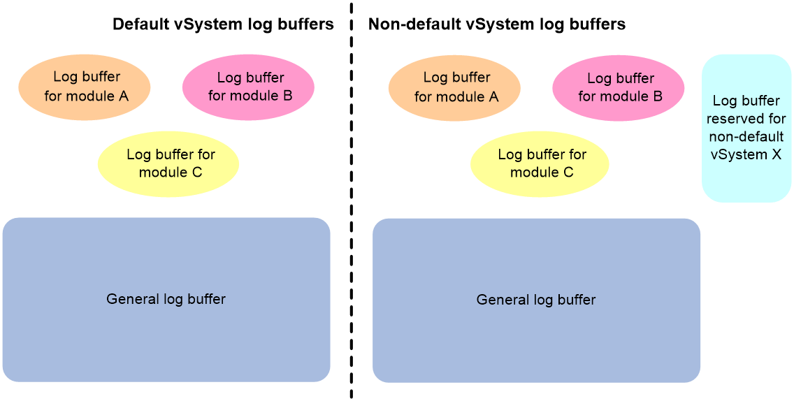

Outputting logs to the log buffer
This feature enables log output to log buffers based on the log source modules. Log buffers include the following types:
·     Separate module-specific log buffers—Logs generated by modules that have separate log buffers are saved to their respective log buffers.
For example, session logs and attack defense logs are saved to the session log buffer and the attack defense log buffer, respectively. With separate buffers, you can manage and view the module-specific logs and general logs conveniently.
The modules that have separate log buffers are determined by factory settings. To view the names of supported modules, use the display logbuffer module ? command. You can use the display logbuffer module module-name command to view buffered logs of the specified module.
·     General log buffer—Logs generated by the system and the modules other than the modules that have separate log buffers are saved to the general log buffer.
You can use the display logbuffer command without the module keyword to view buffered logs in the general log buffer.
The saving of vSystem logs varies by vSystem log type.
·     Default vSystem logs are saved in default vSystem log buffers, which include the default vSystem module-specific log buffers and the default vSystem general log buffer.
·     Non-default vSystem logs are saved in non-default vSystem log buffers, which include the non-default vSystem module-specific log buffers and the non-default vSystem general log buffer. By default, for the same module, all non-default vSystems share and preempt the resources of the non-default log buffer for that module; all non-default vSystems share and preempt the resources of the non-default vSystem general log buffer.
You can use the info-center logbuffer reserved-size command to reserve a log buffer size for a non-default vSystem. The log buffer resources reserved for a non-default vSystem cannot be used by other vSystems. The reserved log buffer resources do not occupy the general log buffer resources of non-default vSystems. A non-default vSystem that has reserved log buffer resources will first use the reserved resources, and then use the non-default vSystem general log buffer when its reserved resources are insufficient.
Figure 2 Default vSystem log buffers and non-default vSystem log buffers

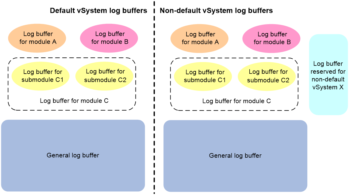

·     Separate module-specific or submodule-specific log buffers—Logs generated by modules and submodules that have separate log buffers are saved to their respective log buffers.
For example, session logs and attack defense logs are saved to the session log buffer and the attack defense log buffer, respectively. With separate buffers, you can manage and view the module-specific or submodule-specific logs and general logs conveniently.
The modules and submodules that have separate log buffers are determined by factory settings. To view the names of supported modules, use the display logbuffer module ? command. To view the names of supported submodules, use the display logbuffer module module-name submodule ? command. You can use the display logbuffer module module-name command to view buffered logs of the specified module. You can use the display logbuffer module module-name submodule submodule-name command to view buffered logs of the specified submodule.
·     General log buffer—Logs generated by the system and the modules or submodules other than the modules or submodules that have separate log buffers are saved to the general log buffer.
·     Default vSystem logs are saved in default vSystem log buffers, which include the default vSystem module-specific or submodule-specific log buffers and the default vSystem general log buffer.
·     Non-default vSystem logs are saved in non-default vSystem log buffers, which include the non-default vSystem module-specific or submodule-specific log buffers and the non-default vSystem general log buffer. By default, for the same module, all non-default vSystems share and preempt the resources of the non-default log buffer for that module; all non-default vSystems share and preempt the resources of the non-default vSystem general log buffer.
Figure 3 Default vSystem log buffers and non-default vSystem log buffers

5.     (Optional.) Set the maximum size of the log buffer for a module.
info-center logbuffer module module-name size buffersize
By default, a maximum of 512 logs can be buffered.
This command takes effect on only default vSystem modules that have separate log buffers.
6.     (Optional.) Set the maximum size of the general log buffer.
info-center logbuffer size buffersize
This command takes effect on only the default vSystem general log buffer.
7.     (Optional.) Specify the log buffer size reserved for non-default vSystems.
a.     Enter vSystem view.
vsys vsys-name [ id vsys-id ]
b.     Specify the log buffer size reserved for the current non-default vSystem.
info-center logbuffer reserved-size reserved-size-value
By default, all non-default vSystems share and preempt the non-default vSystem log buffer resources.
