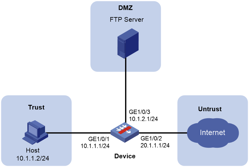

As shown in Figure 1, capture packets on GigabitEthernet 1/0/1. Set the maximum packet size for a packet capture record to 3000 bytes. Use a remote file server to save the .cap files.
1. Assign IP addresses to interfaces:
# Assign an IP address to interface GigabitEthernet 1/0/1.
<Device> system-view
[Device-GigabitEthernet1/0/1] ip address 10.1.1.1 255.255.255.0
2. Add interfaces to security zones.
[Device] security-zone name trust
[Device-security-zone-Trust] import interface gigabitethernet 1/0/1
[Device-security-zone-Trust] quit
[Device] security-zone name dmz
[Device-security-zone-DMZ] import interface gigabitethernet 1/0/3
[Device-security-zone-DMZ] quit
3. Configure a security policy:
# Configure a rule named capturelocalout to allow the device to transfer captured packets to the FTP server. In this example, the FTP server address is 10.1.2.2/24.
[Device] security-policy ip
[Device-security-policy-ip] rule name capturelocalout
[Device-security-policy-ip-1-capturelocalout] source-zone local
[Device-security-policy-ip-1-capturelocalout] destination-zone dmz
[Device-security-policy-ip-1-capturelocalout] destination-ip-host 10.1.2.2
[Device-security-policy-ip-1-capturelocalout] action pass
[Device-security-policy-ip-1-capturelocalout] quit
[Device-security-policy-ip] quit
4. Configure packet capture:
# Set the storage directory for the .cap files to ftp://ftp.remote.com/pcap/. Specify the username and password for accessing the FTP server.
[Device] packet-capture storage remote ftp://ftp.remote.com/pcap/ user zhangsan password simple 123456TESTplat&!
# Set the maximum packet size for a packet capture record to 3000 bytes.
[Device] packet-capture max-bytes 3000
# Start packet capture on GigabitEthernet 1/0/1.
[Device] packet-capture start interface gigabitethernet 1/0/1
# Display packet capture settings and status information.
[Device] display packet-capture status
Capture status: Started
Filter: Interface GigabitEthernet1/0/1
# Use a packet analyzer to display captured packets. (Details not shown.)
