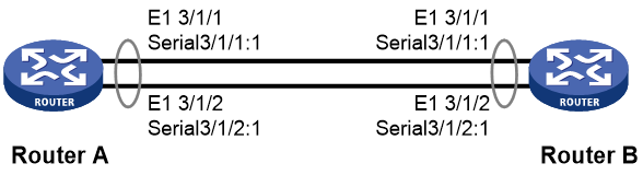

This configuration example is applicable to high-end routers running Release 838x or later.
As shown in Figure 1, Router A and Router B are connected through CE1 interfaces, and the links run the PPP protocol. Bind the links into an MP link through binding the links to an MP-group interface.
Analysis
· Configure the CE1 interfaces to operate in unchannelized E1 mode. Then, the system will automatically create synchronous serial interfaces.
· Create an MP-group interface, and assign the synchronous serial interfaces to the MP-group interface for MP bundling.

The output indicates that Router A and Router B have successfully connected through the CE1 interfaces in unchannelized E1 mode.

1. Display MP information on Router A.
[RouterA] display ppp mp
Template: MP-group3/1/1
max-bind: 31, fragment: enabled, min-fragment: 128
Master link: MP-group3/1/1, Active members: 1, Bundle Multilink
Peer's endPoint descriptor: MP-group3/1/1
Sequence format: long (rcv)/long (sent)
Bundle Up Time: 2023/05/16 10:23:08:696
0 lost fragments, 5 reordered, 0 unassigned, 0 interleaved
Sequence: 4 (rcv)/5 (sent)
Active member channels: 1 members
Serial3/1/1:1 Up-Time:2023/05/16 10:23:08:697
Serial3/1/2:1 Up-Time:2023/05/16 10:23:08:700
2. Ping the peer IP address from Router A.
[RouterA] ping 20.1.1.2
Ping 20.1.1.2 (20.1.1.2): 56 data bytes, press CTRL+C to break
56 bytes from 20.1.1.2: icmp_seq=0 ttl=255 time=4.000 ms
56 bytes from 20.1.1.2: icmp_seq=1 ttl=255 time=1.000 ms
56 bytes from 20.1.1.2: icmp_seq=2 ttl=255 time=0.000 ms
56 bytes from 20.1.1.2: icmp_seq=3 ttl=255 time=7.000 ms
56 bytes from 20.1.1.2: icmp_seq=4 ttl=255 time=1.000 ms
--- Ping statistics for 20.1.1.2 ---
round-trip min/avg/max/std-dev = 0.000/2.600/7.000/2.577 ms
The output indicates that Router A and Router B have successfully connected through the CE1 interfaces in channelized CE1 mode.
Configuration files
· Router A:
controller E1 3/1/1
clock master
channel-set 1 timeslot-list 1-15
controller E1 3/1/2
clock master
interface Serial3/1/1:1
ppp mp MP-group3/1/1
link-protocol ppp
link-protocol ppp
interface MP-group3/1/1
ip address 20.1.1.1 255.255.255.0
· Router B:
controller E1 3/1/1
controller E1 3/1/2
link-protocol ppp
interface Serial3/1/2:1
link-protocol ppp
ip address 20.1.1.2 255.255.255.0
