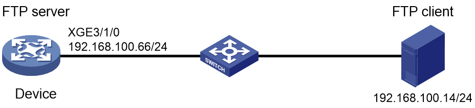

As shown in Figure 1, use TFTP to download a software upgrade file from a TFTP server to upgrade the device.
Figure 1 Network diagram

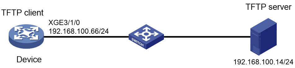

As shown in Figure 2, use FTP to download a software upgrade file from an FTP server to upgrade the device.
Figure 2 Network diagram

Example: Using the device as an FTP server to upgrade software
As shown in Figure 3, enable the FTP server and configure a local user account on the device to provide FTP service. Use FTP to upload a software upgrade file from an FTP client to upgrade the device.
Figure 3 Network diagram

# Assign the IP address 192.168.100.14/24 to the FTP client. Make sure the FTP client can reach the device. (Details not shown.)
# Use the username abc and the password 123456 to log in to the FTP server.
C:\Documents and Settings\Administrator> ftp 192.168.100.66
Connected to 192.168.100.66.

Upgrading software from the BootWare menu
Example: Using the device as a TFTP client to upgrade software
As shown in Figure 4, the device cannot start up.
Use TFTP to upgrade the device from the BootWare menu.
Figure 4 Network diagram
When you upgrade software, make sure the device has sufficient storage space for the upgrade file. If the device does not have sufficient storage space, delete unused files by using the delete /unreserved file-url command.
Procedures
1.     Configure the host:

2.     Configure the TFTP server:
# Assign the IP address 192.168.100.14/24 to the TFTP server. (Details not shown.)
# Start the TFTP server and specify a working directory. (Details not shown.)
3.     Upgrade the device:
