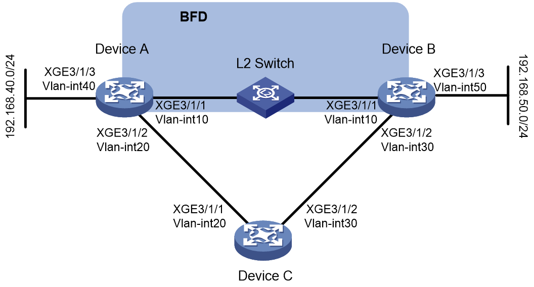

Example: Configuring BFD for static routing
As shown in Figure 2:
·     Device A has two paths to reach Device B: one over a Layer 2 switch, and the other over Device C.
·     A Layer 2 switch connects Device A and Device B.
Because Device B does not support BFD, enable BFD echo packet mode on Device A. When the link between Device B and the Layer 2 switch fails, Device A switches the path over Device C to reach Device B.
Figure 2 Network diagram
Device
Interface
IP address
Device A
XGE3/1/1
192.168.10.101/24
Device A
XGE3/1/2
192.168.20.101/24
Device A
XGE3/1/3
192.168.40.101/24
Device B
XGE3/1/1
192.168.10.102/24
Device B
XGE3/1/2
192.168.30.101/24
Device B
XGE3/1/3
192.168.50.101/24
Device C
XGE3/1/1
192.168.20.102/24
Device C
XGE3/1/2
192.168.30.102/24
When you configure BFD for static routing, follow these restrictions and guidelines:
·     The source IP address for BFD echo packets cannot be on the same network segment as any local interface's IP address. Otherwise, a large number of ICMP redirect packets might be sent from the peer, resulting in link congestion.
·     If the router is not installed with a CSPEX-1404S or CSPEX-1504S card, the minimum interval for receiving echo packets cannot be smaller than 1000 milliseconds. If the router is installed with a CSPEX-1404S or CSPEX-1504S card, the minimum interval for receiving echo packets cannot be smaller than 100 milliseconds.

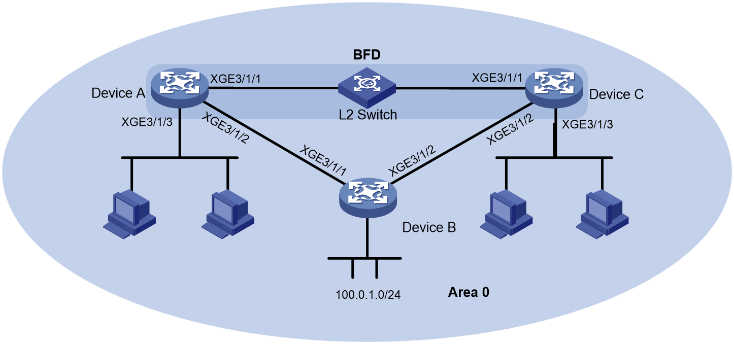

Example: Configuring BFD for RIP
As shown in Figure 3, Device A, Device B, and Device C run RIP. Device A and Device C are connected through a Layer 2 switch.
Enable BFD echo packet mode on Device A (Device C does not support BFD) to monitor the path over the Layer 2 switch. When BFD detects a link failure, it notifies RIP to switch to the path over Device B.
Figure 3 Network diagram
Device
Interface
IP address
Device A
XGE3/1/1
10.1.0.101/24
Device A
XGE3/1/2
192.168.0.101/24
Device A
XGE3/1/3
120.1.1.1/24
Device B
XGE3/1/1
192.168.0.102/24
Device B
XGE3/1/2
13.1.1.101/24
Device C
XGE3/1/1
10.1.0.102/24
Device C
XGE3/1/2
13.1.1.102/24
Device C
XGE3/1/3
121.1.1.1/24
When you configure BFD for RIP, follow these restrictions and guidelines:
Procedures
Configuring interface IP addresses
1.     Configure Device A:
<DeviceA> system-view
[DeviceA] interface ten-gigabitethernet 3/1/1
[DeviceA-Ten-GigabitEthernet3/1/1] ip address 10.1.0.101 24
[DeviceA-Ten-GigabitEthernet3/1/1] quit
2.     Configure other devices in the same way Device A is configured. (Details not shown.)
Configuring RIP
# Configure basic RIP functions, import direct routes, and enable BFD for RIP.
[DeviceA] rip 1
[DeviceA-rip-1] version 2
[DeviceA-rip-1] undo summary
[DeviceA-rip-1] network 10.1.0.0
[DeviceA-rip-1] network 192.168.0.0
[DeviceA-rip-1] import-route direct
[DeviceA-rip-1] quit
[DeviceA-Ten-GigabitEthernet3/1/1] rip bfd enable
2.     Configure Device B:
# Configure basic RIP functions, and import direct routes.
<DeviceB> system-view
[DeviceB] rip 1
[DeviceB-rip-1] version 2
[DeviceB-rip-1] undo summary
[DeviceB-rip-1] network 192.168.0.0
[DeviceB-rip-1] network 13.1.1.0
[DeviceB-rip-1] import-route direct
[DeviceB-rip-1] quit
3.     Configure Device C:
<DeviceC> system-view
[DeviceC] rip 1
[DeviceC-rip-1] version 2
[DeviceC-rip-1] undo summary
[DeviceC-rip-1] network 10.1.0.0
[DeviceC-rip-1] network 13.1.1.0
[DeviceC-rip-1] import-route direct
[DeviceC-rip-1] quit
Configuring BFD parameters on Device A
# Configure the source IP address for BFD echo packets.
[DeviceA] bfd echo-source-ip 11.11.11.11
# Configure the minimum interval for receiving BFD echo packets and the single-hop detection time multiplier.
[DeviceA-Ten-GigabitEthernet3/1/1] bfd min-echo-receive-interval 100
[DeviceA-Ten-GigabitEthernet3/1/1] bfd detect-multiplier 3
# Display BFD session information on Device A.
[DeviceA] display bfd session verbose
 Total Session Num: 1     Up Session Num: 1     Init Mode: Active
 IPv4 Session Working Under Echo Mode:
       Local Discr: 2049
         Source IP: 10.1.0.101         Destination IP: 10.1.0.102
     Session State: Up                      Interface: Ten-GigabitEthernet3/1/1
         Hold Time: 300ms                Act Tx Inter: 100ms
      Min Rx Inter: 100ms                Detect Inter: 300ms
          Rx Count: 464                      Tx Count: 465
      Connect Type: Direct             Running Up for: 00:00:46
       Detect Mode: Async                        Slot: 0
          Protocol: RIP
         Diag Info: No Diagnostic
The output shows that a BFD session has been established and is up.
# Display information about the routes to network 121.1.1.0/24 on Device A.
<DeviceA> display ip routing-table 121.1.1.0 24 verbose
Summary Count : 1
Destination: 121.1.1.0/24
   Protocol: RIP             Process ID: 1
  SubProtID: 0x1                    Age: 04h20m37s
       Cost: 1               Preference: 100
        Tag: 0                    State: Active Adv
  OrigTblID: 0x0                OrigVrf: default-vrf
    TableID: 0x2                 OrigAs: 0
      NBRID: 0x26000002          LastAs: 0
     AttrID: 0xffffffff        Neighbor: 10.1.0.102
      Flags: 0x1008c        OrigNextHop: 10.1.0.102
      Label: NULL           RealNextHop: 10.1.0.102
    BkLabel: NULL             BkNextHop: N/A
  Tunnel ID: Invalid          Interface: Ten-GigabitEthernet3/1/1
BkTunnel ID: Invalid        BkInterface: N/A
The output shows that Device A communicates with Device C through the Layer 2 switch.
# When the link between Device C and the Layer 2 switch fails, view BFD log information.
%Oct  9 18:42:17:650 2013 Device A BFD/5/BFD_CHANGE_FSM: -MDC=1;Sess[10.1.0.101/10.1.0.102, LD/RD:2049/2049, Interface: Ten-GigabitEthernet3/1/1, SessType:Echo, LinkType:INET] , Sta: UP-> DOWN, Diag:1
The output shows that BFD can quickly detect the failure and notify RIP.
Summary Count : 1
   Protocol: RIP             Process ID: 2
       Cost: 2               Preference: 100
     AttrID: 0xffffffff        Neighbor: 192.168.0.102
      Flags: 0x1008c        OrigNextHop: 192.168.0.102
      Label: NULL           RealNextHop: 192.168.0.102
  Tunnel ID: Invalid          Interface: Ten-GigabitEthernet3/1/2
The output shows that Device A communicates with Device C through Device B.

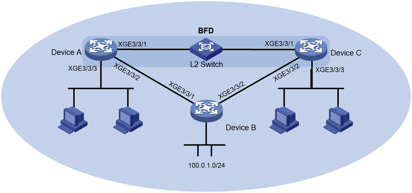

Example: Configuring BFD for OSPF
As shown in Figure 4, Device A, Device B, and Device C run OSPF. Device A and Device C are connected through a Layer 2 switch.
Enable BFD control packet mode on Device A and Device C to monitor the path over the Layer 2 switch. When BFD detects a link failure, it notifies OSPF to switch to the path over Device B.
Figure 4 Network diagram
Table 3 Interface and IP address assignment
Device
Interface
IP address
Device A
XGE3/1/1
10.1.0.101/24
Device A
XGE3/1/2
192.168.0.101/24
Device A
XGE3/1/3
120.1.1.1/24
Device B
XGE3/1/1
192.168.0.102/24
Device B
XGE3/1/2
13.1.1.101/24
Device C
XGE3/1/1
10.1.0.102/24
Device C
XGE3/1/2
13.1.1.102/24
Device C
XGE3/1/3
121.1.1.1/24
When you configure BFD for OSPF, follow these restrictions and guidelines:
·     In BFD control packet mode, a minimum of one end must operate in active mode for a BFD session to be established.
Procedures
Configuring OSPF
# Configure basic OSPF functions, and enable BFD for OSPF.
[DeviceA] ospf
[DeviceA-ospf-1] area 0
[DeviceA-ospf-1-area-0.0.0.0] network 10.1.0.0 0.0.0.255
[DeviceA-ospf-1-area-0.0.0.0] network 192.168.0.0 0.0.0.255
[DeviceA-ospf-1-area-0.0.0.0] network 120.1.1.0 0.0.0.255
[DeviceA-ospf-1-area-0.0.0.0] quit
[DeviceA-ospf-1] quit
[DeviceA-Ten-GigabitEthernet3/1/1] ospf bfd enable
# Configure basic OSPF functions.
[DeviceB] ospf
[DeviceB-ospf-1] area 0
[DeviceB-ospf-1-area-0.0.0.0] network 192.168.0.0 0.0.0.255
[DeviceB-ospf-1-area-0.0.0.0] network 13.1.1.0 0.0.0.255
[DeviceB-ospf-1-area-0.0.0.0] quit
[DeviceB-ospf-1] quit
[DeviceC] ospf
[DeviceC-ospf-1] area 0
[DeviceC-ospf-1-area-0.0.0.0] network 10.1.0.0 0.0.0.255
[DeviceC-ospf-1-area-0.0.0.0] network 13.1.1.0 0.0.0.255
[DeviceC-ospf-1-area-0.0.0.0] network 121.1.1.0 0.0.0.255
[DeviceC-ospf-1-area-0.0.0.0] quit
[DeviceC-ospf-1] quit
[DeviceC] interface ten-gigabitethernet 3/1/1
[DeviceC-Ten-GigabitEthernet3/1/1] ospf bfd enable
[DeviceC-Ten-GigabitEthernet3/1/1] quit
# Configure the session establishment mode as active (this is the default mode).
[DeviceA] bfd session init-mode active
# Configure the minimum interval for sending and receiving single-hop BFD control packets and the single-hop detection time multiplier.
[DeviceA-Ten-GigabitEthernet3/1/1] bfd min-transmit-interval 100
[DeviceA-Ten-GigabitEthernet3/1/1] bfd min-receive-interval 100
2.     Configure Device C:
[DeviceC] bfd session init-mode active
[DeviceC-Ten-GigabitEthernet3/1/1] bfd min-transmit-interval 100
[DeviceC-Ten-GigabitEthernet3/1/1] bfd min-receive-interval 100
[DeviceC-Ten-GigabitEthernet3/1/1] bfd detect-multiplier 3
# Ping host C (connected to Device C) from host A (connected to Device A) to verify the connectivity.
<host A> ping 121.1.1.2
PING 121.1.1.2 (121.1.1.2): 56 data bytes
56 bytes from 121.1.1.2: seq=0 ttl=128 time=22.43 ms
56 bytes from 121.1.1.2: seq=1 ttl=128 time=7.17 ms
56 bytes from 121.1.1.2: seq=2 ttl=128 time=8.91 ms
56 bytes from 121.1.1.2: seq=3 ttl=128 time=7.45 ms
56 bytes from 121.1.1.2: seq=4 ttl=128 time=9.11 ms
--- 121.1.1.2 ping statistics ---
5 packets transmitted, 5 packets received, 0% packet loss
round-trip min/avg/max = 7.17/11.01/22.43 ms
The output shows that host C can be pinged successfully.
# Display detailed OSPF neighbor information on Device A.
[DeviceA] display ospf peer verbose
          OSPF Process 1 with Router ID 2.2.2.2
                  Neighbors
 Area 0.0.0.0 interface 10.1.0.101(Ten-GigabitEthernet3/1/1)'s neighbors
 Router ID: 1.1.1.1          Address: 10.1.0.102       GR State: Normal
   State: Full  Mode: Nbr is Slave  Priority: 1
   DR: 10.1.0.101  BDR: 10.1.0.102  MTU: 0
   Options is 0x42 (-|O|-|-|-|-|E|-)
   Dead timer due in 39  sec
   Neighbor is up for 00:09:01
   Authentication Sequence: [ 0 ]
   Neighbor state change count: 5
   BFD status: Enabled(Control mode)
The output shows that Device A has established OSPF neighbor relationship with Device C.
# Display BFD session information on Device A and Device C.
 Total session number: 1   Up session number: 1   Init mode: Active
 IPv4 session working under Ctrl mode:
     Local Discr: 10                  Remote Discr: 1
 Min Trans Inter: 100ms            Act Trans Inter: 100ms
  Min Recv Inter: 100ms           Act Detect Inter: 300ms
          Rx Count: 3971                     Tx Count: 3776
      Connect Type: Direct             Running Up for: 00:06:52
         Hold Time: 300ms                   Auth mode: None
        Protocol: OSPF
[DeviceC] display bfd session verbose
     Local Discr: 1                   Remote Discr: 10
       Source IP: 10.1.0.102        Destination IP: 10.1.0.101
  Min Recv Inter: 100ms           Act Detect Inter: 100ms
          Rx Count: 3                     Tx Count: 3

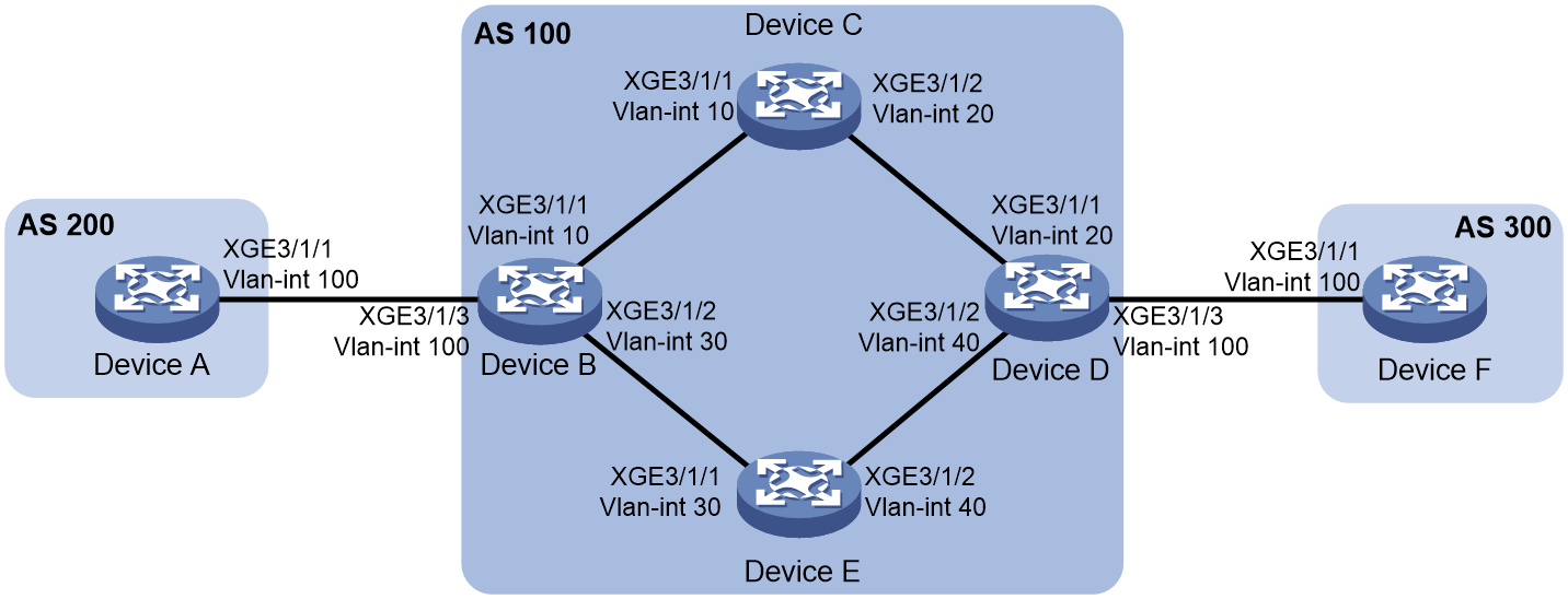

Example: Configuring BFD for BGP
As shown in Figure 6, the devices in AS 100 run OSPF to reach each other. There are two paths between Device B and Device D:
·     Path A—Path over Device C.
·     Path B—Path over Device E.
When both paths are available, BGP uses the path over Device C to forward traffic between Device A and Device F.
Enable BFD control packet mode on Device B and Device D to monitor the path over Device C. When BFD detects a link failure, it notifies BGP to switch to the path over Device E.
Figure 6 Network diagram
Table 5 Interface and IP address assignment
Device
Interface
IP address
Device A
XGE3/1/1
120.1.0.1/24
Device B
XGE3/1/1
10.1.0.101/24
Device B
XGE3/1/2
192.168.0.101/24
Device B
XGE3/1/3
120.1.0.2/24
Device C
XGE3/1/1
10.1.0.102/24
Device C
XGE3/1/2
10.2.0.102/24
Device D
XGE3/1/1
10.2.0.101/24
Device D
XGE3/1/2
13.1.1.101/24
Device D
XGE3/1/3
120.2.0.2/24
Device E
XGE3/1/1
192.168.0.102/24
Device E
XGE3/1/2
13.1.1.102/24
Device F
XGE3/1/1
120.2.0.1/24
Analysis
For Path A to become the primary path, use a routing policy to set a lower cost for Path A than Path B.
Procedures

Configuring OSPF in AS 100
1.     Configure Device B:
[DeviceB] ospf
[DeviceB-ospf-1] import-route direct
[DeviceB-ospf-1-area-0.0.0.0] network 10.1.0.0 0.0.0.255

Configuring BFD
# Enable BFD for the link to BGP peer 10.2.0.101.
[DeviceB] bgp 100
[DeviceB-bgp-default] peer 10.2.0.101 bfd
[DeviceB-bgp-default] quit
2.     Configure Device D:
# Enable BFD for the link to BGP peer 10.1.0.101.
[DeviceD] bgp 100
[DeviceD-bgp-default] peer 10.1.0.101 bfd
[DeviceD-bgp-default] quit
# Ping Device F from Device A to verify the connectivity.
[DeviceA] ping 120.2.0.1
Ping 120.2.0.1 (120.2.0.1): 56 data bytes, press CTRL_C to break
56 bytes from 120.2.0.1: icmp_seq=0 ttl=252 time=1.189 ms
56 bytes from 120.2.0.1: icmp_seq=1 ttl=252 time=1.095 ms
56 bytes from 120.2.0.1: icmp_seq=2 ttl=252 time=1.086 ms
56 bytes from 120.2.0.1: icmp_seq=3 ttl=252 time=1.097 ms
56 bytes from 120.2.0.1: icmp_seq=4 ttl=252 time=1.089 ms
--- Ping statistics for 120.2.0.1 ---
round-trip min/avg/max/std-dev = 1.086/1.111/1.189/0.039 ms
The output shows that Device F can be pinged successfully.
# Display BGP peer information on Device B.
[DeviceB] display bgp peer ipv4
 BGP local router ID: 2.2.2.2
 Local AS number: 100
 Total number of peers: 3                  Peers in established state: 3
  Peer                    AS  MsgRcvd  MsgSent OutQ PrefRcv Up/Down  State
  10.2.0.101             100        6        4    0       1 00:00:56 Established
  13.1.1.101             100        6        5    0       1 00:00:56 Established
  120.1.0.1              200        6        5    0       1 00:00:56 Established
The output shows the following information:
·     Two IBGP connections have been established between Device B and Device D.
·     An EBGP connection has been established between Device B and Device A.
# Display detailed BFD session information on Device B.
[DeviceB] display bfd session verbose
 Total Session Num: 1     Up Session Num: 0     Init Mode: Active
 IPv4 Session Working Under Ctrl Mode:
       Local Discr: 2049                 Remote Discr: 0
         Source IP: 10.1.0.101         Destination IP: 10.2.0.101
     Session State: UP                      Interface: N/A
      Min Tx Inter: 1000400ms               Act Tx Inter: 1000400ms
      Min Rx Inter: 1000400ms               Detect Inter: 50002000ms
          Rx Count: 0                        Tx Count: 910
      Connect Type: Indirect           Running Up for: 00:00:00
         Hold Time: 0ms                     Auth mode: None
          Protocol: BGP

The output shows that Device B communicates with Device D through path over Device C.
# When the path over Device C fails, ping Device F from Device A.
<DeviceA> ping 120.2.0.1
Ping 120.1.0.1 (120.2.0.1): 56 data bytes, press CTRL_C to break
56 bytes from 120.2.0.1: icmp_seq=0 ttl=252 time=0.680 ms
56 bytes from 120.2.0.1: icmp_seq=1 ttl=252 time=0.295 ms
56 bytes from 120.2.0.1: icmp_seq=2 ttl=252 time=0.423 ms
56 bytes from 120.2.0.1: icmp_seq=3 ttl=252 time=0.464 ms
56 bytes from 120.2.0.1: icmp_seq=4 ttl=252 time=0.445 ms
5 packets transmitted, 5 packets received, 0.0% packet loss
round-trip min/avg/max/std-dev = 0.295/0.461/0.680/0.124 ms
# Display information about the routes to network 120.2.0.0/24 on Device B.
<DeviceB> display ip routing-table 120.2.0.0 24 verbose
Summary Count : 2
Destination: 120.2.0.0/24
   Protocol: BGP             Process ID: 0
  SubProtID: 0x1                    Age: 00h00m18s
       Cost: 0               Preference: 100
    TableID: 0x2                 OrigAs: 300
      NibID: 0x15000001          LastAs: 300
     AttrID: 0x1               Neighbor: 10.2.0.101
      Flags: 0x10060        OrigNextHop: 10.2.0.101
   Protocol: OSPF            Process ID: 1
  SubProtID: 0x8                    Age: 00h00m18s
       Cost: 1               Preference: 150
        Tag: 1                    State: Inactive Adv
      NibID: 0x13000001          LastAs: 0
     AttrID: 0xffffffff        Neighbor: 0.0.0.0
      Flags: 0x41           OrigNextHop: 192.168.0.102
The output shows that Device B communicates with Device D through path over Device E.

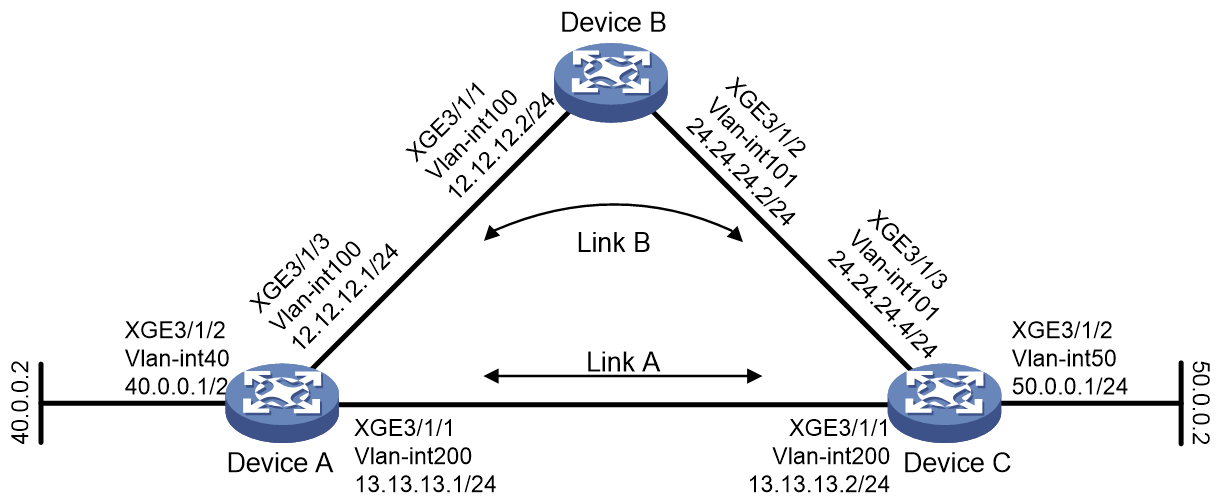

Example: Configuring BFD for PBR
As shown in Figure 7, Device A has two paths to reach Device C:
·     Link A.
·     Link B.
Configure PBR to enable Device A to forward traffic with source IP address 40.0.0.2 over Link B.
Enable BFD echo packet mode on Device A (Device C does not support BFD) to monitor Link B. When BFD detects a link failure, Device A switches the path to Link A.
Figure 7 Network diagram
When you configure BFD for PBR, follow these restrictions and guidelines:
