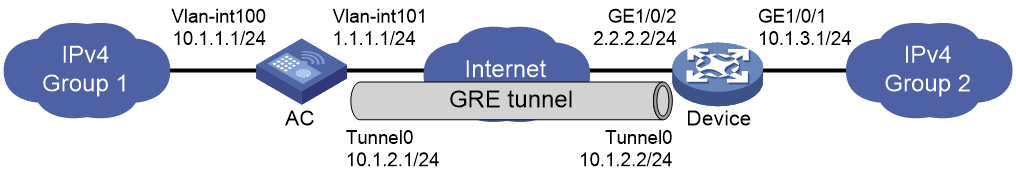

Example: Configuring an IPv4 over IPv4 GRE tunnel
As shown in Figure 7, Group 1 and Group 2 are two private IPv4 networks. The two networks both use private network addresses. Establish a GRE tunnel between the AC and the peer device (Device) to interconnect the two private IPv4 networks Group 1 and Group 2.
Figure 7 Network diagram
Before performing the following configuration, configure an IP address for each interface, and make sure the AC and Device can reach each other.
1.     Configure the AC:
# Create tunnel interface Tunnel 0, and specify the tunnel mode as GRE/IPv4.
<AC> system-view
[AC] interface tunnel 0 mode gre
# Configure an IP address for the tunnel interface.
[AC-Tunnel0] ip address 10.1.2.1 255.255.255.0
# Configure the source address of the tunnel as the IP address of VLAN-interface 101.
[AC-Tunnel0] source 1.1.1.1
# Configure the destination address of the tunnel as the IP address of GigabitEthernet 1/0/2.
[AC-Tunnel0] destination 2.2.2.2
[AC-Tunnel0] quit
# Configure a static route from the AC through the tunnel to Group 2.
[AC] ip route-static 10.1.3.0 255.255.255.0 tunnel 0
2.     Configure Device:
<Device> system-view
[Device] interface tunnel 0 mode gre
[Device-Tunnel0] ip address 10.1.2.2 255.255.255.0
# Configure the source address of the tunnel as the IP address of GigabitEthernet 1/0/2.
[Device-Tunnel0] source 2.2.2.2
# Configure the destination address of the tunnel as the IP address of VLAN-interface 101.
[Device-Tunnel0] destination 1.1.1.1
[Device-Tunnel0] quit
# Configure a static route from Device through the tunnel to Group 1.
[Device] ip route-static 10.1.1.0 255.255.255.0 Tunnel 0
# Display tunnel interface information on the AC.
[AC] display interface tunnel 0
Tunnel0
Current state: UP
Line protocol state: UP
Description: Tunnel0 Interface
Bandwidth: 64kbps
Maximum transmission unit: 64000
Internet address: 10.1.2.1/24 (primary)
Tunnel source 1.1.1.1 (Vlan-interface101), destination 2.2.2.2
Tunnel keepalive disabled
Tunnel TTL 255
Tunnel protocol/transport GRE/IP
    GRE key disabled
    Checksumming of GRE packets disabled
Last clearing of counters: Never
Last 300 seconds input rate: 0 bytes/sec, 0 bits/sec, 0 packets/sec
Last 300 seconds output rate: 0 bytes/sec, 0 bits/sec, 0 packets/sec
Input: 0 packets, 0 bytes, 0 drops
Output: 0 packets, 0 bytes, 0 drops
# Display tunnel interface information on Device.
[Device] display interface tunnel 0
Tunnel0
Current state: UP
Bandwidth: 64kbps
Internet address:10.1.2.2/24 (primary)
Tunnel source 2.2.2.2, destination 1.1.1.1
Tunnel TTL 255
    GRE key disabled
# From Device, ping the IP address of VLAN-interface 100 on the AC.
[Device] ping -a 10.1.3.1 10.1.1.1
Ping 10.1.1.1 (10.1.1.1) from 10.1.3.1: 56 data bytes, press CTRL_C to break
56 bytes from 10.1.1.1: icmp_seq=0 ttl=255 time=11.000 ms
56 bytes from 10.1.1.1: icmp_seq=1 ttl=255 time=1.000 ms
56 bytes from 10.1.1.1: icmp_seq=2 ttl=255 time=0.000 ms
56 bytes from 10.1.1.1: icmp_seq=3 ttl=255 time=0.000 ms
56 bytes from 10.1.1.1: icmp_seq=4 ttl=255 time=0.000 ms
--- Ping statistics for 10.1.1.1 ---
round-trip min/avg/max/std-dev = 0.000/2.400/11.000/4.317 ms
The output shows that Device can successfully ping the AC.

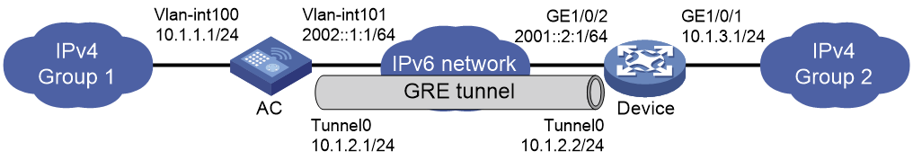

Example: Configuring an IPv4 over IPv6 GRE tunnel
As shown in Figure 8, two IPv4 subnets Group 1 and Group 2 are connected to an IPv6 network. Create a GRE/IPv6 tunnel between the AC and the peer device (Device), so the two IPv4 subnets can communicate with each other through the GRE tunnel over the IPv6 network.
Figure 8 Network diagram
# Create tunnel interface Tunnel 0, and specify the tunnel mode as GRE/ IPv6.
<AC> system-view
[AC] interface tunnel 0 mode gre ipv6
# Configure the source address of the tunnel as the IPv6 address of VLAN-interface 101.
[AC-Tunnel0] source 2002::1:1
# Configure the destination address of the tunnel as the IPv6 address of GigabitEthernet 1/0/2.
[AC-Tunnel0] destination 2001::2:1
[AC-Tunnel0] quit
# Create tunnel interface Tunnel 0, and specify the tunnel mode as GRE/IPv6.
[Device] interface tunnel 0 mode gre ipv6
# Configure the source address of the tunnel as the IPv6 address of GigabitEthernet 1/0/2.
[Device-Tunnel0] source 2001::2:1
# Configure the destination address of the tunnel as the IPv6 address of VLAN-interface 101.
[Device-Tunnel0] destination 2002::1:1
[Device] ip route-static 10.1.1.0 255.255.255.0 tunnel 0
Tunnel0
Current state: UP
Bandwidth: 64kbps
Tunnel source 2002::1:1, destination 2001::2:1
Tunnel TTL 255
Tunnel protocol/transport GRE/IPv6
    GRE key disabled
Tunnel0
Current state: UP
Bandwidth: 64kbps
Tunnel source 2001::2:1, destination 2002::1:1
Tunnel TTL 255
    GRE key disabled
56 bytes from 10.1.1.1: icmp_seq=0 ttl=255 time=2.000 ms
56 bytes from 10.1.1.1: icmp_seq=2 ttl=255 time=1.000 ms
56 bytes from 10.1.1.1: icmp_seq=4 ttl=255 time=1.000 ms
round-trip min/avg/max/std-dev = 0.000/1.000/2.000/0.632 ms
