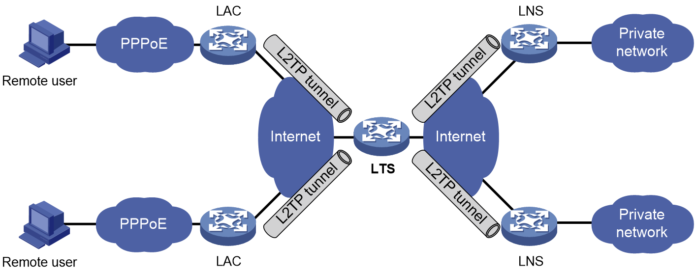

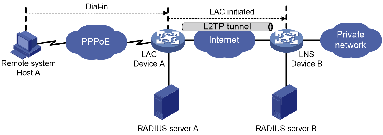

Typical L2TP networking
Figure 1 L2TP network diagram
As shown in Figure 1, a typical L2TP network has the following components:
·     Remote system—A remote system is usually a remote user's host or a remote branch's device that needs to access the private network.
·     LAC—An L2TP access concentrator (LAC) is both PPP and L2TP capable. It is usually a network access server (NAS) located at a local ISP, which provides access services mainly for PPP users.
An LAC is an endpoint of an L2TP tunnel and lies between an LNS and a remote system. It encapsulates packets received from a remote system by using L2TP and then sends the encapsulated packets to the LNS. It decapsulates packets received from the LNS and then sends the decapsulated packets to the intended remote system.
·     LNS—An L2TP network server (LNS) is both PPP and L2TP capable. It is usually an edge device on an enterprise network.
An LNS is the other endpoint of an L2TP tunnel. It is the logical termination point of a PPP session tunneled by the LAC. L2TP extends the termination point of a PPP session from a NAS to an LNS by establishing a tunnel.

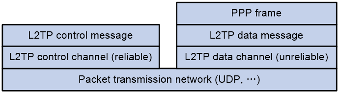

As shown in Figure 2, the L2TP protocol defines two types of messages: L2TP control messages and L2TP data messages.
·     Control message—Used to establish, maintain, and tear down L2TP tunnels and sessions. Control messages are transmitted over a reliable control channel, which supports flow control and congestion control.
·     Data messages—Used to encapsulate PPP frames. Data messages are transmitted over an unreliable data channel and are not retransmitted when packet loss occurs. Data messages can use sequence numbers to reorder packets that are disordered during transport.
Figure 2 L2TP protocol structure diagram

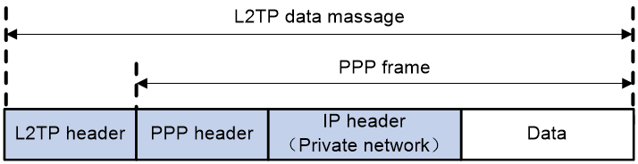

As shown in Figure 3, L2TP control messages and L2TP data messages are both encapsulated in UDP packets.
Figure 3 L2TP message encapsulation structure diagram
The L2TP data message format is as shown in Table 1.
Table 1 L2TP data message format

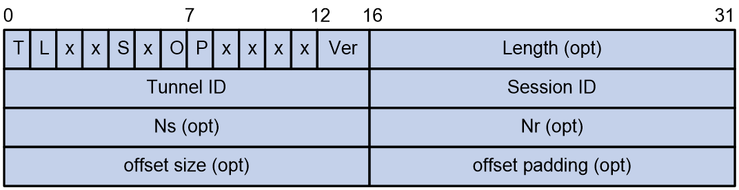

L2TP packet header
The control messages and data messages of L2TP use the same L2TP packet header format as shown in Figure 4. For the meaning of each field in the L2TP packet header, see Table 2.
Figure 4 L2TP packet header format
·     A field with the opt tag in the L2TP packet header means the field is optional in data messages and required in control messages.
·     The L2TP packet header contains the tunnel ID and session ID, which are allocated by the peer to identify different tunnels and sessions. Packets with the same tunnel ID but different session IDs will be multiplexed on the same tunnel.
Table 2 Fields in the L2TP packet header
Field
Description
Value requirement
T
Type. The value of 0 indicates data message, and the value of 1 indicates control message.
The value must be 1 in a control message.
L
Indicates whether the length field is present. The value of 1 indicates the presence of the length field in the packet header.
x
Reserved bits.
S
Indicates whether the sequence fields are present. The value of 1 indicates the presence of the Ns and Nr fields in the packet header.
O
The value of 1 indicates that the offset size field exists in the packet header.
The value must be 0 in a control message.
P
Priority, used only for data messages.
Ver
Version number.
The value for the L2TPv2 protocol is 2.
Length
Total length of the message, measured in bytes.
Tunnel ID
Tunnel ID, which has local significance only.
Hello control messages have global significance, and their tunnel ID must be 0.
Session ID
Session ID, which has local significance only.
Ns
Sequence number of the current message.
Nr
Sequence number expected in the next control message to be received.
In data messages, this field is reserved.
offset size
Offset value, indicating the start position of the payload data.
offset padding
Padding bits.

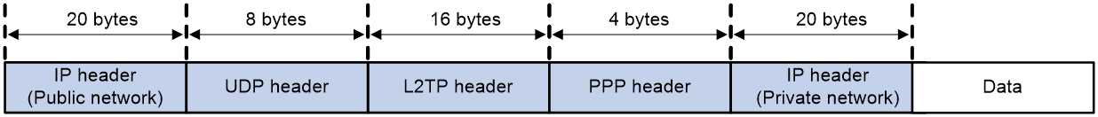

As shown in Figure 5, the user PPP packet (with the source IP packet header and PPP packet header) carries the following protocol headers when transmitted in the public network as an IP packet:
·     One L2TP packet header (16 bytes)
·     One UDP packet header (8 bytes)
·     One new IP packet header (20 bytes), which indicates the source address and destination address of the L2TP tunnel.
Figure 5 L2TP data packet format
An LAC encapsulates a received PPP packet as follows:
1.     First, encapsulates it with the L2TP packet header.
2.     Then, encapsulates the UDP packet header.
3.     Then, encapsulates the new IP header and sends the packet out the interface connected to the public network. The new IP header's address is the IP address of the tunnel destination.
An LNS processes the packet as follows after receiving the packet from the interface connected to the public network:
4.     Removes the IP header and UDP header, and sends the packet to the L2TP protocol module.
5.     The L2TP protocol removes the L2TP protocol header and PPP header, restores the packet to the user IP packet, and sends the packet to the internal server in the private network.

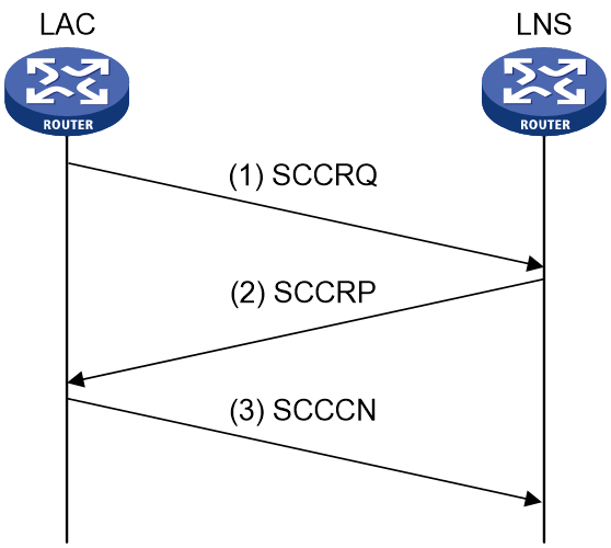

As shown in Figure 12, the following workflow is used to establish a NAS-initiated tunnel:
1.     A remote system (Host A) initiates a PPP connection to the LAC (Device A).
2.     The remote system and LAC perform PPP LCP negotiation.
3.     The LAC authenticates PPP user information of Host A by using PAP or CHAP.
4.     The LAC sends the authentication information (username and password) to its RADIUS server (RADIUS server A) for authentication.
5.     RADIUS server A authenticates the user and returns the result.
6.     The LAC initiates an L2TP tunneling request to the LNS (Device B) when the following conditions exist:
¡     The user passes the authentication.
¡     The user is determined to be an L2TP user according to the username or the ISP domain to which the user belongs.
7.     If tunnel authentication is needed, the LAC and LNS send CHAP challenge messages to authenticate each other before successfully establishing an L2TP tunnel.
8.     The LAC and LNS negotiate to establish L2TP sessions.
9.     The LAC sends PPP user information and PPP negotiation parameters to the LNS.
10.     The LNS sends the authentication information to its RADIUS server (RADIUS server B) for authentication.
11.     RADIUS server B authenticates the user and returns the result.
12.     If the user passes the authentication, the LNS assigns a private IP address to the remote system (Host A).
13.     The PPP user can access internal resources of the enterprise.
In steps 12 and 13, the LAC forwards packets for the remote system and LNS. Host A and LAC exchange PPP frames, and the LAC and LNS exchange L2TP packets.
Client-initiated tunneling mode

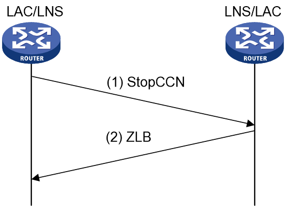

As shown in Figure 13, a remote system running L2TP (LAC client) has a public IP address to communicate with the LNS through the Internet. The LAC client can directly initiate a tunneling request to the LNS without any dedicated LAC devices.
Figure 13 Client-initiated tunneling mode
A client-initiated tunnel has the following characteristics:
·     A client-initiated tunnel has higher security because it is established between a remote system and the LNS.
·     The remote system must support L2TP and be able to communicate with the LNS. This causes poor expandability.
As shown in Figure 14, the workflow for establishing a client-initiated tunnel is similar to that for establishing a NAS-initiated tunnel. (Details not shown.)
Figure 14 Client-initiated tunnel establishment process

·     L2TP tunnel switching—Also called multihop L2TP tunneling. As shown in Figure 15, the Layer 2 tunnel switch (LTS) terminates L2TP packets from each LAC as an LNS. It then sends these packets to a destination LNS as an LAC.
L2TP tunnel switching has the following features:
¡     Simplified configuration and deployment—When LACs and LNSs are in different management domains:
-     All LACs consider the LTS as an LNS and do not need to differentiate LNSs on the network.
-     All LNSs consider the LTS as an LAC and are not affected by the addition or deletion of LACs.
¡     L2TP tunnel sharing—Different users can share the same L2TP tunnel between the LAC and the LTS. The LTS distributes data of different users to different LNSs.
Figure 15 L2TP tunnel switching network diagram
