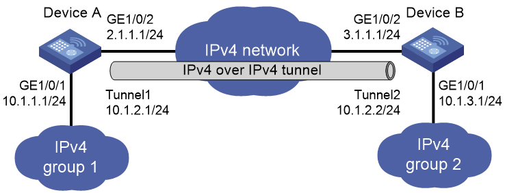

IPv4 over IPv4 tunneling
About IPv4 over IPv4 tunneling
IPv4 over IPv4 tunneling (RFC 1853) enables isolated IPv4 networks to communicate. For example, an IPv4 over IPv4 tunnel can connect isolated private IPv4 networks over a public IPv4 network.
Figure 4 IPv4 over IPv4 tunnel
Figure 4 shows the encapsulation and de-encapsulation processes.
· Encapsulation:
a. Device A receives an IP packet from an IPv4 host and submits it to the IP protocol stack.
b. The IPv4 protocol stack determines how to forward the packet according to the destination address in the IP header. If the packet is destined for the IPv4 host connected to Device B, Device A delivers the packet to the tunnel interface.
c. The tunnel interface adds a new IPv4 header to the IPv4 packet and submits it to the IP protocol stack.
In the new header, the source IP address specifies the tunnel source, and the destination IP address specifies the tunnel destination.
d. The IP protocol stack uses the destination IP address of the new IP header to look up the routing table, and then sends the packet out.
· De-encapsulation:
e. After receiving the packet, Device B delivers it to the IP protocol stack.
f. If the protocol number is 4 (indicating an IPv4 packet is encapsulated within the packet), the IP protocol stack delivers the packet to the tunnel module for de-encapsulation.
g. The tunnel module de-encapsulates the IP packet and sends it back to the IP protocol stack.
h. The protocol stack forwards the de-encapsulated packet.

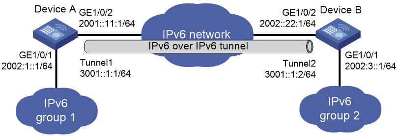

IPv6 over IPv6 tunneling
About IPv6 over IPv6 tunneling
IPv6 over IPv6 tunneling (RFC 2473) enables isolated IPv6 networks to communicate with each other over another IPv6 network. For example, two isolated IPv6 networks that do not want to show their addresses to the Internet can use an IPv6 over IPv6 tunnel to communicate with each other.
Figure 6 Principle of IPv6 over IPv6 tunneling
Figure 6 shows the encapsulation and de-encapsulation processes.
· Encapsulation:
a. After receiving an IPv6 packet, Device A submits it to the IPv6 protocol stack.
b. The IPv6 protocol stack uses the destination IPv6 address of the packet to find the egress interface. If the egress interface is the tunnel interface, the stack delivers it to the tunnel interface.
c. After receiving the packet, the tunnel interface adds an IPv6 header to it and submits it to the IPv6 protocol stack.
d. The IPv6 protocol stack forwards the packet according to its destination IPv6 address.
· De-encapsulation:
e. Upon receiving the IPv6 packet, Device B delivers it to the IPv6 protocol stack.
f. The IPv6 protocol stack checks the protocol type of the data portion encapsulated in the IPv6 packet. If the encapsulation protocol is IPv6, the stack delivers the packet to the tunnel module.

As shown in Figure 7, configure an IPv6 over IPv6 tunnel between Device A and Device B so the IPv6 groups can reach each other without disclosing their IPv6 addresses.
Make sure Device A and Device B can reach each other through IPv6.
1. Configure Device A:
# Assign an IPv6 address to interface GigabitEthernet 1/0/1.
<DeviceA> system-view
[DeviceA-GigabitEthernet1/0/1] ipv6 address 2002:1::1 64
[DeviceA-GigabitEthernet1/0/1] quit
# Assign an IPv6 address to interface GigabitEthernet 1/0/2, the physical interface of the tunnel.
[DeviceA] interface gigabitethernet 1/0/2
[DeviceA-GigabitEthernet1/0/2] ipv6 address 2001::11:1 64
[DeviceA-GigabitEthernet1/0/2] quit
# Create IPv6 tunnel interface Tunnel 1.
[DeviceA] interface tunnel 1 mode ipv6
# Specify an IPv6 address for the tunnel interface.
[DeviceA-Tunnel1] ipv6 address 3001::1:1 64
# Specify the IP address of GigabitEthernet 1/0/2 as the source address of the tunnel.
[DeviceA-Tunnel1] source 2001::11:1
# Specify the IP address of GigabitEthernet 1/0/2 on Device B as the destination address of the tunnel.
[DeviceA-Tunnel1] destination 2002::22:1
[DeviceA-Tunnel1] quit
# Configure a static route destined for the IPv6 network group 2 through the tunnel.
[DeviceA] ipv6 route-static 2002:3:: 64 tunnel 1
2. Configure Device B:
<DeviceB> system-view
[DeviceB-GigabitEthernet1/0/1] ipv6 address 2002:3::1 64
[DeviceB-GigabitEthernet1/0/1] quit
[DeviceB] interface gigabitethernet 1/0/2
[DeviceB-GigabitEthernet1/0/2] ipv6 address 2002::22:1 64
[DeviceB-GigabitEthernet1/0/2] quit
# Create IPv6 tunnel interface Tunnel 2.
[DeviceB] interface tunnel 2 mode ipv6
[DeviceB-Tunnel2] ipv6 address 3001::1:2 64
[DeviceB-Tunnel2] source 2002::22:1
# Specify the IP address of GigabitEthernet 1/0/2 on Device A as the destination address of the tunnel.
[DeviceB-Tunnel2] destination 2001::11:1
[DeviceB-Tunnel2] quit
# Configure a static route destined for the IPv6 network group 1 through the tunnel.
[DeviceB] ipv6 route-static 2002:1:: 64 tunnel 2
# Use the display ipv6 interface command to display the status of the tunnel interfaces on Device A and Device B. Verify that the tunnel interfaces are up. (Details not shown.)
# Verify that Device A and Device B can ping the IPv6 address of interface GigabitEthernet 1/0/1 of each other. This example uses Device A.
[DeviceA] ping ipv6 -a 2002:1::1 2002:3::1
Ping6(56 data bytes) 2002:1::1 --> 2002:3::1, press CTRL_C to break
56 bytes from 2002:3::1, icmp_seq=0 hlim=64 time=9.000 ms
56 bytes from 2002:3::1, icmp_seq=1 hlim=64 time=1.000 ms
56 bytes from 2002:3::1, icmp_seq=2 hlim=64 time=0.000 ms
56 bytes from 2002:3::1, icmp_seq=3 hlim=64 time=0.000 ms
56 bytes from 2002:3::1, icmp_seq=4 hlim=64 time=0.000 ms
--- Ping6 statistics for 2002:3::1 ---
round-trip min/avg/max/std-dev = 0.000/2.000/9.000/3.521 ms
