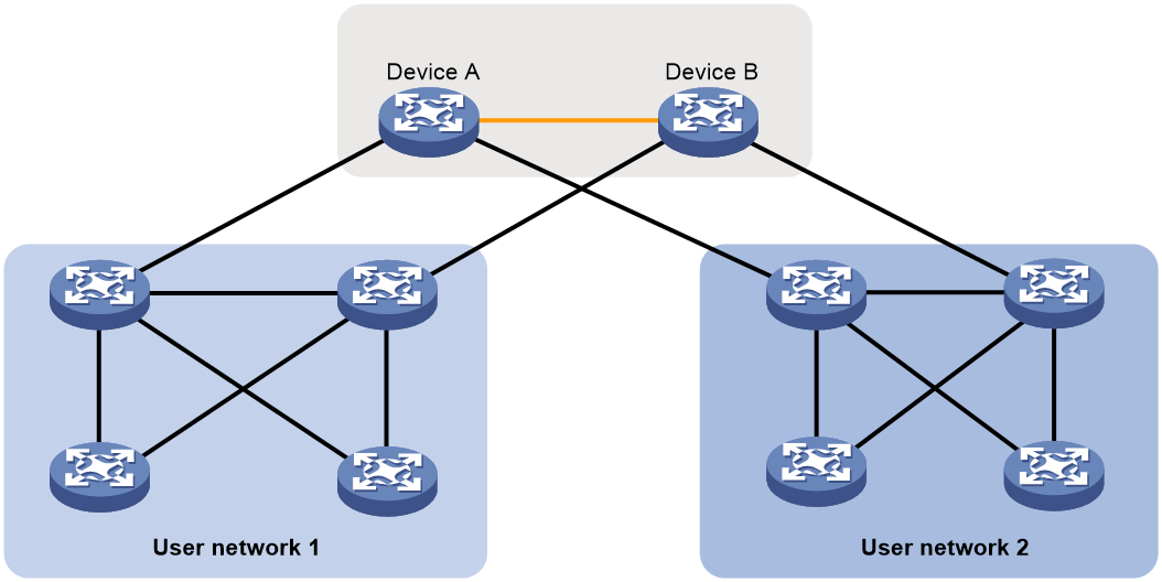

Configuring TC Snooping
As shown in Figure 18, Device A and Device B connect to two user networks through double links.
·     The spanning tree feature is disabled on Device A and Device B and enabled on all devices in user network 1 and user network 2.
·     Device A and Device B transparently transmit BPDUs for both user networks and are not involved in the calculation of spanning trees.
When the network topology changes, it takes time for Device A and Device B to update their MAC address table and ARP table. During this period, traffic in the network might be interrupted.
Figure 18 TC Snooping application scenario
To avoid traffic interruption, you can enable TC Snooping on Device A and Device B. After receiving a TC-BPDU through a port, Device A or Device B updates MAC address table and ARP table entries associated with the port's VLAN. In this way, TC Snooping prevents topology change from interrupting traffic forwarding in the network. For more information about the MAC address table and the ARP table, see Network Connectivity Configuration Guide.
·     TC Snooping and the spanning tree feature are mutually exclusive. You must globally disable the spanning tree feature before enabling TC Snooping.
·     TC Snooping does not support the PVST mode.
2.     Globally disable the spanning tree feature.
undo stp global enable
By default, the spanning tree feature is disabled globally.
3.     Enable TC Snooping.
stp tc-snooping
By default, TC Snooping is disabled.

About dispute guard
Dispute guard is enabled by default. You do not need to manually configure this feature.
Dispute guard can be triggered by unidirectional link failures. If an upstream port receives inferior BPDUs from a downstream designated port in forwarding or learning state because of a unidirectional link failure, a loop appears. Dispute guard blocks the upstream designated port to prevent the loop.
As shown in Figure 19, in normal conditions, the spanning tree calculation result is as follows:
·     Device A is the root bridge, and Port A1 is a designated port.
·     Port B1 is blocked.
When the link between Port A1 and Port B1 fails in the direction of Port A1 to Port B1 and becomes unidirectional, the following events occur:
1.     Port A1 can only receive BPDUs and cannot send BPDUs to Port B1.
2.     Port B1 does not receive BPDUs from Port A1 for a certain period of time.
3.     Device B determines itself as the root bridge.
4.     Port B1 sends its BPDUs to Port A1.
5.     Port A1 determines the received BPDUs are inferior to its own BPDUs. A dispute is detected.
6.     Dispute guard is triggered and blocks Port A1 to prevent a loop.
Figure 19 Dispute guard triggering scenario
