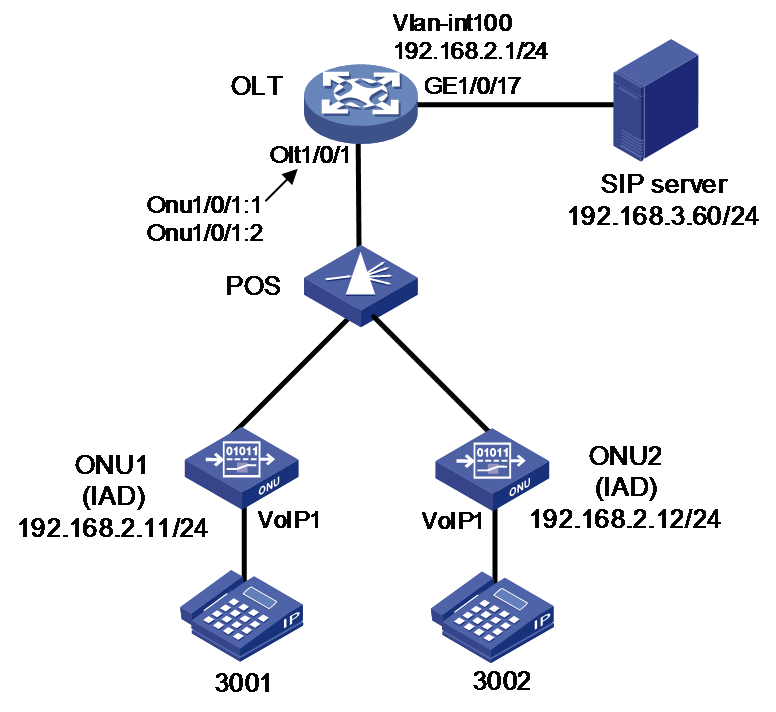

Example: Configuring SIP voice for ONUs attached to an OLT
Configure SIP on the OLT so telephones attached to ONU 1 and ONU 2 can register with the SIP registrar server and then can call each other.
The OLT uses VLAN 100 to transmit voice data.
Figure 1 Network diagram
Configuration procedure
# Create VLAN 100 and its VLAN interface. Then, assign IP addresses to the interfaces on the OLT and make sure the OLT and the SIP server can reach each other. (Details not shown.)
# Enable auto ONU binding on slot 1. Then, the OLT will automatically create ONU interfaces ONU 1/0/1:1 and ONU 1/0/1:2.

# Configure the VLAN tagging operation mode for the voice VLAN feature on ONU 1 and ONU 2.
[OLT-if-range] voice vlan 100
# Bring up VoIP port 1 on ONU 1 and ONU 2.
[OLT-if-range] undo voip-port 1 shutdown
# Specify the SIP registrar server at 192.168.3.60 for ONU 1 and ONU 2.
[OLT-if-range] voip sip registrar-server ip 192.168.3.60
# Specify the SIP proxy server at 192.168.3.60 for ONU 1 and ONU 2.
[OLT-if-range] voip sip proxy-server ip 192.168.3.60
# Configure digit map map1 for ONU 1 and ONU 2 to allow four-digit call numbers starting with 3 to be dialed out.
[OLT-if-range] voip digit-map map1 3xxx
[OLT-if-range] quit
# Configure the IP address and gateway address of the IAD module on ONU 1 as 192.168.2.11/24 and 192.168.2.1, respectively.
[OLT] interface onu 1/0/1:1
[OLT-Onu1/0/1:1] iad address 192.168.2.11 24 gateway 192.168.2.1
# Add SIP user with phone number 3001 as well as username 3001 and password 3001 in plaintext form to ONU 1.
[OLT-Onu1/0/1:1] voip-port 1 sip account 3001 username 3001 password simple 3001
[OLT-Onu1/0/1:1] quit
# Configure the IP address and gateway address of the IAD module on ONU 1 as 192.168.2.12/24 and 192.168.2.1, respectively.
[OLT] interface onu 1/0/1:2
[OLT-Onu1/0/1:2] iad address 192.168.2.12 24 gateway 192.168.2.1
# Add SIP user with phone number 3002 as well as username 3002 and password 3002 in plaintext form to ONU 1.
[OLT-Onu1/0/1:2] voip-port 1 sip account 3002 username 3002 password simple 3002
[OLT-Onu1/0/1:2] quit
# Register SIP users on ONU 1 and ONU 2 with the SIP registrar server and then place a call from 3001 to 3002. The call can be established. (Details not shown.)
