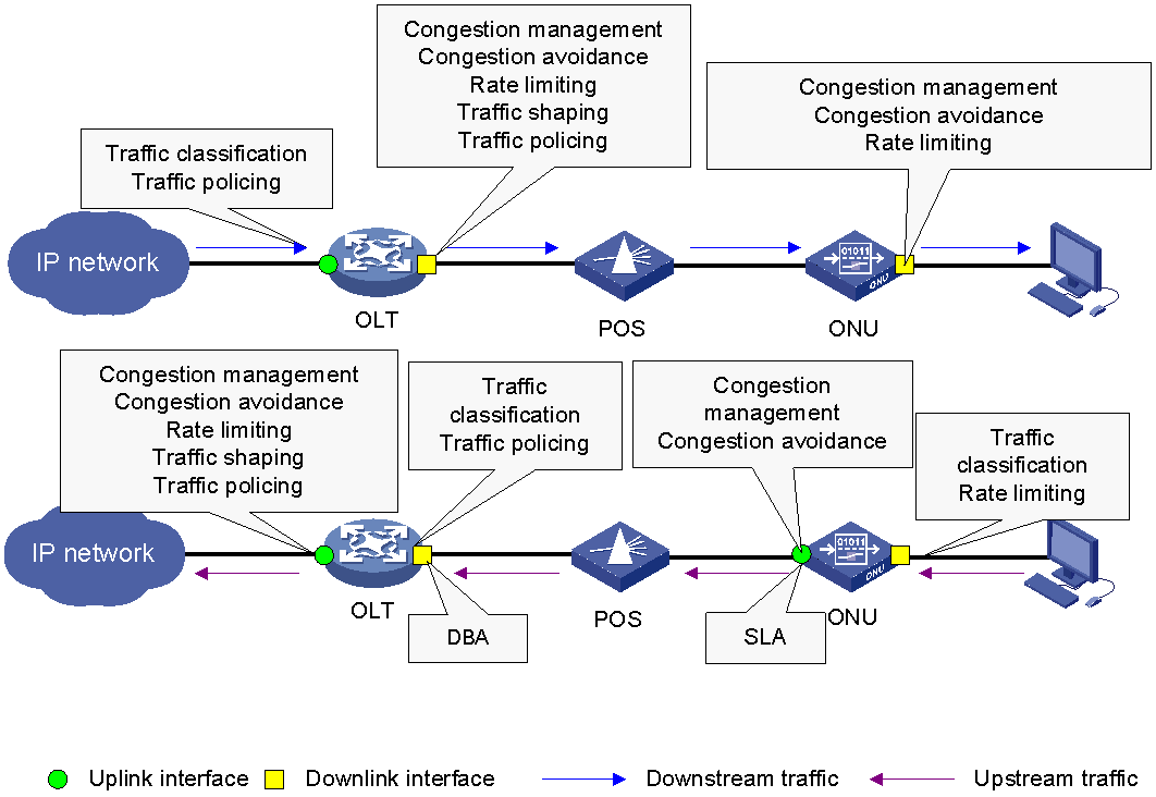

Figure 1 shows the QoS model of the EPON system.
Figure 1 EPON QoS model

An OLT supports remotely configuring the following QoS features for ONUs:
·     ONU bandwidth allocation
Allocate uplink and downlink bandwidth based on different terminal service requirements to realize efficient bandwidth utilization.
·     Congestion management for uplink ONU traffic
By configuring Service Level Agreement (SLA) attributes, you can remotely manage the fixed bandwidth, guaranteed bandwidth, and best-effort bandwidth for each queue on an ONU. During each DBA scheduling cycle, the ONU granularly manages the uplink bandwidth for each queue according to the uplink traffic queue scheduling configuration of the ONU and the DBA configuration on the OLT.
The following queue scheduling modes are supported:
¡     SP—Strict priority queueing, which classifies the eight output queues into eight classes, 7, 6, 5, 4, 3, 2, 1, and 0, in descending order of priority.
¡     WRR—Weighted round robin, which schedules queues according to their weights in a round robin way. WRR guarantees certain service time for each queue.
¡     SP+WRR—Uses SP and WRR together to schedule queues.
For more information about SP and WRR, see hardware congestion management configuration in ACL and QoS Configuration Guide.
·     CoS-to-local priority mapping on ONU interfaces and RONU interfaces
When an ONU receives downlink traffic from an ONU or RONU interface of an OLT, the ONU assigns the traffic to different output queues based on CoS-to-local priority mappings.
·     UNI priority marking
Priority marking enables an ONU to perform the following operations on packets received from a UNI:
a.     Classifies packets received from a UNI into multiple classes based on information of the packets, such as MAC addresses and IP addresses.
b.     Applies different priority mapping policies to packets of different classes.
·     UNI traffic policing
Traffic policing allows ONUs to evaluate traffic and limit the traffic rate. Traffic evaluation is implemented through the token bucket mechanism.
The token bucket mechanism evaluates traffic by checking the number of tokens in the bucket.
¡     If the number of tokens in the bucket is enough for forwarding the packets, the traffic conforms to the specification (called conforming traffic).
¡     If the number of tokens is not enough, the traffic does not conform to the specification (called excess traffic).
A token bucket has the following parameters:
¡     Committed information rate (CIR)—Rate at which tokens are put into the bucket, or the permitted average rate of traffic.
¡     Committed burst size (CBS)—Burst size or the capacity of the token bucket. It is the maximum traffic size permitted in each burst. The burst size must be greater than the maximum packet size.
¡     Excess Burst Size (EBS). For more information, see ACL and QoS Configuration Guide.
¡     Peak Information Rate (PIR). For more information, see ACL and QoS Configuration Guide.
