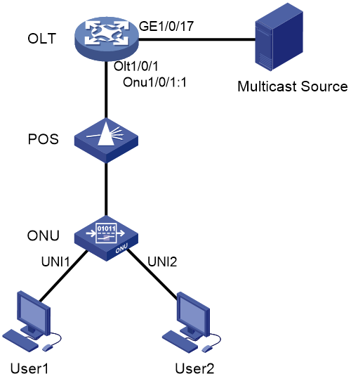

Multicast in IGMP snooping mode
In IGMP snooping mode, the OLT and ONUs mainly use IGMP report, leave, and query messages to manage dynamic multicast group membership. The OLT can implement simple user multicast access control through the multicast VLAN configuration on UNIs of ONUs.
When an ONU receives an IGMP membership report from a multicast group member, the ONU forwards the message to the OLT. When multiple members of a multicast group are attached to the ONU, the OLT will receive duplicate IGMP reports from these members. To reduce IGMP reports, enable IGMP report suppression. Within each query cycle, the ONU forwards only the first IGMP report of a multicast group to the OLT. Subsequent IGMP reports from the same multicast group are not forwarded.
On the OLT, you can configure the router interface aging timer, the multicast group member port aging timer, and the query response timer for an ONU.
·     Router interface aging timer—The router interface is the interface that connects the ONU to the router. The ONU receives IGMP general query messages from the router through this interface. If no IGMP general query message is received through the router interface when the router interface aging timer expires, the ONU determines that the interface is not a router interface. The router interface aging timer must be a value about 2.5 times of the general query interval. For more information about the general query interval, see IGMP in IP Multicast Configuration Guide.
·     Multicast group member port aging timer—This timer determines how often multicast group members are refreshed. If the ONU does not receive an IGMP report from a multicast group member port when this timer expires, the ONU deletes the port. In a network where multicast group members change frequently, set this timer to a small value.
·     Query response timer—This timer sets the response timeout time for group-specific queries. If the ONU does not receive a response before the query response timer expires for the first time, it re-sends group-specific queries and re-starts the query response timer. If the ONU still does not receive a response when the timer expires, the multicast group on the ONU is deleted.
Multicast in multicast control mode
In multicast control mode, the OLT performs the following operations:
·     The OLT maintains an access control table for user multicast services to centrally manage user multicast service access rights.
·     The OLT identifies users based on the user LLID and the VLAN tag (same as the UNI number) carried in uplink IGMP report messages. The OLT also determines whether a user has the right to access the requested multicast service and determines the related parameters.
·     The OLT uses extended multicast control OAM packets to send the ONU a user's access right to a multicast channel. This allows the ONU to forward or shut off the multicast traffic for the user. The network management system on the OLT centrally manages multicast access control. Multicast right management is governed by the OLT and executed by ONUs. The OLT also supports the cooperation between IGMP proxy and upper-layer multicast routers to dynamically request and deliver multicast traffic.
In multicast control mode, an ONU performs the following operations:
·     The ONU maintains a table for multicast address filtering and multicast forwarding. The ONU performs flow control only for the current multicast service on the ONU.
·     The ONU adds VLAN tags to untagged IGMP report and leave messages to identify users and transparently sends the messages to the OLT. The VLAN tag ID is the same as the UNI number. For example, the packets received on UNI 1 are tagged with VLAN ID 1. The ONU adds or deletes the group address filtering and multicast forwarding entries on the ONU based on the multicast control OAM packets delivered by the OLT. The multicast control OAM packets contain a series of multicast control entries. Based on the action taken on the entries, the ONU forwards or shuts off multicast traffic.

Multicast in IGMP snooping mode configuration example
As shown in Figure 1, the ONU has been bound to ONU 1/0/1:1.
Configure multicast in IGMP snooping mode on the ONU for User 1 to access channels 225.1.2.1 through 225.1.2.255 and User 2 to access channels 225.1.3.1 through 225.1.3.255.
Figure 1 Network diagram
Configuration procedure
# Map the multicast IP addresses to multicast VLANs.
<OLT> system-view
[OLT] ftth
[OLT-ftth] multicast vlan-id 1002 ip 225.1.2.1 to 225.1.2.255
[OLT-ftth] multicast vlan-id 1003 ip 225.1.3.1 to 225.1.3.255
[OLT-ftth] quit
# Enable IGMP snooping globally.
[OLT] igmp-snooping
[OLT-igmp-snooping] quit
# Enable IGMP snooping and IGMP snooping querier and set the source IP addresses of IGMP general queries and group-specific queries to a valid IP address on the device in VLAN 1002 and VLAN 1003.
[OLT] vlan 1002
[OLT-vlan1002] igmp-snooping enable
[OLT-vlan1002] igmp-snooping querier
[OLT-vlan1002] igmp-snooping general-query source-ip 10.1.1.1
[OLT-vlan1002] igmp-snooping special-query source-ip 10.1.1.1
[OLT-vlan1002] quit
[OLT] vlan 1003
[OLT-vlan1003] igmp-snooping enable
[OLT-vlan1003] igmp-snooping querier
[OLT-vlan1003] igmp-snooping general-query source-ip 10.1.1.1
[OLT-vlan1003] igmp-snooping special-query source-ip 10.1.1.1
[OLT-vlan1003] quit
# Set the multicast mode to IGMP snooping on ONU 1/0/1:1.
[OLT] interface onu 1/0/1:1
[OLT-Onu1/0/1:1] multicast mode igmp-snooping
# Assign UNI 1 and UNI 2 of the ONU to multicast VLANs 1002 and 1003, respectively.
[OLT-Onu1/0/1:1] uni 1 multicast vlan 1002
[OLT-Onu1/0/1:1] uni 2 multicast vlan 1003
# Configure ONU 1/0/1:1 as a trunk port that permits all VLANs.
[OLT-Onu1/0/1:1] port link-type trunk
[OLT-Onu1/0/1:1] port trunk permit vlan all
# Configure UNI 1 and UNI 2 to remove the VLAN tag of downlink multicast flows.
[OLT-Onu1/0/1:1] uni 1 multicast-strip-tag enable
[OLT-Onu1/0/1:1] uni 2 multicast-strip-tag enable
[OLT-Onu1/0/1:1] quit
# Configure OLT 1/0/1 as a hybrid port, and assign it to VLAN 1002 and VLAN 1003 as a tagged member.
[OLT] interface olt 1/0/1
[OLT-Olt1/0/1] port link-type hybrid
[OLT-Olt1/0/1] port hybrid vlan 1002 1003 tagged
[OLT-Olt1/0/1] quit
# Configure GigabitEthernet 1/0/17 as a trunk port that permits VLAN 1002 and VLAN 1003.
[OLT] interface gigabitethernet 1/0/17
[OLT-GigabitEthernet1/0/17] port link-type trunk
[OLT-GigabitEthernet1/0/17] port trunk permit vlan 1002 1003
[OLT-GigabitEthernet1/0/17] quit
