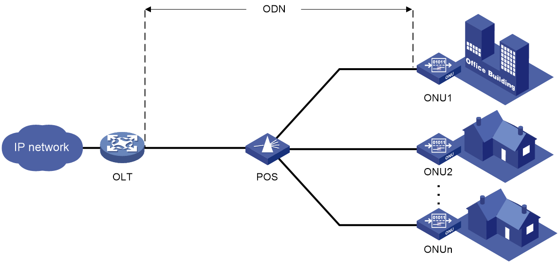

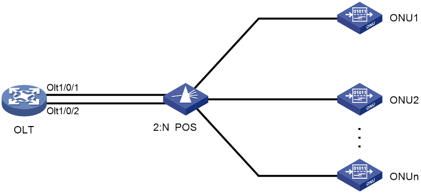

As shown in Figure 1, a typical EPON system contains optical line terminals (OLTs), optical network units (ONUs), and optical distribution networks (ODNs).
·     OLT—The core device of an EPON system, located at the central office. The OLT manages ONUs in the EPON system and forwards traffic between the EPON system and the IP network.
·     ONU—A device connected to customer premises equipment such as PCs, set-top boxes, and switches. Typically, ONUs are placed at customers' homes, corridors, or roadsides. ONUs forward uplink data sent by customer premises equipment (from ONU to OLT) and selectively forward downlink broadcasts sent by OLTs (from OLT to ONU).
·     ODN—A network formed by optical fibers, one or multiple passive optical splitters (POSs), and other passive optical components. ODNs provide optical signal transmission paths between OLTs and ONUs. A POS can couple uplink data into a single piece of fiber and distribute downlink data to ONUs.
EPON uses the single-fiber wavelength division multiplexing (WDM) technology to implement single-fiber bidirectional transmission. WDM uses a downlink central wavelength of 1490 nm and an uplink central wavelength of 1310 nm. WDM can support a transmission distance of up to 20 km (12.43 miles).
Figure 1 Typical EPON architecture

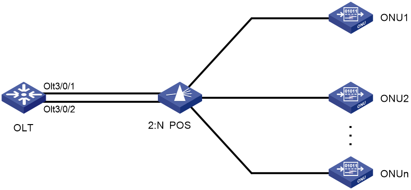

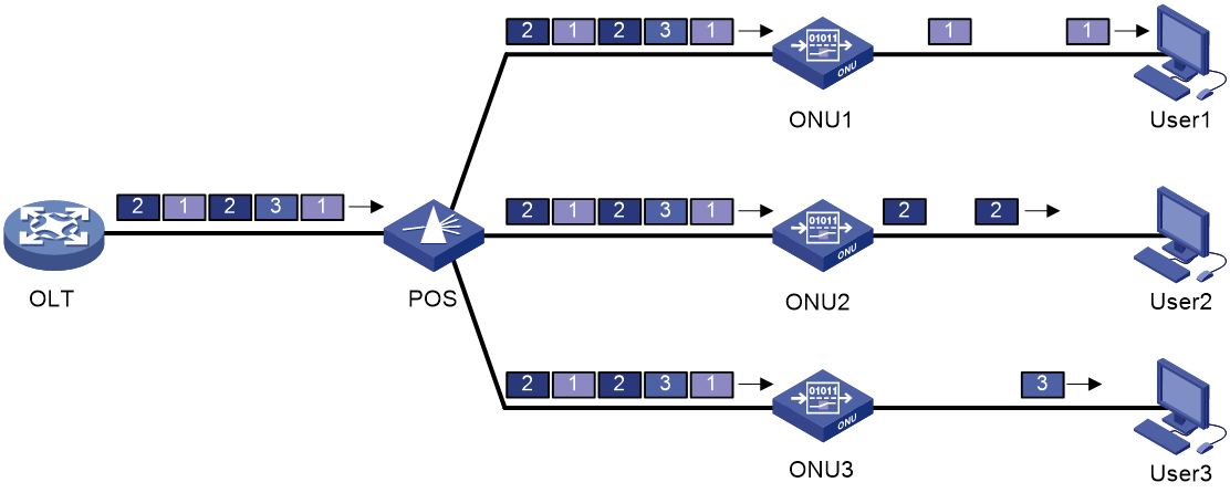

·     Downlink data transmission—As shown in Figure 2, the OLT broadcasts downlink data to ONUs. Each ONU receives packets destined for it based on the LLID and drops the other packets.
Figure 2 Downlink data transmission in an EPON system

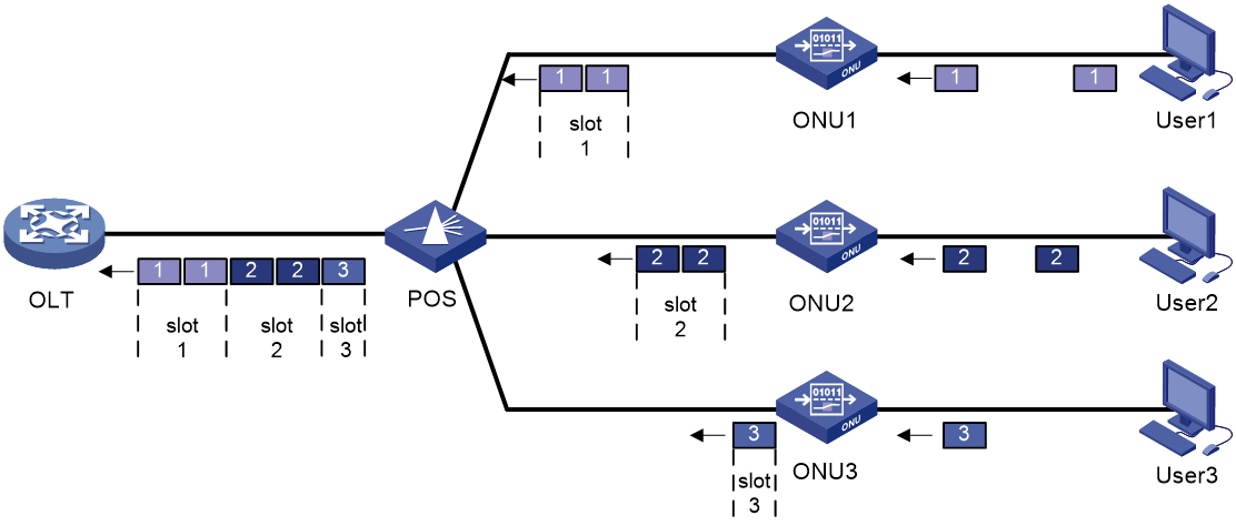

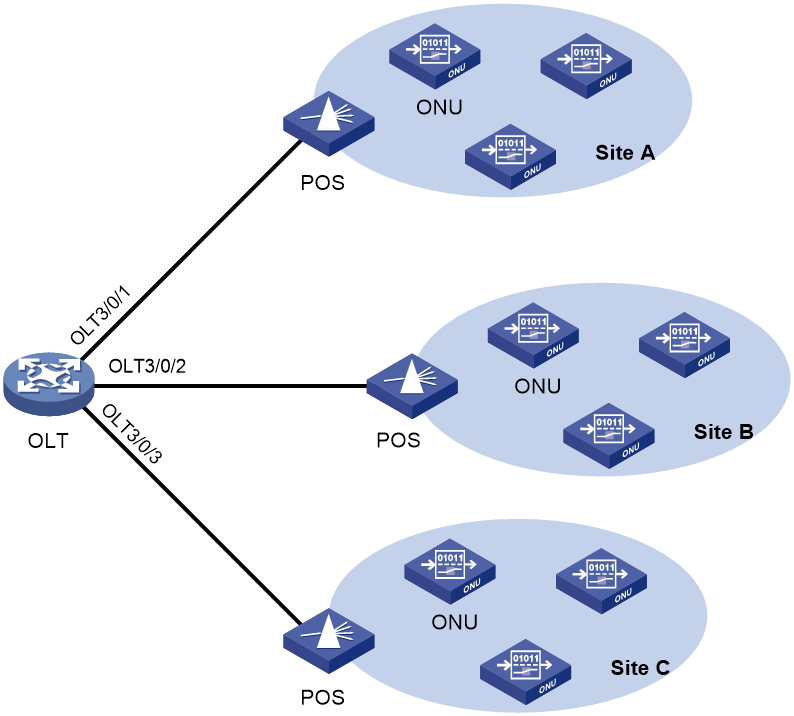

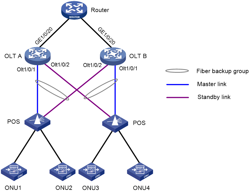

·     Uplink data transmission—As shown in Figure 3, each ONU buffers the data frames received from users and sends the frames at the full wire-speed when the timeslot for the ONU arrives.
EPON uses the Time Division Multiple Access (TDMA) technology to transmit uplink data. This technology ensures that one optical fiber between the OLT and the POS can transmit data signals from multiple ONUs to the OLT without signal interference.
Figure 3 Uplink data transmission in an EPON system

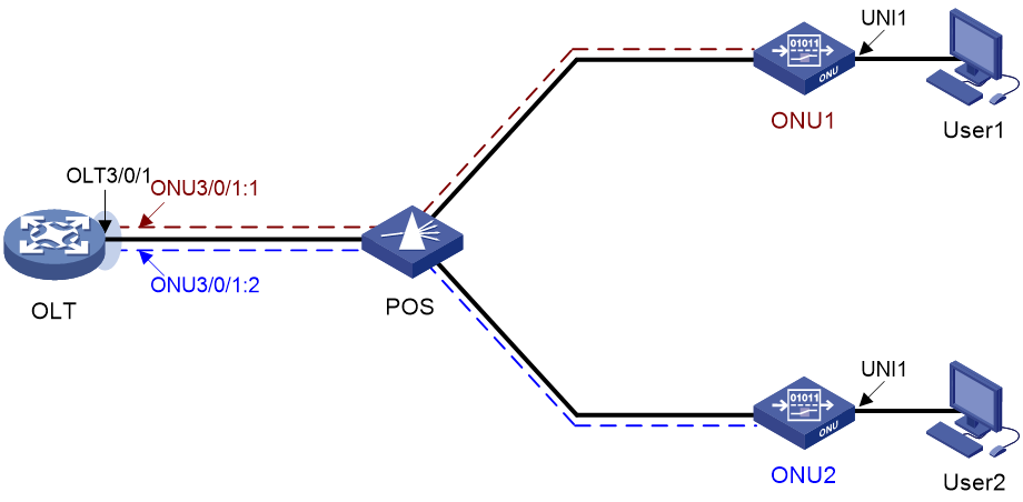

EPON interface types and interface numbering rules
As shown in Figure 4, EPON defines the following interface types:
·     OLT interface—A physical ONU-facing interface on an OLT. Each OLT interface on an EPON card can be connected to an EPON network.
OLT interfaces are numbered in the format of EPON card slot number/subcard slot number/OLT interface number, for example, OLT 3/0/1.
·     ONU interface—A virtual interface created on an OLT interface.
ONU interfaces are numbered in the format of EPON card slot number/subcard slot number/OLT interface number:ONU interface number, for example, ONU 3/0/1:1.
Each ONU interface corresponds to a physical ONU. The configuration performed in ONU interface view takes effect on the ONU bound to the ONU interface. An ONU interface can identify an ONU only after the interface is bound to the ONU.
·     UNI—User network interface, a physical user-facing interface on an ONU.
UNIs can be remotely configured and managed by executing commands in ONU interface view.
Figure 4 EPON interface types and interface numbers

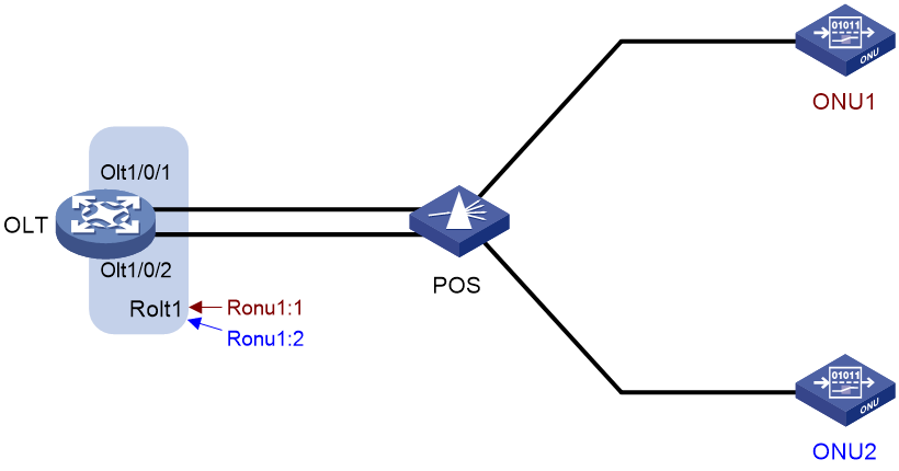

As shown in Figure 5, EPON redundant interfaces include the following types:
·     ROLT—Redundant OLT interface, which is formed by binding two OLT interfaces on an OLT. Then, the two OLT interfaces can redundantly back up each other to improve the link reliability.
An ROLT interface number has only one tier, for example, ROLT 1.
·     RONU—Redundant ONU interface, which is a Layer 2 logical interface created on an ROLT interface to connect an ONU.
An RONU interface is numbered in the format of ROLT interface number:RONU interface number, for example, RONU 1:1.
The configuration made in RONU interface view is applied to the ONU accessing the OLT through the RONU interface. An RONU interface is significant only when an ONU is bound to the RONU interface.
Figure 5 EPON redundant backup model

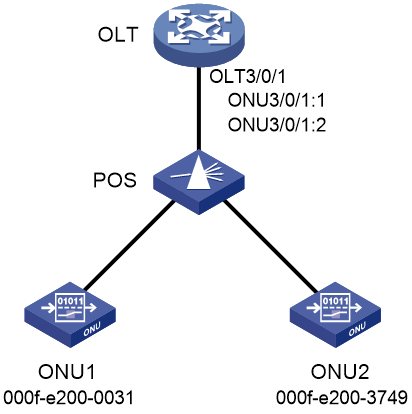

Common fiber backup group
As shown in Figure 6, the OLT interfaces that back up each other are on the same OLT.
In a common fiber backup group, you can manually perform master/subordinate switchover between the two member ports.
Figure 6 Common fiber backup group

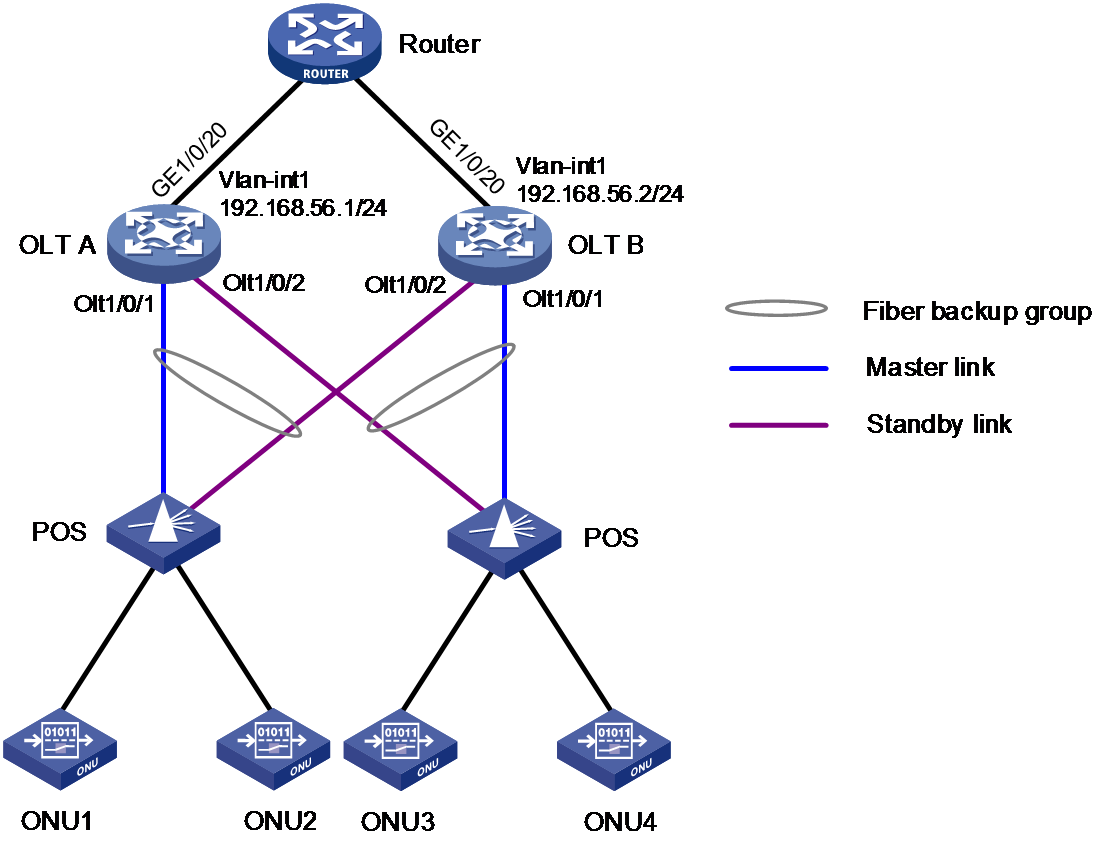

Multidevice fiber backup group
As shown in Figure 7, the OLT interfaces that back up each other are on different OLTs. The two OLTs synchronize data by using TCP connections.
Figure 7 Multidevice fiber backup group

Configuring EPON redundant interfaces
Restrictions and guidelines for cooperation with other features
An OLT interface assigned to a fiber backup group or configured with the ONU authentication mode cannot be assigned to an ROLT interface. An OLT interface assigned to an ROLT interface cannot be assigned to a fiber backup group or configured with the ONU authentication mode.
Restrictions and guidelines for ROLT interface configuration
When you assign member ports to an ROLT interface, follow these restrictions and guidelines:
·     An ROLT interface can contain only two member ports and the member ports must have different priorities.
·     An OLT interface can be assigned to only one ROLT interface.
·     To assign an OLT interface to an ROLT interface, make sure the OLT interface has the same attribute configurations as the ROLT interface. The attribute configurations cannot be modified for an OLT interface that has been assigned to an ROLT interface.
Attribute configurations include port isolation, VLAN mapping, QinQ, and port-based VLAN configurations.
To ensure correct traffic forwarding after active port switchover, make sure the two member ports use the same type of transceiver models and are configured with the same speed.
To ensure correct active port switchover, make sure the two member ports are both on 10G-EPON cards or 1G-EPON cards.
Active port switchover triggered through modifying the member port priorities takes more than 30 seconds.
Restrictions and guidelines for RONU interface configuration
When you assign a member port to or remove a member port from an ROLT interface, the RONU interfaces on the ROLT interface will go down and then come up.
Manually shutting down an ROLT interface does not change the status of the ONUs attached to the RONU interfaces on the ROLT interface.
When an ONU is bound to an RONU interface, the ONU actually communicates with the active member port in the ROLT interface where the RONU interface is created. Therefore, an ONU bound to an RONU interface can register with an OLT only when the ROLT interface has member ports.
For more information about binding an ONU to an RONU interface, see “Configuring ONU bindings.”
Configuration procedure
Step
Remarks
N/A
2.     Create an ROLT interface and enter its view, or enter the view of an existing ROLT interface.
interface rolt interface-number
N/A
3.     Assign a member port to the ROLT interface.
member interface olt interface-number priority priority
By default, an ROLT interface does not have member ports.
4.     Create an RONU interface.
using onu interface-number
By default, no RONU interface exists on an ROLT interface.
To enter the view of an RONU interface, execute the interface ronu command.
5.     (Optional.) Bring up the ROLT interface.
undo shutdown
By default, an ROLT interface is not manually shut down.

Managing lower-level switches through AGMP
Aolynk Group Management Protocol (AGMP) is a LAN switch management protocol based on the data link layer. As shown in Figure 8, after AGMP is enabled on an OLT, you can remotely manage the Aolynk S1500E series switches in the LAN through the Web interface on the OLT.
Figure 8 Network diagram
Configuration requirements and restrictions of AGMP on ONUs
To ensure service smoothness, when you configure and manage ONUs on an OLT, you must set the VLAN operation mode to transparent mode for the UNIs on these ONUs.
You cannot remotely manage the S1500E series switches connected to the following ONUs through AGMP on the OLT.
·     ONUs connected to RONU interfaces.
·     ONUs connected to an OLT interface assigned to a multidevice fiber backup group.
Restrictions of AGMP on lower-level switches
AGMP on an OLT supports managing the S1500E series switches with the management LEDs on the right of the ports.
Each ONU connected to an OLT supports managing up to three levels of six cascaded S1500E series switches.
An S1500E series switch can be discovered and managed by an OLT only when the switch is connected to an ONU or an upper-level switch through its management interface. The management interface of an S1500E series switch is the last port on the switch, for example, interface 16 on an S1516E-B switch and interface 24 on an S1524E-B switch.

Forwarding multicast and broadcast packets from an ONU in multiple VLANs
Use this feature to flexibly forward packets across VLANs at Layer 2. When an OLT with this feature configured receives a packet with the specified destination MAC address/IP address and port number from the specified VLAN from an ONU, it forwards the packet directly to the specified target VLANs.
Step
Remarks
N/A
2.     Forward multicast and broadcast packets from an ONU in multiple VLANs.
onu flow flow-id vlan vlan-id { destination-ip ipv4-address { mask-length | mask } | destination-mac mac-address } [ udp-port port-number ] forward-vlan vlan-list
By default, multicast and broadcast packets from an ONU are not configured to be forwarded in multiple VLANs.
If you execute this command multiple times with the same flow-id argument, the most recent configuration takes effect.

OLT configuration examples
Example: Configuring a common fiber backup group
As shown in Figure 9, assign the two OLT interfaces to a common fiber backup group.
Figure 9 Network diagram
# Create fiber backup group 1.
<OLT> system-view
[OLT] ftth
[OLT-ftth] fiber-backup group 1
# Assign OLT 1/0/1 and OLT 1/0/2 to the fiber backup group in sequence. OLT 1/0/1 is the master port, and OLT 1/0/2 is the subordinate port.
[OLT-fiber-group1] member olt1/0/1
[OLT-fiber-group1] member olt1/0/2
[OLT-fiber-group1] display epon fiber-backup group 1
Fiber backup group 1 information:
 Member         Role        State
 OLT1/0/1       Master      Active
 OLT1/0/2       Standby     Ready
# Perform a master/subordinate switchover, and verify that OLT 1/0/2 becomes the master port.
[OLT-fiber-group1] port switch-over
 Member         Role        State
 OLT1/0/2       Master      Active
 OLT1/0/1       Standby     Ready
# Shut down OLT 1/0/2, and verify that OLT 1/0/1 becomes the master port.
[OLT-fiber-group1] quit
[OLT] interface olt1/0/2
[OLT-Olt1/0/2] shutdown
[OLT-Olt1/0/2] display epon fiber-backup group 1
 Member         Role        State
 OLT1/0/2       Standby     Other
Example: Configuring multidevice fiber backup groups
As shown in Figure 10, traffic from ONUs is transmitted to Router through OLT A and OLT B.
Create two multidevice fiber backup groups on OLT A and OLT B separately. In fiber backup groups numbered the same, the two OLT interfaces back up each other.
The two OLTs synchronize data by using uplink interfaces and TCP connections.
Figure 10 Network diagram

# Configure TCP connection parameters for multidevice fiber backup groups. The local device IP is 192.168.56.1, and the peer device IP is 192.168.56.2.
<OLT A> system-view
[OLT A] ftth
[OLT A-ftth] fiber-backup tcp local-ip 192.168.56.1 peer-ip 192.168.56.2
# Create multidevice fiber backup group 1. Configure Layer 2 Ethernet interface GigabitEthernet 1/0/20 as the uplink interface of the fiber backup group. Assign OLT 1/0/1 to the fiber backup group as the master port.
[OLT A-ftth] fiber-backup group 1 multidevice
[OLT A-fiber-group1] uplink interface gigabitethernet 1/0/20
[OLT A-fiber-group1] member olt 1/0/1 master
[OLT A-fiber-group1] quit
# Create multidevice fiber backup group 2. Configure Layer 2 Ethernet interface GigabitEthernet 1/0/20 as the uplink interface of the fiber backup group. Assign OLT 1/0/2 to the fiber backup group as the subordinate port.
[OLT A-ftth] fiber-backup group 2 multidevice
[OLT A-fiber-group2] uplink interface gigabitethernet 1/0/20
[OLT A-fiber-group2] member olt 1/0/2 standby
[OLT A-fiber-group2] quit
3.     Configure OLT B
<OLT B> system-view
[OLT B] ftth
[OLT B-ftth] fiber-backup tcp local-ip 192.168.56.2 peer-ip 192.168.56.1
# Create multidevice fiber backup group 1. Configure Layer 2 Ethernet interface GigabitEthernet 1/0/20 as the uplink interface of the fiber backup group. Assign OLT 1/0/2 to the fiber backup group as the subordinate port.
[OLT B-ftth] fiber-backup group 1 multidevice
[OLT B-fiber-group1] uplink interface gigabitethernet 1/0/20
[OLT B-fiber-group1] member olt 1/0/2 standby
[OLT B-fiber-group1] quit
# Create multidevice fiber backup group 2. Configure Layer 2 Ethernet interface GigabitEthernet 1/0/20 as the uplink interface of the backup group. Assign OLT 1/0/1 to the fiber backup group as the master port.
[OLT B-ftth] fiber-backup group 2 multidevice
[OLT B-fiber-group2] uplink interface gigabitethernet 1/0/20
[OLT B-fiber-group2] member olt 1/0/1 master
[OLT B-fiber-group2] quit
This section takes multidevice fiber backup group 1 as an example. Display information about the fiber backup group on the two OLTs.
# Display information about fiber backup group 1 on OLT A.
<OLT A> display epon fiber-backup group 1
 Member         Role        State
 Uplink interface: GigabitEthernet1/0/20
The output shows that the master port OLT 1/0/1 is in active state.
# Display information about fiber backup group 1 on OLT B.
<OLT B> display epon fiber-backup group 1
 Member         Role        State
The output shows that the master port OLT 1/0/2 is in ready state.
Example: Configuring EPON redundant interfaces
Create ROLT interface 1 on the OLT and assign member ports OLT /0/1 and OLT 1/0/2 to implement redundant backup between the OLT interfaces.
Figure 11 Network diagram
# Create ROLT interface 1 and enter its view.
<Sysname> system-view
[Sysname] interface rolt 1
# Assign OLT 1/0/1 to ROLT interface 1 and specify the priority as 100. Assign OLT 1/0/2 to ROLT interface 1 and specify the priority as 50. OLT 1/0/1 will become active preferentially.
[Sysname-Rolt1] member interface olt 1/0/1 priority 100
[Sysname-Rolt1] member interface olt 1/0/2 priority 50
[Sysname-Rolt1] quit
# Enable auto ONU binding on slot 1. Then, the device will automatically create RONU interfaces according to the number of ONUs to be bound.
[Sysname] ftth
[Sysname-ftth] onu bind auto slot 1
# Display information about interface ROLT 1.
<Sysname> display rolt interface rolt 1
Rolt1:
  Member         Priority       Forwarding status      Presence status
  Olt1/0/1       100            Active                 Normal
  Olt1/0/2       50             Inactive               Normal
The output shows that OLT 1/0/1 is active.
# Display information about ONUs on ROLT 1.
<Sysname> display onu interface rolt 1
MAC             LOID                      LLID    Dist(M)  Port             Mode
l/Version   Sft/Epm    State     Aging
000f-e200-0031                            N/A     N/A      Ronu1:1          N/A
            N/A        Offline   N/A
000f-e200-3749                            N/A     N/A      Ronu1:2          N/A
            N/A        Offline   N/A
The output shows that two ONUs have been bound to RONU interfaces on ROLT 1.

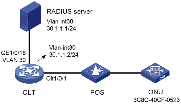

Example: Configuring AGMP on an OLT
As shown in Figure 12, you can remotely manage S1500E series switches in the LAN through AGMP on the OLT.
Configure an IP address for the management interface of the OLT at the CLI. Then, you can use log in to the Web interface of AGMP through this IP address.
Figure 12 Network diagram
1.     Log in to the OLT through the console port on a user PC, and configure the IP address as 172.7.102.106 for the management interface of the OLT.
<OLT> system-view
[OLT] interface m-gigabitethernet 0/0/0
[OLT-M-GigabitEthernet0/0/0] ip address 172.7.102.106 8
[OLT-M-GigabitEthernet0/0/0] quit
2.     Configure VLANs:
# Create VLAN 100 on the OLT.
[OLT] vlan 100
[OLT-vlan100] quit
# Assign OLT 1/0/1 to VLAN 100.
[OLT] interface olt 1/0/1
[OLT-Olt1/0/1] port hybrid vlan 100 tagged
# Create ONU interface ONU 1/0/1:1 on OLT 1/0/1.
[OLT-Olt1/0/1] using onu 1
[OLT-Olt1/0/1] quit
3.     Remotely configure the ONU:
# Configure ONU 1/0/1:1 as a trunk port and assign it to VLAN 100. Configure the PVID of the interface as VLAN 100.
[OLT] interface onu1/0/1:1
[OLT-Onu1/0/1:1] port link-type trunk
[OLT-Onu1/0/1:1] port trunk permit vlan 100
[OLT-Onu1/0/1:1] port trunk pvid vlan 100
# Bind the MAC address of the ONU to the ONU interface on the OLT.
[OLT-Onu1/0/1:1] bind onu-id 586a-b1ea-9215
# Configure the VLAN operation mode of UNI 1 on the ONU as transparent. (The default configuration. You do not need to execute this command.)
[OLT-Onu1/0/1:1] uni 1 vlan-mode transparent
[OLT-Onu1/0/1:1] quit
4.     Enable AGMP on the OLT.
[OLT] ftth
[OLT-ftth] agmp enable
[OLT-ftth] quit
5.     Configure the user and permission for logging in to the Web interface:
# Create a local user named admin, and configure the password, authorized user role, and service types that can be used for the user.
[OLT] local-user admin
[OLT-luser-manage-admin] password simple h3c12345678
[OLT-luser-manage-admin] authorization-attribute user-role network-admin
[OLT-luser-manage-admin] service-type http https
[OLT-luser-manage-admin] service-type ftp
[OLT-luser-manage-admin] quit
# Enable the HTTP and HTTPS services.
[OLT] ip http enable
[OLT] ip https enable
6.     Log in to the Web interface:
a.     Open the browser, and enter IP address 172.7.102.106 in the address bar to enter the Web login interface of the OLT.
b.     Enter the username and password configured previously to log in to the Web interface.

ONU binding configuration example
Network requirements
As shown in Figure 14, bind ONU1 (000f-e200-0031) and ONU2 (000f-e200-3749) to ONU interfaces ONU 3/0/1:1 and ONU 3/0/1:2, respectively.
Figure 14 Network diagram
# Create ONU interfaces ONU 3/0/1:1 and ONU 3/0/1:2.
<OLT> system-view
[OLT] interface olt 3/0/1
[OLT-Olt3/0/1] using onu 1 to 2
[OLT-Olt3/0/1] quit
# Bind ONU1 to ONU 3/0/1:1.
[OLT] interface onu 3/0/1:1
[OLT-Onu3/0/1:1] bind onu-id 000f-e200-0031
[OLT-Onu3/0/1:1] quit
# Bind ONU2 to ONU 3/0/1:2.
[OLT] interface onu 3/0/1:2
[OLT-Onu3/0/1:2] bind onu-id 000f-e200-3749
[OLT-Onu3/0/1:2] quit
# Power on ONU1 and ONU2, and verify that the ONUs have been bound to their respective ONU interface.
<OLT> display onu interface olt 3/0/1
000f-e200-0031                            1       1        Onu1/0/1:1       302
            105/100    Up        N/A
000f-e200-3749                            2       1        Onu1/0/1:2       320
            105/100    Up        N/A
 ---  2 entries found  ---
ONU user authentication configuration example
As shown in Figure 15, configure the OLT to use the RADIUS server to authenticate ONU users accessing the OLT as follows:
·     The shared key for exchanging packets between the OLT and the RADIUS server is expert. The usernames sent to the RADIUS server do not carry domain names.
·     When a user performs authentication, both the username and the password are the MAC address of the ONU (for example, 3C8C-40CF-0523).
Figure 15 Network diagram
1.     Configure interfaces and VLANs as shown in the network diagram. (Details not shown.)
As shown in Figure 16, update the type-A ONU bound to ONU 3/0/1:1 at Site A with the enhanced software version 110.
Figure 16 Network diagram
# Upload the file a110.app to the active and standby MPUs of the OLT. (Details not shown.)
# Update the type-A ONU bound to ONU 3/0/1:1 with the file a110.app.
<OLT> system-view
[OLT-Onu3/0/1:1] update onu filename a110.app
Update flash:/ a110.app?[Y/N]:y
 Info: Download file to onu may take a long time, please wait...
 Please wait while the firmware is being burnt, and check the software version after re-registration!
