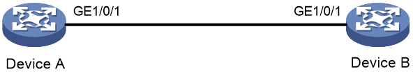

Network synchronization configuration examples
Example: Configuring network synchronization
As shown in Figure 1, Device A obtains its timing signal from an external BITS clock. The MPU on Device A supports network synchronization. GigabitEthernet 1/0/1 on Device B connects to Device A.
Configure Device B to derive its timing from Device A.
Figure 1 Network diagram
# Specify GigabitEthernet1/0/1 as a line clock input port and use it as the clock reference.
<DeviceB> system-view
[DeviceB] network-clock work-mode manual source lpuport gigabitethernet 1/0/1
[DeviceB] quit
# Verify that GigabitEthernet 1/0/1 provides the network clock reference for Device B.
<DeviceB> display network-clock status
Mode                : Manual
Reference          : GE1/0/1
Traced reference  : GE1/0/1
Lock mode          : Locked
OSC state          : Normal
SSM output level  : SSUB
SSM control enable: Off
