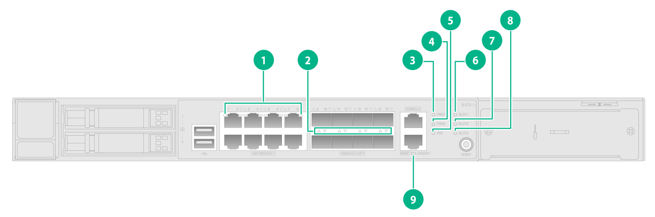

Figure7-1 LEDs
(1) 100/1000BASE-T autosensing Ethernet port LEDs
(2) 1000BASE-X SFP port LED
(3) Power module LED (PWR1)
(4) Power module LED (PWR2)
(5) System status LED (SYS)
(6) Expansion module status LED (SLOT1)
(7) Expansion module status LED (SLOT2)
(8) Expansion module status LED (SLOT3)
(9) 100/1000BASE-T out-of-band management Ethernet port status LED (LINK/ACT)
