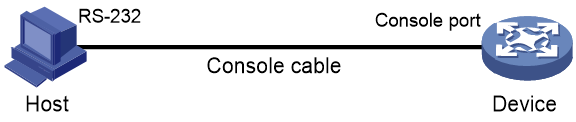

Configure terminal parameters
As shown in Figure3-1, use a terminal emulator program, such as HyperTerminal or PuTTY to connect the configuration terminal to the device.
Figure3-1 Connecting the PC to the device
Configure the terminal parameters as follows:
·     Bits per second—9600.
·     Data bits—8.
·     Stop bits—1.
·     Parity—None.
·     Flow control—None.

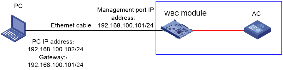

1.     Set up the network environment as shown in the following figure. Configure IP settings to ensure the connectivity between the PC and the front management port on the WBC module.
Figure3-2 Setting up the network environment

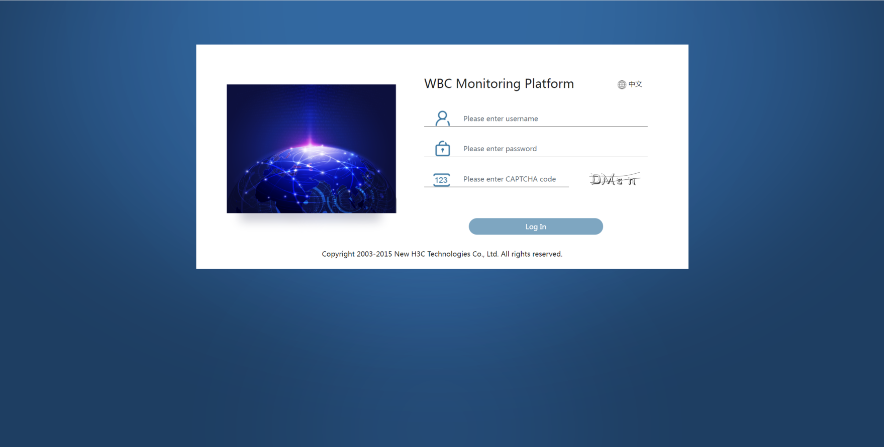

2.     Use an Ethernet cable to connect the PC to the management port on the module. Enter https://x.x.x.x:9999 in a browser to access the WBC monitoring platform login page. x.x.x.x represents the IP address of the management port, which is 192.168.100.101 by default.
Figure3-3 WBC monitoring platform login page
3.     Enter the username, password, and CAPTCHA code. The default username and password are admin and admin.Default.0506, respectively. Then, click the login button.

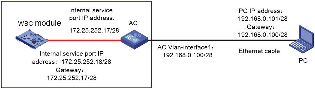

1.     Set up the network environment as shown in the following figure. Configure IP settings to ensure the connectivity between the PC and the internal service port on the WBC module.
·     When you install the module in slot 1 on the rear panel of the AC, the corresponding internal service port is GE1/0/17.
·     When you install the module in slot 2 on the rear panel of the AC, the corresponding internal service port is GE1/0/18.
Figure3-5 Setting up the network environment
2.     Use an Ethernet cable to connect the PC to a Layer 2 Ethernet port on the AC. Configure IP settings for the PC, AC, and WBC module and make sure they have connectivity to each other.

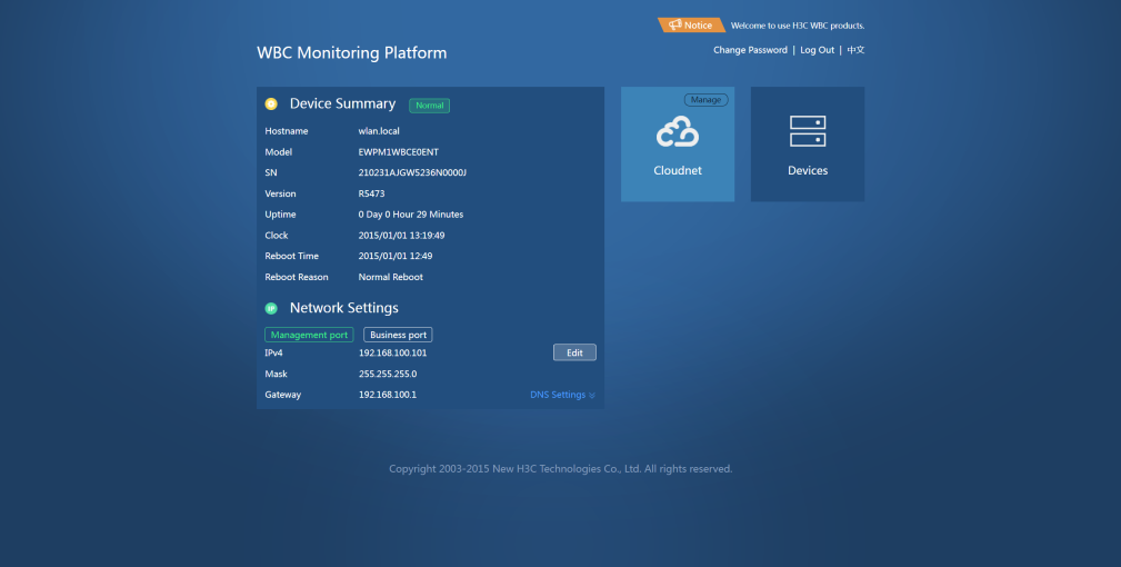

3.     Enter https://x.x.x.x:9999 in the address bar of a browser. x.x.x.x represents the IP address of the service port on the module, which is 172.25.252.18 by default. Enter the username and password on the login page. The default username and password are admin and admin.Default.0506, respectively. Then, click the login button.

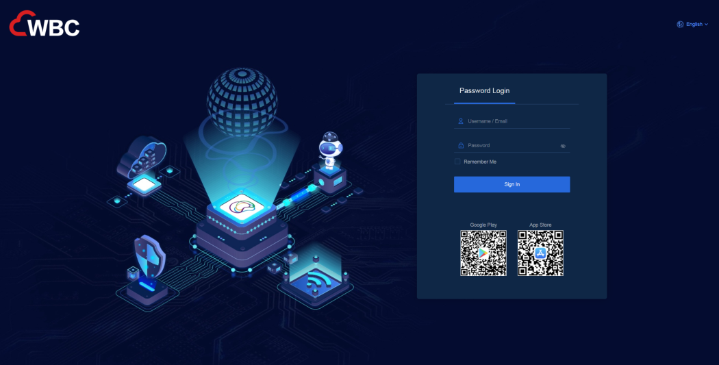

·     Enter https://x.x.x.x:31443 in the address bar of a browser. x.x.x.x represents the IP address of the Cloudnet platform, which is 172.25.252.18 by default.
2.     Enter the username and password, and then click the login button. Both the default username and password are wbcadmin.
Figure3-7 Cloudnet platform login page
