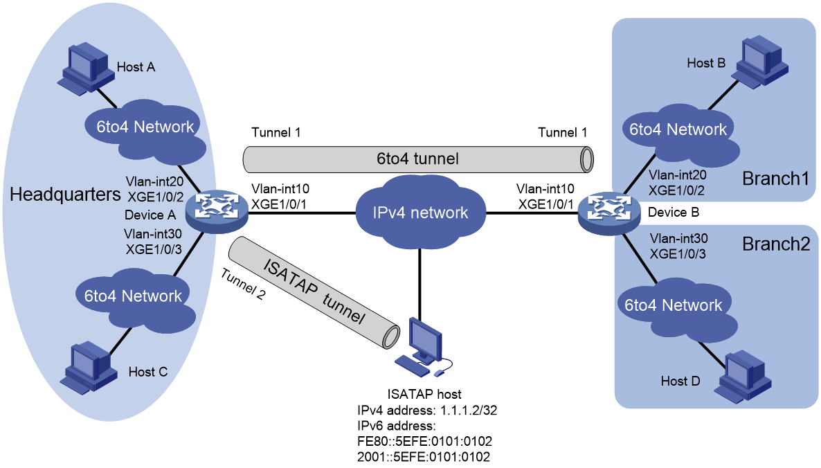

As shown in Figure 1, configure a 6to4 tunnel between Device A and Device B to allow communications between the headquarters and the branches over the IPv4 network.
Configure an ISATAP tunnel between Device A and the ISATAP host to allow the host in the IPv4 network to access the headquarters.
Figure 1 Network diagram
Device
Interface
IP address
Device
Interface
IP address

Make sure Device A and Device B can reach each other through IPv4.
