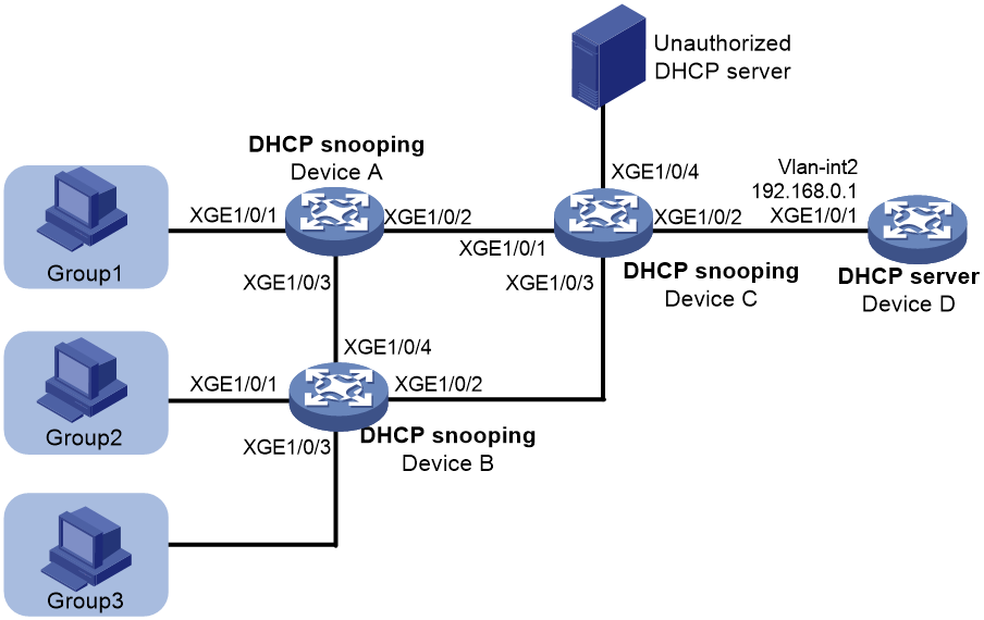

As shown in Figure 1, three groups of hosts are connected to the DHCP server through the DHCP snooping devices. Configure DHCP snooping and DHCP server to meet the following requirements:
·     Hosts in each group obtain IP addresses from the address range assigned to the group. Assign address ranges to the groups as follows:
¡     Address range 192.168.0.2 to 192.168.0.39 for Group 1.
¡     Address range 192.168.0.40 to 192.168.0.99 for Group 2.
¡     Address range 192.168.0.100 to 192.168.0.200 for Group 3.
·     The hosts can obtain IP addresses only from the authorized DHCP server.
·     The hosts cannot access the network through IP addresses that are manually configured.
Figure 1 Network diagram
Analysis
To meet the network requirements, you must perform the following tasks:
·     To make sure the hosts in each group obtain IP addresses from the address range assigned to the group, perform the following tasks:
¡     Configure Option 82 on the DHCP snooping devices.
¡     Create DHCP user classes for the groups and configure match rules based on Option 82 to match the groups on the DHCP server.

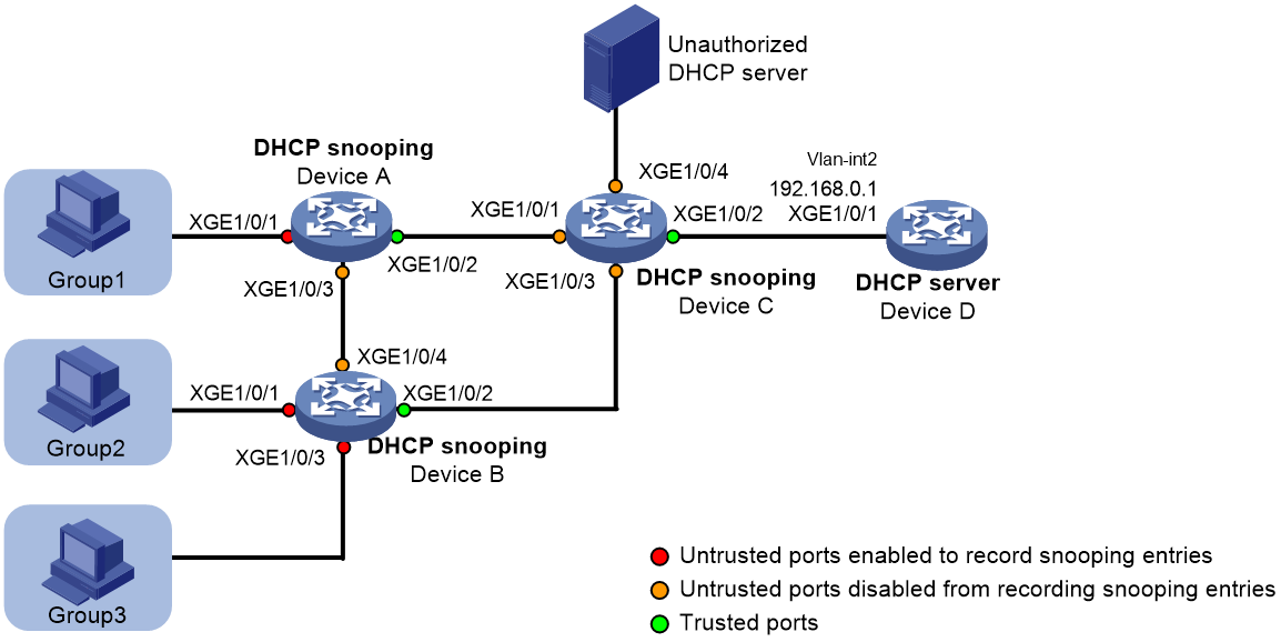

·     To make sure the hosts obtain addresses only from the authorized DHCP server, configure ports facing the server as trusted and other ports as untrusted, as shown in Figure 2.
·     To prevent illegal users from using manually configured IP addresses to access the network, perform the following tasks:
¡     Enable ARP detection in the VLANs where the groups reside to check user validity based on DHCP snooping entries.
¡     Enable recording of client information in DHCP snooping entries. To save system resources, you can enable only untrusted ports directly connected to hosts to record DHCP snooping entries, as shown in Figure 2.
Figure 2 Trusted and untrusted ports
