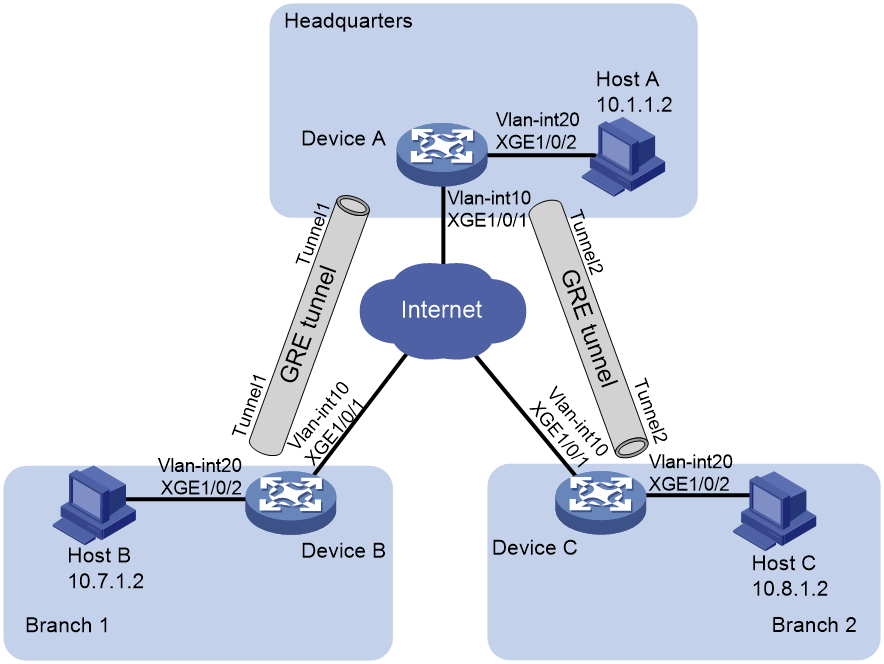

As shown in Figure 1, Device A is the gateway of the headquarters. Device B and Device C are the gateways of Branch 1 and Branch 2, respectively. The gateways have obtained public IP addresses from an ISP and can communicate with one another. Configure GRE with OSPF to meet the following requirements:
·     The headquarters and the branches communicate with one another through the GRE tunnels established between the headquarters and the branches.
·     The gateways learn the routes reaching the destination networks through the tunnel interfaces.
Figure 1 Network diagram
Device
Interface
IP address
Device
Interface
IP address
Device A
Vlan-int10
191.2.1.1/24
Device B
Vlan-int10
191.3.1.1/24
Vlan-int20
10.1.1.1/24
Vlan-int20
10.7.1.1/24
Tunnel1
10.5.1.1/24
Tunnel1
10.5.1.2/24
Tunnel2
10.6.1.1/24
Device C
Vlan-int10
191.4.1.1/24
Vlan-int20
10.8.1.1/24
Tunnel2
10.6.1.2/24
Hardware
Software version
S12500G-AF switch series
Release 7639P01 and later
S10500X switch series
S10500 switch series
S7500E-X switch series
S7500E switch series
S7500X switch series
The device cannot directly route a tunneled packet based on its destination address. The packet must be sent to a tunnel-type service loopback group, which then delivers the packet to the forwarding module for Layer 3 forwarding. Before you configure GRE, you must configure a tunnel-type service loopback group on the device.
