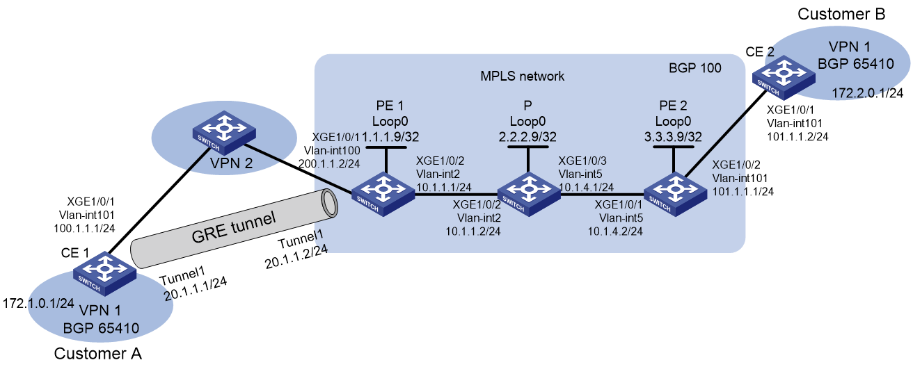

As shown in Figure 1:
·     Customer A and Customer B belong to VPN network vpn1.
·     CE 1 and CE 2 are the edge devices of customer network vpn1.
·     PE 1 and PE 2 are the edge devices of the MPLS network.
·     CE 1 and PE 1 are interconnected through a VPN network named vpn2.
Configure the following settings for Customer A and Customer B to communicate with each other through the MPLS and VPN networks:
·     Set up a point-to-point GRE tunnel between CE 1 and PE 1 and configure static routes for them to reach each other.
·     Configure an IGP routing protocol in the MPLS network to ensure IP connectivity among the PE and P devices. In this example, OSPF is used.
·     Configure LDP in the MPLS network to distribute public network labels (outer labels) of packets from VPN network vpn1.
·     Configure MP-BGP and establish peer relationship between the PEs so that the PEs can advertise private network routing information and distribute private network labels (inner labels).
Figure 1 Network diagram

[PE1-Tunnel1] source vlan-interface 100
# Configure the destination address of the tunnel interface as the IP address of VLAN-interface 101 on CE 1.
[PE1-Tunnel1] destination 100.1.1.1
# Specify the VPN instance to which the tunnel destination belongs.
[PE1-Tunnel1] tunnel vpn-instance vpn1
[PE1-Tunnel1] quit
# Configure a static route from Customer B through tunnel interface Tunnel 1 to Customer A.
[PE1] ip route-static vpn-instance vpn1 172.1.0.0 24 Tunnel 1

Establishing EBGP peer relationship between PEs and CEs and redistributing VPN routes
1.     Configure PE 1:
# Enable BGP instance default, set the local AS number to 100, and enter BGP instance view.
[PE1] bgp 100
# Specify CE 1 as a BGP peer and set its AS number to 65410.
[PE1-bgp-default] ip vpn-instance vpn1
[PE1-bgp-default-vpn1] peer 20.1.1.1 as-number 65410
# Redistribute the direct routes of PE 1 to BGP-VPN IPv4 unicast address family.
[PE1-bgp-default-vpn1] address-family ipv4 unicast
[PE1-bgp-default-ipv4-vpn1] peer 20.1.1.1 enable
[PE1-bgp-default-ipv4-vpn1] import-route direct
[PE1-bgp-default-ipv4-vpn1] quit
[PE1-bgp-default-vpn1] quit
2.     Configure PE 2:
[PE2] bgp 100
# Specify CE 2 as a BGP peer and set its AS number to 65410.
[PE2-bgp-default] ip vpn-instance vpn1
[PE2-bgp-default-vpn1] peer 101.1.1.2 as-number 65410

Establishing MP-IBGP peer relationship between PEs
1.     Configure PE 1:
# Specify PE 2 as a BGP peer and specify Loopback 0 as the source interface for TCP connections to the peer.
[PE1] bgp 100
[PE1-bgp-default] peer 3.3.3.9 as-number 100
[PE1-bgp-default] peer 3.3.3.9 connect-interface loopback 0
# Enter BGP VPNv4 address family view and specify PE 2 as a BGP peer.
[PE1-bgp-default] address-family vpnv4
[PE1-bgp-default-vpnv4] peer 3.3.3.9 enable
[PE1-bgp-default-vpnv4] quit
[PE1-bgp-default] quit
2.     Configure PE 2:
# Specify PE 1 as a BGP peer and specify Loopback 0 as the source interface for TCP connections to the peer.
[PE2] bgp 100
[PE2-bgp-default] peer 1.1.1.9 as-number 100
[PE2-bgp-default] peer 1.1.1.9 connect-interface loopback 0
# Enter BGP VPNv4 address family view and specify PE 1 as a BGP peer.
[PE2-bgp-default] address-family vpnv4
[PE2-bgp-default-vpnv4] peer 1.1.1.9 enable
[PE2-bgp-default-vpnv4] quit
[PE2-bgp-default] quit
3.     Verify that the PEs have established BGP peer relationship.
[PE1] display bgp peer vpnv4
 BGP local router ID: 1.1.1.9
 Local AS number: 100
 Total number of peers: 1                  Peers in established state: 1
  Peer                    AS  MsgRcvd  MsgSent OutQ PrefRcv Up/Down  State
  3.3.3.9                100        8        8    0       0 00:00:08 Established

Configuration files
·     PE 1:
 route-distinguisher 100:1
 vpn-target 100:1 import-extcommunity
 vpn-target 100:1 export-extcommunity
service-loopback group 1 type tunnel
ospf 1
 area 0.0.0.0
  network 1.1.1.9 0.0.0.0
  network 10.1.1.0 0.0.0.255
 mpls lsr-id 1.1.1.9
vlan 2
vlan 100
mpls ldp
interface LoopBack0
 ip address 1.1.1.9 255.255.255.255
interface Vlan-interface2
 mpls enable
 mpls ldp enable
interface Vlan-interface100
 ip binding vpn-instance vpn1
 ip address 200.1.1.2 255.255.255.0
interface Ten-GigabitEthernet1/0/1
 port link-mode bridge
 port access vlan 100
interface Ten-GigabitEthernet1/0/2
 port access vlan 2
interface Ten-GigabitEthernet1/0/3
 port service-loopback group 1
interface Tunnel1 mode gre
 ip address 20.1.1.2 255.255.255.0
 source Vlan-interface100
bgp 100
 peer 3.3.3.9 connect-interface LoopBack0
  peer 3.3.3.9 enable
   import-route direct
 ip route-static vpn-instance vpn1 172.1.0.0 24 Tunnel1
·     P:
ospf 1
 area 0.0.0.0
  network 2.2.2.9 0.0.0.0
  network 10.1.4.0 0.0.0.255
 mpls lsr-id 2.2.2.9
vlan 2
vlan 5
mpls ldp
interface LoopBack0
 ip address 2.2.2.9 255.255.255.255
 ip address 10.1.1.2 255.255.255.0
 mpls enable
 mpls ldp enable
interface Vlan-interface5
 ip address 10.1.4.1 255.255.255.0
 mpls enable
 mpls ldp enable
 port access vlan 2
 port access vlan 5
·     PE 2:
ospf 1
 area 0.0.0.0
  network 3.3.3.9 0.0.0.0
 mpls lsr-id 3.3.3.9
 lldp global enable
vlan 5
vlan 101
mpls ldp
interface LoopBack0
 ip address 3.3.3.9 255.255.255.255
 ip address 10.1.4.2 255.255.255.0
 mpls enable
 mpls ldp enable
interface Vlan-interface101
 ip address 101.1.1.1 255.255.255.0
 port access vlan 5
 port access vlan 101
bgp 100
 peer 1.1.1.9 connect-interface LoopBack0
  peer 1.1.1.9 enable
   import-route direct
   peer 101.1.1.2 enable
·     CE 1:
vlan 101
 ip address 100.1.1.1 255.255.255.0
 ip address 20.1.1.1 255.255.255.0
 source Vlan-interface101
 destination 200.1.1.2
bgp 65410
 peer 20.1.1.2 as-number 100
  import-route direct
  peer 20.1.1.2 enable
 ip route-static vpn-instance vpn1 172.2.0.0 24 Tunnel1
·     CE 2:
vlan 101
 ip address 101.1.1.2 255.255.255.0
bgp 65410
 peer 101.1.1.1 as-number 100
  import-route direct
  peer 101.1.1.1 enable
