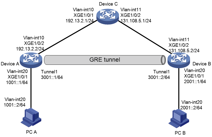

As shown in Figure 1, Device A, Device B, and Device C are all on an IPv4 network. Dual stack devices Device A and Device B each connect to an IPv6 host.
Configure a GRE/IPv4 tunnel between Device A and Device B, so PC A and PC B can communicate with each other over the IPv4 network.
Figure 1 Network diagram
Analysis
To meet the network requirements, perform the following tasks:
·     To enable the IPv6 hosts to communicate over the IPv4 network, specify the GRE tunnel mode as GRE/IPv4 and configure IPv6 addresses for the tunnel interfaces.
·     To transmit packets between PC A and PC B through the GRE tunnel, configure a route reaching the destination network through the tunnel interface on Device A and Device B. You can configure the routes by using either of the following methods:
¡     Configure static routes, using the peer tunnel interface as the next hop or using the local tunnel interface as the outgoing interface.
¡     Enable a dynamic routing protocol on both the tunnel interfaces and the Layer 3 interfaces connected to PC A and PC B.
·     For both ends of the GRE tunnel to reach each other, configure a static route reaching the remote end on Device A and Device B.
