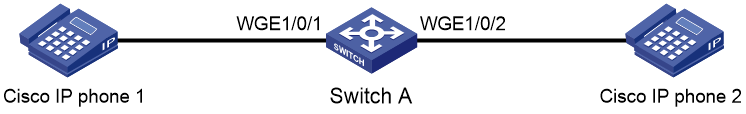

Example: Configuring CDP-compatible LLDP
As shown in Figure 6, Twenty-FiveGigE 1/0/1 and Twenty-FiveGigE 1/0/2 of Switch A are each connected to a Cisco IP phone, which sends tagged voice traffic.
Configure voice VLAN 2 on Switch A. Enable CDP compatibility of LLDP on Switch A to allow the Cisco IP phones to automatically configure the voice VLAN. The voice VLAN feature performs the following operations:
·     Confines the voice traffic to the voice VLAN.
·     Isolates the voice traffic from other types of traffic.
Figure 6 Network diagram
1.     Configure a voice VLAN on Switch A:
# Create VLAN 2.
<SwitchA> system-view
[SwitchA] vlan 2
[SwitchA-vlan2] quit
# Set the link type of Twenty-FiveGigE 1/0/1 and Twenty-FiveGigE 1/0/2 to trunk, and enable voice VLAN on them.
[SwitchA] interface twenty-fivegige 1/0/1
[SwitchA-Twenty-FiveGigE1/0/1] port link-type trunk
[SwitchA-Twenty-FiveGigE1/0/1] voice-vlan 2 enable
[SwitchA-Twenty-FiveGigE1/0/1] quit
[SwitchA] interface twenty-fivegige 1/0/2
[SwitchA-Twenty-FiveGigE1/0/2] port link-type trunk
[SwitchA-Twenty-FiveGigE1/0/2] voice-vlan 2 enable
[SwitchA-Twenty-FiveGigE1/0/2] quit
2.     Configure CDP-compatible LLDP on Switch A:
# Enable LLDP globally, and enable CDP compatibility globally.
[SwitchA] lldp global enable
[SwitchA] lldp compliance cdp
# Enable LLDP on Twenty-FiveGigE 1/0/1. By default, LLDP is enabled on ports.
[SwitchA-Twenty-FiveGigE1/0/1] lldp enable
# Configure LLDP to operate in TxRx mode on Twenty-FiveGigE 1/0/1.
[SwitchA-Twenty-FiveGigE1/0/1] lldp admin-status txrx
# Configure CDP-compatible LLDP to operate in TxRx mode on Twenty-FiveGigE 1/0/1.
[SwitchA-Twenty-FiveGigE1/0/1] lldp compliance admin-status cdp txrx
# Enable LLDP on Twenty-FiveGigE 1/0/2. By default, LLDP is enabled on ports.
[SwitchA-Twenty-FiveGigE1/0/2] lldp enable
# Configure LLDP to operate in TxRx mode on Twenty-FiveGigE 1/0/2.
[SwitchA-Twenty-FiveGigE1/0/2] lldp admin-status txrx
# Configure CDP-compatible LLDP to operate in TxRx mode on Twenty-FiveGigE 1/0/2.
[SwitchA-Twenty-FiveGigE1/0/2] lldp compliance admin-status cdp txrx
# Verify that Switch A has completed the following operations:
·     Discovering the IP phones connected to Twenty-FiveGigE 1/0/1 and Twenty-FiveGigE 1/0/2.
·     Obtaining IP phone information.
[SwitchA] display lldp neighbor-information
CDP neighbor-information of port 1[Twenty-FiveGigE1/0/1]:
LLDP agent nearest-bridge:
 CDP neighbor index  : 1
 Chassis ID          : SEP00141CBCDBFE
 Port ID             : Port 1
CDP neighbor-information of port 2[Twenty-FiveGigE1/0/2]:
 CDP neighbor index  : 2
 Chassis ID          : SEP00141CBCDBFF
 Port ID             : Port 1

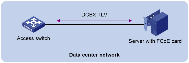

DCBX application scenario
Figure 7 DCBX application scenario
DCBX enables lossless packet transmission on DCE networks.
As shown in Figure 7, DCBX applies to an FCoE-based data center network, and operates on an access switch. DCBX enables the switch to control the server or storage adapter, and simplifies the configuration and guarantees configuration consistency. DCBX extends LLDP by using the IEEE 802.1 organizationally specific TLVs (DCBX TLVs) to transmit DCBX data, including:
·     In DCBX Rev 1.00 and DCBX Rev 1.01:
¡     Application Protocol (APP).
¡     Enhanced Transmission Selection (ETS).
¡     Priority-based Flow Control (PFC).
·     In IEEE Std 802.1Qaz-2011:
¡     ETS Configuration.
¡     ETS Recommendation.
¡     PFC.
¡     APP.
H3C devices can send these types of DCBX information to a server or storage adapter supporting FCoE. However, H3C devices cannot accept these types of DCBX information.

DCBX configuration examples
Example: Configuring DCBX
As shown in Figure 8, Twenty-FiveGigE 1/0/1 of the access switch (Switch A) connects to the FCoE adapter of the data center server (DC server).
Configure Switch A to implement lossless FCoE and FIP frame transmission to DC server.
In this example, both Switch A and the DC server support DCBX Rev 1.01.
Figure 8 Network diagram
1.     Enable LLDP and DCBX TLV advertising:
# Enable LLDP globally.
# Enable LLDP and DCBX TLV advertising on Twenty-FiveGigE 1/0/1.
[SwitchA-Twenty-FiveGigE1/0/1] lldp tlv-enable dot1-tlv dcbx
2.     Set the DCBX version to Rev. 1.01 on Twenty-FiveGigE 1/0/1.
[SwitchA-Twenty-FiveGigE1/0/1] dcbx version rev101
3.     Configure APP parameters:
# Create Layer 2 ACL 4000.
[SwitchA] acl mac 4000
# Configure ACL 4000 to permit FCoE frames (frame type is 0x8906) and FIP frames (frame type is 0x8914) to pass through.
[SwitchA-acl-mac-4000] rule permit type 8906 ffff
[SwitchA-acl-mac-4000] rule permit type 8914 ffff
[SwitchA-acl-mac-4000] quit
# Create a class named app_c, set the operator of the class to OR, and use ACL 4000 as the match criterion of the class.
[SwitchA] traffic classifier app_c operator or
[SwitchA-classifier-app_c] if-match acl mac 4000
[SwitchA-classifier-app_c] quit
# Create a traffic behavior named app_b, and configure the traffic behavior to mark packets with 802.1p priority value 3.
[SwitchA] traffic behavior app_b
[SwitchA-behavior-app_b] remark dot1p 3
[SwitchA-behavior-app_b] quit
# Create a QoS policy named plcy, associate class app_c with traffic behavior app_b in the QoS policy, and apply the association to DCBX.
[SwitchA] qos policy plcy
[SwitchA-qospolicy-plcy] classifier app_c behavior app_b mode dcbx
[SwitchA-qospolicy-plcy] quit
# Apply QoS policy plcy to the outgoing traffic of Twenty-FiveGigE 1/0/1.
[SwitchA-Twenty-FiveGigE1/0/1] qos apply policy plcy outbound
4.     Configure ETS parameters:
# Configure the 802.1p-to-local priority mapping table to map 802.1p priority value 3 to local precedence 3. (This is the default mapping table. You can modify this configuration as needed.)
[SwitchA] qos map-table outbound dot1p-lp
[SwitchA-maptbl-out-dot1p-lp] import 3 export 3
[SwitchA-maptbl-out-dot1p-lp] quit
# Enable byte-count WRR queuing on Twenty-FiveGigE 1/0/1, and configure queue 3 on the interface to use SP queuing.
[SwitchA-Twenty-FiveGigE1/0/1] qos wrr byte-count
[SwitchA-Twenty-FiveGigE1/0/1] qos wrr 3 group sp
5.     Configure PFC:
# Enable PFC in auto mode on Twenty-FiveGigE 1/0/1.
[SwitchA-Twenty-FiveGigE1/0/1] priority-flow-control auto
# Enable PFC for 802.1 priority 3.
[SwitchA-Twenty-FiveGigE1/0/1] priority-flow-control no-drop dot1p 3
# Display the data exchange result on the DC server through the software interface. This example uses the data exchange result for a QLogic adapter on the DC server.

The output shows that the DC server will use SP queuing (priority group ID 15) for 802.1p priority 3.

The output shows that the DC server will use PFC for 802.1p priority 3.
