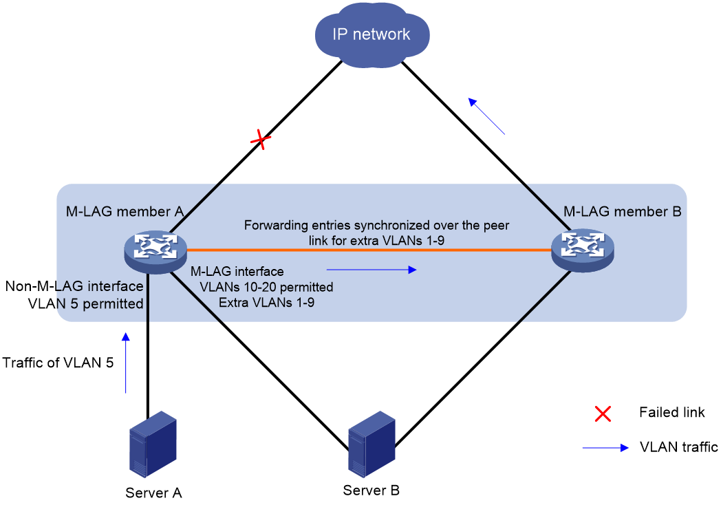

Configuring M-LAG extra VLANs· 38

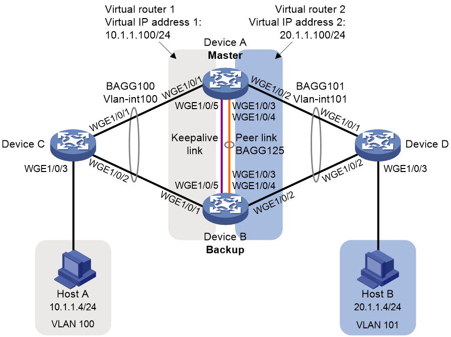

Example: Configuring basic M-LAG functions· 43

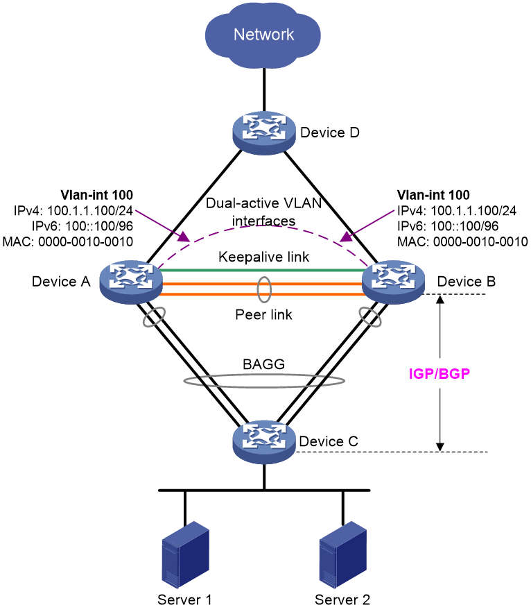

Example: Configuring Layer 3 gateways on an M-LAG system·· 47
Example: Configure dual-active gateways on an M-LAG system·· 57

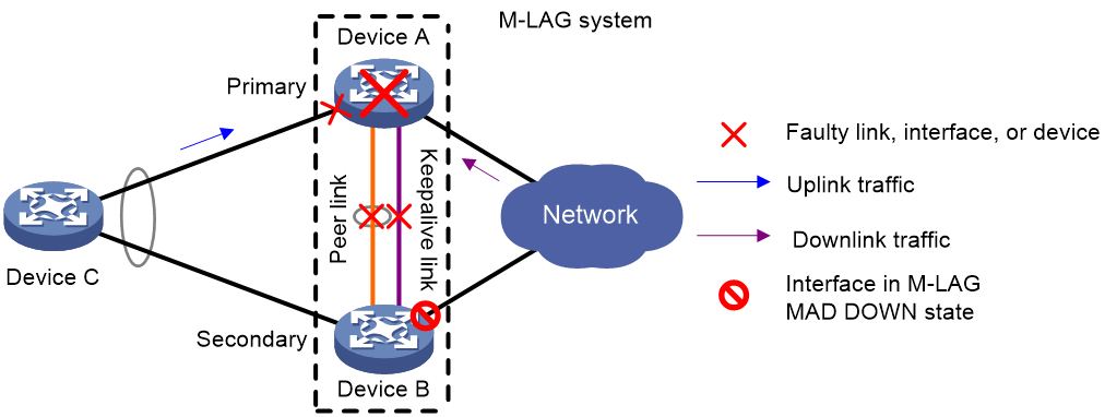

MAD mechanism
M-LAG MAD
A multi-active collision occurs if the peer link goes down while the keepalive link is up. To avoid network issues, M-LAG MAD shuts down all network interfaces on the secondary M-LAG member device except those manually or automatically excluded.
When the peer link comes up, the secondary M-LAG member device starts a delay timer and begins to restore table entries (including MAC address entries and ARP entries) from the primary M-LAG member device. When the delay timer expires, the secondary M-LAG member device brings up all network interfaces placed in M-LAG MAD DOWN state.
M-LAG MAD DOWN state persistence
Both of the M-LAG member devices might take the primary role if both of them have M-LAG interfaces in up state after the following series of events occur:
1.     The peer link goes down while the keepalive link is up. Then, M-LAG MAD shuts down all network interfaces on the secondary M-LAG member device except those excluded from the shutdown action by  M-LAG MAD.
2.     The keepalive link also goes down. Then, the secondary M-LAG member device brings up the network interfaces in M-LAG MAD DOWN state and sets its role to primary.
M-LAG MAD DOWN state persistence helps avoid the forwarding issues that might occur in the multi-active situation that occurs because the keepalive link goes down while the peer link is down.
To prevent packet loss after the peer link recovers from a link fault, the secondary member device should try to synchronize entries (such as the MAC address entries and ARP entries) within the data restoration interval. Subsequently, interfaces in M-LAG MAD DOWN state on the device will restore to up.

Dual-active gateways on an M-LAG system
When a Layer 3 network is dualhomed to an M-LAG system, each M-LAG member device uses a logical interface as the gateway interface for the Layer 3 network. Both logical interfaces are active to perform Layer 3 forwarding, and they use the same IP address and MAC address. When both links to the M-LAG system are operating correctly, the links load share traffic to balance bandwidth usage. When one of the links fails, the M-LAG system switches the traffic on the failed link to the other link to ensure high availability.
Typically, dual-active gateways are deployed if downstream devices run a dynamic routing protocol to communicate with the M-LAG system. As shown in Figure 4, IGP or BGP runs between Device C and the M-LAG system. To configure dual-active VLAN interfaces, perform the following tasks on Device A and Device B:
1.     Create VLAN interfaces for the same VLAN, VLAN-interface 100 for example, assign the same IPv4, IPv6, and MAC addresses to the VLAN interfaces, and assign the M-LAG interfaces to that VLAN.
2.     Assign different M-LAG VIPs to the VLAN interfaces.
Device A and Device B use their M-LAG VIPs to set up IGP or BGP peer relationships with Device C and with each other.
Figure 4 Layer 3 access to an M-LAG system through dynamic routing protocols

Mechanisms to handle concurrent peer link and keepalive link failures
When both the peer link and the keepalive link are down, the M-LAG member devices handle this situation depending on your configuration.
Default failure handling mechanism
Figure 9 shows the default mechanism to handle peer link and keepalive link failures when the M-LAG standalone mode and M-LAG MAD DOWN state persistency features are not configured.
·     If the peer link goes down while the keepalive link is up, the M-LAG member devices negotiate their roles over the keepalive link. M-LAG MAD shuts down all network interfaces on the secondary M-LAG member device except those excluded from the shutdown action by M-LAG MAD.
·     If the keepalive link goes down while the peer link is down, the secondary M-LAG member device sets its role to primary and brings up the network interfaces in M-LAG MAD DOWN state to forward traffic. In this situation, both of the M-LAG member devices might operate with the primary role to forward traffic. Forwarding errors might occur because the M-LAG member devices cannot synchronize MAC address entries over the peer link.
·     If the keepalive link is down before the peer link goes down, M-LAG MAD will not place network interfaces in M-LAG MAD DOWN state. Both M-LAG member devices can operate with the primary role to forward traffic.

Failure handling mechanism with M-LAG standalone mode
Figure 12 shows the mechanism to handle peer link and keepalive link failures when the M-LAG standalone mode feature is configured.
·     If the keepalive link goes down while the peer link is down, both M-LAG member devices change to M-LAG standalone mode. The secondary M-LAG member device sets its role to primary and brings up its network interfaces in M-LAG MAD DOWN state. In M-LAG standalone mode, only the aggregation member ports on one M-LAG member device can become Selected to forward traffic. For more information about how M-LAG standalone mode operates, see "M-LAG standalone mode."
·     If the keepalive link is down before the peer link goes down, both M-LAG member devices change to M-LAG standalone mode.
Figure 12 Failure handling mechanism with M-LAG standalone mode
For VLANs permitted only on non-M-LAG interfaces, the device processes traffic locally and do not synchronize forwarding entries such as MAC and ARP entries with the M-LAG peer device. For the device to synchronize forwarding entries for such VLANs, configure them as extra VLANs. The device will synchronize forwarding entries for the extra VLANs even though they are not permitted on M-LAG interfaces, as shown in Figure 13. When the uplink of one M-LAG member device fails, traffic of the extra VLANs can fail over to the other M-LAG member device through the peer link.
Figure 13 M-LAG extra VLANs
2.     Configure M-LAG extra VLANs.
m-lag extra-vlan vlan-id-list
By default, no M-LAG extra VLANs are configured.
As shown in Figure 15:
·     Configure Device A and Device B as an M-LAG system to establish one multichassis aggregate link with Device C and one with Device D.
·     Set up a keepalive link between Twenty-FiveGigE 1/0/5 of Device A and Twenty-FiveGigE 1/0/5 of Device B, and exclude the interfaces from the shutdown action by M-LAG MAD.
·     Configure two VRRP groups on Device A and Device B to provide gateway services for VLAN 100 and VLAN 200. Configure Device A as the master of the VRRP groups.
Figure 15 Network diagram

[DeviceB-Bridge-Aggregation125] quit
# Assign Twenty-FiveGigE 1/0/3 and Twenty-FiveGigE 1/0/4 to aggregation group 125.
[DeviceB] interface twenty-fivegige 1/0/3
[DeviceB-Twenty-FiveGigE1/0/3] port link-aggregation group 125
[DeviceB-Twenty-FiveGigE1/0/3] quit
[DeviceB] interface twenty-fivegige 1/0/4
[DeviceB-Twenty-FiveGigE1/0/4] port link-aggregation group 125
[DeviceB-Twenty-FiveGigE1/0/4] quit
# Specify Bridge-Aggregation 125 as the peer-link interface.
[DeviceB] interface bridge-aggregation 125
[DeviceB-Bridge-Aggregation125] port m-lag peer-link 1
[DeviceB-Bridge-Aggregation125] undo mac-address static source-check enable
# Create Layer 2 dynamic aggregate interface Bridge-Aggregation 100, and assign it to M-LAG group 1.
[DeviceB] interface bridge-aggregation 100
[DeviceB-Bridge-Aggregation100] link-aggregation mode dynamic
[DeviceB-Bridge-Aggregation100] port m-lag group 1
[DeviceB-Bridge-Aggregation100] quit
# Assign Twenty-FiveGigE 1/0/1 to aggregation group 100.
[DeviceB] interface twenty-fivegige 1/0/1
[DeviceB-Twenty-FiveGigE1/0/1] port link-aggregation group 100
[DeviceB-Twenty-FiveGigE1/0/1] quit
# Create Layer 2 dynamic aggregate interface Bridge-Aggregation 101, and assign it to M-LAG group 2.
[DeviceB] interface bridge-aggregation 101
[DeviceB-Bridge-Aggregation101] link-aggregation mode dynamic
[DeviceB-Bridge-Aggregation101] port m-lag group 2
[DeviceB-Bridge-Aggregation101] quit
# Assign Twenty-FiveGigE 1/0/2 to aggregation group 101.
[DeviceB] interface twenty-fivegige 1/0/2
[DeviceB-Twenty-FiveGigE1/0/2] port link-aggregation group 101
[DeviceB-Twenty-FiveGigE1/0/2] quit
# Create VLAN 100 and VLAN 101.
[DeviceB] vlan 100
[DeviceB-vlan100] quit
[DeviceB] vlan 101
[DeviceB-vlan101] quit
# Set the link type of Bridge-Aggregation 100 to trunk, and assign it to VLAN 100.
[DeviceB-Bridge-Aggregation100] port link-type trunk
[DeviceB-Bridge-Aggregation100] port trunk permit vlan 100
# Set the link type of Bridge-Aggregation 101 to trunk, and assign it to VLAN 101.
[DeviceB-Bridge-Aggregation101] port link-type trunk
[DeviceB-Bridge-Aggregation101] port trunk permit vlan 101
# Create VLAN-interface 100 and VLAN-interface 101, and assign IP addresses to them.
[DeviceB] interface vlan-interface 100
[DeviceB-vlan-interface100] ip address 10.1.1.2 24
[DeviceB-vlan-interface100] quit
[DeviceB] interface vlan-interface 101
[DeviceB-vlan-interface101] ip address 20.1.1.2 24
[DeviceB-vlan-interface101] quit
# Exclude VLAN-interface 100 and VLAN-interface 101 from the shutdown action by M-LAG MAD.
[DeviceB] m-lag mad exclude interface vlan-interface 100
[DeviceB] m-lag mad exclude interface vlan-interface 101
# Configure OSPF.
[DeviceB] ospf
[DeviceB-ospf-1] import-route direct
[DeviceB-ospf-1] area 0
[DeviceB-ospf-1-area-0.0.0.0] network 10.1.1.0 0.0.0.255
[DeviceB-ospf-1-area-0.0.0.0] network 20.1.1.0 0.0.0.255
[DeviceB-ospf-1-area-0.0.0.0] quit
[DeviceB-ospf-1] quit
# Create VRRP group 1 on VLAN-interface 100 and set its virtual IP address to 10.1.1.100.
[DeviceB-Vlan-interface100] vrrp vrid 1 virtual-ip 10.1.1.100
[DeviceB-Vlan-interface100] quit
# Create VRRP group 2 on VLAN-interface 101 and set its virtual IP address to 20.1.1.100.
[DeviceB-Vlan-interface101] vrrp vrid 2 virtual-ip 20.1.1.100
[DeviceB-Vlan-interface101] quit
3.     Configure Device C:
# Create Layer 2 dynamic aggregate interface Bridge-Aggregation 100.
<DeviceC> system-view
[DeviceC] interface bridge-aggregation 100
[DeviceC-Bridge-Aggregation100] link-aggregation mode dynamic
[DeviceC-Bridge-Aggregation100] quit
# Assign Twenty-FiveGigE 1/0/1 and Twenty-FiveGigE 1/0/2 to aggregation group 100.
[DeviceC] interface range twenty-fivegige 1/0/1 to twenty-fivegige 1/0/2
[DeviceC-if-range] port link-aggregation group 100
[DeviceC-if-range] quit
# Create VLAN 100.
[DeviceC] vlan 100
[DeviceC-vlan100] quit
[DeviceC-Bridge-Aggregation100] port link-type trunk
[DeviceC-Bridge-Aggregation100] port trunk permit vlan 100
# Set the link type of Twenty-FiveGigE 1/0/3 to trunk, and assign it to VLAN 100.
[DeviceC] interface twenty-fivegige 1/0/3
[DeviceC-Twenty-FiveGigE1/0/3] port link-type trunk
[DeviceC-Twenty-FiveGigE1/0/3] port trunk permit vlan 100
[DeviceC-Twenty-FiveGigE1/0/3] quit
# Create VLAN-interface 100, and assign it an IP address.
[DeviceC] interface vlan-interface 100
[DeviceC-vlan-interface100] ip address 10.1.1.3 24
[DeviceC-vlan-interface100] quit
# Configure OSPF.
[DeviceC] ospf
[DeviceC-ospf-1] import-route direct
[DeviceC-ospf-1] area 0
[DeviceC-ospf-1-area-0.0.0.0] network 10.1.1.0 0.0.0.255
[DeviceC-ospf-1-area-0.0.0.0] quit
[DeviceC-ospf-1] quit
4.     Configure Device D:
# Create Layer 2 dynamic aggregate interface Bridge-Aggregation 101.
<DeviceD> system-view
[DeviceD] interface bridge-aggregation 101
[DeviceD-Bridge-Aggregation101] link-aggregation mode dynamic
[DeviceD-Bridge-Aggregation101] quit
# Assign Twenty-FiveGigE 1/0/1 and Twenty-FiveGigE 1/0/2 to aggregation group 101.
[DeviceD] interface range twenty-fivegige 1/0/1 to twenty-fivegige 1/0/2
[DeviceD-if-range] port link-aggregation group 101
[DeviceD-if-range] quit
# Create VLAN 101.
[DeviceD] vlan 101
[DeviceD-vlan101] quit
[DeviceD-Bridge-Aggregation101] port link-type trunk
[DeviceD-Bridge-Aggregation101] port trunk permit vlan 101
# Set the link type of Twenty-FiveGigE 1/0/3 to trunk, and assign it to VLAN 101.
[DeviceD] interface twenty-fivegige 1/0/3
[DeviceD-Twenty-FiveGigE1/0/3] port link-type trunk
[DeviceD-Twenty-FiveGigE1/0/3] port trunk permit vlan 101
[DeviceD-Twenty-FiveGigE1/0/3] quit
# Create VLAN-interface 101, and assign it an IP address.
[DeviceD] interface vlan-interface 101
[DeviceD-vlan-interface101] ip address 20.1.1.3 24
[DeviceD-vlan-interface101] quit
# Configure OSPF.
[DeviceD] ospf
[DeviceD-ospf-1] import-route direct
[DeviceD-ospf-1] area 0
[DeviceD-ospf-1-area-0.0.0.0] network 20.1.1.0 0.0.0.255
[DeviceD-ospf-1-area-0.0.0.0] quit
[DeviceD-ospf-1] quit
# Verify that Device A has formed an M-LAG system with Device B.
[DeviceA] display m-lag summary
Flags: A -- Aggregate interface down, B -- No peer M-LAG interface configured
       C -- Configuration consistency check failed
Peer-link interface: BAGG125
Peer-link interface state (cause): UP
Keepalive link state (cause): UP
                     M-LAG interface information
M-LAG IF      M-LAG group  Local state (cause)  Peer state  Remaining down time(s)
BAGG100       1            UP                   UP          -
BAGG101       2            UP                   UP          -
[DeviceA] display m-lag verbose
Flags: A -- Home_Gateway, B -- Neighbor_Gateway, C -- Other_Gateway,
       D -- PeerLink_Activity, E -- DRCP_Timeout, F -- Gateway_Sync,
       G -- Port_Sync, H -- Expired
Peer-link interface/Peer-link interface ID: BAGG125/1
State: UP
Cause: -
Local DRCP flags/Peer DRCP flags: ABDFG/ABDFG
Local Selected ports (index): WGE1/0/3 (260), WGE1/0/4 (261)
Peer Selected ports indexes: 260, 261
M-LAG interface/M-LAG group ID: BAGG100/1
Local M-LAG interface state: UP
Peer M-LAG interface state: UP
M-LAG group state: UP
Local M-LAG interface down cause: -
Remaining M-LAG DOWN time: -
Local M-LAG interface LACP MAC: Config=N/A, Effective=0001-0001-0001
Peer M-LAG interface LACP MAC: Config=N/A, Effective=0001-0001-0001
Local M-LAG interface LACP priority: Config=32768, Effective=123
Peer M-LAG interface LACP priority: Config=32768, Effective=123
Local Selected ports (index): WGE1/0/1 (258)
Peer Selected ports indexes: 258
M-LAG interface/M-LAG group ID: BAGG101/2
Local Selected ports (index): WGE1/0/2 (259)
Peer Selected ports indexes: 259
# Verify that Device C and Device D have correctly set up aggregate links with the M-LAG system.
[DeviceC] display link-aggregation verbose
Loadsharing Type: Shar -- Loadsharing, NonS -- Non-Loadsharing
Port Status: S -- Selected, U -- Unselected, I -- Individual
Port: A -- Auto port, M -- Management port, R -- Reference port
Flags:  A -- LACP_Activity, B -- LACP_Timeout, C -- Aggregation,
        G -- Defaulted, H -- Expired
Aggregate Interface: Bridge-Aggregation100
Creation Mode: Manual
Aggregation Mode: Dynamic
Management VLANs: None
System ID: 0x8000, a03b-0694-0300
Local:
  Port                Status   Priority Index    Oper-Key               Flag
  WGE1/0/1            S        32768    1        1                      {ACDEF}
  WGE1/0/2            S        32768    2        1                      {ACDEF}
Remote:
  Actor               Priority Index    Oper-Key SystemID               Flag
  WGE1/0/1(R)         32768    16386    40001    0x7b  , 0001-0001-0001 {ACDEF}
  WGE1/0/2            32768    32770    40001    0x7b  , 0001-0001-0001 {ACDEF}
[DeviceD] display link-aggregation verbose
Aggregate Interface: Bridge-Aggregation101
System ID: 0x8000, a03b-0d51-0400
Local:
Remote:
  WGE1/0/1(R)         32768    16387    40002    0x7b  , 0001-0001-0001 {ACDEF}
  WGE1/0/2            32768    32771    40002    0x7b  , 0001-0001-0001 {ACDEF}
# Verify that Device A is the master in VRRP group 1 and VRRP group 2.
[DeviceA] display vrrp
IPv4 Virtual Router Information:
 Running mode : Standard
 Total number of virtual routers : 2
 Interface          VRID  State        Running Adver   Auth             Virtual
                                       Pri     Timer   Type             IP
 Vlan100            1     Master       200     100     None             10.1.1.100
 Vlan101            2     Master       200     100     None             20.1.1.100
[DeviceB] display vrrp
                                       Pri     Timer   Type             IP
 Vlan100            1     Backup       100     100     None             10.1.1.100
 Vlan101            2     Backup       100     100     None             20.1.1.100
# Verify that Device C and Device D have established OSPF neighbor relationships with Device A and Device B.
[DeviceC] display ospf peer
         OSPF Process 1 with Router ID 10.1.1.3
               Neighbor Brief Information
 Area: 0.0.0.0
 Router ID       Address         Pri Dead-Time  State             Interface
 20.1.1.1        10.1.1.1        1   37         Full/DR           Vlan100
 20.1.1.2        10.1.1.2        1   32         Full/BDR          Vlan100
[DeviceD] display ospf peer
         OSPF Process 1 with Router ID 20.1.1.3
 Area: 0.0.0.0
 20.1.1.1        20.1.1.1        1   38         Full/DR           Vlan101
 20.1.1.2        20.1.1.2        1   37         Full/BDR          Vlan101
# Verify that Host A and Host B can ping each other. (Details not shown.)
As shown in Figure 16, set up an M-LAG system with Device A and Device B and configure dual-active gateways for the servers on Device A and Device B.
Figure 16 Network diagram
In this example, all devices use the factory default settings. When you apply this configuration example to a live environment, make sure the existing configurations do not conflict with the configurations in this example.
You must configure the same M-LAG system MAC address on the M-LAG member devices in the same M-LAG system. You must assign unique M-LAG system MAC addresses to different M-LAG systems.

3.     Configure a dual-active gateway on Device A after the M-LAG system is set up:
# Create VLAN-interface 102 and assign it an IPv4 address and an IPv6 address for the interface to act as an IPv4 and IPv6 gateway.
[DeviceA] interface vlan-interface 102
[DeviceA-Vlan-interface102] ip address 10.102.0.1 255.255.255.0
[DeviceA-Vlan-interface102] ipv6 address 10:102::1 64
# Assign M-LAG virtual IPv4 and IPv6 addresses to VLAN-interface 102 for Device A to establish OSPF and OSPFv3 neighbor relationships with Device D.
[DeviceA-Vlan-interface102] port m-lag virtual-ip 10.102.0.3 24 active
[DeviceA-Vlan-interface102] port m-lag ipv6 virtual-ip FE80::2 link-local
# Assign a MAC address to VLAN-interface 102.
[DeviceA-Vlan-interface102] mac-address 3-3-3
[DeviceA-Vlan-interface102] quit
# Exclude VLAN-interface 102 from the shutdown action by M-LAG MAD.
[DeviceA] m-lag mad exclude interface vlan-interface 102
# Create VLAN-interface 103 and assign it an IPv4 address and an IPv6 address for the interface to act as an IPv4 and IPv6 gateway.
[DeviceA] interface vlan-interface 103
[DeviceA-Vlan-interface103] ip address 10.103.0.1 24
[DeviceA-Vlan-interface103] ipv6 address 10:103::1 64
# Assign M-LAG virtual IPv4 and IPv6 addresses to VLAN-interface 103 for Device A to establish BGP and BGP4+ peer relationships with Device D.
[DeviceA-Vlan-interface103] port m-lag virtual-ip 10.103.0.3 24 active
[DeviceA-Vlan-interface103] port m-lag ipv6 virtual-ip 10:103::3 64 active
# Assign a MAC address to VLAN-interface 103.
[DeviceA-Vlan-interface103] mac-address 4-4-4
[DeviceA-Vlan-interface103] quit
# Exclude VLAN-interface 103 from the shutdown action by M-LAG MAD.
[DeviceA] m-lag mad exclude interface vlan-interface 103
# Assign an IPv4 address and an IPv6 address to uplink interface Ten-GigabitEthernet 1/0/6.
[DeviceA] interface ten-gigabitethernet 1/0/6
[DeviceA-Ten-GigabitEthernet1/0/6] port link-mode route
[DeviceA-Ten-GigabitEthernet1/0/6] ip address 32.1.1.1 24
[DeviceA-Ten-GigabitEthernet1/0/6] ipv6 address 32:1::1 64
[DeviceA-Ten-GigabitEthernet1/0/6] quit
# Configure OSPF.
[DeviceA] ospf 1 router-id 11.1.1.1
[DeviceA-ospf-1] area 0
[DeviceA-ospf-1-area-0.0.0.0] quit
[DeviceA-ospf-1] quit
[DeviceA-Vlan-interface102] ospf 1 area 0
[DeviceA-Vlan-interface102] ospf peer sub-address enable 10.102.0.3
[DeviceA-Ten-GigabitEthernet1/0/6] ospf 1 area 0
# Configure OSPFv3.
[DeviceA] ospfv3 1
[DeviceA-ospfv3-1] router-id 10.1.1.1
[DeviceA-ospfv3-1] area 0
[DeviceA-ospfv3-1-area-0.0.0.0] quit
[DeviceA-ospfv3-1] quit
[DeviceA-Vlan-interface102] ospfv3 1 area 0
[DeviceA-Ten-GigabitEthernet1/0/6] ospfv3 1 area 0
# Configure BGP.
[DeviceA] bgp 100
[DeviceA-bgp-default] router-id 12.1.1.1
[DeviceA-bgp-default] peer 32.1.1.2 as-number 100
[DeviceA-bgp-default] peer 10.103.0.2 as-number 100
[DeviceA-bgp-default] peer 10.103.0.2 source-address 10.103.0.3
[DeviceA-bgp-default] address-family ipv4
[DeviceA-bgp-default-ipv4] peer 10.103.0.2 enable
[DeviceA-bgp-default-ipv4] network 10.103.0.0  255.255.255.0
[DeviceA-bgp-default-ipv4] peer 32.1.1.2 enable
[DeviceA-bgp-default-ipv4] network 32.1.1.0 255.255.255.0
[DeviceA-bgp-default-ipv4] quit
# Configure BGP4+.
[DeviceA-bgp-default] peer 32:1::2 as-number 100
[DeviceA-bgp-default] peer 10:103::2 as-number 100
[DeviceA-bgp-default] peer 10:103::2 source-address 10:103::3
[DeviceA-bgp-default] address-family ipv6
[DeviceA-bgp-default-ipv6] peer 10:103::2 enable
[DeviceA-bgp-default-ipv6] network 10:103::2  64
[DeviceA-bgp-default-ipv6] peer 32:1::2 enable
[DeviceA-bgp-default-ipv6] network  32:1::2 64
[DeviceA-bgp-default-ipv6] quit
[DeviceA-bgp-default] quit
4.     Configure a dual-active gateway on Device B after the M-LAG system is set up:
# Set the link type of Bridge-Aggregation 3 to trunk, and assign it to VLAN 102 and VLAN 103.
[DeviceB] interface bridge-aggregation 3
[DeviceB-Bridge-Aggregation3] port link-type trunk
[DeviceB-Bridge-Aggregation3] port trunk permit vlan 102 103
[DeviceB-Bridge-Aggregation3] quit
[DeviceB] interface vlan-interface 102
[DeviceB-Vlan-interface102] ip address 10.102.0.1 24
[DeviceB-Vlan-interface102] ipv6 address 10:102::1 64
[DeviceB-Vlan-interface102] port m-lag virtual-ip 10.102.0.4 24 active
[DeviceB-Vlan-interface102] port m-lag ipv6 virtual-ip FE80::4 link-local
[DeviceB-Vlan-interface102] mac-address 3-3-3
[DeviceB-Vlan-interface102] quit
[DeviceB] m-lag mad exclude interface vlan-interface 102
[DeviceB] interface vlan-interface 103
[DeviceB-Vlan-interface103] ip address 10.103.0.1 24
[DeviceB-Vlan-interface103] ipv6 address 10:103::1 64
[DeviceB-Vlan-interface103] port m-lag virtual-ip 10.103.0.4 24 active
[DeviceB-Vlan-interface103] port m-lag ipv6 virtual-ip 10:103::4 64 active
[DeviceB-Vlan-interface103] mac-address 4-4-4
[DeviceB-Vlan-interface103] quit
[DeviceB] m-lag mad exclude interface vlan-interface 103
# Assign an IPv4 address and an IPv6 address to uplink interface Twenty-FiveGigE 1/0/6.
[DeviceB] interface twenty-fivegige 1/0/6
[DeviceB-Twenty-FiveGigE1/0/6] port link-mode route
[DeviceB-Twenty-FiveGigE1/0/6] ip address 33.1.1.1 24
[DeviceB-Twenty-FiveGigE1/0/6] ipv6 address 33:1::1 64
[DeviceB-Twenty-FiveGigE1/0/6] quit
# Configure OSPF.
[DeviceB] ospf 1 router-id 11.1.1.2
[DeviceB-Vlan-interface102] ospf 1 area 0
[DeviceB-Vlan-interface102] ospf peer sub-address enable 10.102.0.4
[DeviceB-Twenty-FiveGigE1/0/6] ospf 1 area 0
# Configure OSPFv3.
[DeviceB] ospfv3 1
[DeviceB-ospfv3-1] router-id 10.1.1.2
[DeviceB-ospfv3-1] area 0
[DeviceB-ospfv3-1-area-0.0.0.0] quit
[DeviceB-ospfv3-1] quit
[DeviceB-Vlan-interface102] ospfv3 1 area 0
[DeviceB-Twenty-FiveGigE1/0/6] ospfv3 1 area 0
# Configure BGP.
[DeviceB] bgp 100
[DeviceB-bgp-default] router-id 12.1.1.2
[DeviceB-bgp-default] peer 33.1.1.2 as-number 100
[DeviceB-bgp-default] peer 10.103.0.2 as-number 100
[DeviceB-bgp-default] peer 10.103.0.2 source-address 10.103.0.4
[DeviceB-bgp-default] address-family ipv4
[DeviceB-bgp-default-ipv4] peer 10.103.0.2 enable
[DeviceB-bgp-default-ipv4] network 10.103.0.0  255.255.255.0
[DeviceB-bgp-default-ipv4] peer 33.1.1.2 enable
[DeviceB-bgp-default-ipv4] network 33.1.1.0 255.255.255.0
[DeviceB-bgp-default-ipv4] quit
# Configure BGP4+.
[DeviceB-bgp-default] peer 33:1::2 as-number 100
[DeviceB-bgp-default] peer 10:103::2 as-number 100
[DeviceB-bgp-default] peer 10:103::2 source-address 10:103::4
[DeviceB-bgp-default] address-family ipv6
[DeviceB-bgp-default-ipv6] peer 10:103::2 enable
[DeviceB-bgp-default-ipv6] network 10:103::2  64
[DeviceB-bgp-default-ipv6] peer 33:1::2 enable
[DeviceB-bgp-default-ipv6] network 33:1::2 64
[DeviceB-bgp-default-ipv6] quit
[DeviceB-bgp-default] quit
