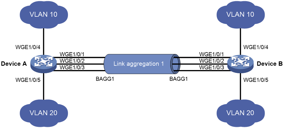

As shown in Figure 1, Device A and Device B are connected by three physical Ethernet links. These physical Ethernet links are combined into an aggregate link called link aggregation 1. The bandwidth of this aggregate link can reach up to the total bandwidth of the three physical Ethernet links. At the same time, the three Ethernet links back up one another. When a physical Ethernet link fails, the traffic transmitted on the failed link is switched to the other two links.
Figure 1 Ethernet link aggregation diagram

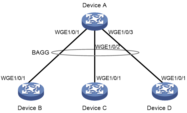

As shown in Figure 3, an interface enabled with automatic assignment joins a dynamic aggregation group based on the peer information in the LACPDUs received from the aggregation peer. If none of the existing dynamic aggregation groups is qualified, the device automatically creates a new dynamic aggregation group, Then, the device assigns the interface to that group and synchronizes the interface's attribute configurations to the aggregate interface.
A dynamic aggregation group that contains automatically assigned member ports selects a reference port and Selected ports as described in "How dynamic link aggregation works." The assignment methods of member ports do not change the processes of reference port selection and Selected port selection.
Figure 3 Automatic member port assignment process

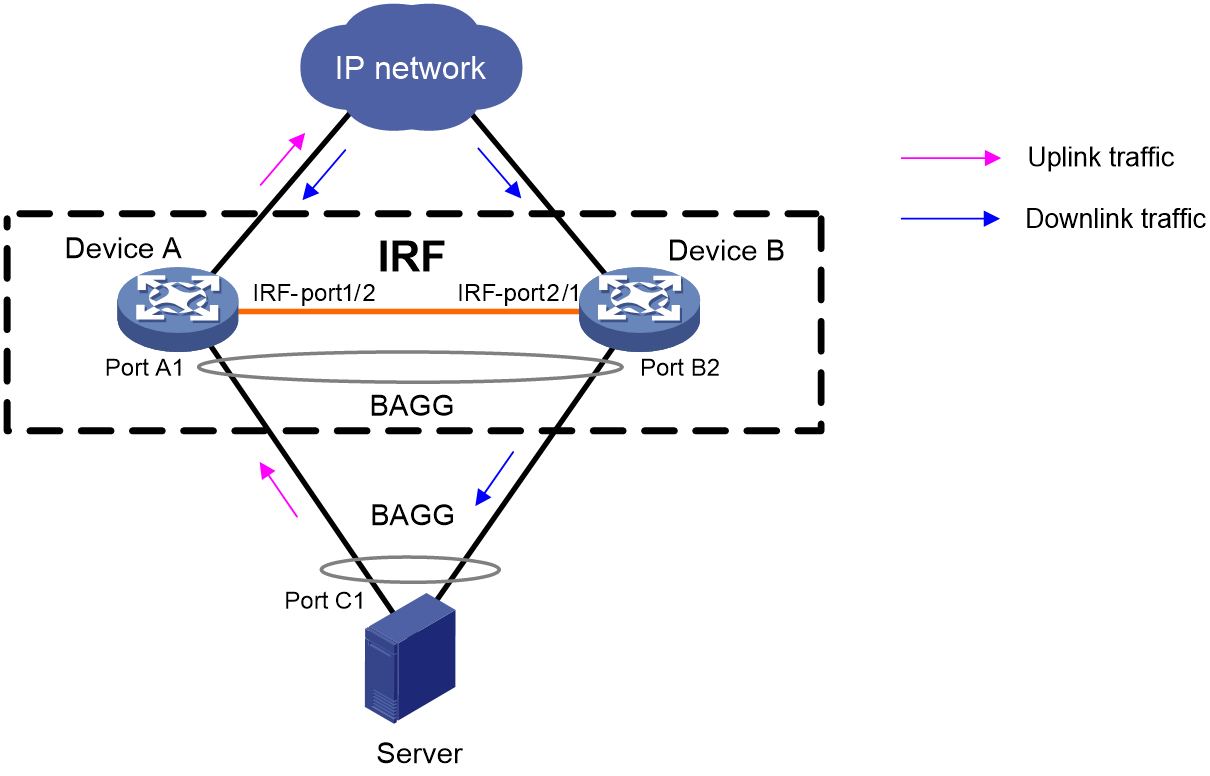

Figure 4 Setting the state of a member port in a dynamic aggregation group
The system with the greater system ID can detect the aggregation state changes on the peer system. The system with the greater system ID sets the aggregation state of local member ports the same as their peer ports.

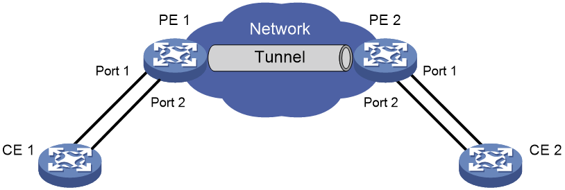

Simple multichassis link aggregation (S-MLAG) enhances dynamic link aggregation to establish an aggregation that spans multiple standalone devices to a remote device.
An S-MLAG multichassis aggregation connects one dynamic Layer 2 aggregate interface on each S-MLAG device to the remote device, as shown in Figure 5.
S-MLAG uses an S-MLAG group to manage the aggregate interfaces for each aggregation, and it runs LACP to maintain each aggregation as does dynamic link aggregation. To the remote device, the S-MLAG devices appear as one peer aggregation system.
Use S-MLAG only to establish aggregate links with servers.
Figure 5 S-MLAG application scenario

Enabling transparent LACPDU transmission
To establish a dynamic aggregation between two remote CEs in an L2VPN network, use transparent LACPDU transmission on the PEs to which the CEs are attached, as shown in Figure 6.
This feature enables the PEs to forward LACPDUs for the CEs to establish a dynamic aggregation.
If this feature is disabled, the PEs terminate the LACPDUs. The remote CEs cannot establish dynamic aggregations.
Figure 6 Application scenario of transparent LACPDU transmission
Perform the following tasks on PEs:
1.     Configure the untagged or default frame match criterion for the Ethernet service instances on the interfaces connected to CEs.
2.     Map the Ethernet service instances to different VSIs and set the access mode to Ethernet for the VSIs.
For more information about L2VPN and Ethernet service instances, see L2VPN configuration in MPLS Configuration Guide.
When you use this feature on the PEs, follow these guidelines:
·     Enable transparent LACPDU transmission on the interfaces that transmit traffic between CEs and PEs and between PEs.
·     Do not use an interface for dynamic link aggregation if you enable transparent LACPDU transmission on that interface. With transparent LACPDU transmission enabled, an interface cannot be selected for aggregation.

By default, tunneled traffic is distributed based on the inner IP header on aggregate links.

Excluding a subnet from load sharing on aggregate links
Typically, an aggregate interface distributes traffic across its Selected member ports. The uplink and downlink traffic of a host might be distributed to different member ports. To make sure the bidirectional traffic of a subnet traverses the same member port, you can exclude that subnet from load sharing by specifying it as a link aggregation management subnet.
As shown in Figure 8, an aggregate link is established between the server and the IRF fabric. The server sends all uplink traffic of a subnet through Port C1 to Port A1 on the IRF fabric. If that subnet is not specified as a management subnet, the IRF fabric distributes its downlink traffic across Port A1 and Port B2. To send the downlink traffic of that subnet to the server only through Port A1, you can specify the subnet as a link aggregation management subnet.
Figure 8 Link aggregation scenario before management subnets are used
When an aggregate interface receives an ARP packet from the management subnet, the device looks up the sender IP address in the ARP table for a matching entry.
·     If no matching entry exists, the device creates an ARP entry on the aggregation member port from which the packet came in. This mechanism ensures that the returned downlink traffic will be forwarded out of the member port that received the uplink traffic.
·     If an ARP entry already exists on a different port than the aggregate interface or its member ports, the device does not update that ARP entry. Instead, the device broadcasts an ARP request out of all ports to relearn the ARP entry.
When an aggregate interface sends an ARP packet to the management subnet, the device sends the packet out of all Selected member ports of the aggregate interface.
You can configure a maximum of 20 management subnets.
To ensure correct packet forwarding, delete all ARP entries of a subnet before you specify it as a management subnet or after you remove it from the management subnet list.
If you are using link aggregation management subnets, do not use the following features:
·     M-LAG. For more information, see Layer 2—LAN Switching Configuration Guide.
·     ARP snooping. For more information, see Layer 3—IP Services Configuration Guide.

Example: Configuring a Layer 2 static aggregation group
On the network shown in Figure 9, perform the following tasks:
·     Configure a Layer 2 static aggregation group on both Device A and Device B.
·     Enable VLAN 10 at one end of the aggregate link to communicate with VLAN 10 at the other end.
·     Enable VLAN 20 at one end of the aggregate link to communicate with VLAN 20 at the other end.
Figure 9 Network diagram
1.     Configure Device A:
# Create VLAN 10, and assign port Twenty-FiveGigE 1/0/4 to VLAN 10.
<DeviceA> system-view
[DeviceA] vlan 10
[DeviceA-vlan10] port twenty-fivegige 1/0/4
[DeviceA-vlan10] quit
# Create VLAN 20, and assign port Twenty-FiveGigE 1/0/5 to VLAN 20.
[DeviceA] vlan 20
[DeviceA-vlan20] port twenty-fivegige 1/0/5
[DeviceA-vlan20] quit
# Create Layer 2 aggregate interface Bridge-Aggregation 1.
[DeviceA] interface bridge-aggregation 1
[DeviceA-Bridge-Aggregation1] quit
# Assign ports Twenty-FiveGigE 1/0/1 through Twenty-FiveGigE 1/0/3 to link aggregation group 1.
[DeviceA] interface twenty-fivegige 1/0/1
[DeviceA-Twenty-FiveGigE1/0/1] port link-aggregation group 1
[DeviceA-Twenty-FiveGigE1/0/1] quit
[DeviceA] interface twenty-fivegige 1/0/2
[DeviceA-Twenty-FiveGigE1/0/2] port link-aggregation group 1
[DeviceA-Twenty-FiveGigE1/0/2] quit
[DeviceA] interface twenty-fivegige 1/0/3
[DeviceA-Twenty-FiveGigE1/0/3] port link-aggregation group 1
[DeviceA-Twenty-FiveGigE1/0/3] quit
# Configure Layer 2 aggregate interface Bridge-Aggregation 1 as a trunk port and assign it to VLANs 10 and 20.
[DeviceA-Bridge-Aggregation1] port link-type trunk
[DeviceA-Bridge-Aggregation1] port trunk permit vlan 10 20
2.     Configure Device B in the same way Device A is configured. (Details not shown.)

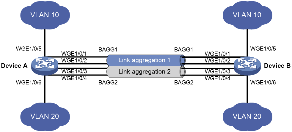

Example: Configuring a Layer 2 dynamic aggregation group
On the network shown in Figure 10, perform the following tasks:
·     Configure a Layer 2 dynamic aggregation group on both Device A and Device B.
Figure 10 Network diagram
# Create VLAN 10, and assign the port Twenty-FiveGigE 1/0/4 to VLAN 10.
[DeviceA] vlan 10
# Create VLAN 20, and assign the port Twenty-FiveGigE 1/0/5 to VLAN 20.
[DeviceA] vlan 20
# Create Layer 2 aggregate interface Bridge-Aggregation 1, and set the link aggregation mode to dynamic.
[DeviceA-Bridge-Aggregation1] link-aggregation mode dynamic
# Display detailed information about all aggregation groups on Device A.
[DeviceA] display link-aggregation verbose
Loadsharing Type: Shar -- Loadsharing, NonS -- Non-Loadsharing
Port Status: S -- Selected, U -- Unselected, I -- Individual
Port: A -- Auto port, M -- Management port, R -- Reference port
Flags:  A -- LACP_Activity, B -- LACP_Timeout, C -- Aggregation,
        G -- Defaulted, H -- Expired
Aggregate Interface: Bridge-Aggregation1
Creation Mode: Manual
Aggregation Mode: Dynamic
Management VLANs: None
System ID: 0x8000, 000f-e267-6c6a
Local:
  Port                Status   Priority Index    Oper-Key               Flag
  WGE1/0/1(R)         S        32768    11       1                      {ACDEF}
  WGE1/0/2            S        32768    12       1                      {ACDEF}
  WGE1/0/3            S        32768    13       1                      {ACDEF}
Remote:
  Actor               Priority Index    Oper-Key SystemID               Flag
  WGE1/0/1            32768    81       1        0x8000, 000f-e267-57ad {ACDEF}
  WGE1/0/2            32768    82       1        0x8000, 000f-e267-57ad {ACDEF}
  WGE1/0/3            32768    83       1        0x8000, 000f-e267-57ad {ACDEF}
The output shows that link aggregation group 1 is a Layer 2 dynamic aggregation group that contains three Selected ports.

On the network shown in Figure 11, perform the following tasks:
·     Configure Layer 2 static aggregation groups 1 and 2 on Device A and Device B, respectively.
·     Configure link aggregation groups 1 and 2 to load share traffic across aggregation group member ports.
¡     Configure link aggregation group 1 to load share packets based on source MAC addresses.
¡     Configure link aggregation group 2 to load share packets based on destination MAC addresses.
Figure 11 Network diagram
# Create VLAN 10, and assign the port Twenty-FiveGigE 1/0/5 to VLAN 10.
[DeviceA] vlan 10
[DeviceA-vlan10] port twenty-fivegige 1/0/5
# Create VLAN 20, and assign the port Twenty-FiveGigE 1/0/6 to VLAN 20.
[DeviceA] vlan 20
[DeviceA-vlan20] port twenty-fivegige 1/0/6
# Configure Layer 2 aggregation group 1 to load share packets based on source MAC addresses.
[DeviceA-Bridge-Aggregation1] link-aggregation load-sharing mode source-mac
# Assign ports Twenty-FiveGigE 1/0/1 and Twenty-FiveGigE 1/0/2 to link aggregation group 1.
# Configure Layer 2 aggregate interface Bridge-Aggregation 1 as a trunk port and assign it to VLAN 10.
# Create Layer 2 aggregate interface Bridge-Aggregation 2.
[DeviceA] interface bridge-aggregation 2
# Configure Layer 2 aggregation group 2 to load share packets based on destination MAC addresses.
[DeviceA-Bridge-Aggregation2] link-aggregation load-sharing mode destination-mac
[DeviceA-Bridge-Aggregation2] quit
# Assign ports Twenty-FiveGigE 1/0/3 and Twenty-FiveGigE 1/0/4 to link aggregation group 2.
[DeviceA-Twenty-FiveGigE1/0/3] port link-aggregation group 2
[DeviceA] interface twenty-fivegige 1/0/4
[DeviceA-Twenty-FiveGigE1/0/4] port link-aggregation group 2
[DeviceA-Twenty-FiveGigE1/0/4] quit
# Configure Layer 2 aggregate interface Bridge-Aggregation 2 as a trunk port and assign it to VLAN 20.
[DeviceA-Bridge-Aggregation2] port link-type trunk
[DeviceA-Bridge-Aggregation2] port trunk permit vlan 20
Aggregation Mode: Static
  Port             Status  Priority Oper-Key
  WGE1/0/2         S       32768    1
Aggregate Interface: Bridge-Aggregation2
  WGE1/0/3(R)      S       32768    2
  WGE1/0/4         S       32768    2
The output shows that:
·     Link aggregation groups 1 and 2 are both load-shared Layer 2 static aggregation groups.
·     Each aggregation group contains two Selected ports.
# Display all the group-specific load sharing modes on Device A.
[DeviceA] display link-aggregation load-sharing mode interface
The dynamic load sharing mode takes effect if it exists.
Route-Aggregation1 load-sharing mode:
Dynamic:
  N/A
Static:
  source-mac address
Route-Aggregation2 load-sharing mode:
Dynamic:
  N/A
Static:
  destination-mac address
·     Link aggregation group 1 distributes packets based on source MAC addresses.
·     Link aggregation group 2 distributes packets based on destination MAC addresses.
