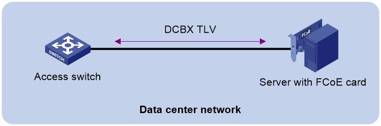

About DCBX· 37
DCBX versions· 37
DCBX functions· 37
DCBX application scenario· 37

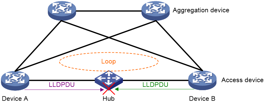

As shown in Figure 5, Device A and Device B are connected through a hub, causing a loop in the network. However, since LLDP packets are point-to-point packets, they are terminated at the next node after being sent from the device. Therefore, the hub acts as a black hole for LLDP packets and LLDP packets cannot be transmitted between Device A and Device B through the HUB. As a result, Device A and Device B cannot use LLDP to learn about the physical link between them and the formed loop, and therefore the loop cannot be eliminated in time. In order to eliminate potential loop risks, it required to detect LLDP packet black holes and block the links leading to the black holes.
Figure 5 LLDP black hole detection application scenario
The LLDP black hole detection feature can detect the presence of LLDP black holes in links on ports. The operating mechanism is as follows:
1.     Triggering the sending of black hole detection packets
The ports enabled with LLDP black hole detection will carry black hole detection TLVs in the transmitted LLDP packets. The black hole detection TLV is a type of TLV defined by H3C. If an LLDP packet carrying the black hole detection TLV is received, it indicates that there is no LLDP black hole between the device and its neighbor, and LLDP packets can be sent and received successfully. Only H3C devices can send and recognize the black hole detection TLV carried in LLDP packets.
After LLDP black hole detection is enabled on a port, the port will activate the LLDP packet receiving timer for black hole detection. If no LLDP packets are received on the port until the timer expires, it indicates a potential LLDP packet black hole in the network, causing the device to not receive LLDP packets. The port then starts sending LLDP black hole detection packets continuously. If the port receives an LLDP packet carrying the black hole detection TLV before the timer expires, the port terminates the timer and takes no further action.
After LLDP black hole detection is enabled, if a port receives an LLDP packet without the black hole detection TLV, the port will start sending LLDP black hole detection packets continuously.
LLDP black hole detection packet is an H3C proprietary Layer 2 packet type. Unlike LLDP packets, LLDP black hole detection packets can be transparently transmitted by a hub and are continuously sent at fixed intervals after being triggered.
The timeout for receiving LLDP packets is configured through the lldp global blackhole-detection rx-lldpdu timeout command. The interval for sending LLDP black hole detection packets is configured through the lldp timer blackhole-detection-interval command or the lldp global timer blackhole-detection-interval command.
2.     Black hole confirmation
After a port starts to send LLDP black hole detection packets, if it receives an LLDP packet carrying the black hole detection TLV, it determines that no LLDP black hole exists between the port and its neighbor, stops sending LLDP black hole detection packets, and resets the LLDP packet receiving timer.
If a port enabled with LLDP black hole detection receives an LLDP black hole detection packet and the LLDP packet receiving timer on this port has timed out, it indicates that the local device and the peer device are connected with a link and both devices have the ability to send LLDP packets. However, neither of the devices has received LLDP packets, and therefore the local device concludes that there is an LLDP black hole between the two ends of the link.
3.     Black hole processing
After detecting an LLDP black hole, the device blocks the port receiving LLDP black hole detection packets to eliminate network loops and prevent the transmission of user data packets. If the blocked port receives no LLDP black hole detection packets within the timeout period specified by the lldp timer rx-blackhole-timeout or lldp global timer rx-blackhole-timeout command, it means that the LLDP black hole is eliminated and the port resumes normal forwarding. Otherwise, it remains blocked.

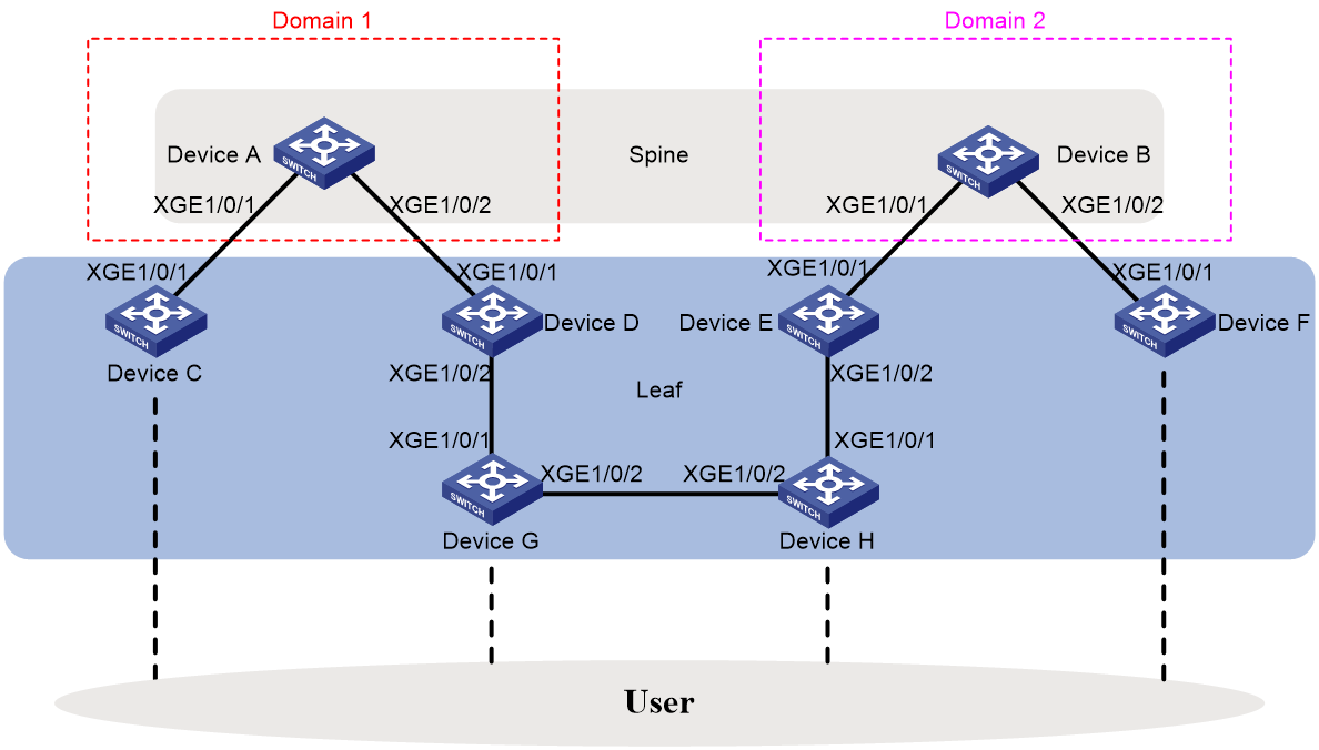

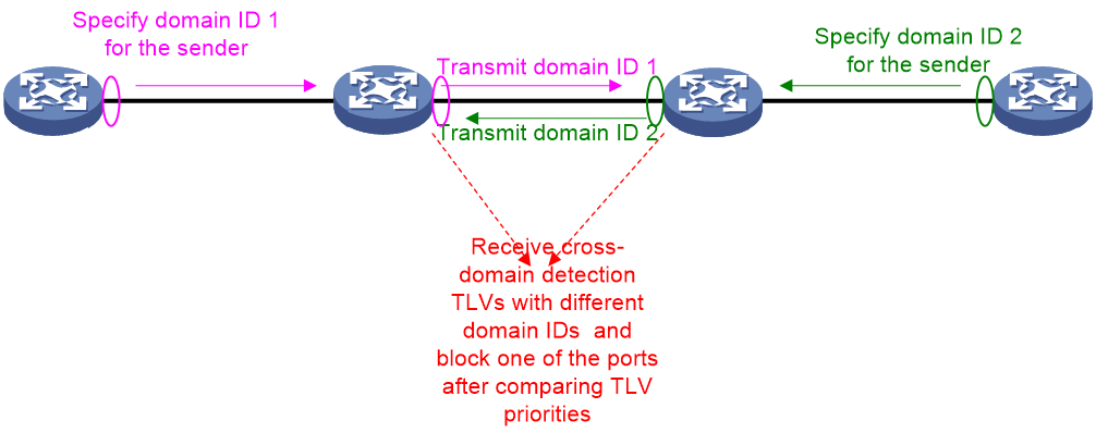

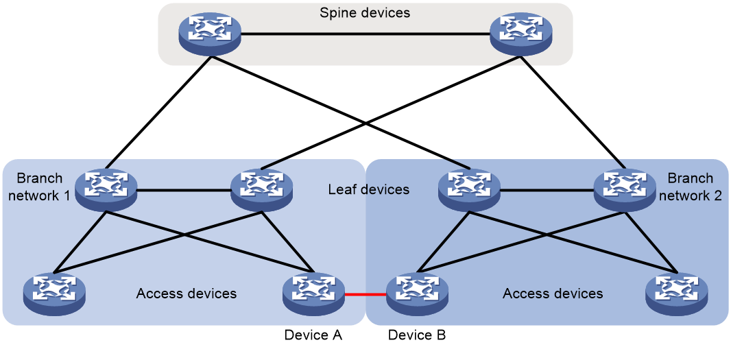

As shown in Figure 6, Device A and Device B belongs to different branch networks. If a link exists between Device A and Device B, a loop might occur in the network. After configuring LLDP cross-domain detection, you can manually assign the devices to different domains, and use LLDP to detect whether the specified LLDP neighbor is in the local domain. In addition, you can block the link to neighbors in other domains to eliminate the potential loop risk.
Figure 6 LLDP cross-domain detection application scenario
The LLDP cross-domain detection feature defines a private type of TLV for LLDP, that is, the cross-domain detection TLV. This TLV is used to advertise the local domain to the LLDP neighbor at the peer end. The LLDP cross-domain detection feature takes effect on a port only after you execute the lldp global cross-domain-detection enable or lldp cross-domain-detection command to enable LLDP cross-domain detection. Then, LLDP packets sent by the device will carry cross-domain detection TLVs.
The domain ID in a cross-domain detection TLV is key information, because it indicates the domain to which the port that sends the cross-domain detection TLV belongs. If you execute the lldp cross-domain-detection domain-id command to specify a domain ID for a port, the cross-domain detection TLVs sent by this port must carry the specified domain ID. If you do not specify a domain ID for a port, the cross-domain detection TLVs sent by this port carry a domain ID in the cross-domain detection TLVs received by the device. If the device has received multiple cross-domain detection TLVs with different domain IDs, it will compare the priorities of these TLVs. When sending a cross-domain detection TLV, the device will carry only the domain ID of the optimal TLV it received, and block ports that receive non-optimal TLVs with different domain IDs. This will help eliminating potential loops in the network, as shown in Figure 7. A blocked port can restore normal forwarding status when LLDP cross-domain detection is disabled or it does not receive any cross-domain detection TLV that carries a different domain ID.
Figure 7 Domain ID transmission
As a best practice, enable LLDP cross-domain detection only on a port of the start device of a domain ID (typically the spine device in a spine-leaf architecture), and do not enable LLDP cross-domain detection globally. If you fail to do so, LLDP cross-domain detection might fail to take effect.
If the domain ID is not configured for LLDP cross-domain detection, or the port is not enabled with the cross-domain detection TLV advertisement capability, the cross-domain detection feature cannot take effect on the port. In this case, the device cannot identify cross-domain detection TLVs carried in LLDP packets or add cross-domain detection TLVs to LLDP packets.

Example: Configuring LLDP cross-domain detection
As shown in Figure 9, in a spine-leaf architecture, Device A, Device C, Device D, and Device G belong to the same branch, and Device B, Device E, Device F, and Device H belong to the other. To prevent loops caused by incorrect wiring between devices, make sure only the devices within the same branch can exchange data. To meet these requirements, configure LLDP cross-domain detection. Assign Device A and its downstream devices to one domain and Device B and its downstream devices to another. Then, the ports that connect different domains will be blocked to prevent data traffic between different branches.
Figure 9 Network diagram

8.     Configure F:
# Enable LLDP globally.
<DeviceF> system-view
[DeviceF] lldp global enable
# Enable LLDP cross-domain detection globally.
[DeviceF] lldp global cross-domain-detection enable
# Enable LLDP on Ten-GigabitEthernet 1/0/1. By default, LLDP is enabled on ports.
[DeviceF] interface ten-gigabitethernet 1/0/1
[DeviceF-Ten-GigabitEthernet1/0/1] lldp enable
[DeviceF-Ten-GigabitEthernet1/0/1] quit
# On Device H, obtain the global LLDP status and LLDP status on all ports.
[DeviceG] display lldp status
Global status of LLDP: Enable
Bridge mode of LLDP: customer-bridge
The current number of LLDP neighbors: 2
The current number of CDP neighbors: 0
LLDP neighbor information last changed time: 0 days, 0 hours, 2 minutes, 28 seconds
Transmit interval              : 30s
Fast transmit interval         : 1s
Transmit max credit            : 5
Hold multiplier                : 4
Reinit delay                   : 2s
Trap interval                  : 30s
Fast start times               : 4
LLDP status information of port 2 [Ten-GigabitEthernet1/0/1]:
LLDP agent nearest-bridge:
Port status of LLDP            : Enable
Admin status                   : TX_RX
Trap flag                      : No
MED trap flag                  : No
Polling interval               : 0s
Number of LLDP neighbors       : 1
Number of MED neighbors        : 0
Number of CDP neighbors        : 0
Number of sent optional TLV    : 12
Number of received unknown TLV : 16
Neighbor protection status     : Port not protected
LLDP agent nearest-nontpmr:
Admin status                   : Disable
Trap flag                      : No
MED trap flag                  : No
Number of LLDP neighbors       : 0
Number of sent optional TLV    : 0
Number of received unknown TLV : 0
LLDP agent nearest-customer:
Trap flag                      : No
MED trap flag                  : No
LLDP status information of port 3 [Ten-GigabitEthernet1/0/2]:
Trap flag                      : No
MED trap flag                  : No
Number of received unknown TLV : 17
Neighbor protection status     : Port blocked (different domain)
Trap flag                      : No
MED trap flag                  : No
Trap flag                      : No
MED trap flag                  : No
Interface Ten-GigabitEthernet 1/0/2 on Device H is blocked by cross-domain detection.
Figure 10 DCBX application scenario
DCBX enables lossless packet transmission on DCE networks.
As shown in Figure 10, DCBX applies to an FCoE-based data center network, and operates on an access switch. DCBX enables the switch to control the server or storage adapter, and simplifies the configuration and guarantees configuration consistency. DCBX extends LLDP by using the IEEE 802.1 organizationally specific TLVs (DCBX TLVs) to transmit DCBX data, including:
·     Priority-based Flow Control (PFC) in DCBX Rev 1.00 and DCBX Rev 1.01.
·     PFC in IEEE Std 802.1Qaz-2011.
H3C devices can send these types of DCBX information to a server or storage adapter. However, H3C devices cannot accept these types of DCBX information.
