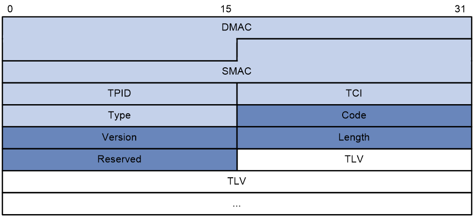

Figure 1 Ethernet frame header for loop detection
The Ethernet frame header of a loop detection packet contains the following fields:
·     DMACDestination MAC address of the frame, which is the multicast MAC address 010f-e200-0007. When a loop detection-enabled device receives a frame with this destination MAC address, it performs the following operations:
¡     Sends the frame to the CPU.
¡     Floods the frame in the VLAN from which the frame was originally received.
·     SMACSource MAC address of the frame, which is the bridge MAC address of the sending device.
·     TPIDType of the VLAN tag, with the value of 0x8100.
·     TCIInformation of the VLAN tag, including the priority and VLAN ID.
·     TypeProtocol type, with the value of 0x8918.
Figure 2 Inner frame header for loop detection
The inner frame header of a loop detection packet contains the following fields:
·     CodeProtocol sub-type, which is 0x0001, indicating the loop detection protocol.
·     VersionProtocol version, which is always 0x0000.
·     LengthLength of the frame. The value includes the inner header, but excludes the Ethernet header.
·     ReservedThis field is reserved.

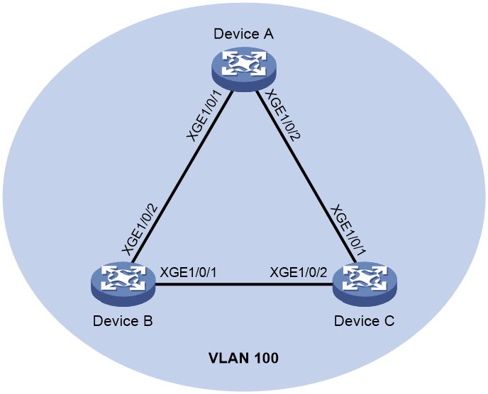

As shown in Figure 3, configure loop detection on Device A to meet the following requirements:
·     Device A generates a log as a notification.
·     Device A automatically shuts down the interface on which a loop is detected.
Figure 3 Network diagram

# Set the global loop protection action to shutdown.
[DeviceA] loopback-detection global action shutdown
# Set the loop detection interval to 35 seconds.
[DeviceA] loopback-detection interval-time 35
2.     Configure Device B:
# Create VLAN 100.
<DeviceB> system-view
[DeviceB] vlan 100
[DeviceB–vlan100] quit
# Configure Ten-GigabitEthernet 1/0/1 and Ten-GigabitEthernet 1/0/2 as trunk ports, and assign them to VLAN 100.
[DeviceB] interface ten-gigabitethernet 1/0/1
[DeviceB-Ten-GigabitEthernet1/0/1] port link-type trunk
[DeviceB-Ten-GigabitEthernet1/0/1] port trunk permit vlan 100
[DeviceB-Ten-GigabitEthernet1/0/1] quit
[DeviceB] interface ten-gigabitethernet 1/0/2
[DeviceB-Ten-GigabitEthernet1/0/2] port link-type trunk
[DeviceB-Ten-GigabitEthernet1/0/2] port trunk permit vlan 100
[DeviceB-Ten-GigabitEthernet1/0/2] quit
3.     Configure Device C:
# Create VLAN 100.
<DeviceC> system-view
[DeviceC] vlan 100
[DeviceC–vlan100] quit
[DeviceC] interface ten-gigabitethernet 1/0/1
[DeviceC-Ten-GigabitEthernet1/0/1] port link-type trunk
[DeviceC-Ten-GigabitEthernet1/0/1] port trunk permit vlan 100
[DeviceC-Ten-GigabitEthernet1/0/1] quit
[DeviceC] interface ten-gigabitethernet 1/0/2
[DeviceC-Ten-GigabitEthernet1/0/2] port link-type trunk
[DeviceC-Ten-GigabitEthernet1/0/2] port trunk permit vlan 100
[DeviceC-Ten-GigabitEthernet1/0/2] quit
# View the system logs on devices, for example, Device A.
[DeviceA]
%Feb 24 15:04:29:663 2019 DeviceA LPDT/4/LPDT_LOOPED:  A loop was detected on Ten-GigabitEthernet1/0/1.
%Feb 24 15:04:29:664 2019 DeviceA LPDT/4/LPDT_VLAN_LOOPED: A loop was detected on Ten-GigabitEthernet1/0/1 in VLAN 100.
%Feb 24 15:04:29:667 2019 DeviceA LPDT/4/LPDT_LOOPED: A loop was detected on Ten-GigabitEthernet1/0/2.
%Feb 24 15:04:29:668 2019 DeviceA LPDT/4/LPDT_VLAN_LOOPED: A loop was detected on Ten-GigabitEthernet1/0/2 in VLAN 100.
%Feb 24 15:04:44:243 2019 DeviceA LPDT/5/LPDT_VLAN_RECOVERED: A loop was removed on Ten-GigabitEthernet1/0/1 in VLAN 100.
%Feb 24 15:04:44:243 2019 DeviceA LPDT/5/LPDT_RECOVERED: All loops were removed on Ten-GigabitEthernet1/0/1.
%Feb 24 15:04:44:248 2019 DeviceA LPDT/5/LPDT_VLAN_RECOVERED: A loop was removed on Ten-GigabitEthernet1/0/2 in VLAN 100.
%Feb 24 15:04:44:248 2019 DeviceA LPDT/5/LPDT_RECOVERED: All loops were removed on Ten-GigabitEthernet1/0/2.
The output shows the following information:
·     Device A detected loops on Ten-GigabitEthernet 1/0/1 and Ten-GigabitEthernet 1/0/2 within a loop detection interval.
·     Loops on Ten-GigabitEthernet 1/0/1 and Ten-GigabitEthernet 1/0/2 were removed.
# Use the display loopback-detection command to display the loop detection configuration and status on devices, for example, Device A.
[DeviceA] display loopback-detection
Loop detection is enabled.
Global loop detection interval is 35 second(s).
Loop is detected on following interfaces:
  Interface                      Action mode     VLANs/VSI
 Ten-GigabitEthernet1/0/1       Shutdown        100
 Ten-GigabitEthernet1/0/2       Shutdown        100
The output shows that the device has removed the loops from Ten-GigabitEthernet 1/0/1 and Ten-GigabitEthernet 1/0/2 according to the shutdown action.
# Display the status of Ten-GigabitEthernet 1/0/1 on devices, for example, Device A.
[DeviceA] display interface ten-gigabitethernet 1/0/1
Ten-GigabitEthernet1/0/1 current state: DOWN (Loop detection down)
The output shows that Ten-GigabitEthernet 1/0/1 is already shut down by the loop detection module.
# Display the status of Ten-GigabitEthernet 1/0/2 on devices, for example, Device A.
[DeviceA] display interface ten-gigabitethernet 1/0/2
Ten-GigabitEthernet1/0/2 current state: DOWN (Loop detection down)
The output shows that Ten-GigabitEthernet 1/0/2 is already shut down by the loop detection module.

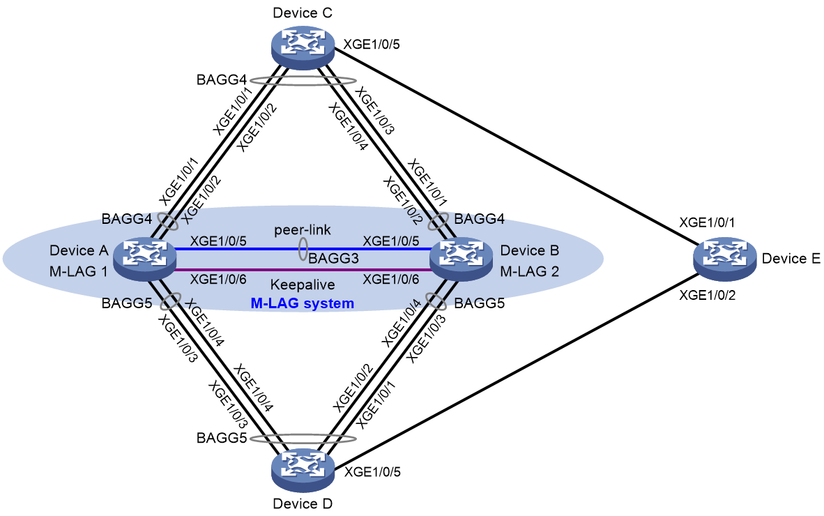

Example: Configuring loop detection on an M-LAG system
As shown in Figure 5, configure loop detection on the M-LAG system formed by Device A and Device B to meet the following requirements:
·     Generates a log as a notification.
·     Automatically shuts down the interface on which a loop is detected.
Figure 5 Network diagram
1.     Configure Device A:
# Create VLAN 100.
<DeviceA> system-view
[DeviceA] vlan 100
[DeviceA-vlan100] quit
# Configure M-LAG system settings.
[DeviceA] m-lag system-mac 1-1-1
[DeviceA] m-lag system-number 1
[DeviceA] m-lag system-priority 123
# Configure M-LAG keepalive packet parameters.
[DeviceA] m-lag keepalive ip destination 1.1.1.1 source 1.1.1.2
# Set the link mode of Ten-GigabitEthernet 1/0/6 to Layer 3, and assign the interface an IP address. The IP address will be used as the source IP address of keepalive packets.
[DeviceA] interface ten-gigabitethernet 1/0/6
[DeviceA-Ten-GigabitEthernet1/0/6] port link-mode route
[DeviceA-Ten-GigabitEthernet1/0/6] ip address 1.1.1.2 24
[DeviceA-Ten-GigabitEthernet1/0/6] quit
# Exclude the interface used for M-LAG keepalive detection (Ten-GigabitEthernet 1/0/6) from the shutdown action by M-LAG MAD.
[DeviceA] drni m-lag exclude interface ten-gigabitethernet 1/0/6
# Create Layer 2 dynamic aggregate interface Bridge-Aggregation 3, and specify it as the M-LAG peer-link interface.
[DeviceA] interface bridge-aggregation 3
[DeviceA-Bridge-Aggregation3] link-aggregation mode dynamic
[DeviceA-Bridge-Aggregation3] port m-lag peer-link 1
[DeviceA-Bridge-Aggregation3] quit
# Assign Ten-GigabitEthernet 1/0/5 to aggregation group 3.
[DeviceA] interface ten-gigabitethernet 1/0/5
[DeviceA-Ten-GigabitEthernet1/0/5] port link-aggregation group 3
[DeviceA-Ten-GigabitEthernet1/0/5] quit
# Set the link type of Bridge-Aggregation 3 to trunk, and assign it to VLAN 100.
[DeviceA-Bridge-Aggregation3] port link-type trunk
[DeviceA-Bridge-Aggregation3] port trunk permit vlan 100
# Create Layer 2 dynamic aggregate interface Bridge-Aggregation 4, and assign it to M-LAG group 4.
[DeviceA] interface bridge-aggregation 4
[DeviceA-Bridge-Aggregation4] link-aggregation mode dynamic
[DeviceA-Bridge-Aggregation4] port m-lag group 4
[DeviceA-Bridge-Aggregation4] quit
# Assign Ten-GigabitEthernet 1/0/1 and Ten-GigabitEthernet 1/0/2 to aggregation group 4.
[DeviceA] interface ten-gigabitethernet 1/0/1
[DeviceA-Ten-GigabitEthernet1/0/1] port link-aggregation group 4
[DeviceA-Ten-GigabitEthernet1/0/1] quit
[DeviceA] interface ten-gigabitethernet 1/0/2
[DeviceA-Ten-GigabitEthernet1/0/2] port link-aggregation group 4
[DeviceA-Ten-GigabitEthernet1/0/2] quit
# Set the link type of Bridge-Aggregation 4 to trunk, and assign it to VLAN 100.
[DeviceA-Bridge-Aggregation4] port link-type trunk
[DeviceA-Bridge-Aggregation4] port trunk permit vlan 100
# Create Layer 2 dynamic aggregate interface Bridge-Aggregation 5, and assign it to M-LAG group 5.
[DeviceA] interface bridge-aggregation 5
[DeviceA-Bridge-Aggregation5] link-aggregation mode dynamic
[DeviceA-Bridge-Aggregation5] port m-lag group 5
[DeviceA-Bridge-Aggregation5] quit
# Assign Ten-GigabitEthernet 1/0/3 and Ten-GigabitEthernet 1/0/4 to aggregation group 5.
[DeviceA] interface ten-gigabitethernet 1/0/3
[DeviceA-Ten-GigabitEthernet1/0/3] port link-aggregation group 5
[DeviceA-Ten-GigabitEthernet1/0/3] quit
[DeviceA] interface ten-gigabitethernet 1/0/4
[DeviceA-Ten-GigabitEthernet1/0/4] port link-aggregation group 5
[DeviceA-Ten-GigabitEthernet1/0/4] quit
# Set the link type of Bridge-Aggregation 5 to trunk, and assign it to VLAN 100.
[DeviceA-Bridge-Aggregation5] port link-type trunk
[DeviceA-Bridge-Aggregation5] port trunk permit vlan 100
# Disable the spanning tree feature.
[DeviceA] undo stp global enable
# Enable loop detection for VLAN 100 globally, set the global loop protection action to shutdown, and set the loop detection interval to 35 seconds.
[DeviceA] loopback-detection global enable vlan 100
2.     Configure Device B in the same way Device A is configured. Set the M-LAG system number to 2, and set the source and destination IP addresses of keepalive packets to 1.1.1.1 and 1.1.1.2, respectively. (Details not shown.)
[DeviceC] undo stp global enable
# Create VLAN 100.
[DeviceC] vlan 100
[DeviceC-vlan100] quit
# Create Layer 2 dynamic aggregate interface Bridge-Aggregation 4.
[DeviceC] interface bridge-aggregation 4
[DeviceC-Bridge-Aggregation4] link-aggregation mode dynamic
[DeviceC-Bridge-Aggregation4] quit
# Assign Ten-GigabitEthernet 1/0/1 through Ten-GigabitEthernet 1/0/4 to aggregation group 4.
[DeviceC] interface range ten-gigabitethernet 1/0/1 to ten-gigabitethernet 1/0/4
[DeviceC-if-range] port link-aggregation group 4
[DeviceC-if-range] quit
[DeviceC-Bridge-Aggregation4] port link-type trunk
[DeviceC-Bridge-Aggregation4] port trunk permit vlan 100
# Set the link type of Ten-GigabitEthernet 1/0/5 to trunk, and assign it to VLAN 100.
[DeviceC] interface ten-gigabitethernet 1/0/5
[DeviceC-Ten-GigabitEthernet1/0/5] port link-type trunk
[DeviceC-Ten-GigabitEthernet1/0/5] port trunk permit vlan 100
[DeviceC-Ten-GigabitEthernet1/0/5] quit
4.     Configure Device D:
<DeviceD> system-view
[DeviceD] undo stp global enable
# Create VLAN 100.
[DeviceD] vlan 100
[DeviceD-vlan100] quit
# Create Layer 2 dynamic aggregate interface Bridge-Aggregation 5.

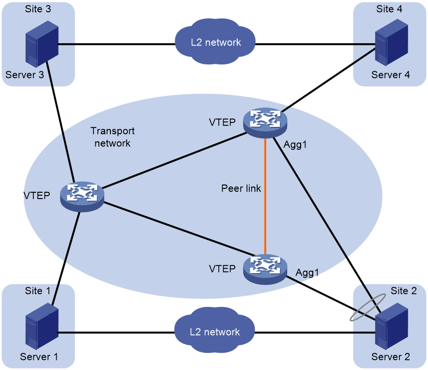

Application scenario
As shown in Figure 6, two VTEPs provide data transmission services for site 1 and site 2. Because the sites also have Layer 2 connectivity, broadcast storms can spread across the sites.
To remove loops from the VXLAN network, configure loop detection on the VTEPs. When a VTEP detects a loop on an AC, it performs one of the following actions to remove the loop:
·     Blocks the AC.
·     Disables the site-facing interface on one of the VTEPs.

Loop detection frame format
As shown in Figure 7, a loop detection frame contains the Ethernet header, loop detection header, and loop detection TLVs.
Figure 7 Loop detection frame format
The Ethernet frame header of a loop detection frame contains the following fields:
·     DMAC—Destination MAC address of the frame, which is the multicast MAC address 010f-e200-0007. When a loop detection-enabled device receives a frame with this destination MAC address, it performs the following operations:
¡     Floods the frame in the VLAN from which the frame was received.
·     SMAC—Source MAC address of the frame, which is the bridge MAC address of the sending device.
·     TPID—Type of the VLAN tag, with the default value of 0x8100.
·     TCI—Tag control information, including the priority and VLAN ID.
·     Type—Protocol type, with the value of 0x8918.
The loop detection header of a loop detection frame contains the following fields:
·     Code—Protocol sub-type, which is 0x0001, indicating the loop detection type.
·     Version—Protocol version, which is reserved. This field is fixed at 0x0000.
·     Length—Length of the frame. The value includes the loop detection header, but excludes the Ethernet header.
·     Reserved—This field is reserved.
Payload of a loop detection frame is encapsulated as TLV triplets.

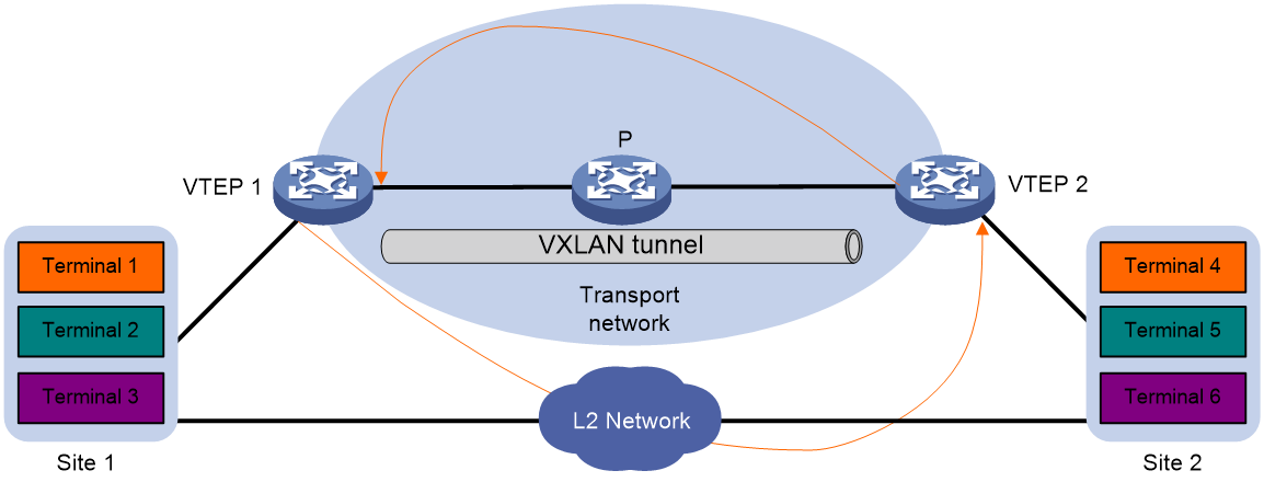

Loop detection mechanisms
After you enable loop detection on a VSI, its ACs keep sending loop detection frames and detecting incoming loop detection frames at the same time. If an AC receives a loop detection frame that carries a VXLAN ID the same as the AC's VXLAN ID, the device determines that a loop exists on the AC. Then, the AC compares its own loop detection priority with that in the frame. If the loop detection priority in the frame is higher, the loop protection action is triggered. If the loop detection priority of the AC is higher, the system only records the loop information.
The ACs of a loop detection-enabled VSI send loop detection frames to detect loops in the attached sites. If the device receives a loop detection frame on a VXLAN tunnel interface and the VXLAN ID in the frame matches the local one, it determines that a loop exists on the traffic outgoing AC.
Loop detection is a continuous process as the network changes. Loop detection frames are sent at the loop detection interval to determine whether loops occur on ACs and whether loops are removed.
Loop detection actions
When the device detects a loop on an AC, it generates a log but performs no action on the interface by default. You can configure the device to take one of the following actions:
·     Block—If a loop is detected on an AC whose loop detection priority is lower than that in received loop detection frames, the device generates a log, disables the interface from learning MAC addresses, and blocks the interface.
·     Shutdown—If a loop is detected on an AC whose loop detection priority is lower than that in received loop detection frames, the device generates a log, and shuts down the interface where the AC resides to disable it from receiving and sending any frames.
AC status auto recovery
When the device configured with the shutdown or block action detects a loop on an AC, it performs the action and waits three loop detection intervals. If the device does not receive a loop detection frame within three loop detection intervals, it performs the following operations:
·     Automatically sets the interface to the forwarding state.
·     Notifies the user of the event.
When the device configured with the shutdown action detects a loop on an AC, the following events occur:
1.     The device automatically shuts down the interface where the AC is configured.
2.     The device automatically sets the AC to the forwarding state after the detection timer set by using the shutdown-interval command expires. For more information about the shutdown-interval command, see Fundamentals Command Reference.
3.     The device shuts down the AC again if a loop is still detected on the interface.
This process is repeated until the loop is removed.
Loop detection in a VXLAN network with M-LAG configured
In a VXLAN network, M-LAG can virtualize two VTEPs into an M-LAG system that connects to the remote aggregation system through a multichassis aggregate link. To the remote aggregation system, the M-LAG system is one device. This prevents single points of failure from interrupting traffic forwarding and ensures high availability of the VXLAN network. For more information about M-LAG, see "Configuring M-LAG."
Figure 8 Network diagram
As shown in Figure 8, if an endpoint is dualhomed to the M-LAG system, you must enable loop detection on both VTEPs in the M-LAG system. Loop detection works as follows on the VTEPs:
1.     The VTEPs send loop detection frames out of the ACs configured on the M-LAG interfaces facing the endpoint. The loop detection frames contain the same source MAC address, VLAN tag, loop detection interval, and loop detection priority. The source MAC address is the M-LAG system MAC address.
2.     When receiving loop detection frames on a local M-LAG interface, a VTEP sends the loop detection frames to the peer VTEP over the peer link. This synchronization mechanism ensures that a VTEP can receive loop detection frames in case of link or interface failure.
3.     If a VTEP receives a self-sent loop detection frame from an AC, the VTEP compares the loop detection priority of the AC with that in the frame and acts as follows:
¡     If the loop detection priority in the frame is higher, the VTEP performs the loop protection action on all ACs configured for the M-LAG group that accommodates the looped M-LAG interface.
¡     If the loop detection priority of the AC is higher, the system only records the loop information.
If an endpoint is singlehomed to one VTEP in the M-LAG system, enable loop detection only on that VTEP. Loop detection works as follows on the VTEP:
1.     The VTEP sends loop detection frames out of the ACs configured on the M-LAG interface facing the endpoint. The source MAC address is the M-LAG system MAC address.
2.     If the VTEP receives a self-sent loop detection frame from an AC, the VTEP compares the loop detection priority of the AC with that in the frame and acts as follows:
¡     If the loop detection priority in the frame is higher, the VTEP performs the loop protection action on the looped AC.

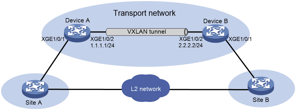

Example: Configuring local site loop detection
As shown in Figure 9, Device A and Device B provide user traffic transmission service for site 1 and site 2, and the sites have Layer 2 connectivity in VLAN 10. Configure loop detection on Device A and Device B so that they can block ACs if loops exist.
Figure 9 Network diagram
Configure a routing protocol in the VXLAN for the VTEPs to reach one another.
# Create VXLAN 1 and assign it a VXLAN tunnel. Map VSI vsi 1 to VXLAN 1.
[DeviceA] l2vpn enable
[DeviceA] interface tunnel 10 mode vxlan
[DeviceA-Tunnel10] source 1.1.1.1
[DeviceA-Tunnel10] destination 2.2.2.2
[DeviceA-Tunnel10] quit
[DeviceA] vsi 1
[DeviceA-vsi-1] vxlan 1
[DeviceA-vsi-1-vxlan-1] tunnel 10
[DeviceA-vsi-1-vxlan-1] quit
# Disable spanning tree globally.
# Configure an AC and map it to VSI vsi 1.
[DeviceA-Ten-GigabitEthernet1/0/1] service-instance 1
[DeviceA-Ten-GigabitEthernet1/0/1-srv1] encapsulation s-vid 10
[DeviceA-Ten-GigabitEthernet1/0/1-srv1] xconnect vsi 1
[DeviceA-Ten-GigabitEthernet1/0/1-srv1] quit
# Enable loop detection on VSI vsi 1.
[DeviceA] vsi 1
[DeviceA-vsi-1] loopback-detection enable
# Set the loop protection action to block on VSI vsi 1.
[DeviceA-vsi-1] loopback-detection action block
# Set the loop detection interval to 35 seconds on VSI vsi 1.
[DeviceA-vsi-1] loopback-detection interval-time 35
# Set the loop detection priority to 1 on VSI vsi 1.
[DeviceA-vsi-1] loopback-detection priority 1
[DeviceB] l2vpn enable
[DeviceB] interface Tunnel 10 mode vxlan
[DeviceB-Tunnel10] source 2.2.2.2
[DeviceB-Tunnel10] destination 1.1.1.1
[DeviceB-Tunnel10] quit
[DeviceB] vsi 1
[DeviceB-vsi-1] vxlan 1
[DeviceB-vsi-1-vxlan-1] tunnel 10
[DeviceB-vsi-1-vxlan-1] quit
[DeviceB] undo stp global enable
[DeviceB-Ten-GigabitEthernet1/0/1] service-instance 1
[DeviceB-Ten-GigabitEthernet1/0/1-srv1] encapsulation s-vid 10
[DeviceB-Ten-GigabitEthernet1/0/1-srv1] xconnect vsi 1
[DeviceB-Ten-GigabitEthernet1/0/1-srv1] quit
[DeviceB] vsi 1
[DeviceB-vsi-1] loopback-detection enable
[DeviceB-vsi-1] loopback-detection action block
[DeviceB-vsi-1] loopback-detection interval-time 35
# Set the loop detection priority to 6 on VSI vsi 1.
[DeviceB-vsi-1] loopback-detection priority 6
# Verify that Device A has detected a loop.
[DeviceA]
%Mar 25 10:59:59:690 2019 Device A LPDT/4/LPDT_VSI_LOOPED: A loop was detected on VSI 1's Ethernet service instance srv1 on Ten-GigabitEthernet1/0/1.
# Verify that Device A has detected a loop on the AC on Ten-GigabitEthernet 1/0/1 but does not block the AC because it has high priority.
Global loop detection interval is 30 second(s).
* indicates the loop protection action was not triggered.
# indicates the loop protection action failed.
  Ten-GigabitEthernet1/0/1  srv1    Block*          1
# Verify that Device B has blocked the AC on Ten-GigabitEthernet 1/0/1 to remove the loop.
[DeviceB] display loopback-detection
  Ten-GigabitEthernet1/0/1  srv1    Block           1
