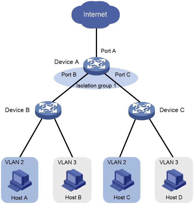

As shown in Figure 1:
·     To isolate Host A from Host C, and Host B from Host D, assign Port B and Port C on Device A to isolation group 1.
·     To enable Layer 2 communication between Host B and Host D, specify VLAN 3 as a community VLAN in isolation group 1. Host B and Host D belong to VLAN 3.
Figure 1 Community VLANs in an isolation group
