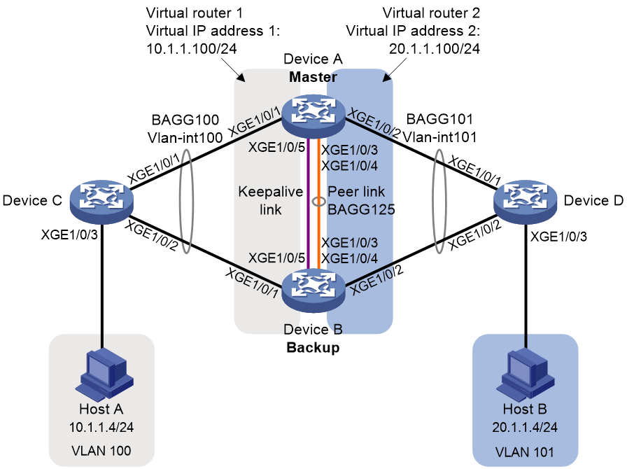

As shown in Figure 1, M-LAG virtualizes two devices into an M-LAG system, which connects to the remote aggregation system through a multichassis aggregate link. To the remote aggregation system, the M-LAG system is one device.
Figure 1 M-LAG network model
The M-LAG member devices are M-LAG peers to each other. For features that require centralized traffic processing (for example, spanning tree), an M-LAG member device is assigned the primary or secondary role based on its M-LAG role priority. The secondary M-LAG member device passes the traffic of those features to the primary M-LAG member device for processing. If the M-LAG member devices in an M-LAG system have the same M-LAG role priority, the device with the lower bridge MAC address is assigned the primary role.
M-LAG defines the following interface roles for each M-LAG member device:
·     M-LAG interface—Layer 2 aggregate interface connected to the remote aggregation system. M-LAG interfaces connected to the same remote aggregation system belong to one M-LAG group. In Figure 1, Bridge-Aggregation 1 on Device A and Bridge-Aggregation 2 on Device B belong to the same M-LAG group. M-LAG interfaces in an M-LAG group form a multichassis aggregate link.
·     Peer-link interface—Interface connected to the M-LAG peer for internal control. Each M-LAG member device has only one peer-link interface. The peer-link interfaces of the M-LAG member devices transmit M-LAG protocol packets and data packets through the peer link established between them. An M-LAG system has only one peer link.
M-LAG member devices use a keepalive link to monitor each other's state. For more information about the keepalive mechanism, see "Keepalive and failover mechanism."
If a device is attached to only one of the M-LAG member devices in an M-LAG system, that device is a single-homed device.

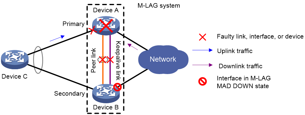

If the keepalive link is down while the peer link is up, the M-LAG member devices prompt you to check for keepalive link issues.
If the keepalive link is up while the peer link is down, the M-LAG member devices elect a primary device based on the information in the keepalive packets.

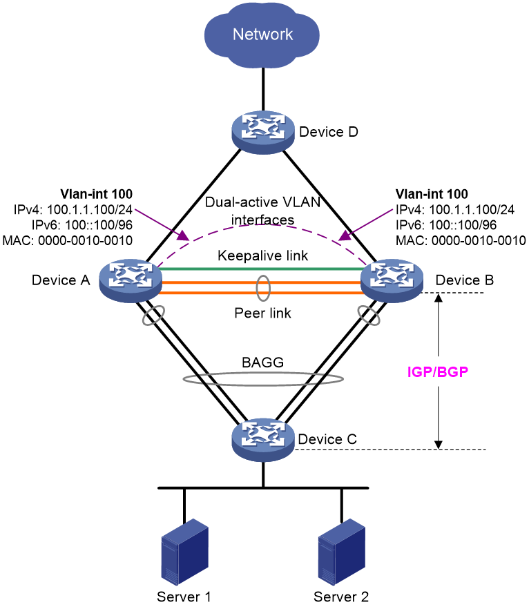

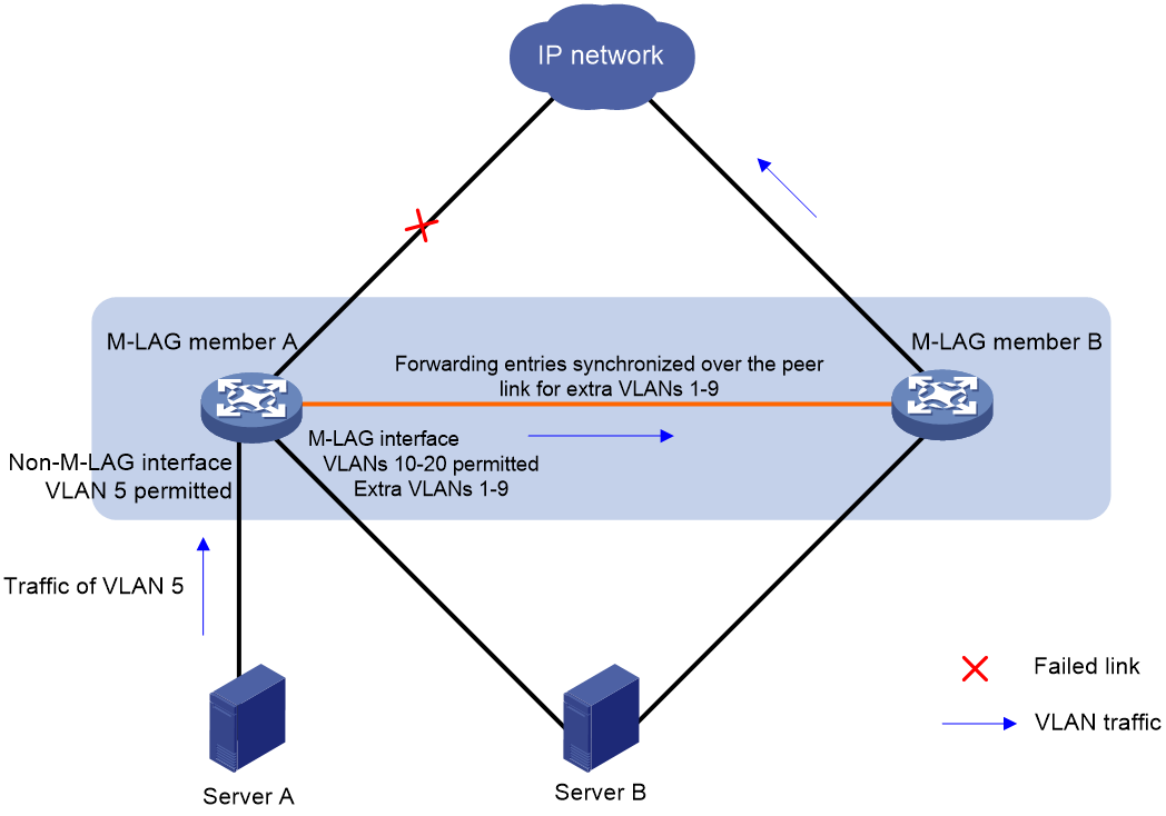

Dual-active gateways on an M-LAG system
When a Layer 3 network is dualhomed to an M-LAG system, each M-LAG member device uses a logical interface as the gateway interface for the Layer 3 network. Both logical interfaces are active to perform Layer 3 forwarding, and they use the same IP address and MAC address. When both links to the M-LAG system are operating correctly, the links load share traffic to balance bandwidth usage. When one of the links fails, the M-LAG system switches the traffic on the failed link to the other link to ensure high availability.
Typically, dual-active gateways are deployed if downstream devices run a dynamic routing protocol to communicate with the M-LAG system. As shown in Figure 4, IGP or BGP runs between Device C and the M-LAG system. To configure dual-active VLAN interfaces, perform the following tasks on Device A and Device B:
1.     Create VLAN interfaces for the same VLAN, VLAN-interface 100 for example, assign the same IPv4, IPv6, and MAC addresses to the VLAN interfaces, and assign the M-LAG interfaces to that VLAN.
2.     Assign different M-LAG VIPs to the VLAN interfaces.
Device A and Device B use their M-LAG VIPs to set up IGP or BGP peer relationships with Device C and with each other.
Figure 4 Layer 3 access to an M-LAG system through dynamic routing protocols
M-LAG sequence number check
M-LAG sequence number check protects M-LAG member devices from replay attacks.
With this feature enabled, the M-LAG member devices insert a sequence number into each outgoing DRCPDU or keepalive packet and the sequence number increases by 1 for each sent packet. When receiving a DRCPDU or keepalive packet, the M-LAG member devices check its sequence number and drop the packet if the check result is either of the following:
·     The sequence number of the packet is the same as that of a previously received packet.
·     The sequence number of the packet is smaller than that of the most recently received packet.
M-LAG packet authentication
M-LAG packet authentication prevents DRCPDU and keepalive packet tampering from causing link flapping.
With this feature enabled, the M-LAG member devices compute a message digest by using an authentication key for each outgoing DRCPDU or keepalive packet and insert the message digest into the packet. When receiving a DRCPDU or keepalive packet, an M-LAG member device computes a message digest and compares it with the message digest in the packet. If the message digests match, the packet passes authentication. If the message digests do not match, the device drops the packet.
M-LAG failure handling mechanisms
M-LAG interface failure handling mechanism
When the M-LAG interface of one M-LAG member device fails, the M-LAG system forwards traffic through the other M-LAG member device.
As shown in Figure 5, Device A and Device B form an M-LAG system, to which Device C is attached through a multichassis aggregation. If traffic to Device C arrives at Device B after the M-LAG interface connected Device B to Device C has failed, the M-LAG system forwards the traffic as follows:
1.     Device B sends the traffic to Device A over the peer link.
2.     Device A forwards the downlink traffic received from the peer link to Device C.
After the faulty M-LAG interface comes up, Device B forwards traffic to Device C through the M-LAG interface.
Figure 5 M-LAG interface failure handling mechanism
Peer link failure handling mechanism
As shown in Figure 6, multi-active collision occurs if the IPL goes down while the keepalive link is up. To avoid network issues, the secondary M-LAG device sets all network interfaces to M-LAG MAD DOWN state, except for the interfaces excluded from the shutdown action by M-LAG MAD.
In this situation, the primary M-LAG member device forwards all traffic for the M-LAG system.
When the peer-link interface comes up, the secondary M-LAG member device does not bring up the network interfaces immediately. Instead, it starts a delay timer and begins to recover data from the primary M-LAG member device. When the delay timer expires, the secondary M-LAG member device brings up all network interfaces.
Figure 6 Peer link failure handling mechanism
Device failure handling mechanism
As shown in Figure 7, when the primary M-LAG member device fails, the secondary M-LAG member device takes over the primary role to forward all traffic for the M-LAG system. When the faulty device recovers, it becomes the secondary M-LAG member device.

Uplink failure handling mechanism
Uplink failure does not interrupt traffic forwarding of the M-LAG system. As shown in Figure 8, when the uplink of Device A fails, Device A passes traffic destined for the IP network to Device B for forwarding.
To enable faster traffic switchover in response to an uplink failure and minimize traffic losses, configure Monitor Link to associate the M-LAG interfaces with the uplink interfaces. When the uplink interface of an M-LAG member device fails, that device shuts down its M-LAG interface for the other M-LAG member device to forward all traffic of Device C. For more information about Monitor Link, see High Availability Configuration Guide.
Figure 8 Uplink failure handling mechanism

Failure handling mechanism with M-LAG standalone mode
Figure 12 shows the mechanism to handle peer link and keepalive link failures when the M-LAG standalone mode feature is configured.
·     If the peer link goes down while the keepalive link is up, the M-LAG member devices negotiate their roles over the keepalive link. M-LAG MAD shuts down all network interfaces on the secondary M-LAG member device except those excluded from the shutdown action by M-LAG MAD.
·     If the keepalive link goes down while the peer link is down, both M-LAG member devices change to M-LAG standalone mode. The secondary M-LAG member device sets its role to primary and brings up its network interfaces in M-LAG MAD DOWN state. In M-LAG standalone mode, only the aggregation member ports on one M-LAG member device can become Selected to forward traffic. For more information about how M-LAG standalone mode operates, see "M-LAG standalone mode."
·     If the keepalive link is down before the peer link goes down, both M-LAG member devices change to M-LAG standalone mode.
Figure 12 Failure handling mechanism with M-LAG standalone mode

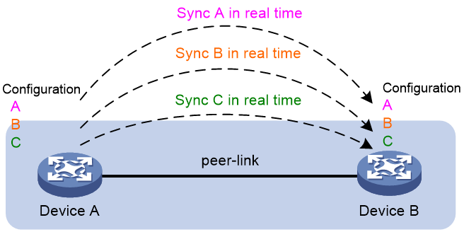

Real-time configuration sync
As shown in Figure 13, settings in multichassis configuration sync view of a member device are synchronized to its peer device in real time.
Figure 13 Real-time configuration sync

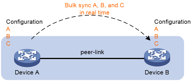

Bulk configuration sync
To fast deploy the services that are required to be consistent across the M-LAG member devices, configure the services on an M-LAG member device before M-LAG system setup. After the M-LAG system is set up and the peer link comes up, you can bulk synchronize settings on the member device to the same view for multichassis configuration sync on the M-LAG peer, as shown in Figure 14.
Figure 14 Bulk configuration sync

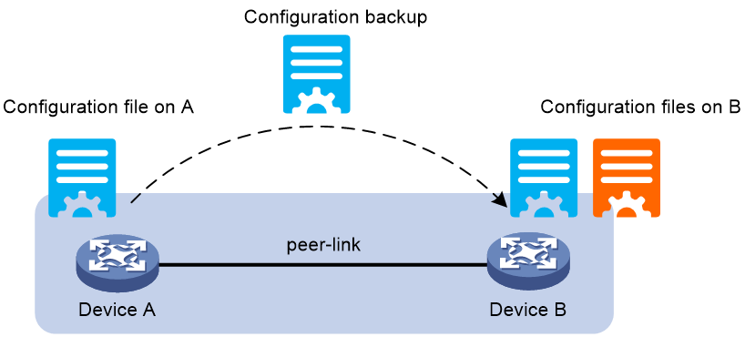

Configuration backup
If you are to update an M-LAG member device, for example, update the software version or replace the device, back up its configuration file to the M-LAG peer in advance as shown in Figure 15. After the update is completed, you can retrieve the previously saved configuration file from the peer device.
Figure 15 Configuration backup

Configuring M-LAG extra VLANs
For VLANs permitted only on non-M-LAG interfaces, the device processes traffic locally and do not synchronize forwarding entries such as MAC and ARP entries with the M-LAG peer device. For the device to synchronize forwarding entries for such VLANs, configure them as extra VLANs. The device will synchronize forwarding entries for the extra VLANs even though they are not permitted on M-LAG interfaces, as shown in Figure 16. When the uplink of one M-LAG member device fails, traffic of the extra VLANs can fail over to the other M-LAG member device through the peer link.
Figure 16 M-LAG extra VLANs
2.     Configure M-LAG extra VLANs.
m-lag extra-vlan vlan-id-list
By default, no M-LAG extra VLANs are configured.

Example: Configuring basic M-LAG functions
As shown in Figure 17, configure M-LAG on Device A and Device B to establish a multichassis aggregate link with Device C.
Figure 17 Network diagram

Example: Configuring Layer 3 gateways on an M-LAG system
As shown in Figure 18:
·     Configure Device A and Device B as an M-LAG system to establish one multichassis aggregate link with Device C and one with Device D.
·     Set up a keepalive link between Ten-GigabitEthernet 1/0/5 of Device A and Ten-GigabitEthernet 1/0/5 of Device B, and exclude the interfaces from the shutdown action by M-LAG MAD.
·     Configure two VRRP groups on Device A and Device B to provide gateway services for VLAN 100 and VLAN 200. Configure Device A as the master of the VRRP groups.
Figure 18 Network diagram
1.     Configure Device A:
# Configure M-LAG system settings.
<DeviceA> system-view
[DeviceA] m-lag system-mac 1-1-1
[DeviceA] m-lag system-number 1
[DeviceA] m-lag system-priority 123
# Configure M-LAG keepalive parameters.
[DeviceA] m-lag keepalive ip destination 1.1.1.2 source 1.1.1.1
# Set the link mode of Ten-GigabitEthernet 1/0/5 to Layer 3, and assign the interface an IP address. The IP address will be used as the source IP address of keepalive packets.
[DeviceA] interface ten-gigabitethernet 1/0/5
[DeviceA-Ten-GigabitEthernet1/0/5] port link-mode route
[DeviceA-Ten-GigabitEthernet1/0/5] ip address 1.1.1.1 24
[DeviceA-Ten-GigabitEthernet1/0/5] quit
# Exclude the interface used for M-LAG keepalive detection (Ten-GigabitEthernet 1/0/5) from the shutdown action by M-LAG MAD.
[DeviceA] m-lag mad exclude interface ten-gigabitethernet 1/0/5
# Create Layer 2 dynamic aggregate interface Bridge-Aggregation 125.
[DeviceA] interface bridge-aggregation 125
[DeviceA-Bridge-Aggregation125] link-aggregation mode dynamic
[DeviceA-Bridge-Aggregation125] quit
# Assign Ten-GigabitEthernet 1/0/3 and Ten-GigabitEthernet 1/0/4 to aggregation group 125.
[DeviceA] interface ten-gigabitethernet 1/0/3
[DeviceA-Ten-GigabitEthernet1/0/3] port link-aggregation group 125
[DeviceA-Ten-GigabitEthernet1/0/3] quit
[DeviceA] interface Ten-GigabitEthernet 1/0/4
[DeviceA-Ten-GigabitEthernet1/0/4] port link-aggregation group 125
[DeviceA-Ten-GigabitEthernet1/0/4] quit
# Specify Bridge-Aggregation 125 as the peer-link interface.
[DeviceA-Bridge-Aggregation125] port m-lag peer-link 1
[DeviceA-Bridge-Aggregation125] undo mac-address static source-check enable
# Create Layer 2 dynamic aggregate interface Bridge-Aggregation 100, and assign it to M-LAG group 1.
[DeviceA] interface bridge-aggregation 100
[DeviceA-Bridge-Aggregation100] link-aggregation mode dynamic
[DeviceA-Bridge-Aggregation100] port m-lag group 1
[DeviceA-Bridge-Aggregation100] quit
# Assign Ten-GigabitEthernet 1/0/1 to aggregation group 100.
[DeviceA] interface ten-gigabitethernet 1/0/1
[DeviceA-Ten-GigabitEthernet1/0/1] port link-aggregation group 100
[DeviceA-Ten-GigabitEthernet1/0/1] quit
# Create Layer 2 dynamic aggregate interface Bridge-Aggregation 101, and assign it to M-LAG group 2.
[DeviceA] interface bridge-aggregation 101
[DeviceA-Bridge-Aggregation101] link-aggregation mode dynamic
[DeviceA-Bridge-Aggregation101] port m-lag group 2
[DeviceA-Bridge-Aggregation101] quit
# Assign Ten-GigabitEthernet 1/0/2 to aggregation group 101.
[DeviceA] interface ten-gigabitethernet 1/0/2
[DeviceA-Ten-GigabitEthernet1/0/2] port link-aggregation group 101
[DeviceA-Ten-GigabitEthernet1/0/2] quit
# Create VLAN 100 and VLAN 101.
[DeviceA] vlan 100
[DeviceA-vlan100] quit
[DeviceA] vlan 101
[DeviceA-vlan101] quit
# Set the link type of Bridge-Aggregation 100 to trunk, and assign it to VLAN 100.
[DeviceA-Bridge-Aggregation100] port link-type trunk
[DeviceA-Bridge-Aggregation100] port trunk permit vlan 100
# Set the link type of Bridge-Aggregation 101 to trunk, and assign it to VLAN 101.
[DeviceA-Bridge-Aggregation101] port link-type trunk
[DeviceA-Bridge-Aggregation101] port trunk permit vlan 101
# Create VLAN-interface 100 and VLAN-interface 101, and assign IP addresses to them.
[DeviceA] interface vlan-interface 100
[DeviceA-vlan-interface100] ip address 10.1.1.1 24
[DeviceA-vlan-interface100] quit
[DeviceA] interface vlan-interface 101
[DeviceA-vlan-interface101] ip address 20.1.1.1 24
[DeviceA-vlan-interface101] quit
# Exclude VLAN-interface 100 and VLAN-interface 101 from the shutdown action by M-LAG MAD.
[DeviceA] m-lag mad exclude interface vlan-interface 100
[DeviceA] m-lag mad exclude interface vlan-interface 101
# Configure OSPF.
[DeviceA] ospf
[DeviceA-ospf-1] import-route direct
[DeviceA-ospf-1] area 0
[DeviceA-ospf-1-area-0.0.0.0] network 10.1.1.0 0.0.0.255
[DeviceA-ospf-1-area-0.0.0.0] network 20.1.1.0 0.0.0.255
[DeviceA-ospf-1-area-0.0.0.0] quit
[DeviceA-ospf-1] quit
# Create VRRP group 1 on VLAN-interface 100 and set its virtual IP address to 10.1.1.100.
[DeviceA-Vlan-interface100] vrrp vrid 1 virtual-ip 10.1.1.100
# Set the priority of Device A (primary M-LAG member device) to 200 for it to become the master in VRRP group 1.
[DeviceA-Vlan-interface100] vrrp vrid 1 priority 200
[DeviceA-Vlan-interface100] quit
# Create VRRP group 2 on VLAN-interface 101 and set its virtual IP address to 20.1.1.100.
[DeviceA-Vlan-interface101] vrrp vrid 2 virtual-ip 20.1.1.100
# Set the priority of Device A (primary M-LAG member device) to 200 for it to become the master in VRRP group 2.
[DeviceA-Vlan-interface101] vrrp vrid 2 priority 200
[DeviceA-Vlan-interface101] quit
2.     Configure Device B:
<DeviceB> system-view
[DeviceB] m-lag system-mac 1-1-1
[DeviceB] m-lag system-number 2
[DeviceB] m-lag system-priority 123
[DeviceB] m-lag keepalive ip destination 1.1.1.1 source 1.1.1.2
[DeviceB] interface ten-gigabitethernet 1/0/5
[DeviceB-Ten-GigabitEthernet1/0/5] port link-mode route
[DeviceB-Ten-GigabitEthernet1/0/5] ip address 1.1.1.2 24
[DeviceB-Ten-GigabitEthernet1/0/5] quit
[DeviceB] m-lag mad exclude interface ten-gigabitethernet 1/0/5
[DeviceB] interface bridge-aggregation 125
[DeviceB-Bridge-Aggregation125] link-aggregation mode dynamic
[DeviceB-Bridge-Aggregation125] quit
[DeviceB] interface ten-gigabitethernet 1/0/3
[DeviceB-Ten-GigabitEthernet1/0/3] port link-aggregation group 125
[DeviceB-Ten-GigabitEthernet1/0/3] quit
[DeviceB] interface ten-gigabitethernet 1/0/4
[DeviceB-Ten-GigabitEthernet1/0/4] port link-aggregation group 125
[DeviceB-Ten-GigabitEthernet1/0/4] quit
[DeviceB-Bridge-Aggregation125] port m-lag peer-link 1
[DeviceB-Bridge-Aggregation125] undo mac-address static source-check enable
[DeviceB] interface bridge-aggregation 100
[DeviceB-Bridge-Aggregation100] link-aggregation mode dynamic
[DeviceB-Bridge-Aggregation100] port m-lag group 1
[DeviceB-Bridge-Aggregation100] quit
[DeviceB] interface ten-gigabitethernet 1/0/1
[DeviceB-Ten-GigabitEthernet1/0/1] port link-aggregation group 100
[DeviceB-Ten-GigabitEthernet1/0/1] quit
[DeviceB] interface bridge-aggregation 101
[DeviceB-Bridge-Aggregation101] link-aggregation mode dynamic
[DeviceB-Bridge-Aggregation101] port m-lag group 2
[DeviceB-Bridge-Aggregation101] quit
[DeviceB] interface ten-gigabitethernet 1/0/2
[DeviceB-Ten-GigabitEthernet1/0/2] port link-aggregation group 101
[DeviceB-Ten-GigabitEthernet1/0/2] quit
[DeviceB] vlan 100
[DeviceB-vlan100] quit
[DeviceB] vlan 101
[DeviceB-vlan101] quit
[DeviceB-Bridge-Aggregation100] port link-type trunk
[DeviceB-Bridge-Aggregation100] port trunk permit vlan 100
[DeviceB-Bridge-Aggregation101] port link-type trunk
[DeviceB-Bridge-Aggregation101] port trunk permit vlan 101
[DeviceB] interface vlan-interface 100
[DeviceB-vlan-interface100] ip address 10.1.1.2 24
[DeviceB-vlan-interface100] quit
[DeviceB] interface vlan-interface 101
[DeviceB-vlan-interface101] ip address 20.1.1.2 24
[DeviceB-vlan-interface101] quit
[DeviceB] m-lag mad exclude interface vlan-interface 100
[DeviceB] m-lag mad exclude interface vlan-interface 101
# Configure OSPF.
[DeviceB] ospf
[DeviceB-ospf-1] import-route direct
[DeviceB-ospf-1] area 0
[DeviceB-ospf-1-area-0.0.0.0] network 10.1.1.0 0.0.0.255
[DeviceB-ospf-1-area-0.0.0.0] network 20.1.1.0 0.0.0.255
[DeviceB-ospf-1-area-0.0.0.0] quit
[DeviceB-ospf-1] quit
[DeviceB-Vlan-interface100] vrrp vrid 1 virtual-ip 10.1.1.100
[DeviceB-Vlan-interface100] quit
[DeviceB-Vlan-interface101] vrrp vrid 2 virtual-ip 20.1.1.100
[DeviceB-Vlan-interface101] quit
3.     Configure Device C:
# Create Layer 2 dynamic aggregate interface Bridge-Aggregation 100.
<DeviceC> system-view
[DeviceC] interface bridge-aggregation 100
[DeviceC-Bridge-Aggregation100] link-aggregation mode dynamic
[DeviceC-Bridge-Aggregation100] quit
# Assign Ten-GigabitEthernet 1/0/1 and Ten-GigabitEthernet 1/0/2 to aggregation group 100.
[DeviceC] interface range ten-gigabitethernet 1/0/1 to ten-gigabitethernet 1/0/2
[DeviceC-if-range] port link-aggregation group 100
[DeviceC-if-range] quit
# Create VLAN 100.
[DeviceC] vlan 100
[DeviceC-vlan100] quit
[DeviceC-Bridge-Aggregation100] port link-type trunk
[DeviceC-Bridge-Aggregation100] port trunk permit vlan 100
# Set the link type of Ten-GigabitEthernet 1/0/3 to trunk, and assign it to VLAN 100.
[DeviceC] interface ten-gigabitethernet 1/0/3
[DeviceC-Ten-GigabitEthernet1/0/3] port link-type trunk
[DeviceC-Ten-GigabitEthernet1/0/3] port trunk permit vlan 100
[DeviceC-Ten-GigabitEthernet1/0/3] quit
# Create VLAN-interface 100, and assign it an IP address.
[DeviceC] interface vlan-interface 100
[DeviceC-vlan-interface100] ip address 10.1.1.3 24
[DeviceC-vlan-interface100] quit
# Configure OSPF.
[DeviceC] ospf
[DeviceC-ospf-1] import-route direct
[DeviceC-ospf-1] area 0
[DeviceC-ospf-1-area-0.0.0.0] network 10.1.1.0 0.0.0.255
[DeviceC-ospf-1-area-0.0.0.0] quit
[DeviceC-ospf-1] quit
4.     Configure Device D:
# Create Layer 2 dynamic aggregate interface Bridge-Aggregation 101.
<DeviceD> system-view
[DeviceD] interface bridge-aggregation 101
[DeviceD-Bridge-Aggregation101] link-aggregation mode dynamic
[DeviceD-Bridge-Aggregation101] quit
# Assign Ten-GigabitEthernet 1/0/1 and Ten-GigabitEthernet 1/0/2 to aggregation group 101.
[DeviceD] interface range ten-gigabitethernet 1/0/1 to ten-gigabitethernet 1/0/2
[DeviceD-if-range] port link-aggregation group 101
[DeviceD-if-range] quit
# Create VLAN 101.
[DeviceD] vlan 101
[DeviceD-vlan101] quit
[DeviceD-Bridge-Aggregation101] port link-type trunk
[DeviceD-Bridge-Aggregation101] port trunk permit vlan 101
# Set the link type of Ten-GigabitEthernet 1/0/3 to trunk, and assign it to VLAN 101.
[DeviceD] interface ten-gigabitethernet 1/0/3
[DeviceD-Ten-GigabitEthernet1/0/3] port link-type trunk
[DeviceD-Ten-GigabitEthernet1/0/3] port trunk permit vlan 101
[DeviceD-Ten-GigabitEthernet1/0/3] quit
# Create VLAN-interface 101, and assign it an IP address.
[DeviceD] interface vlan-interface 101
[DeviceD-vlan-interface101] ip address 20.1.1.3 24
[DeviceD-vlan-interface101] quit
# Configure OSPF.
[DeviceD] ospf
[DeviceD-ospf-1] import-route direct
[DeviceD-ospf-1] area 0
[DeviceD-ospf-1-area-0.0.0.0] network 20.1.1.0 0.0.0.255
[DeviceD-ospf-1-area-0.0.0.0] quit
[DeviceD-ospf-1] quit
# Verify that Device A has formed an M-LAG system with Device B.
[DeviceA] display m-lag summary
Flags: A -- Aggregate interface down, B -- No peer M-LAG interface configured
       C -- Configuration consistency check failed
Peer-link interface: BAGG125
Peer-link interface state (cause): UP
Keepalive link state (cause): UP
                     M-LAG interface information
M-LAG IF      M-LAG group  Local state (cause)  Peer state  Remaining down time(s)
BAGG100       1            UP                   UP          -
BAGG101       2            UP                   UP          -
[DeviceA] display m-lag verbose
Flags: A -- Home_Gateway, B -- Neighbor_Gateway, C -- Other_Gateway,
       D -- PeerLink_Activity, E -- DRCP_Timeout, F -- Gateway_Sync,
       G -- Port_Sync, H -- Expired
Peer-link interface/Peer-link interface ID: BAGG125/1
State: UP
Cause: -
Local DRCP flags/Peer DRCP flags: ABDFG/ABDFG
Local Selected ports (index): XGE1/0/3 (260), XGE1/0/4 (261)
Peer Selected ports indexes: 260, 261
M-LAG interface/M-LAG group ID: BAGG100/1
Local M-LAG interface state: UP
Peer M-LAG interface state: UP
M-LAG group state: UP
Local M-LAG interface down cause: -
Remaining M-LAG DOWN time: -
Local M-LAG interface LACP MAC: Config=N/A, Effective=0001-0001-0001
Peer M-LAG interface LACP MAC: Config=N/A, Effective=0001-0001-0001
Local M-LAG interface LACP priority: Config=32768, Effective=123
Peer M-LAG interface LACP priority: Config=32768, Effective=123
Local Selected ports (index): XGE1/0/1 (258)
Peer Selected ports indexes: 258
M-LAG interface/M-LAG group ID: BAGG101/2
Local Selected ports (index): XGE1/0/2 (259)
Peer Selected ports indexes: 259
# Verify that Device C and Device D have correctly set up aggregate links with the M-LAG system.
[DeviceC] display link-aggregation verbose
Loadsharing Type: Shar -- Loadsharing, NonS -- Non-Loadsharing
Port Status: S -- Selected, U -- Unselected, I -- Individual
Port: A -- Auto port, M -- Management port, R -- Reference port
Flags:  A -- LACP_Activity, B -- LACP_Timeout, C -- Aggregation,
        G -- Defaulted, H -- Expired
Aggregate Interface: Bridge-Aggregation100
Creation Mode: Manual
Aggregation Mode: Dynamic
Management VLANs: None
System ID: 0x8000, a03b-0694-0300
Local:
  Port                Status   Priority Index    Oper-Key               Flag
  XGE1/0/1            S        32768    1        1                      {ACDEF}
  XGE1/0/2            S        32768    2        1                      {ACDEF}
Remote:
  Actor               Priority Index    Oper-Key SystemID               Flag
  XGE1/0/1(R)         32768    16386    40001    0x7b  , 0001-0001-0001 {ACDEF}
  XGE1/0/2            32768    32770    40001    0x7b  , 0001-0001-0001 {ACDEF}
[DeviceD] display link-aggregation verbose
Aggregate Interface: Bridge-Aggregation101
System ID: 0x8000, a03b-0d51-0400
Local:
Remote:
  XGE1/0/1(R)         32768    16387    40002    0x7b  , 0001-0001-0001 {ACDEF}
  XGE1/0/2            32768    32771    40002    0x7b  , 0001-0001-0001 {ACDEF}
# Verify that Device A is the master in VRRP group 1 and VRRP group 2.
[DeviceA] display vrrp
IPv4 Virtual Router Information:
 Running mode : Standard
 Total number of virtual routers : 2
 Interface          VRID  State        Running Adver   Auth             Virtual
                                       Pri     Timer   Type             IP
 Vlan100            1     Master       200     100     None             10.1.1.100
 Vlan101            2     Master       200     100     None             20.1.1.100
[DeviceB] display vrrp
                                       Pri     Timer   Type             IP
 Vlan100            1     Backup       100     100     None             10.1.1.100
 Vlan101            2     Backup       100     100     None             20.1.1.100
# Verify that Device C and Device D have established OSPF neighbor relationships with Device A and Device B.
[DeviceC] display ospf peer
         OSPF Process 1 with Router ID 10.1.1.3
               Neighbor Brief Information
 Area: 0.0.0.0
 Router ID       Address         Pri Dead-Time  State             Interface
 20.1.1.1        10.1.1.1        1   37         Full/DR           Vlan100
 20.1.1.2        10.1.1.2        1   32         Full/BDR          Vlan100
[DeviceD] display ospf peer
         OSPF Process 1 with Router ID 20.1.1.3
 Area: 0.0.0.0
 20.1.1.1        20.1.1.1        1   38         Full/DR           Vlan101
 20.1.1.2        20.1.1.2        1   37         Full/BDR          Vlan101
# Verify that Host A and Host B can ping each other. (Details not shown.)
Example: Configure dual-active gateways on an M-LAG system
As shown in Figure 19, set up an M-LAG system with Device A and Device B and configure dual-active gateways for the servers on Device A and Device B.
Figure 19 Network diagram
In this example, all devices use the factory default settings. When you apply this configuration example to a live environment, make sure the existing configurations do not conflict with the configurations in this example.
You must configure the same M-LAG system MAC address on the M-LAG member devices in the same M-LAG system. You must assign unique M-LAG system MAC addresses to different M-LAG systems.
To avoid loops, do not configure local proxy ARP or ND on the downstream VLAN interfaces of the M-LAG member devices. For more information about local proxy ARP or ND, see proxy ARP configuration and IPv6 neighbor discovery in Layer 3—IP Services Configuration Guide.
