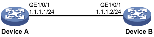

Example: Tracing IPv4 TCP connections
As show in Figure 3, you can Telnet to Device B from Device A. Configure TCP connection trace on Device A to trace the TCP connection between Device A and Device B. When the connection is abnormally closed, you can use the trace information to locate disconnection reasons. Enable persistence for TCP connection trace configuration so that the configuration can survive Device A reboot.
· Configure Device B as a Telnet server. For more information, see login management configuration in Fundamentals Configuration Guide.
· Assign an IP address to each interface as shown in Figure 3. (Details not shown.)
# Allow the TCP connection trace feature to trace a maximum of 600 data packets per TCP connection.
<DeviceA> tcp trace max-packet-number 600
# Set the memory quota to 300 MB for recording TCP connection information.
<DeviceA> tcp trace memory-quota 300
# Enable TCP connection trace.
<DeviceA> tcp trace enable
# Enable persistence for the TCP connection trace configuration.
<DeviceA> tcp trace persist
1. Telnet to Device B from Device A.
<DeviceA> telnet 1.1.1.2
2. Display TCP connection information when you can correctly log in to Device B from Device A through Telnet.
# Display information about all disconnected IPv4 TCP connections that have been recorded.
<DeviceA> display tcp trace cache-connection ip slot 1
R (Reason):
PN: Peer normal close
RR: Received reset
SR: Sent reset
AN: Application normal close
AA: Application abnormal close
KT: Keepalive timeout
PT: Persist timeout
RT: Retransmit timeout
BD: Backup drop
Local Addr:port Foreign Addr:port VPN name R Time
# Display packet information about disconnected IPv4 TCP connections.
<DeviceA> display tcp trace cache-packet ip source-ip 1.1.1.1 source-port 23 destination-ip 1.1.1.2 destination-port 23 verbose slot 1
The TCP connection is normal and no output is displayed.
3. Shut down HundredGigE 1/1/1 on Device B.
<DeviceB> system-view
[DeviceB] interface hundredgige 1/1/1
[DeviceB-HundredGigE1/1/1] shutdown
After you shut down HundredGigE 1/1/1, the Telnet connection is terminated. Display TCP connection information on Device A after a period of time.

Example: Tracing IPv6 TCP connections
As show in Figure 4, you can Telnet to Device B from Device A. Configure TCP connection trace on Device A to trace the IPv6 TCP connection between Device A and Device B. When the connection is abnormally closed, you can use the trace information to locate disconnection reasons. Enable persistence for TCP connection trace configuration so that the configuration can survive Device A reboot.
· Assign an IPv6 address to each interface as shown in Figure 4. (Details not shown.)
