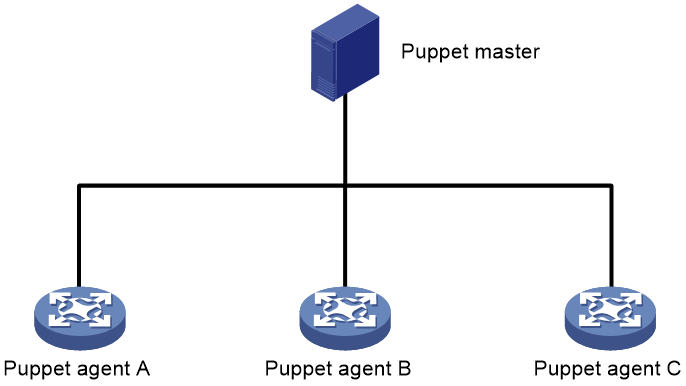

Puppet network framework
Figure 1 Puppet network framework
As shown in Figure 1, Puppet operates in a client/server network framework. In the framework, the Puppet master (server) stores configuration manifests for Puppet agents (clients). The Puppet agents establish SSL connections to the Puppet master to obtain their respective latest configurations.
Puppet master
The Puppet master runs the Puppet daemon process to listen to requests from Puppet agents, authenticates Puppet agents, and sends configurations to Puppet agents on demand.
For information about installing and configuring a Puppet master, access the official Puppet website at https://puppetlabs.com/.

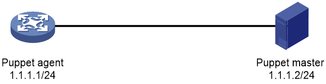

Example: Configuring Puppet
As shown in Figure 2, the device is connected to the Puppet master. Use Puppet to configure the device to perform the following operations:
·     Set the SSH login username and password to user and passwd, respectively.
·     Create VLAN 3.
Figure 2 Network diagram
1.     Configure SSH login and enable NETCONF over SSH on the device. (Details not shown.)
2.     On the Puppet master, create the modules/custom/manifests directory in the /etc/puppet/ directory for storing configuration manifests.
$ mkdir -p /etc/puppet/modules/custom/manifests
3.     Create configuration manifest init.pp in the /etc/puppet/modules/custom/manifests directory as follows:
netdev_device{'device':
 ensure => undo_shutdown,
 username => 'user',
 password => 'passwd',
 ipaddr => '1.1.1.1',
netdev_vlan{'vlan3':
 id => 3,
 require => Netdev_device['device'],
4.     Start Puppet on the device.
<PuppetAgent> system-view
[PuppetAgent] third-part-process start name puppet arg agent --certname=1.1.1.1 --server=1.1.1.2
5.     Configure the Puppet master to authenticate the request from the Puppet agent.
$ puppet cert sign 1.1.1.1
After passing the authentication, the Puppet agent requests the latest configuration for it from the Puppet master.
