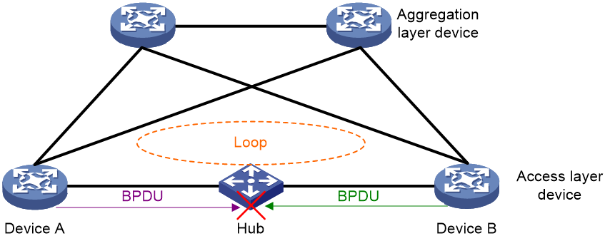

stp blackhole-detection enable
Use stp blackhole-detection enable to enable spanning tree blackhole detection on a port.
Use undo stp blackhole-detection enable to disable spanning tree blackhole detection on a port.
Syntax
Default
The spanning tree blackhole detection on a port is enabled.
Views
Layer 2 Ethernet interface view
Predefined user roles
network-admin
Usage guidelines
Prerequisite
The spanning tree blackhole detection feature takes effect when the following conditions are met:
·     On the devices at both ends of a link, the spanning tree blackhole detection is enabled both globally and on ports.
·     The link status of the port on which the spanning tree blackhole detection is enabled is up, and the spanning tree feature is enabled.
Operating mechanism
1.     Blackhole verification phase.
A port enabled with spanning tree blackhole detection will start the BPDU reception timer of the blackhole detection feature. If the port receives a BPDU before the BPDU reception timer expires, the port resets the BPDU reception timer. If the BPDU reception timer expires, BPDU blackholes might exist on the network. As a result, the device fails to receive BPDUs for a long time, and the port starts to send spanning tree blackhole detection packets continuously.
Spanning tree blackhole detection packet is a type of Layer 2 packets defined by H3C. Different from the BPDU, the spanning tree blackhole detection packet can be transparently transmitted by the HUB, and will be sent continuously at a fixed time interval after being triggered to send.
Use the stp global blackhole-detection rx-bpdu timeout command to set the BPDU reception timer. Use the stp timer blackhole-detection-interval or stp global timer blackhole-detection-interval command to set the interval for sending spanning tree blackhole detection packets.
2.     Blackhole confirmation phase.
If the port is triggered to send spanning tree blackhole detection packets and receives a BPDU, it proves that no BPDU blackhole exist between the devices. The port stops transmitting the spanning tree blackhole detection packets and resets the BPDU reception timer.
If a port with the spanning tree blackhole detection feature enabled receives a blackhole detection frame while its BPDU reception timer is in a timeout state, it indicates that the link between the local and remote devices is connected. Both devices are capable of sending BPDUs, but neither device receives BPDUs. The local device determines that a BPDU blackhole exists between the two ends of the link.
3.     Blackhole handling phase.
After the device discovers a BPDU blackhole, it blocks the port that receives the spanning tree blackhole detection packet. Loops in the network are eliminated by preventing ports from sending and receiving any user data packets. You can use the stp timer rx-blackhole-timeout or stp global timer rx-blackhole-timeout command to specify the timeout period of the blocked port for spanning tree blackhole detection. If the port does not receive the spanning tree blackhole detection packet again within the timeout period, it means that the BPDU blackhole is eliminated, and the port returns to the normal forwarding state. Otherwise, the port continues to retain the blocking state.
If the spanning tree blackhole detection is disabled on the port, or the BPDU reception timer on the port has not expired, the port does not perform any processing after receiving the spanning tree blackhole detection packet.

Application scenarios
Figure 1 Network diagram
As shown in Figure 1, Device A and Device B are connected via a HUB, which creates a loop in the network. Since BPDUs are point-to-point frames, once they are transmitted from a device and received by the next node, their transmission is terminated. The HUB acts as a blackhole for BPDUs. BPDUs cannot be transmitted between Device A and Device B through the HUB, and Device A and Device B cannot eliminate the loop through correct spanning tree topology calculation. Therefore, a method to detect BPDU blackholes is crucial for devices to block links to blackholes when detecting them, effectively eliminating potential loop risks.
Prerequisite
Operating mechanism

stp loopback-protection
Use stp loopback-protection to enable loopback guard on an interface.
Use undo stp loopback-protection to disable loopback guard on an interface.
Syntax
Default
Loopback guard is enabled on an interface.
Views
Layer 2 aggregate interface view
Layer 2 RPR logical interface view
network-admin
Usage guidelines
Disabling loopback guard might cause loops. Disable this feature unless necessary. Make sure you are fully aware of the impact when you disable loopback guard on a live network.
The device blocks a loopback guard-enabled interface to remove loops when the interface receives a BPDU sent by itself. In some scenarios, an interface can receive the BPDUs sent by itself when no loop exists. For example, a fiber-to-copper converter might reflect back BDPUs. To prevent the device from blocking loopless interfaces in those scenarios and ensure a stable network topology, you can disable loopback guard.
If this command is executed in Layer 2 Ethernet interface view, it takes effect only on that interface.
If this command is executed in Layer 2 aggregate interface view, it takes effect only on the aggregate interface.
If this command is executed on a member port in an aggregation group, it takes effect only after the port leaves the aggregation group.
Examples
