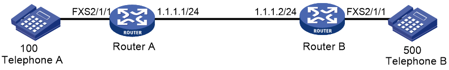

Example: Configuring call node-based normal secondary calls by using dial terminator match
As shown in Figure 1, configure an IVR access number and customize call node functions on Router B to achieve the following purposes:
· After a subscriber originates a SIP call by dialing 300 (the IVR access number of Router B) at Telephone A, Router B plays the media file welcome.wav. Then, after the subscriber dials 50# at Telephone A to originate a secondary call, Telephone B1 rings.
· In the case of an input error, Router B plays the media file input_error.wav.
· In the case of an input timeout, Router B plays the media file timeout.wav.
# Configure the local number as 100 for POTS entity 100, and bind FXS interface line 2/1/1 to the POTS entity.
<RouterA> system-view
[RouterA] voice-setup
[RouterA-voice] dial-program
[RouterA-voice-dial] entity 100 pots
[RouterA-voice-dial-entity100] match-template 100
[RouterA-voice-dial-entity100] line 2/1/1
[RouterA-voice-dial-entity100] quit
# Configure the called number as 300 for VoIP entity 300, and configure the destination IP address as 1.1.1.2.
[RouterA-voice-dial] entity 300 voip
[RouterA-voice-dial-entity300] match-template 300
[RouterA-voice-dial-entity300] address sip ip 1.1.1.2
[RouterA-voice-dial-entity300] outband sip
# Configure the local number as 500 for POTS entity 500, and bind FXS interface line 2/1/2 to the POTS entity.
<RouterB> system-view
[RouterB] voice-setup
[RouterB-voice] dial-program
[RouterB-voice-dial] entity 500 pots
[RouterB-voice-dial-entity500] match-template 500
[RouterB-voice-dial-entity500] line 2/1/2
[RouterB-voice-dial-entity500] quit
# Configure the local number as 50 for POTS entity 50, and bind FXS interface line 2/1/1 to the POTS entity.
[RouterB-voice-dial] entity 50 pots
[RouterB-voice-dial-entity50] match-template 50
[RouterB-voice-dial-entity50] line 2/1/1
[RouterB-voice-dial-entity50] quit
# Configure an access number of 300 for IVR entity 300, and specify node 10 as the root node.
[RouterB-voice-dial] entity 300 ivr
[RouterB-voice-dial-entity300] match-template 300
[RouterB-voice-dial-entity300] ivr-root 10
[RouterB-voice-dial-entity300] quit
[RouterB-voice-dial] quit
# Specify IDs for media files as follows:
¡ Specify ID 10001 for the media file cfa0:/wav/g729r8/welcome.wav.
¡ Specify ID 10002 for the media file cfa0:/wav/g729r8/timeout.wav.
¡ Specify ID 10003 for the media file cfa0:/wav/g729r8/input_error.wav.
[RouterB-voice] media-file g729r8
[RouterB-voice-media-g729r8] set-media 10001 file cfa0:/wav/g729r8/welcome.wav
[RouterB-voice-media-g729r8] set-media 10002 file cfa0:/wav/g729r8/timeout.wav
[RouterB-voice-media-g729r8] set-media 10003 file cfa0:/wav/g729r8/input_error.wav
[RouterB-voice-media-g729r8] quit
# Configure global policies for handling input errors and timeouts.
[RouterB-voice-ivr] global-input-error repeat 3 media-play 10003
[RouterB-voice-ivr] global-timeout repeat 4 expires 5 media-play 10002
# Configure call node 10 as follows:
¡ After the IVR access number 300 is matched, Router B plays the media file welcome.wav
¡ After the subscriber dials 50# at Telephone A, Router B originates a secondary call to Telephone B1.
[RouterB-voice-ivr] node 10 call
[RouterB-voice-ivr-node10] media-play 10001
[RouterB-voice-ivr-node10] call-normal terminator #
# Dial the number 300 at Telephone A to verify that the media file welcome.wav is played.
# After the media file welcome.wav is played, dial 50# at Telephone A to verify that Telephone B1 rings.

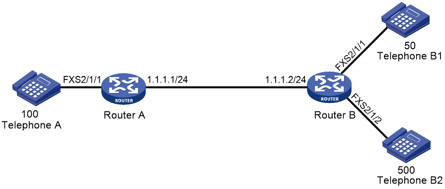

Example: Configuring call node-based normal secondary calls by using number length match
As shown in Figure 2, configure an IVR access number and customize call node functions on Router B to achieve the following purposes:
· After a subscriber originates a call by dialing 300 (the IVR access number of Router B) at Telephone A, Router B plays the media file welcome.wav. Then, after the subscriber dials a 3-digit number 500, Telephone B2 rings.
1. Configure Router A. For more information, see "Configure Router A:."
2. Configure Router B:
¡ After the subscriber dials a 3-digit number 500 at Telephone A, Router B originates a secondary call to Telephone B2.
[RouterB-voice-ivr-node10] call-normal length 3
# For other configurations, see "Configure Router B:."
# After the media file welcome.wav is played, dial 500 at Telephone A to verify that Telephone B2 rings.

Example: Configuring service node-based call ending
As shown in Figure 7, configure an IVR access number and customize service node functions on Router B to achieve the following purposes:
· After a subscriber dials 300 (the IVR access number of Router B) at Telephone A, Router B plays the media file bye.wav and then terminates the call.

Example: Configuring comprehensive IVR nodes
As shown in Figure 8, configure an IVR access number and customize call node, jump node and service node functions on Router B to achieve the following purposes:
· After a subscriber dials 300 (the IVR access number of Router B) at Telephone A, Router B plays the media file welcome.wav.
¡ If the subscriber presses the * key at Telephone A, the call jumps to the service node and the subscriber hears voice prompts of the media file bye.wav. Then, the service node releases the call.
¡ If the subscriber presses the # key at Telephone A, the call jumps to the call node and the subscriber hears the voice prompts of the media file call.wav. Then, if the subscriber dials 1, the call node executes an extension secondary call to Telephone B (500).
