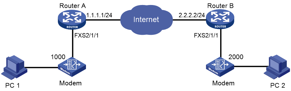

Configuring modem pass-through
Modem pass-through allows modem signals to be transmitted in RTP packets without being compressed, and it supports G.711 A-law and G711 μ-law codecs. During modem pass-through, the device automatically disables VAD.
The codec used for modem pass-through must be a codec specified for the voice entity.
1. Enter system view.
2. Enter voice view.
voice-setup
3. Enter dial program view.
dial-program
4. Enter voice entity view.
entity entity-number { pots | voip }
5. Configure modem pass-through.
modem passthrough { nse [ payload-type number ] | protocol } codec { g711alaw | g711ulaw }
By default, modem pass-through is not used.

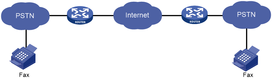

FoIP configuration examples
Example: Configuring T.38 fax
As shown in Figure 2, configure Router A and Router B to use the standard T.38 protocol for fax transmission.
1. Configure Router A:
# Configure the called fax number as 2000 for VoIP entity 2000, and configure the destination IP address as 2.2.2.2.
<RouterA> system-view
[RouterA] voice-setup
[RouterA-voice] dial-program
[RouterA-voice-dial] entity 2000 voip
[RouterA-voice-dial-entity2000] match-template 2000
[RouterA-voice-dial-entity2000] address sip ip 2.2.2.2
# Configure the standard T.38 protocol for VoIP entity 2000, with a low redundancy value of 4.
[RouterA-voice-dial-entity2000] fax protocol standard-t38 ls-redundancy 4
[RouterA-voice-dial-entity2000] quit
# Configure the local fax number as 1000 for POTS entity 1000, and bind FXS interface line 2/1/1 to the POTS entity.
[RouterA-voice-dial] entity 1000 pots
[RouterA-voice-dial-entity1000] match-template 1000
[RouterA-voice-dial-entity1000] line 2/1/1
# Configure the standard T.38 protocol for POTS entity 1000, with a low redundancy value of 4.

Example: Configuring modem pass-through
As shown in Figure 3, configure modem pass-through on Router A and Router B for data communication between PC 1 and PC 2.
# Configure the called number as 2000 for VoIP entity 2000, and configure the destination IP address as 2.2.2.2.
# Configure modem pass-through for VoIP entity 2000.
[RouterA-voice-dial-entity2000] modem passthrough protocol codec g711alaw
# Configure the local number as 1000 for POTS entity 1000, and bind FXS interface line 2/1/1 to the POTS entity.
# Configure modem pass-through for POTS entity 1000.
[RouterA-voice-dial-entity1000] modem passthrough protocol codec g711alaw
2. Configure Router B:
# Configure the called number as 1000 for VoIP entity 1000, and configure the destination IP address as 1.1.1.1.
<RouterB> system-view
[RouterB] voice-setup
[RouterB-voice] dial-program
[RouterB-voice-dial] entity 1000 voip
[RouterB-voice-dial-entity1000] match-template 1000
[RouterB-voice-dial-entity1000] address sip ip 1.1.1.1
# Configure modem pass-through for VoIP entity 1000.
[RouterB-voice-dial-entity1000] modem passthrough protocol codec g711alaw
[RouterB-voice-dial-entity1000] quit
# Configure the local number as 2000 for POTS entity 2000, and bind FXS interface line 2/1/1 to the POTS entity.
[RouterB-voice-dial] entity 2000 pots
[RouterB-voice-dial-entity2000] match-template 2000
[RouterB-voice-dial-entity2000] line 2/1/1
# Configure modem pass-through for POTS entity 2000.
[RouterB-voice-dial-entity2000] modem passthrough protocol codec g711alaw
