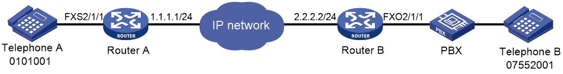

Configuring busy tone detection
· Busy tone standards—PBX switches might use different busy tone standards. If a user on the PBX side hangs up, the router knows the on-hook operation by detecting a busy tone. If the router cannot correctly identify the played busy tones, the FXO interface on the router will remain seized or goes on-hook prematurely.
As shown in Figure 1, Telephone A establishes a call to Telephone B, and then Telephone A goes on-hook. The PBX plays busy tones to Router A after detecting the on-hook condition of Telephone A. If Router A cannot detect the played busy tones, the FXO interface on Router A will remain seized. To solve this problem, you can configure busy tone detection for the FXO interface.
Two busy tone standards are available: European and North American. After you specify a standard, the device uses a set of parameters compliant with that standard for busy tone detection. If the actual busy tone data do not completely match the set of parameters, the device can use customized busy tone parameters or automatic busy tone detection to accurately detect busy tones.
· Custom busy tone parameters—You can configure busy tone detection by customizing busy tone parameters or configuring automatic busy tone detection. If the tone that the router receives from the PBX matches the busy tone parameters, the router considers the tone as a busy tone and renders the FXO interface on-hook.
As shown in Figure 1, the procedure for automatic busy tone detection is as follows:
a. Place a call from Telephone A to Telephone B.
b. Hang up Telephone A first.
The PBX plays a busy tone to Router A after detecting the on-hook condition.
c. Execute the busytone-detect auto command on Router A to detect busy tones.
As a best practice to ensure that the FXO interface can capture the busy tones sent by the PBX, execute this command two seconds after Telephone A goes on-hook.
The console prompts that busy tone detection is in progress and prompts detection success when the detection is complete.
d. Check whether the detected busy tone parameters are valid by repeating steps 1 and 2.
After Telephone A goes on-hook, the PBX plays a busy tone to Router A. If Router A detects the busy tone, it shuts down the FXO interface.

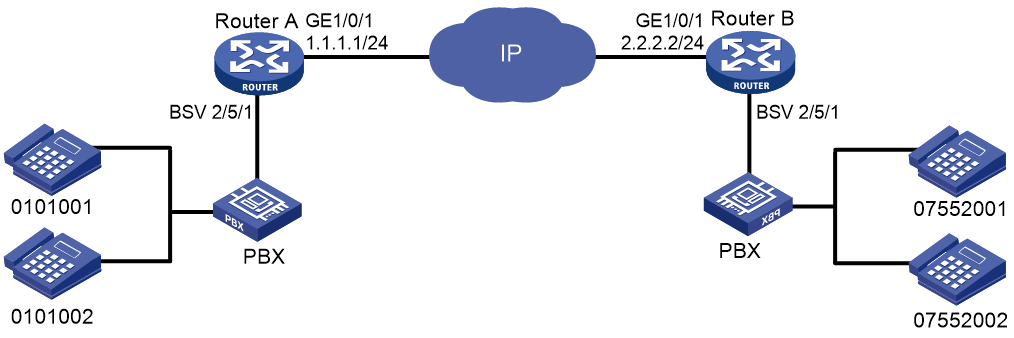

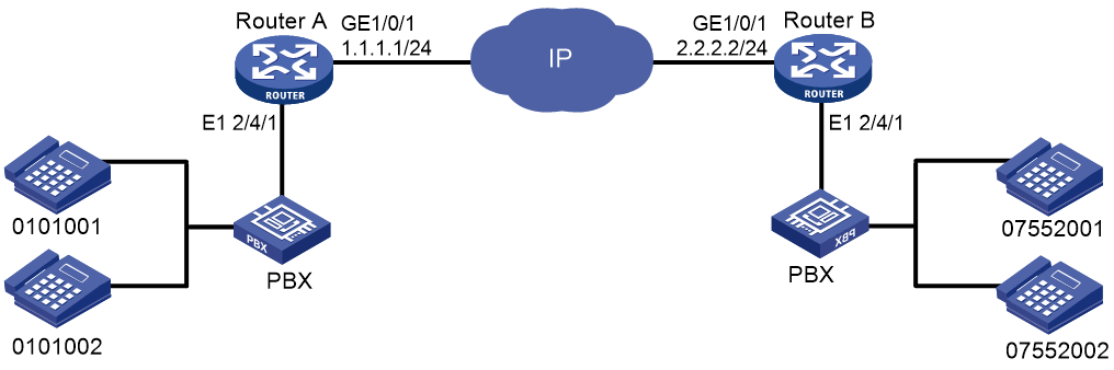

Configuring a start mode for E&M signaling
E&M signaling supports the following start modes:
· Immediate start—After off-hook, the originating side waits for a specified period of time to send the called number to the terminating side. During this period of time, the originating side does not check whether the terminating side is ready to receive the called number. The terminating side enters off-hook state after receiving the called number.
Figure 2 Immediate start
· Delay start—The originating side goes off-hook and seizes the trunk. After detecting the seizure signal from the originating side, the terminating side enters the off-hook state and remains in this state until it is ready to receive the called number. Then, the terminating side enters the on-hook state and sends a signal to indicate that the line is idle. After receiving the idle signal, the originating side sends the called number to the terminating side, which relays the call to the user phone.
Figure 3 Delay start
· Wink start—The terminating side remains in on-hook state until it receives the seizure signal from the originating side and then sends a wink to the originating side. After receiving the wink, the originating side sends the called number to the terminating side, which relays the call to the user phone.
Figure 4 Wink start
You must configure the same start mode for E&M signaling on both the originating and terminating devices.

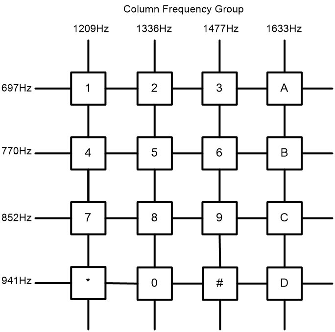

Configuring DTMF signaling
About DTMF signaling
Dual tone multifrequency signaling (DTMF signaling) uses a mixture of a high frequency tone and a lower frequency tone to represent a key on a keypad. Each column of keys is represented by a high frequency tone and each row of keys is represented by a low frequency tone. For example, as shown in Figure 6, the digit 1 is represented by the combination of a pure 697 Hz signal and a pure 1209 Hz signal. These DTMF tones offer good immunity to interference.
Figure 6 DTMF keypad frequencies
A DTMF tone must last a minimum of 45 milliseconds. A minimum interval of 23 milliseconds is required between two DTMF tones to make sure DTMF tones are recognizable. Such requirements are roughly the same in all countries. For more information, see the ITU-T Recommendation Q.24.

As shown in Figure 8, Router A and Router B are connected through an IP network and can reach each other. The PBX is configured with a trunk number 07552003.
Configure the two routers to enable Telephone B to establish a call with Telephone A through two dials.
1. On Router A, configure the local number as 0101001 for POTS entity 1001, and bind FXS interface line 2/1/1 to the POTS entity.
<RouterA> system-view
[RouterA] voice-setup
[RouterA-voice] dial-program
[RouterA-voice-dial] entity 1001 pots
[RouterA-voice-dial-entity1001] match-template 0101001
[RouterA-voice-dial-entity1001] line 2/1/1
2. Configure Router B:
# Configure the called number as 0101001 for VoIP entity 010, and configure the destination IP address as 1.1.1.1.
<RouterB> system-view
[RouterB] voice-setup
[RouterB-voice] dial-program
[RouterB-voice-dial] entity 010 voip
[RouterB-voice-dial-entity10] match-template 0101001
[RouterB-voice-dial-entity10] address sip ip 1.1.1.1
[RouterB-voice-dial-entity10] quit
# Configure the local number as 07552001 for POTS entity 2001, and bind FXO interface line 2/1/1 to POTS entity 2001.
[RouterB-voice-dial] entity 2001 pots
[RouterB-voice-dial-entity2001] match-template 07552001
[RouterB-voice-dial-entity2001] line 2/1/1
# Configure the number sending mode as all.
[RouterB-voice-dial-entity2001] send-number all
# Dial 07552003 from Telephone B.
# After hearing a dial tone, dial 0101001 (Telephone A) from Telephone B to verify that Telephone B can establish calls with Telephone A through two dials.

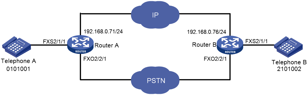

Example: Configuring PLAR for FXO interfaces
As shown in Figure 9, Router A and Router B are connected through an IP network and can reach each other. The PBX is configured with a trunk number 07552003.
Configure PLAR for the FXO interface of Router B. When the user of Telephone B dials 07552003, the FXO interface automatically calls Telephone A.
# Configure the local number as 07552001 for POTS entity 2001, and bind FXO interface line 2/1/1 to the POTS entity.
# Enable the PLAR feature and configure the delay off-hook mode for the FXO interface.
[RouterB] subscriber-line 2/1/1
[RouterB-subscriber-line2/1/1] private-line 0101001
[RouterB-subscriber-line2/1/1] hookoff-mode delay
# Dial 07552003 from Telephone B to verify that Telephone B can automatically establish calls with Telephone A through the PLAR feature.

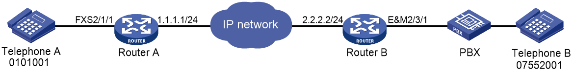

Example: Configuring E&M interfaces
As shown in Figure 10, Router A and Router B are connected through an IP network and can reach each other.
Configure the two routers to enable Telephone A and Telephone B to establish calls.
1. Configure Router A:
# Configure the called number as 07552001 for VoIP entity 0755, and configure the destination IP address as 2.2.2.2.

# Enter the view of E&M interface 5/0. The E&M interface must have the same configuration as the connected PBX.
[RouterB] subscriber-line 2/3/1
# Configure the wink start mode.
[RouterB-subscriber-line2/3/1] signal wink
# Configure the 4-wire cable type (optional, because the default is the 4-wire cable type).
[RouterB-subscriber-line2/3/1] cable 4-wire
# Configure the signal type as 5 (optional, because the default is 5).
[RouterB-subscriber-line2/3/1] type 5
# Dial 07552001 (Telephone B) from Telephone A to verify that Telephone A can establish calls with Telephone B.
# Dial 0101001 (Telephone A) from Telephone B to verify that Telephone B can establish calls with Telephone A.
Example: Configuring E&M non-signaling mode
As shown in Figure 11, configure the PLAR mode for the E&M interface on Router A. When the user of Telephone A picks up the handset, the E&M interface automatically calls Telephone B.
# Configure the called number as 2000 for VoIP entity 2000, and configure the destination IP address as 2.2.2.2.
[RouterA-voice-dial] entity 2000 voip
[RouterA-voice-dial-entity2000] match-template 2000
[RouterA-voice-dial-entity2000] address sip ip 2.2.2.2
[RouterA-voice-dial-entity2000] quit
# Configure the local number as 1000 for POTS entity 1000, and bind E&M interface line 2/3/1 to the POTS entity.
[RouterA-voice-dial] entity 1000 pots
[RouterA-voice-dial-entity1000] match-template 1000
[RouterA-voice-dial-entity1000] line 2/3/1
[RouterA-voice-dial-entity1000] return
# Enter the view of the E&M interface line 2/3/1.
[RouterA] subscriber-line 2/3/1
# Configure the immediate start mode (optional, because the default is the immediate start mode).
[RouterA-subscriber-line2/3/1] signal immediate
# Enable the PLAR feature.
[RouterA-subscriber-line2/3/1] private-line 2000
# Enable the E&M non-signaling mode.
[RouterA-subscriber-line2/3/1] open-trunk caller
# Enable E&M control signals pass-through.
[RouterA-subscriber-line2/3/1] passthrough
# Disable the echo cancellation feature.
[RouterA-subscriber-line2/3/1] undo echo-canceler enable
# Configure the called number as 1000 for VoIP entity 1000, and configure the destination IP address as 1.1.1.1.
[RouterB-voice-dial] entity 1000 voip
[RouterB-voice-dial-entity1000] match-template 1000
[RouterB-voice-dial-entity1000] address sip ip 1.1.1.1
[RouterB-voice-dial-entity1000] quit
# Configure the local number as 2000 for POTS entity 2000, and bind E&M interface line 2/3/1 to the POTS entity.
[RouterB-voice-dial] entity 2000 pots
[RouterB-voice-dial-entity2000] match-template 2000
[RouterB-voice-dial-entity2000] line 2/3/1
[RouterB-voice-dial-entity2000] return
# Configure the immediate start mode. The default is the immediate start mode.
[RouterB-subscriber-line2/3/1] signal immediate
[RouterB-subscriber-line2/3/1] open-trunk called
[RouterB-subscriber-line2/3/1] passthrough
[RouterB-subscriber-line2/3/1] undo echo-canceler enable
# Pick up the handset of Telephone A to verify that Telephone A can automatically establish calls with Telephone B through the PLAR feature.
Example: Configuring FXS&FXO 1:1 bindings
As shown in Figure 12, Telephone A calls Telephone B through the IP network. When the IP network is unavailable, Telephone A uses the bound FXO interface to call Telephone B through the PSTN network.
# Configure the called number template as 210…. for VoIP entity 210, and configure the destination IP address as 192.168.0.76.
[RouterA-voice-dial] entity 210 voip
[RouterA-voice-dial-entity210] match-template 210....
[RouterA-voice-dial-entity210] address sip ip 192.168.0.76
[RouterA-voice-dial-entity210] quit
# Configure the local number as 0101001 for POTS entity 0101001, and bind the FXS interface line 2/1/1 to the POTS entity.
[RouterA-voice-dial] entity 0101001 pots
[RouterA-voice-dial-entity101001] match-template 0101001
[RouterA-voice-dial-entity101001] line 2/1/1
[RouterA-voice-dial-entity101001] quit
# Configure the called number template as .T for POTS entity 211 used for call backup on FXO interface line 2/2/1, and configure the permitted calling number as 0101001.
[RouterA-voice-dial] entity 211 pots
[RouterA-voice-dial-entity211] match-template .T
[RouterA-voice-dial-entity211] line 2/2/1
[RouterA-voice-dial-entity211] send-number all
[RouterA-voice-dial-entity211] caller-permit 0101001
[RouterA-voice-dial-entity211] quit
[RouterA-voice-dial] quit
[RouterA-voice] quit
# Enable the PLAR feature for the FXO interface line 2/2/1, and bind the FXS interface line 2/1/1 to the FXO interface line 2/2/1.
[RouterA] subscriber-line 2/2/1
[RouterA-subscriber-line2/2/1] private-line 0101001
[RouterA-subscriber-line2/2/1] hookoff-mode delay bind 2/1/1
# Configure the called number template as 010…. for VoIP entity 010, and configure the destination IP address as 192.168.0.71.
[RouterB-voice-dial-entity10] match-template 010....
[RouterB-voice-dial-entity10] address sip ip 192.168.0.71
# Configure the local number as 2101002 for POTS entity 2101002, and bind the FXS interface line 2/1/1 to the POTS entity.
[RouterB-voice-dial] entity 2101002 pots
[RouterB-voice-dial-entity2101002] match-template 2101002
[RouterB-voice-dial-entity2101002] line 2/1/1
[RouterB-voice-dial-entity2101002] quit
# Configure the called number template as .T for POTS entity 011 used for call backup on FXO interface line 2/2/1, and configure the permitted calling number as 2101002.
[RouterB-voice-dial] entity 011 pots
[RouterB-voice-dial-entity11] match-template .T
[RouterB-voice-dial-entity11] line 2/2/1
[RouterB-voice-dial-entity11] send-number all
[RouterB-voice-dial-entity11] caller-permit 2101002
[RouterB-voice-dial-entity11] quit
[RouterB-voice-dial] quit
[RouterB-voice] quit
[RouterB] subscriber-line 2/2/1
[RouterB-subscriber-line2/2/1] private-line 2101002
[RouterB-subscriber-line2/2/1] hookoff-mode delay bind 1/0
# When the IP network is available, place a call to verify that the call is established through the IP network.
# When the IP network is unavailable, place a call to verify that the call is established through the PSTN.

Example: Configuring R2 signaling
As shown in Figure 20, configure R2 signaling on the routers so the telephones can call each other.
# Configure the IP address 1.1.1.1/24 for interface GigabitEthernet 1/0/1.
[RouterA] interface gigabitethernet 1/0/1
[RouterA-GigabitEthernet1/0/1] ip address 1.1.1.1 255.255.255.0
[RouterA-GigabitEthernet1/0/1] quit
# Create a timeslot set on interface E1 2/4/1.
[RouterA] controller e1 2/4/1
[RouterA-E1 2/4/1] timeslot-set 1 timeslot-list 1-31 signal r2
[RouterA-E1 2/4/1] quit
# Configure the local number 0101001 for POTS entity 1001, and bind the digital voice interface line 2/4/1:1 to the POTS entity.
[RouterA-voice-dial-entity1001] line 2/4/1:1
[RouterA-voice-dial-entity1001] send-number all
[RouterA-voice-dial-entity1001] quit
# Configure the local number 0101002 for POTS entity 1002, and bind the digital voice interface line 2/4/1:1 to the POTS entity.

Example: Configuring E1 DSS1 signaling
As shown in Figure 21, the routers connect to the PBXs through E1 interfaces.
Configure DSS1 signaling on the routers so the telephones can call each other.
# Bundle the timeslots on interface E1 2/4/1 into a PRI set.
[RouterA-E1 2/4/1] pri-set
# Configure the local number 0101001 for POTS entity 1001, and bind the digital voice interfaces line 2/4/1:15 to the POTS entity.
[RouterA-voice-dial-entity1001] line 2/4/1:15
# Configure the local number 0101002 for POTS entity 1002, and bind the digital voice interfaces line 2/4/1:15 to the POTS entity.
[RouterA-voice-dial] entity 1002 pots
[RouterA-voice-dial-entity1002] match-template 0101002
[RouterA-voice-dial-entity1002] line 2/4/1:15
[RouterA-voice-dial-entity1002] send-number all
[RouterA-voice-dial-entity1002] quit
# Configure the called number template 0755…. for VoIP entity 0755, and configure the destination IP address as 2.2.2.2.
[RouterA-voice-dial] entity 0755 voip
[RouterA-voice-dial-entity755] match-template 0755....
[RouterA-voice-dial-entity755] address ip 2.2.2.2
# Configure the IP address 2.2.2.2/24 for interface GigabitEthernet 1/0/1.
[RouterB-GigabitEthernet1/0/1] ip address 2.2.2.2 255.255.255.0
[RouterB-GigabitEthernet1/0/1] quit
[RouterB] controller e1 2/4/1
[RouterB-E1 2/4/1] pri-set
[RouterB-E1 2/4/1] quit
# Configure the local number 07552001 for POTS entity 2001, and bind the digital voice interfaces line 2/4/1:15 to the POTS entity.
[RouterB-voice-dial-entity2001] line 2/4/1:15
[RouterB-voice-dial-entity2001] quit
# Configure the local number 07552002 for POTS entity 2002, and bind the digital voice interfaces line 2/4/1:15 to the POTS entity.
[RouterB-voice-dial] entity 2002 pots
[RouterB-voice-dial-entity2002] match-template 07552002
[RouterB-voice-dial-entity2002] line 2/4/1:15
[RouterB-voice-dial-entity2002] send-number all
[RouterB-voice-dial-entity2002] quit
# Configure the called number template 010…. for VoIP entity 010, and configure the destination IP address as 1.1.1.1.
[RouterB-voice-dial-entity10] address ip 1.1.1.1
# Place a call from a telephone attached to Router A to a telephone attached to Router B to verify that the telephones can call each other through DSS1 signaling.
# Use the display voice subscriber-line command to display information about digital voice interfaces. (Details not shown.)
Example: Configuring BSV DSS1 signaling
As shown in Figure 22, the routers connect to the PBXs through BSV interfaces.
# Configure the local number 0101001 for POTS entity 1001, and bind the digital voice interfaces line 2/5/1 to the POTS entity.
[RouterA-voice-dial-entity1001] line 2/5/1
# Configure the local number 0101002 for POTS entity 1002, and bind the digital voice interfaces line 2/5/1 to the POTS entity.
[RouterA-voice-dial-entity1002] line 2/5/1
[RouterA-voice-dial-entity755] address sip ip 2.2.2.2
# Configure the local number 07552001 for POTS entity 2001, and bind the digital voice interfaces line 2/5/1 to the POTS entity.
[RouterB-voice-dial-entity2001] line 2/5/1
# Configure the local number 07552002 for POTS entity 2002, and bind the digital voice interfaces line 2/5/1 to the POTS entity.
[RouterB-voice-dial-entity2002] line 2/5/1
