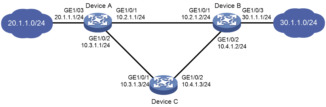

Associating Track with static routing
A static route is a manually configured route to route packets. For more information about static route configuration, see Layer 3—IP Routing Configuration Guide.
Static routes cannot adapt to network topology changes. Link failures or network topological changes can make the routes unreachable and cause communication interruption.
To resolve this problem, configure another route to back up the static route. When the static route is reachable, packets are forwarded through the static route. When the static route is unreachable, packets are forwarded through the backup route.
To check the accessibility of a static route in real time, associate the Track module with the static route.
If you specify the next hop but not the output interface when configuring a static route, you can configure the static routing-Track-detection module collaboration. This collaboration enables you to verify the accessibility of the static route based on the track entry state.
·     If the track entry is in Positive state, the following conditions exist:
¡     The next hop of the static route is reachable.
¡     The configured static route is valid.
·     If the track entry is in Negative state, the following conditions exist:
¡     The next hop of the static route is not reachable.
¡     The configured static route is invalid.
·     If the track entry is in NotReady state, the following conditions exist:
¡     The accessibility of the next hop of the static route is unknown.
¡     The static route is valid.
In static routing-Track-NQA collaboration, you must configure the same VPN instance name for the NQA operation and the next hop of the static route. Otherwise, the accessibility detection cannot operate correctly.
If a static route needs route recursion, the associated track entry must monitor the next hop of the recursive route. The next hop of the static route cannot be monitored. Otherwise, a valid route might be considered invalid.

Example: Configuring VRRP-Track-NQA collaboration
As shown in Figure 2:
·     Host A requires access to Host B. The default gateway of Host A is 10.1.1.10/24.
·     Switch A and Switch B belong to VRRP group 1. The virtual IP address of VRRP group 1 is 10.1.1.10.
Configure VRRP-Track-NQA collaboration to monitor the uplink on the master and meet the following requirements:
·     When Switch A operates correctly, Switch A forwards packets from Host A to Host B.
·     When NQA detects a fault on the uplink of Switch A, Switch B forwards packets from Host A to Host B.
Figure 2 Network diagram
1.     Create VLANs and assign ports to them. Configure the IP address of each VLAN interface, as shown in Figure 2. (Details not shown.)
2.     Configure an NQA operation on Switch A:
# Create an NQA operation with administrator name admin and operation tag test.
<SwitchA> system-view
[SwitchA] nqa entry admin test
# Specify the ICMP echo operation type.
[SwitchA-nqa-admin-test] type icmp-echo
# Specify 10.1.2.2 as the destination address of ICMP echo requests.
[SwitchA-nqa-admin-test-icmp-echo] destination ip 10.1.2.2
# Configure the ICMP echo operation to repeat every 100 milliseconds.
[SwitchA-nqa-admin-test-icmp-echo] frequency 100
# Configure reaction entry 1, specifying that five consecutive probe failures trigger the Track module.
[SwitchA-nqa-admin-test-icmp-echo] reaction 1 checked-element probe-fail threshold-type consecutive 5 action-type trigger-only
[SwitchA-nqa-admin-test-icmp-echo] quit
# Start the NQA operation.
[SwitchA] nqa schedule admin test start-time now lifetime forever
3.     On Switch A, configure track entry 1, and associate it with reaction entry 1 of the NQA operation.
[SwitchA] track 1 nqa entry admin test reaction 1
[SwitchA-track-1] quit
4.     Configure VRRP on Switch A:
# Specify VRRPv2 to run on VLAN-interface 2.
[SwitchA-Vlan-interface2] vrrp version 2
# Create VRRP group 1, and configure virtual IP address 10.1.1.10 for the group.
[SwitchA-Vlan-interface2] vrrp vrid 1 virtual-ip 10.1.1.10
# Set the priority of Switch A to 110 in VRRP group 1.
[SwitchA-Vlan-interface2] vrrp vrid 1 priority 110
# Set the authentication mode of VRRP group 1 to simple, and the authentication key to hello.
[SwitchA-Vlan-interface2] vrrp vrid 1 authentication-mode simple hello
# Configure the master to send VRRP packets every 500 centiseconds.
[SwitchA-Vlan-interface2] vrrp vrid 1 timer advertise 500
# Configure Switch A to operate in preemptive mode and set the preemption delay to 5000 centiseconds.
[SwitchA-Vlan-interface2] vrrp vrid 1 preempt-mode timer delay 5000
# Associate VRRP group 1 with track entry 1 and decrease the router priority by 30 when the state of track entry 1 changes to Negative.
[SwitchA-Vlan-interface2] vrrp vrid 1 track 1 priority reduced 30
5.     Configure VRRP on Switch B:
<SwitchB> system-view
[SwitchB-Vlan-interface2] vrrp version 2
[SwitchB-Vlan-interface2] vrrp vrid 1 virtual-ip 10.1.1.10
[SwitchB-Vlan-interface2] vrrp vrid 1 authentication-mode simple hello
[SwitchB-Vlan-interface2] vrrp vrid 1 timer advertise 500
# Configure Switch B to operate in preemptive mode and set the preemption delay to 5000 centiseconds.
[SwitchB-Vlan-interface2] vrrp vrid 1 preempt-mode timer delay 5000
# Ping Host B from Host A to verify that Host B is reachable. (Details not shown.)
# Display detailed information about VRRP group 1 on Switch A.
[SwitchA-Vlan-interface2] display vrrp verbose
IPv4 Virtual Router Information:
 Running Mode      : Standard
 Total number of virtual routers : 1
   Interface Vlan-interface2
     VRID             : 1               Adver Timer  : 500
     Admin Status     : Up              State        : Master
     Config Pri       : 110             Running Pri  : 110
     Preempt Mode     : Yes             Delay Time   : 5000
     Auth Type        : Simple          Key          : ******
     Version          : 2
     Virtual IP       : 10.1.1.10
     Virtual MAC      : 0000-5e00-0101
     Master IP        : 10.1.1.1
   VRRP Track Information:
     Track Object   : 1              State : Positive          Pri Reduced : 30
# Display detailed information about VRRP group 1 on Switch B.
[SwitchB-Vlan-interface2] display vrrp verbose
     Admin Status     : Up              State        : Backup
     Config Pri       : 100             Running Pri  : 100
     Become Master    : 2200ms left
     Version          : 2
The output shows that in VRRP group 1, Switch A is the master, and Switch B is a backup. Switch A forwards packets from Host A to Host B.
# Disconnect the link between Switch A and Switch C, and verify that Host A can still ping Host B. (Details not shown.)
     Config Pri       : 110             Running Pri  : 80
     Version          : 2
     Master IP        : 10.1.1.2
     Track Object   : 1              State : Negative          Pri Reduced : 30
     Version          : 2
The output shows that Switch A becomes the backup, and Switch B becomes the master. Switch B forwards packets from Host A to Host B.

Example: Configuring static routing-Track-NQA collaboration
As shown in Figure 7:
·     Switch A is the default gateway of the hosts in network 20.1.1.0/24.
·     Switch D is the default gateway of the hosts in network 30.1.1.0/24.
·     Hosts in the two networks communicate with each other through static routes.
To ensure network availability, configure route backup and static routing-Track-NQA collaboration on Switch A and Switch D as follows:
·     On Switch A, assign a higher priority to the static route to 30.1.1.0/24 with next hop Switch B. This route is the master route. The static route to 30.1.1.0/24 with next hop Switch C acts as the backup route. When the master route is unavailable, the backup route takes effect. Switch A forwards packets to 30.1.1.0/24 through Switch C.
·     On Switch D, assign a higher priority to the static route to 20.1.1.0/24 with next hop Switch B. This route is the master route. The static route to 20.1.1.0/24 with next hop Switch C acts as the backup route. When the master route is unavailable, the backup route takes effect. Switch D forwards packets to 20.1.1.0/24 through Switch C.
Figure 7 Network diagram

Example: Configuring static routing-Track-BFD (echo mode) collaboration
As shown in Figure 8:
·     Switch B is the default gateway of the hosts in network 30.1.1.0/24.
To ensure network availability, configure route backup and static routing-Track-BFD (echo mode) collaboration on Switch A and Switch B as follows:
·     On Switch A, assign a higher priority to the static route to 30.1.1.0/24 with next hop Switch B. This route is the master route. The static route to 30.1.1.0/24 with next hop Switch C acts as the backup route. When the master route is unavailable, the echo-mode BFD session can quickly detect the route failure to make the backup route take effect.
·     On Switch B, assign a higher priority to the static route to 20.1.1.0/24 with next hop Switch A. This route is the master route. The static route to 20.1.1.0/24 with next hop Switch C acts as the backup route. When the master route is unavailable, the echo-mode BFD session can quickly detect the route failure to make the backup route take effect.
Figure 8 Network diagram
1.     Create VLANs and assign ports to them. Configure the IP address of each VLAN interface, as shown in Figure 8. (Details not shown.)
2.     Configure Switch A:
# Configure a static route to 30.1.1.0/24 with next hop 10.2.1.2 and the default priority (60). Associate this static route with track entry 1.

Example: Configuring static routing-Track-BFD (control mode) collaboration
As shown in Figure 9:
To ensure network availability, configure route backup and static routing-Track-BFD (control mode) collaboration on Switch A and Switch B as follows:
·     On Switch A, assign a higher priority to the static route to 30.1.1.0/24 with next hop Switch B. This route is the master route. The static route to 30.1.1.0/24 with next hop Switch C acts as the backup route. When the master route is unavailable, the control-mode BFD session can quickly detect the route failure to make the backup route take effect.
·     On Switch B, assign a higher priority to the static route to 20.1.1.0/24 with next hop Switch A. This route is the master route. The static route to 20.1.1.0/24 with next hop Switch C acts as the backup route. When the master route is unavailable, the control-mode BFD session can quickly detect the route failure to make the backup route take effect.
Figure 9 Network diagram
1.     Create VLANs and assign ports to them. Configure the IP address of each VLAN interface, as shown in Figure 9. (Details not shown.)

Example: Configuring static routing-Track-LLDP collaboration
Network requirements
As shown in Figure 12:
·     Device A is the default gateway of the hosts in network 20.1.1.0/24.
·     Device B is the default gateway of the hosts in network 30.1.1.0/24.
To ensure network availability, configure route backup and static routing-Track-LLDP collaboration on Device A and Device B as follows:
·     On Device A, assign a higher priority to the static route to 30.1.1.0/24 with next hop Device B. This route is the master route. The static route to 30.1.1.0/24 with next hop Device C acts as the backup route. When the master route is unavailable, the backup route takes effect. Device A forwards packets destined for 30.1.1.0/24 to Device C.
·     On Device B, assign a higher priority to the static route to 20.1.1.0/24 with next hop Device A. This route is the master route. The static route to 20.1.1.0/24 with next hop Device C acts as the backup route. When the master route is unavailable, the backup route takes effect. Device B forwards packets destined for 20.1.1.0/24 to Device C.
Figure 12 Network diagram
1.     Configure the IP address of each interface, as shown in Figure 12. (Details not shown.)
2.     Configure Device A:
# Configure a static route to 30.1.1.0/24 with next hop 10.1.1.2 and the default priority (60). Associate this static route with track entry 1.
<DeviceA> system-view
[DeviceA] ip route-static 30.1.1.0 24 10.2.1.2 track 1
# Configure a static route to 30.1.1.0/24 with next hop 10.3.1.3 and priority 80.
[DeviceA] ip route-static 30.1.1.0 24 10.3.1.3 preference 80

# Configure track entry 1 and associate it with the availability of the neighbor for LLDP interface Gigabitethernet 1/0/1.
[DeviceA] track 1 lldp neighbor interface gigabitethernet 1/0/1
[DeviceA-track-1] quit

# Display track entry information on Device A.
[DeviceA] display track all
Track ID: 1
  State: Positive
  Duration: 0 days 0 hours 0 minutes 32 seconds
  Tracked object type: LLDP
  Notification delay: Positive 0, Negative 0 (in seconds)
  Tracked object:
    LLDP interface: GigabitEthernet1/0/1
The output shows that the status of track entry 1 is Positive, indicating that the neighbor of LLDP interface GigabitEthernet 1/0/1 is available. The master route takes effect.

30.1.1.0/24         Static 60   0            10.2.1.2        GE1/0/1
127.0.0.0/8         Direct 0    0            127.0.0.1       InLoop0
127.0.0.1/32        Direct 0    0            127.0.0.1       InLoop0
The output shows that Device A forwards packets to 30.1.1.0/24 through Device B.
# On Device B, disable LLDP on GigabitEthernet 1/0/1.
<DeviceB> system-view
[DeviceB-GigabitEthernet1/0/1] undo lldp enable
Track ID: 1
  State: Negative
  Tracked object:
The output shows that the status of track entry 1 is Negative, indicating that the neighbor of LLDP interface GigabitEthernet 1/0/1 is unavailable. The master route fails.
# Display the routing table of Device A.
[DeviceA] display ip routing-table
Destinations : 9        Routes : 9
10.2.1.0/24         Direct 0    0            10.2.1.1        GE1/0/1
10.2.1.1/32         Direct 0    0            127.0.0.1       InLoop0
10.3.1.0/24         Direct 0    0            10.3.1.1        GE1/0/2
10.3.1.1/32         Direct 0    0            127.0.0.1       InLoop0
20.1.1.0/24         Direct 0    0            20.1.1.1        GE1/0/3
20.1.1.1/32         Direct 0    0            127.0.0.1       InLoop0
30.1.1.0/24         Static 80   0            10.3.1.3        GE1/0/2
The output shows that Device A forwards packets destined for 30.1.1.0/24 to Device C. The backup static route has taken effect.
# Verify that hosts in 20.1.1.0/24 can communicate with the hosts in 30.1.1.0/24 when the master route fails.
[DeviceA] ping -a 20.1.1.1 30.1.1.1
Ping 30.1.1.1: 56  data bytes, press CTRL_C to break
Reply from 30.1.1.1: bytes=56 Sequence=1 ttl=254 time=2 ms
Reply from 30.1.1.1: bytes=56 Sequence=2 ttl=254 time=1 ms
Reply from 30.1.1.1: bytes=56 Sequence=3 ttl=254 time=1 ms
Reply from 30.1.1.1: bytes=56 Sequence=4 ttl=254 time=2 ms
Reply from 30.1.1.1: bytes=56 Sequence=5 ttl=254 time=1 ms
--- Ping statistics for 30.1.1.1 ---
5 packet(s) transmitted, 5 packet(s) received, 0.00% packet loss
round-trip min/avg/max/std-dev = 1/1/2/1 ms
# Verify that the hosts in 30.1.1.0/24 can communicate with the hosts in 20.1.1.0/24 when the master route fails.
[DeviceB] ping -a 30.1.1.1 20.1.1.1
Ping 20.1.1.1: 56  data bytes, press CTRL_C to break
Reply from 20.1.1.1: bytes=56 Sequence=1 ttl=254 time=2 ms
Reply from 20.1.1.1: bytes=56 Sequence=2 ttl=254 time=1 ms
Reply from 20.1.1.1: bytes=56 Sequence=3 ttl=254 time=1 ms
Reply from 20.1.1.1: bytes=56 Sequence=4 ttl=254 time=1 ms
Reply from 20.1.1.1: bytes=56 Sequence=5 ttl=254 time=1 ms
--- Ping statistics for 20.1.1.1 ---
Example: Configuring Smart Link-Track-CFD collaboration
For information about the Smart Link-Track-CFD collaboration configuration example, see "Configuring Smart Link."
