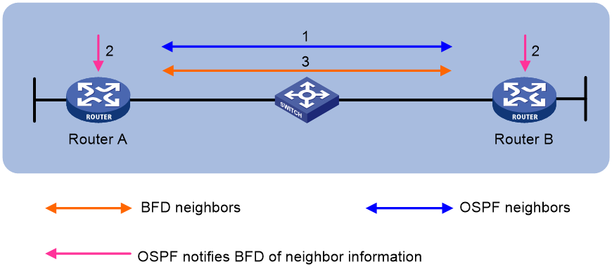

Figure 1 describes the operation of BFD for OSPF.
1.     OSPF discovers neighbors by sending Hello packets and establishes neighbor relationships.
2.     After establishing neighbor relationships, OSPF notifies BFD of the neighbor information, including destination and source addresses.
3.     BFD uses the information to establish BFD sessions.
Figure 1 BFD session establishment

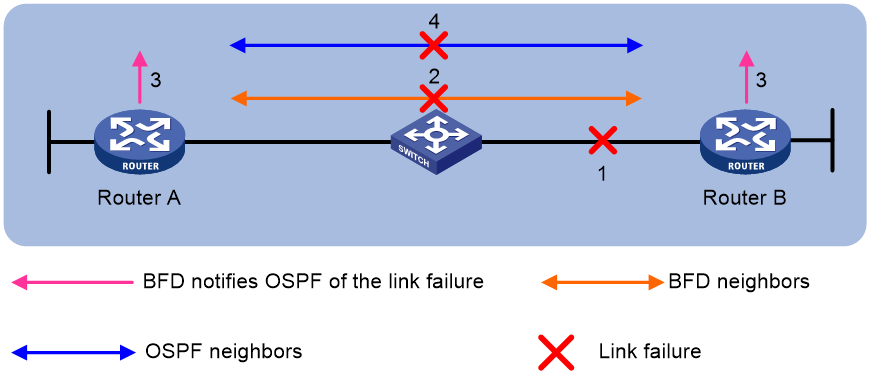

Figure 2 describes the BFD fault detection process.
1.     BFD detects a link failure and tears down the session.
2.     BFD notifies the neighbor unreachability to OSPF.
3.     OSPF terminates the neighbor relationship on the link.
Figure 2 BFD fault detection
