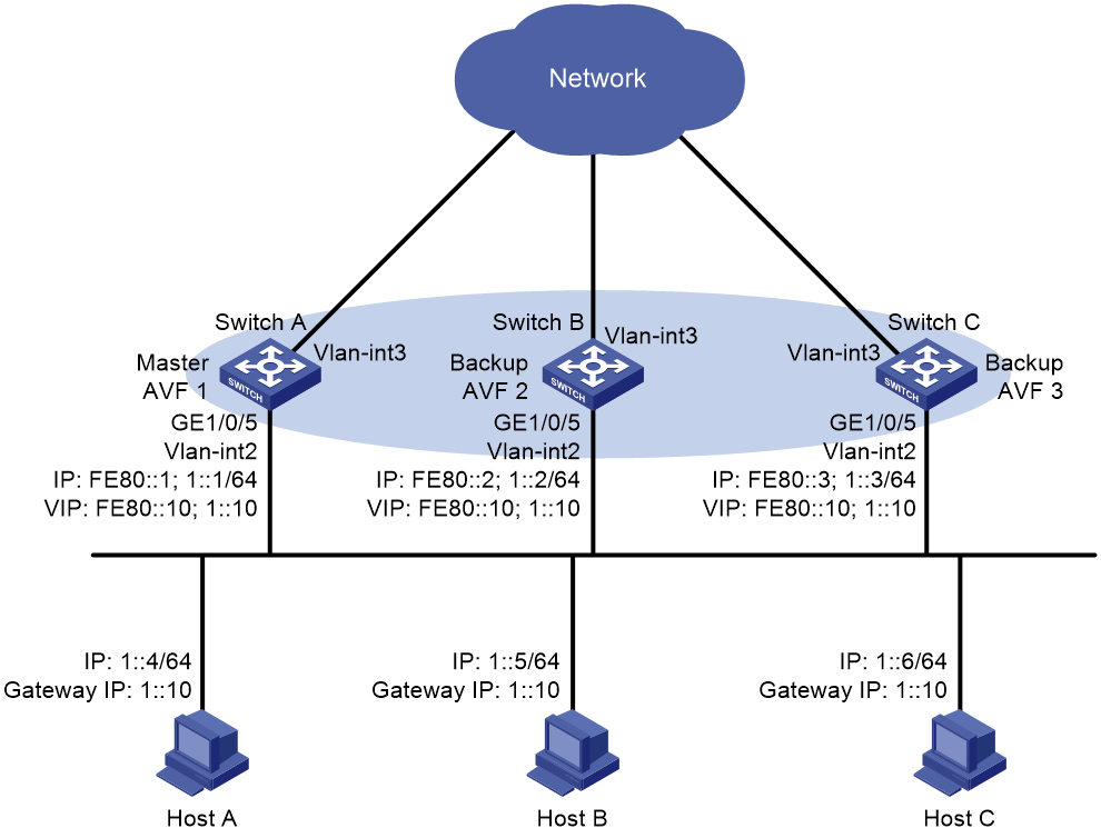

VRRP load balancing mode
In a standard-mode VRRP group, only the master can forward packets and backups are in listening state. You can create multiple VRRP groups to share traffic, but you must configure different gateways for hosts on the subnet.
In load balancing mode, a VRRP group maps its virtual IP address to multiple virtual MAC addresses, assigning one virtual MAC address to each member router. Every router in this VRRP group can forward traffic and respond to IPv4 ARP requests or IPv6 ND requests from hosts. Because their virtual MAC addresses are different, traffic from hosts is distributed across the VRRP group members. Load balancing mode simplifies configuration and improves forwarding efficiency.
VRRP load balancing mode uses the same master election, preemption, and tracking mechanisms as the standard mode. New mechanisms have been introduced to VRRP load balancing mode, as described in the following sections.
Virtual MAC address assignment
In load balancing mode, the master assigns virtual MAC addresses to routers in the VRRP group. The master uses different MAC addresses to respond to ARP requests or ND requests from different hosts. The backup routers, however, do not answer ARP requests or ND requests from hosts.
In an IPv4 network, a load balanced VRRP group works as follows:
1.     The master assigns virtual MAC addresses to all member routers, including itself. This example assumes that the virtual IP address of the VRRP group is 10.1.1.1/24, Router A is the master, and Router B is the backup. Router A assigns 000f-e2ff-0011 for itself and 000f-e2ff-0012 for Router B. See Figure 5.
Figure 5 Virtual MAC address assignment
2.     When an ARP request arrives, the master (Router A) selects a virtual MAC address based on the load balancing algorithm to answer the ARP request. In this example, Router A returns the virtual MAC address of itself in response to the ARP request from Host A. Router A returns the virtual MAC address of Router B in response to the ARP request from Host B. See Figure 6.
Figure 6 Answering ARP requests
3.     Each host sends packets to the returned MAC address. As shown in Figure 7, Host A sends packets to Router A and Host B sends packets to Router B.
Figure 7 Sending packets to different routers for forwarding
In the ARP reply sent by the master, the source MAC address in the Ethernet header is different from the sender MAC address in the message body. For the Layer 2 device to forward the ARP packet, follow these configuration guidelines on the Layer 2 device:

The VFs corresponding to a virtual MAC address on different routers in the VRRP group back up one another.
Figure 8 VF information
Figure 8 shows the VF table on each router in the VRRP group and how the VFs back up one another. The master, Router A, assigns virtual MAC addresses 000f-e2ff-0011, 000f-e2ff-0012, and 000f-e2ff-0013 to itself, Router B, and Router C, respectively. Each router creates VF 1, VF 2, and VF 3 for virtual MAC addresses 000f-e2ff-0011, 000f-e2ff-0012, and 000f-e2ff-0013, respectively. The VFs for the same virtual MAC address on different routers back up one another. For example, the VF 1 instances on Router A, Router B, and Router C back up one another.
·     The VF 1 instance on Router A (the VF 1 owner) has priority 255. It acts as the AVF to forward packets sent to virtual MAC address 000f-e2ff-0011.
·     The VF 1 instances on Router B and Router C have a priority of 255/(1 + 1), or 127. Because their priorities are lower than the priority of the VF 1 instance on Router A, they act as LVFs. These LVFs listen to the state of the VF 1 instance on Router A.
·     When the VF 1 instance on Router A fails, the VF 1 instances on Router B and Router C elect the one with higher priority as the new AVF. This AVF forwards packets destined for virtual MAC address 000f-e2ff-0011. If the two LVFs' priorities are the same, the LVF with a greater device MAC address becomes the new AVF.
A VF always operates in preemptive mode. When an LVF finds its priority value higher than the one advertised by the AVF, the LVF declares itself as the AVF.

Example: Configuring multiple VRRP groups
As shown in Figure 10, Switch A and Switch B form two VRRP groups. VRRP group 1 uses the virtual IP address 10.1.1.100/25 to provide gateway service for hosts in VLAN 2, and VRRP group 2 uses the virtual IP address 10.1.1.200/25 to provide gateway service for hosts in VLAN 3.
Assign a higher priority to Switch A than Switch B in VRRP group 1, but a lower priority in VRRP group 2. Traffic from VLAN 2 and VLAN 3 can then be distributed between the two switches. When one of the switches fails, the healthy switch provides gateway service for both VLANs.
Figure 10 Network diagram
1.     Configure Switch A:

Example: Configuring VRRP load balancing
As shown in Figure 11, Switch A, Switch B, and Switch C form a load-balanced VRRP group. They use the virtual IP address 10.1.1.1/24 to provide gateway service for subnet 10.1.1.0/24.
Configure VFs on Switch A, Switch B, and Switch C to monitor their respective VLAN-interface 3. When the interface on any one of them fails, the weights of the VFs on the problematic switch decrease so another AVF can take over.
Figure 11 Network diagram
# Configure VLAN 2.
<SwitchA> system-view
[SwitchA] vlan 2
[SwitchA-vlan2] port gigabitethernet 1/0/5
[SwitchA-vlan2] quit
# Configure VRRP to operate in load balancing mode.
[SwitchA] vrrp mode load-balance
# Create VRRP group 1, and set its virtual IP address to 10.1.1.1.
[SwitchA-Vlan-interface2] ip address 10.1.1.2 24
[SwitchA-Vlan-interface2] vrrp vrid 1 virtual-ip 10.1.1.1
# Assign Switch A the highest priority in VRRP group 1, so Switch A can become the master.
[SwitchA-Vlan-interface2] vrrp vrid 1 priority 120
# Configure Switch A to operate in preemptive mode, so it can become the master whenever it operates correctly. Set the preemption delay to 5000 centiseconds to avoid frequent status switchover.
[SwitchA-Vlan-interface2] vrrp vrid 1 preempt-mode delay 5000
# Create track entry 1 to monitor the upstream link status of VLAN-interface 3. When the upstream link fails, the track entry transits to Negative.
[SwitchA] track 1 interface vlan-interface 3
# Configure the VFs in VRRP group 1 to monitor track entry 1, and decrease their weights by 250 when the track entry transits to Negative.
[SwitchA-Vlan-interface2] vrrp vrid 1 track 1 weight reduced 250
2.     Configure Switch B:
# Configure VLAN 2.
<SwitchB> system-view
[SwitchB] vlan 2
[SwitchB-vlan2] port gigabitethernet 1/0/5
[SwitchB-vlan2] quit
[SwitchB] vrrp mode load-balance
[SwitchB-Vlan-interface2] ip address 10.1.1.3 24
[SwitchB-Vlan-interface2] vrrp vrid 1 virtual-ip 10.1.1.1
# Assign Switch B a higher priority than Switch C in VRRP group 1, so Switch B can become the master when Switch A fails.
[SwitchB-Vlan-interface2] vrrp vrid 1 priority 110
# Configure Switch B to operate in preemptive mode, and set the preemption delay to 5000 centiseconds.
[SwitchB-Vlan-interface2] vrrp vrid 1 preempt-mode delay 5000
[SwitchB-Vlan-interface2] quit
[SwitchB] track 1 interface vlan-interface 3
[SwitchB-Vlan-interface2] vrrp vrid 1 track 1 weight reduced 250
3.     Configure Switch C:
# Configure VLAN 2.
<SwitchC> system-view
[SwitchC] vlan 2
[SwitchC-vlan2] port gigabitethernet 1/0/5
[SwitchC-vlan2] quit
[SwitchC] vrrp mode load-balance
[SwitchC] interface vlan-interface 2
[SwitchC-Vlan-interface2] ip address 10.1.1.4 24
[SwitchC-Vlan-interface2] vrrp vrid 1 virtual-ip 10.1.1.1
# Configure Switch C to operate in preemptive mode, and set the preemption delay to 5000 centiseconds.
[SwitchC-Vlan-interface2] vrrp vrid 1 preempt-mode delay 5000
[SwitchC-Vlan-interface2] quit
[SwitchC] track 1 interface vlan-interface 3
[SwitchC-Vlan-interface2] vrrp vrid 1 track 1 weight reduced 250
# Verify that Host A can ping the external network. (Details not shown.)

The output shows that Switch A is the master in VRRP group 1, and each of the three switches has one AVF and two LVFs.
# Disconnect the link of VLAN-interface 3 on Switch A, and display detailed information about VRRP group 1 on Switch A.

   Interface Vlan-interface2
     VRID             : 1                    Adver Timer  : 100
     Admin Status     : Up                   State        : Backup
     Config Pri       : 100                  Running Pri  : 100
     Preempt Mode     : Yes                  Delay Time   : 5000
     Become Master    : 401ms left
     Auth Type        : Not supported
     Version          : 3
     Virtual IP       : 10.1.1.1
     Member IP List   : 10.1.1.4 (Local, Backup)
                        10.1.1.2 (Master)
                        10.1.1.3 (Backup)
   Forwarder Information: 3 Forwarders 2 Active
     Config Weight  : 255
     Running Weight : 255
    Forwarder 01
     State          : Active
     Virtual MAC    : 000f-e2ff-0011 (Take Over)
     Owner ID       : 0000-5e01-1101
     Priority       : 85
     Active         : local
    Forwarder 02
     State          : Listening
     Virtual MAC    : 000f-e2ff-0012 (Learnt)
     Owner ID       : 0000-5e01-1103
     Priority       : 85
     Active         : 10.1.1.3
    Forwarder 03
     State          : Active
     Virtual MAC    : 000f-e2ff-0013 (Owner)
     Owner ID       : 0000-5e01-1105
     Priority       : 255
     Active         : local
   Forwarder Weight Track Information:
     Track Object   : 1          State : Positive   Weight Reduced : 250
The output shows that when VLAN-interface 3 on Switch A fails, the weights of the VFs on Switch A drop below the lower limit of failure. All VFs on Switch A transit to the Initialize state and cannot forward traffic. The VF for MAC address 000f-e2ff-0011 on Switch C becomes the AVF to forward traffic.
# When the timeout timer (about 1800 seconds) expires, display detailed information about VRRP group 1 on Switch C.
[SwitchC-Vlan-interface2] display vrrp verbose
IPv4 Virtual Router Information:
 Running Mode      : Load Balance
 Total number of virtual routers : 1
     Become Master    : 402ms left
     Version          : 3
                        10.1.1.2 (Master)
                        10.1.1.3 (Backup)
   Forwarder Information: 2 Forwarders 1 Active
     Config Weight  : 255
    Forwarder 02
     State          : Listening
     Priority       : 127
     Active         : 10.1.1.3
    Forwarder 03
     State          : Active
     Priority       : 255
     Active         : local
The output shows that when the timeout timer expires, the VF for virtual MAC address 000f-e2ff-0011 is removed. The VF no longer forwards the packets destined for the MAC address.
# When Switch A fails, display detailed information about VRRP group 1 on Switch B.
[SwitchB-Vlan-interface2] display vrrp verbose
     Admin Status     : Up                   State        : Master
     Config Pri       : 110                  Running Pri  : 110
     Version          : 3
     Member IP List   : 10.1.1.3 (Local, Master)
                        10.1.1.4 (Backup)
     Config Weight  : 255
    Forwarder 02
     State          : Active
     Virtual MAC    : 000f-e2ff-0012 (Owner)
     Priority       : 255
     Active         : local
    Forwarder 03
     State          : Listening
     Virtual MAC    : 000f-e2ff-0013 (Learnt)
     Priority       : 127
     Active         : 10.1.1.4
The output shows the following information:
·     When Switch A fails, Switch B becomes the master because it has a higher priority than Switch C.
·     The VF for virtual MAC address 000f-e2ff-0011 is removed.
As shown in Figure 14, Switch A, Switch B, and Switch C form a load balanced VRRP group. They use the virtual IPv6 addresses FE80::10 and 1::10 to provide gateway service for subnet 1::/64.
Hosts on subnet 1::/64 learn 1::10 as their default gateway from RA messages sent by the switches.
Configure VFs on Switch A, Switch B, or Switch C to monitor their respective VLAN-interface 3. When the interface on any of them fails, the weights of the VFs on the problematic switch decrease so another AVF can take over.
Figure 14 Network diagram

[SwitchC-Vlan-interface2] display vrrp ipv6 verbose
IPv6 Virtual Router Information:
     Become Master    : 400ms left
     Virtual IP       : FE80::10
                        1::10
     Member IP List   : FE80::3 (Local, Backup)
                        FE80::1 (Master)
                        FE80::2 (Backup)
     Config Weight  : 255
    Forwarder 02
     State          : Listening
     Virtual MAC    : 000f-e2ff-4012 (Learnt)
     Priority       : 127
     Active         : FE80::2
    Forwarder 03
     State          : Active
     Virtual MAC    : 000f-e2ff-4013 (Owner)
     Priority       : 255
     Active         : local
The output shows that when the timeout timer expires, the VF for virtual MAC address 000f-e2ff-4011 is removed. The VF no longer forwards the packets destined for the MAC address.
[SwitchB-Vlan-interface2] display vrrp ipv6 verbose
                        1::10
     Member IP List   : FE80::2 (Local, Master)
                        FE80::3 (Backup)
     Config Weight  : 255
    Forwarder 02
     State          : Active
     Virtual MAC    : 000f-e2ff-4012 (Owner)
     Priority       : 255
     Active         : local
    Forwarder 03
     State          : Listening
     Virtual MAC    : 000f-e2ff-4013 (Learnt)
     Priority       : 127
     Active         : FE80::3
·     The VF for virtual MAC address 000f-e2ff-4011 is removed.
