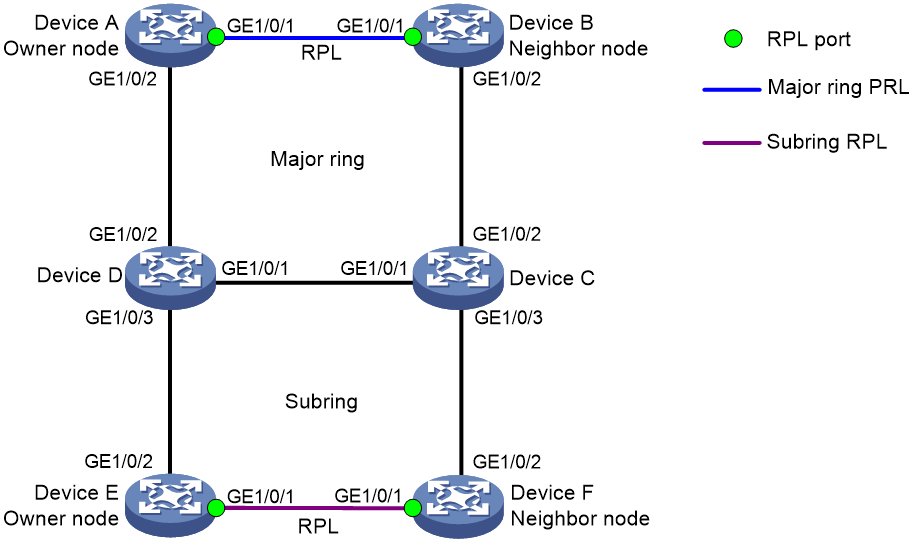

Multi-instance load balancing mechanism
Figure 4 Multi-instance load balancing mechanism
An ERPS ring topology might carry traffic from multiple VLANs. Traffic from different VLANs can be load balanced among different ERPS instances.
ERPS uses the following types of VLANs:
·     Control VLAN—Carries ERPS protocol packets. Each ERPS instance has its own control VLAN.
·     Protected VLAN—Carries data packets. Each ERPS instance has its own protected VLAN. Protected VLANs are configured by using the mappings between VLANs and MSTIs.
As shown in Figure 4, the ERPS ring is configured with instance 1 and instance 2. For instance 1, the owner node is Device A, and the RPL is the link between Device A and Device B. For instance 2, the owner node is Device C, and the RPL is the link between Device C and Device D. Traffic from different VLANs can be load balanced among different links.

Example: Configuring one ring
As shown in Figure 11, perform the following tasks to eliminate loops on the network:
·     Configure the ring as ERPS ring 1.
·     Configure VLAN 100 as the control VLAN for ERPS ring 1.
·     Configure VLANs 1 to 30 as the protected VLANs for ERPS ring 1.
·     Configure Device A as the owner node, GigabitEthernet 1/0/1 as ERPS ring member port 0 and the RPL port, and GigabitEthernet 1/0/2 as ERPS ring member port 1.
·     Configure Device B as the neighbor node, GigabitEthernet 1/0/1 as ERPS ring member port 0 and the RPL port, and GigabitEthernet 1/0/2 as ERPS ring member port 1.
·     Configure Device C and Device D as normal nodes, GigabitEthernet 1/0/1 as ERPS ring member port 0, and GigabitEthernet 1/0/2 as ERPS ring member port 1.
Figure 11 Network diagram

Example: Configuring one subring
As shown in Figure 12, perform the following tasks to eliminate loops on the network:
·     Configure VLAN 100 and VLAN 110 as the control VLANs for the major ring and the subring, respectively.
·     Configure VLANs 1 to 30 as the protected VLANs for the major ring and subring.
·     Configure Device A as the owner node for the major ring, GigabitEthernet 1/0/1 as ERPS ring member port 0 and the RPL port, and GigabitEthernet 1/0/2 as ERPS ring member port 1.
·     Configure Device B as the neighbor node for the major ring, GigabitEthernet 1/0/1 as ERPS ring member port 0 and the RPL port, and GigabitEthernet 1/0/2 as ERPS ring member port 1.
·     Configure Devices C and D as interconnection nodes, GigabitEthernet 1/0/1 as ERPS ring member port 0, GigabitEthernet 1/0/2 as ERPS ring member port 1, and GigabitEthernet 1/0/3 as the interconnection port.
·     Configure Device E as the owner node for the subring, GigabitEthernet 1/0/1 as ERPS ring member port 0 and the RPL port, and GigabitEthernet 1/0/2 as ERPS ring member port 1.
·     Configure Device F as the neighbor node for the subring, GigabitEthernet 1/0/1 as ERPS ring member port 0 and the RPL port, and GigabitEthernet 1/0/2 as ERPS ring member port 1.
Figure 12 Network diagram

# Configure GigabitEthernet 1/0/2 in the same way GigabitEthernet 1/0/1 is configured.
[DeviceA] interface gigabitethernet 1/0/2
[DeviceA-GigabitEthernet1/0/2] link-delay up 0
[DeviceA-GigabitEthernet1/0/2] link-delay down 0
[DeviceA-GigabitEthernet1/0/2] undo stp enable
[DeviceA-GigabitEthernet1/0/2] port link-type trunk
[DeviceA-GigabitEthernet1/0/2] port trunk permit vlan 1 to 30
[DeviceA-GigabitEthernet1/0/2] quit
# Create ERPS ring 1.
[DeviceA] erps ring 1
# Configure ERPS ring member ports.
[DeviceA-erps-ring1] port0 interface gigabitethernet 1/0/1
[DeviceA-erps-ring1] port1 interface gigabitethernet 1/0/2
# Create ERPS instance 1.
[DeviceA-erps-ring1] instance 1
# Configure the node role.
[DeviceA-erps-ring1-inst1] node-role owner rpl port0
# Configure the control VLAN.
[DeviceA-erps-ring1-inst1] control-vlan 100
# Configure the protected VLANs.
[DeviceA-erps-ring1-inst1] protected-vlan reference-instance 1
# Enable ERPS for instance 1.
[DeviceA-erps-ring1-inst1] instance enable
[DeviceA-erps-ring1-inst1] quit
[DeviceA-erps-ring1] quit
# Enable CFD, and create a level-5 MD named MD_A.
[DeviceA] cfd enable
[DeviceA] cfd md MD_A level 5
# Create service instance 1, in which the MA is identified by a VLAN and serves VLAN 1.
[DeviceA] cfd service-instance 1 ma-id vlan-based md MD_A vlan 1
# Configure a MEP list in service instance 1, create outward-facing MEP 1001 in service instance 1, and enable CCM sending on GigabitEthernet 1/0/1.
[DeviceA] cfd meplist 1001 1002 service-instance 1
[DeviceA-GigabitEthernet1/0/1] cfd mep 1001 service-instance 1 outbound
[DeviceA-GigabitEthernet1/0/1] cfd cc service-instance 1 mep 1001 enable
[DeviceA-GigabitEthernet1/0/1] quit
# Create service instance 2, in which the MA is identified by a VLAN and serves VLAN 2.
[DeviceA] cfd service-instance 2 ma-id vlan-based md MD_A vlan 2
# Configure a MEP list in service instance 2, create outward-facing MEP 2001 in service instance 1, and enable CCM sending on GigabitEthernet 1/0/2.
[DeviceA] cfd meplist 2001 2002 service-instance 2
[DeviceA-GigabitEthernet1/0/2] cfd mep 2001 service-instance 2 outbound
[DeviceA-GigabitEthernet1/0/2] cfd cc service-instance 2 mep 2001 enable
# Create track entry 1 and associate it with the CC function of CFD for MEP 1001 in service instance 1.
[DeviceA] track 1 cfd cc service-instance 1 mep 1001
# Associate GigabitEthernet 1/0/1 with track entry 1 and bring up the port.
[DeviceA-GigabitEthernet1/0/1] port erps ring 1 instance 1 track 1
[DeviceA-GigabitEthernet1/0/1] undo shutdown
# Create track entry 2 and associate it with the CC function of CFD for MEP 2001 in service instance 2.
[DeviceA] track 2 cfd cc service-instance 2 mep 2001
# Associate GigabitEthernet 1/0/2 with track entry 2 and bring up the port.
[DeviceA-GigabitEthernet1/0/2] port erps ring 1 instance 1 track 2
[DeviceA-GigabitEthernet1/0/2] undo shutdown
# Enable ERPS.
[DeviceA] erps enable
2.     Configure Device B.
# Create VLANs 1 to 30, map these VLANs to MSTI 1, and activate the MST region configuration.
<DeviceB> system-view
[DeviceB] vlan 1 to 30
[DeviceB] stp region-configuration
[DeviceB-mst-region] instance 1 vlan 1 to 30
[DeviceB-mst-region] active region-configuration
[DeviceB-mst-region] quit
# Set the link state change suppression interval to 0 seconds on GigabitEthernet 1/0/1.
[DeviceB-GigabitEthernet1/0/1] link-delay up 0
[DeviceB-GigabitEthernet1/0/1] link-delay down 0
# Disable the spanning tree feature on the port.
[DeviceB-GigabitEthernet1/0/1] undo stp enable
# Configure the port as a trunk port and assign it to VLANs 1 to 30.
[DeviceB-GigabitEthernet1/0/1] port link-type trunk
[DeviceB-GigabitEthernet1/0/1] port trunk permit vlan 1 to 30
[DeviceB-GigabitEthernet1/0/1] quit
[DeviceB] interface gigabitethernet 1/0/2
[DeviceB-GigabitEthernet1/0/2] link-delay up 0
[DeviceB-GigabitEthernet1/0/2] link-delay down 0
[DeviceB-GigabitEthernet1/0/2] undo stp enable
[DeviceB-GigabitEthernet1/0/2] port link-type trunk
[DeviceB-GigabitEthernet1/0/2] port trunk permit vlan 1 to 30
[DeviceB-GigabitEthernet1/0/2] quit
[DeviceB] erps ring 1
[DeviceB-erps-ring1] port0 interface gigabitethernet 1/0/1
[DeviceB-erps-ring1] port1 interface gigabitethernet 1/0/2
[DeviceB-erps-ring1] instance 1
[DeviceB-erps-ring1-inst1] node-role neighbor rpl port0
[DeviceB-erps-ring1-inst1] control-vlan 100
[DeviceB-erps-ring1-inst1] protected-vlan reference-instance 1
[DeviceB-erps-ring1-inst1] instance enable
[DeviceB-erps-ring1-inst1] quit
[DeviceB-erps-ring1] quit
[DeviceB] cfd enable
[DeviceB] cfd md MD_A level 5
[DeviceB] cfd service-instance 1 ma-id vlan-based md MD_A vlan 1
# Configure a MEP list in service instance 1, create outward-facing MEP 1002 in service instance 1, and enable CCM sending on GigabitEthernet 1/0/1.
[DeviceB] cfd meplist 1001 1002 service-instance 1
[DeviceB-GigabitEthernet1/0/1] cfd mep 1002 service-instance 1 outbound
[DeviceB-GigabitEthernet1/0/1] cfd cc service-instance 1 mep 1002 enable
# Create service instance 3, in which the MA is identified by a VLAN and serves VLAN 3.
[DeviceB] cfd service-instance 3 ma-id vlan-based md MD_A vlan 3
# Configure a MEP list in service instance 3, create outward-facing MEP 3002 in service instance 2, and enable CCM sending on GigabitEthernet 1/0/2.
[DeviceB] cfd meplist 3001 3002 service-instance 3
[DeviceB-GigabitEthernet1/0/2] cfd mep 3002 service-instance 3 outbound
[DeviceB-GigabitEthernet1/0/2] cfd cc service-instance 3 mep 3002 enable
# Create track entry 1 and associate it with the CC function of CFD for MEP 1002 in service instance 1.
[DeviceB] track 1 cfd cc service-instance 1 mep 1002
[DeviceB-GigabitEthernet1/0/1] port erps ring 1 instance 1 track 1
[DeviceB-GigabitEthernet1/0/1] undo shutdown
# Create track entry 3 and associate it with the CC function of CFD for MEP 3002 in service instance 3.
[DeviceB] track 3 cfd cc service-instance 3 mep 3002
# Associate GigabitEthernet 1/0/2 with track entry 3 and bring up the port.
[DeviceB-GigabitEthernet1/0/2] port erps ring 1 instance 1 track 2
[DeviceB-GigabitEthernet1/0/2] undo shutdown
# Enable ERPS.
[DeviceB] erps enable
3.     Configure Device C.
<DeviceC> system-view
[DeviceC] vlan 1 to 30
[DeviceC] stp region-configuration
[DeviceC-mst-region] instance 1 vlan 1 to 30
[DeviceC-mst-region] active region-configuration
[DeviceC-mst-region] quit
[DeviceC] interface gigabitethernet 1/0/1
[DeviceC-GigabitEthernet1/0/1] link-delay up 0
[DeviceC-GigabitEthernet1/0/1] link-delay down 0
[DeviceC-GigabitEthernet1/0/1] undo stp enable
[DeviceC-GigabitEthernet1/0/1] port link-type trunk
[DeviceC-GigabitEthernet1/0/1] port trunk permit vlan 1 to 30
[DeviceC-GigabitEthernet1/0/1] quit
[DeviceC] interface gigabitethernet 1/0/2
[DeviceC-GigabitEthernet1/0/2] link-delay up 0
[DeviceC-GigabitEthernet1/0/2] link-delay down 0
[DeviceC-GigabitEthernet1/0/2] undo stp enable
[DeviceC-GigabitEthernet1/0/2] port link-type trunk
[DeviceC-GigabitEthernet1/0/2] port trunk permit vlan 1 to 30
[DeviceC-GigabitEthernet1/0/2] quit
# Configure GigabitEthernet 1/0/3 in the same way GigabitEthernet 1/0/1 is configured.
[DeviceC] interface gigabitethernet 1/0/3
[DeviceC-GigabitEthernet1/0/3] link-delay up 0
[DeviceC-GigabitEthernet1/0/3] link-delay down 0
[DeviceC-GigabitEthernet1/0/3] undo stp enable
[DeviceC-GigabitEthernet1/0/3] port link-type trunk
[DeviceC-GigabitEthernet1/0/3] port trunk permit vlan 1 to 30
[DeviceC-GigabitEthernet1/0/3] quit
[DeviceC] erps ring 1
[DeviceC-erps-ring1] port0 interface gigabitethernet 1/0/1
[DeviceC-erps-ring1] port1 interface gigabitethernet 1/0/2
[DeviceC-erps-ring1] instance 1
[DeviceC-erps-ring1-inst1] control-vlan 100
[DeviceC-erps-ring1-inst1] protected-vlan reference-instance 1
[DeviceC-erps-ring1-inst1] instance enable
[DeviceC-erps-ring1-inst1] quit
[DeviceC-erps-ring1] quit
[DeviceC] cfd enable
[DeviceC] cfd md MD_A level 5
[DeviceC] cfd service-instance 3 ma-id vlan-based md MD_A vlan 3
# Configure a MEP list in service instance 3, create outward-facing MEP 3001 in service instance 3, and enable CCM sending on GigabitEthernet 1/0/2.
[DeviceC] cfd meplist 3001 3002 service-instance 3
[DeviceC-GigabitEthernet1/0/2] cfd mep 3001 service-instance 3 outbound
[DeviceC-GigabitEthernet1/0/2] cfd cc service-instance 3 mep 3001 enable
# Create service instance 4, in which the MA is identified by a VLAN and serves VLAN 4.
[DeviceC] cfd service-instance 4 ma-id vlan-based md MD_A vlan 4
# Configure a MEP list in service instance 4, create outward-facing MEP 4001 in service instance 4, and enable CCM sending on GigabitEthernet 1/0/1.
[DeviceC] cfd meplist 4001 4002 service-instance 4
[DeviceC-GigabitEthernet1/0/1] cfd mep 4001 service-instance 4 outbound
[DeviceC-GigabitEthernet1/0/1] cfd cc service-instance 4 mep 4001 enable
# Create track entry 1 and associate it with the CC function of CFD for MEP 3001 in service instance 3.
[DeviceC] track 1 cfd cc service-instance 3 mep 3001
# Associate GigabitEthernet 1/0/2 with track entry 1 and bring up the port.
[DeviceC-GigabitEthernet1/0/2] port erps ring 1 instance 1 track 1
[DeviceC-GigabitEthernet1/0/2] undo shutdown
# Create track entry 2 and associate it with the CC function of CFD for MEP 4001 in service instance 4.
[DeviceC] track 2 cfd cc service-instance 4 mep 4001
# Associate GigabitEthernet 1/0/1 with track entry 2 and bring up the port.
[DeviceC-GigabitEthernet1/0/1] port erps ring 1 instance 1 track 2
[DeviceC-GigabitEthernet1/0/1] undo shutdown
# Create ERPS ring 2.
[DeviceC] erps ring 2
[DeviceC-erps-ring2] port0 interface gigabitethernet 1/0/3
# Configure ERPS ring 2 as the subring.
[DeviceC-erps-ring2] ring-type sub-ring
[DeviceC-erps-ring2] instance 1
[DeviceC-erps-ring2-inst1] node-role interconnection port0
[DeviceC-erps-ring2-inst1] control-vlan 110
[DeviceC-erps-ring2-inst1] protected-vlan reference-instance 1
[DeviceC-erps-ring2-inst1] instance enable
[DeviceC-erps-ring2-inst1] quit
[DeviceC-erps-ring2] quit
# Create service instance 5, in which the MA is identified by a VLAN and serves VLAN 5.
[DeviceC] cfd service-instance 5 ma-id vlan-based md MD_A vlan 5
# Configure a MEP list in service instance 5, create outward-facing MEP 5001 in service instance 3, and enable CCM sending on GigabitEthernet 1/0/3.
[DeviceC] cfd meplist 5001 5002 service-instance 5
[DeviceC-GigabitEthernet1/0/3] cfd mep 5001 service-instance 5 outbound
[DeviceC-GigabitEthernet1/0/3] cfd cc service-instance 5 mep 5001 enable
# Create track entry 3 and associate it with the CC function of CFD for MEP 5001 in service instance 3.
[DeviceC] track 3 cfd cc service-instance 5 mep 5001
# Associate GigabitEthernet 1/0/3 with track entry 3 and bring up the port.
[DeviceC-GigabitEthernet1/0/3] port erps ring 2 instance 1 track 3
[DeviceC-GigabitEthernet1/0/3] undo shutdown
# Enable ERPS.
[DeviceC] erps enable

Example: Configuring one-ring multi-instance load balancing
As shown in Figure 13, perform the following tasks to improve network resource utilization and implement load balancing among links:
·     Configure ERPS instances 1 and 2 on the ERPS ring.
·     For ERPS instance 1, configure the following items:
¡     Configure Device A as the owner node.
¡     Configure the link between Devices A and Device B as the RPL.
¡     Configure VLAN 100 as the control VLAN.
¡     Configure VLANs 1 to 30 as the protected VLANs.
·     For ERPS instance 2, configure the following items:
¡     Configure the link between Devices C and Device D as the RPL.
¡     Configure VLANs 31 to 60 as the protected VLANs.
Figure 13 Network diagram
1.     Configure Device A.
# Create VLANs 1 to 60, map VLANs 1 to 30 to MSTI 1, map VLANs 31 to 60 to MSTI 2, and activate the MST region configuration.
# Create ERPS instance 2.
[DeviceC-erps-ring1] instance 2
[DeviceC-erps-ring1-inst2] node-role owner rpl port0
[DeviceC-erps-ring1-inst2] control-vlan 110
[DeviceC-erps-ring1-inst2] protected-vlan reference-instance 2
# Enable ERPS for instance 2.
[DeviceC-erps-ring1-inst2] instance enable
[DeviceC-erps-ring1-inst2] quit
# Associate GigabitEthernet 1/0/2 with track entry 1 and bring up the port for ERPS instances 1 and 2.
[DeviceC-GigabitEthernet1/0/2] port erps ring 1 instance 2 track 1
# Associate GigabitEthernet 1/0/1 with track entry 2 and bring up the port for ERPS instances 1 and 2.
[DeviceC-GigabitEthernet1/0/1] port erps ring 1 instance 2 track 2
# Enable ERPS.
