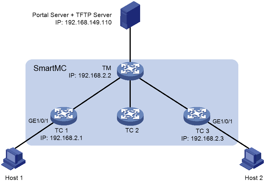

Example: Configuring static endpoint identification
As shown in Figure 3, the SmartMC network is established manually. Configure the devices in SmartMC network so EPA can automatically identify camera 1 and camera 2 when they access the SmartMC network.
Figure 3 Network diagram

2.     Configure static endpoint identification rules on the commander.
[TM] epa monitor-rule mac 1-1-1
[TM] epa monitor-rule mac 2-2-2
Configuring TC 1

Configuring TC 3
# Configure TC 3 in the same way TC 1 is configured. (Details not shown.)
# On TC 1, display the online and offline information of endpoints.
[TC1] display epa monitor-information
Local device type   : SmartMC TC
Local device ID     : 3acc-58e2-0100
Endpoint information:
  Access device ID    MAC address     VLAN    Interface                  Status
  3acc-58e2-0100      0001-0001-0001  1        GE1/0/1                     Online
# On the TM, display the online and offline information of endpoints.
[TM] display epa monitor-information
Local device type   : SmartMC TM
  3acc-58e2-0300      0002-0002-0002  1        GE1/0/1                     Online

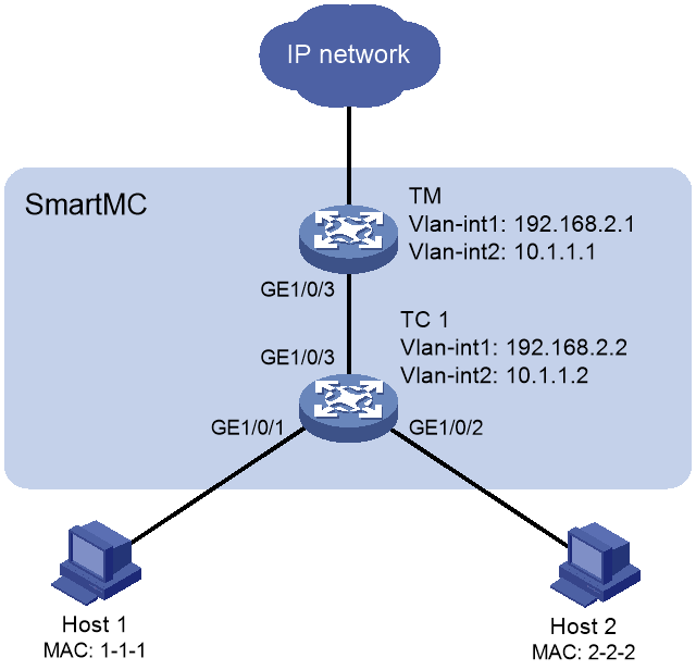

Example: Configuring automatic endpoint identification (portal authentication)
As shown in Figure 4, the SmartMC network is established automatically. Configure the devices in SmartMC network so EPA can automatically identify host 1 and host 2 when they access the SmartMC network through portal authentication.
Figure 4 Network diagram

# Configure VLAN-interface 1.
<TC1> system-view
[TC1] interface vlan-interface 1
[TC1-Vlan-interface1] ip address 192.168.2.2 24
[TC1-Vlan-interface1] quit
# Enable HTTP and HTTPS.
[TC1] ip http enable
[TC1] ip https enable
# Enable the Telnet service.
[TC1] telnet server enable
# Enable NETCONF over SOAP over HTTP.
[TC1] netconf soap http enable
# Enable LLDP globally.
[TC1] lldp global enable
# Create a user named admin.
[TC1] local-user admin
# Lower password complexity requirements. For more information about these commands, see password control commands in Security Command Reference.
[TC1-luser-manage-admin] password-control length 4
[TC1-luser-manage-admin] password-control composition type-number 1 type-length 1
[TC1-luser-manage-admin] undo password-control complexity user-name check
# Set the username and password to admin, add the telnet, http, and https service types, and authorize the user to use the network-admin user role.
[TC1-luser-manage-admin] password simple admin
[TC1-luser-manage-admin] service-type telnet http https
[TC1-luser-manage-admin] authorization-attribute user-role network-admin
[TC1-luser-manage-admin] quit
# Set scheme authentication for VTY user lines 0 to 63.
[TC1] line vty 0 63
[TC1-line-vty0-63] authentication-mode scheme
[TC1-line-vty0-63] quit
# Enable SmartMC and set the device role to member.
[TC1] smartmc tc enable
2.     Configure portal authentication:
# Create an ISP domain named dm1 and enter its view.
[TC1] domain dm1
# Configure AAA methods for the ISP domain.
[TC1-isp-dm1] authentication portal local
[TC1-isp-dm1] authorization portal local
[TC1-isp-dm1] accounting portal local
[TC1-isp-dm1] quit
# Configure a portal Web server.
[TC1] portal web-server newpt
[TC1-portal-websvr-newpt] url http://192.168.149.110:2331/portal
[TC1-portal-websvr-newpt] quit
# Enable direct portal authentication on GigabitEthernet 1/0/1.
[TC1] interface gigabitethernet 1/0/1
[TC1-GigabitEthernet1/0/1] port link-mode route
[TC1-GigabitEthernet1/0/1] ip address 192.168.149.110 16
[TC1-GigabitEthernet1/0/1] portal enable method direct
# Specify portal Web server newpt on GigabitEthernet 1/0/1.
[TC1-GigabitEthernet1/0/1] portal apply web-server newpt
[TC1-GigabitEthernet1/0/1] quit
[TC1] quit
# Download an authentication page file from a TFTP server.
<TC1> tftp 192.168.149.110 get defaultfile.zip
# Create an HTTP-based local portal Web service and enter its view.
<TC1> system-view
[TC1] portal local-web-server http
# Specify file defaultfile.zip as the default authentication page file for the local portal Web service. (Make sure the file exist under the root directory of the router.)
[TC1-portal-local-websvr-http] default-logon-page defaultfile.zip
# Set the HTTP listening port number to 2331 for the local portal Web service.
[TC1-portal-local-websvr-http] tcp-port 2331
[TC1-portal-local-websvr-http] quit
3.     Configure a BYOD endpoint identification rule:
# Configure a rule to identify BYOD endpoints containing HTTP UserAgent fingerprint Mozilla/5.0.
[TC1] byod rule http-user-agent Mozilla/5.0 device-attributes
# Configure at least one piece of the following fingerprint information.
[TC1-byod-ua-Mozilla/5.0] device-category PC
[TC1-byod-ua-Mozilla/5.0] device-vendor Xerox
[TC1-byod-ua-Mozilla/5.0] device-os "Window Vista/7 or Server 2008 (Version 6.0)"
[TC1-byod-ua-Mozilla/5.0] quit
Configuring TC 3
# On TC 1, verify that EPA can successfully identify the hosts when they come online.
[TC1] display epa monitor-information verbose
Auto identification : Enabled
Total endpoints identified by EPA: 1
Access device ID: 3acc-58e2-0100
  MAC address   : 0a00-2700-0010              VLAN  : -
  IP address    : 192.168.226.1
  Interface     : GigabitEthernet1/0/1       Status: Online
  Category      : PC                             Vendor: Xerox
  OS             : Windows Vista/7 or Server 2008 (Version 6.0)
# On the TM, verify that EPA can successfully identify the hosts when they come online.
[TM] display epa monitor-information verbose
Local device ID      : 90bc-1b85-0300
Total endpoints identified by EPA: 2
  MAC address    : 0001-0001-0001              VLAN  : -
Access device ID: 3acc-58e2-0300
  MAC address    : 0002-0002-0002              VLAN  : -
  IP address     : 192.168.226.2
Example: Configuring automatic endpoint identification (DHCP)
As shown in Figure 5, the SmartMC network is established automatically. Configure the devices in SmartMC network so EPA can automatically identify host 1 and host 2 when they access the SmartMC network through DHCP.
Figure 5 Network diagram
Configuring the TM
1.     Configure SmartMC:
[TM] interface vlan-interface 1
[TM-Vlan-interface1] ip address 192.168.2.1 24
[TM-Vlan-interface1] quit
[TM] ip http enable
[TM] ip https enable
[TM] telnet server enable
[TM] netconf soap http enable
[TM] lldp global enable
# Create a user. Set the username to admin and password to hello12345, add the telnet, http, and https service types, and authorize the user to use the network-admin user role.
[TM] local-user admin
[TM-luser-manage-admin] password simple hello12345
[TM-luser-manage-admin] service-type telnet http https
[TM-luser-manage-admin] authorization-attribute user-role network-admin
[TM-luser-manage-admin] quit
[TM] line vty 0 63
[TM-line-vty0-63] authentication-mode scheme
[TM-line-vty0-63] quit
# Enable SmartMC, set the device role to commander, and set the username to admin and the password (plaintext) to hello12345.
[TM] smartmc tm username admin password simple hello12345 enable
2.     Configure the DHCP server:
# Configure VLAN-interface 2.
<TM> system-view
[TM] vlan 2
[TM-vlan2] quit
[TM] interface vlan-interface 2
[TM-Vlan-interface2] ip address 10.1.1.1 24
[TM-Vlan-interface2] quit
# Exclude the IP address of the DNS server from dynamic allocation.
[TM] dhcp server forbidden-ip 10.1.1.2
# Configure DHCP address pool 0 to assign IP addresses and other configuration parameters to clients on subnet 10.1.1.0/24.
[TM] dhcp server ip-pool 0
[TM-dhcp-pool-0] network 10.1.1.0 mask 255.255.255.0
[TM-dhcp-pool-0] expired day 10
[TM-dhcp-pool-0] quit
# Enable DHCP.
[RouterA] dhcp enable
3.     Enable EPA automatic endpoint identification on the commander.
[TM] epa auto-identify enable
4.     Configure GigabitEthernet 1/0/3.
[TM] interface gigabitethernet 1/0/3
[TM-GigabitEthernet1/0/3] port link-type trunk
[TM-GigabitEthernet1/0/3] port trunk permit vlan all
Configuring TC 1
<TC1> system-view
[TC1] line vty 0 63
2.     Configure DHCP snooping:
# Enable DHCP snooping globally.
<TC1> system-view
[TC1] dhcp snooping enable
# Assign an IP address to VLAN-interface 2.
[TC1] vlan 2
[TC1-vlan2] quit
[TC1] interface vlan-interface 2
[TC1-Vlan-interface2] ip address 10.1.1.2 24
[TC1-Vlan-interface2] quit
# Assign GigabitEthernet 1/0/1 to VLAN 2, and configure it as a trusted port.
[TC1-GigabitEthernet1/0/1] port access vlan 2
[TC1-GigabitEthernet1/0/1] dhcp snooping trust
# Assign GigabitEthernet 1/0/2 to VLAN 2, and configure it as a trusted port.
[TC1] interface gigabitethernet 1/0/2
[TC1-GigabitEthernet1/0/2] port access vlan 2
[TC1-GigabitEthernet1/0/2] dhcp snooping trust
[TC1-GigabitEthernet1/0/2] quit
3.     Configure GigabitEthernet 1/0/3.
[TC1] interface gigabitethernet 1/0/3
[TC1-GigabitEthernet1/0/3] port link-type trunk
[TC1-GigabitEthernet1/0/3] port trunk permit vlan all
4.     Configure a BYOD endpoint identification rule:
If you use the default fingerprint information, skip this step.
# Configure a rule to identify BYOD endpoints containing DHCP Option55 fingerprint 1,121,3,6,12,15,33,43,66,67,138,150.
[TC1] byod rule dhcp-option 1,121,3,6,12,15,33,43,66,67,138,150 device-attribute
[TC1-byod-opt-1,121,3,6,12,15,33,43,66,67,138,150] device-category PC
[TC1-byod-opt-1,121,3,6,12,15,33,43,66,67,138,150] device-vendor Xerox
[TC1-byod-opt-1,121,3,6,12,15,33,43,66,67,138,150] device-os "Window Vista/7 or Server 2008 (Version 6.0)"
[TC1-byod-opt-1,121,3,6,12,15,33,43,66,67,138,150] quit
5.     Configure host 1 and host 2 to obtain IP addresses through DHCP.
  MAC address   : 0001-0001-0001              VLAN  : 2
  IP address    : 10.1.1.3
  OS             : Window Vista/7 or Server 2008 (Version 6.0)
  MAC address   : 0002-0002-0002              VLAN  : 2
  IP address    : 10.1.1.4
  Interface     : GigabitEthernet1/0/2       Status: Online
