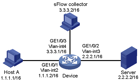

As shown in Figure 2, perform the following tasks:
·     Configure flow sampling in random mode and counter sampling on GigabitEthernet 1/0/1 of the device to monitor traffic on the port.
·     Configure the device to send sampled information in sFlow packets through GigabitEthernet 1/0/3 to the sFlow collector.
Figure 2 Network diagram
1.     Configure VLANs, assign Ethernet interfaces to VLANs, and configure IP addresses and subnet masks for VLAN interfaces, as shown in Figure 2. (Details not shown.)
2.     Configure the sFlow agent and configure information about the sFlow collector:
# Configure the IP address for the sFlow agent.
<Device> system-view
[Device] sflow agent ip 3.3.3.1
# Configure information about the sFlow collector. Specify the sFlow collector ID as 1, IP address as 3.3.3.2, port number as 6343 (default), and description as netserver.
[Device] sflow collector 1 ip 3.3.3.2 description netserver
3.     Configure counter sampling:
# Enable counter sampling and set the counter sampling interval to 120 seconds on GigabitEthernet 1/0/1.
[Device-GigabitEthernet1/0/1] sflow counter interval 120
# Specify sFlow collector 1 for counter sampling.
[Device-GigabitEthernet1/0/1] sflow counter collector 1
4.     Configure flow sampling:
# Enable flow sampling and set the flow sampling mode to random and sampling interval to 32767.
[Device-GigabitEthernet1/0/1] sflow sampling-mode random
[Device-GigabitEthernet1/0/1] sflow sampling-rate 32767
# Specify sFlow collector 1 for flow sampling.
[Device-GigabitEthernet1/0/1] sflow flow collector 1
# Verify the following items:
·     GigabitEthernet 1/0/1 enabled with sFlow is active.
·     The counter sampling interval is 120 seconds.
·     The flow sampling interval is 32767 (one packet is sampled from every 32767 packets).
[Device-GigabitEthernet1/0/1] display sflow
sFlow datagram version: 5
Global information:
Agent IP: 3.3.3.1(CLI)
Source address:
Collector information:
ID    IP              Port  Aging      Size VPN-instance Description
1     3.3.3.2         6343  N/A        1400              netserver
Port counter sampling information:
Interface   Instance   CID   Interval(s)
GE1/0/1     1          1     120
Port flow sampling information:
Interface   Instance   FID   MaxHLen Rate       Mode      Status
GE1/0/1        1          1     128     32767      Random    Active
