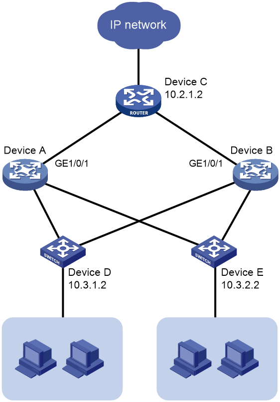

Example: Configuring a track event monitor policy from the CLI
As shown in Figure 3, Device A has established BGP sessions with Device D and Device E. Traffic from Device D and Device E to the Internet is forwarded through Device A.
Configure a CLI-defined EAA monitor policy on Device A to disconnect the sessions with Device D and Device E when GigabitEthernet 1/0/1 connected to Device C is down. In this way, traffic from Device D and Device E to the Internet can be forwarded through Device B.
Figure 3 Network diagram
# Display BGP peer information for Device A.
<DeviceA> display bgp peer ipv4
 BGP local router ID: 1.1.1.1
 Local AS number: 100
 Total number of peers: 3                  Peers in established state: 3
  * - Dynamically created peer
  Peer                    AS  MsgRcvd  MsgSent OutQ PrefRcv Up/Down  State
  10.2.1.2                200       13       16    0       0 00:16:12 Established
  10.3.1.2                300       13       16    0       0 00:10:34 Established
  10.3.2.2                300       13       16    0       0 00:10:38 Established
# Create track entry 1 and associate it with the link state of GigabitEthernet 1/0/1.
<Device A> system-view
[Device A] track 1 interface gigabitethernet 1/0/1
# Configure a CLI-defined EAA monitor policy so that the system automatically disables session establishment with Device D and Device E when GigabitEthernet 1/0/1 is down.
[Device A] rtm cli-policy test
[Device A-rtm-test] event track 1 state negative
[Device A-rtm-test] action 0 cli system-view
[Device A-rtm-test] action 1 cli bgp 100
[Device A-rtm-test] action 2 cli peer 10.3.1.2 ignore
[Device A-rtm-test] action 3 cli peer 10.3.2.2 ignore
[Device A-rtm-test] user-role network-admin
[Device A-rtm-test] commit
[Device A-rtm-test] quit
# Shut down GigabitEthernet 1/0/1.
[Device A] interface gigabitethernet 1/0/1
[Device A-GigabitEthernet1/0/1] shutdown
# Execute the display bgp peer ipv4 command on Device A to display BGP peer information. Verify that no BGP peer is in established state.
