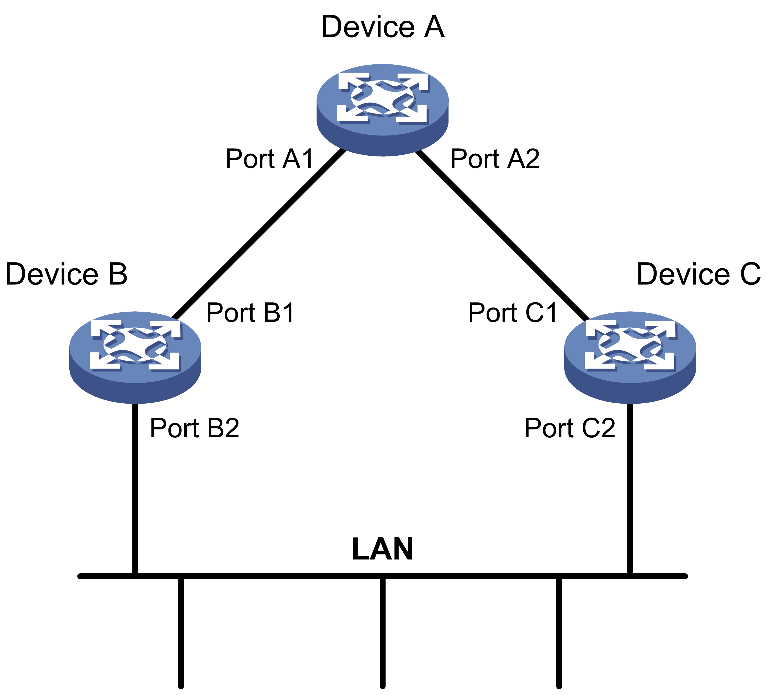

As shown in Figure 3, Device B and Device C are directly connected to a LAN.
If Device A forwards BPDUs to Device B through port A1, the designated bridge and designated port are as follows:
· The designated bridge for Device B is Device A.
· The designated port for Device B is port A1 on Device A.
If Device B forwards BPDUs to the LAN, the designated bridge and designated port are as follows:
· The designated bridge for the LAN is Device B.
· The designated port for the LAN is port B2 on Device B.
Figure 3 Designated bridges and designated ports

As shown in Figure 6, Device A is the root bridge. The priority of Device B is higher than the priority of Device C. Port C2 on Device C is blocked.
When the link between Device A and Device B fails, the following events occur:
1. Device B sends an RSTP BPDU with itself as the root bridge to Device C.
2. Device C compares the RSTP BPDU with its own BPDU.
3. Because the RSTP BPDU from Device B has a lower priority, Device C sends its own BPDU to Device B.
4. Device B considers that Port B2 is the root port and stops sending RSTP BPDUs to Device C.
Figure 6 BPDU processing in RSTP

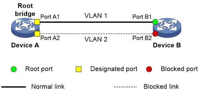

As shown in Figure 12, Port C3 is an edge port connected to a host. When a network topology change occurs, the port can immediately transit from the blocking state to the forwarding state because no loop will be caused.
Figure 12 Edge port rapid transition
Root port rapid transition
When a root port is blocked, the bridge will elect the alternate port with the highest priority as the new root port. If the new root port's peer is in the forwarding state, the new root port immediately transits to the forwarding state.
As shown in Figure 13, Port C2 on Device C is a root port and Port C1 is an alternate port. When Port C2 transits to the blocking state, Port C1 is elected as the root port and immediately transits to the forwarding state.
Figure 13 Root port rapid transition
P/A transition
The P/A transition enables a designated port to rapidly transit to the forwarding state after a handshake with its peer. The P/A transition applies only to point-to-point links.
P/A transition for RSTP and PVST
In RSTP or PVST, the ports on a new link or recovered link are designated ports in blocking state. When one of the designated ports transits to the discarding or learning state, it sets the proposal flag in its BPDU. Its peer bridge receives the BPDU and determines whether the receiving port is the root port. If it is the root port, the bridge blocks the other ports except edge ports. The bridge then replies an agreement BPDU to the designated port. The designated port immediately transits to the forwarding state upon receiving the agreement BPDU. If the designated port does not receive the agreement BPDU, it waits for twice the forward delay to transit to the forwarding state.
As shown in Figure 14, the P/A transition operates as follows:
1. Device A sends a proposal BPDU to Device B through Port A1.
2. Device B receives the proposal BPDU on Port B2. Port B2 is elected as the root port.
3. Device B blocks its designated port Port B1 and alternate port Port B3 to eliminate loops.
4. The root port Port B2 transits to the forwarding state and sends an agreement BPDU to Device A.
5. The designated port Port A1 on Device A immediately transits to the forwarding state after receiving the agreement BPDU.
Figure 14 P/A transition for RSTP and PVST

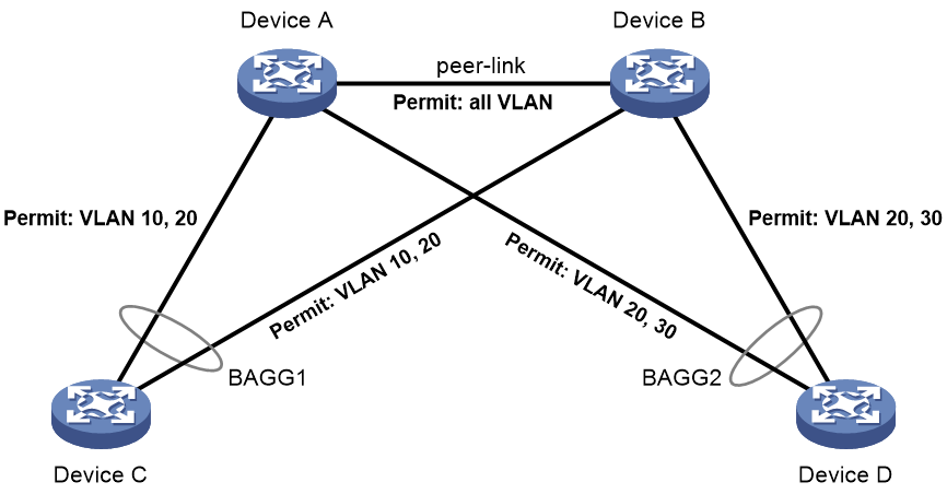

P/A transition for MSTP
In MSTP, an upstream bridge sets both the proposal and agreement flags in its BPDU. If a downstream bridge receives the BPDU and its receiving port is elected as the root port, the bridge blocks all the other ports except edge ports. The downstream bridge then replies an agreement BPDU to the upstream bridge. The upstream port immediately transits to the forwarding state upon receiving the agreement BPDU. If the upstream port does not receive the agreement BPDU, it waits for twice the forward delay to transit to the forwarding state.
As shown in Figure 15, the P/A transition operates as follows:
1. Device A sets the proposal and agreement flags in its BPDU and sends it to Device B through Port A1.
2. Device B receives the BPDU. Port B1 of Device B is elected as the root port.
3. Device B then blocks all its ports except the edge ports.
4. The root port Port B1 of Device B transits to the forwarding state and sends an agreement BPDU to Device A.
5. Port A1 of Device A immediately transits to the forwarding state upon receiving the agreement BPDU.
Figure 15 P/A transition for MSTP

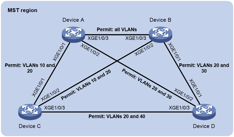

Ignoring the specified VLANs
Traffic of a VLAN on a complex network might be blocked by the spanning tree, as shown in Figure 16.
· Port A1 on Device A allows the traffic of VLAN 1 to pass through.
· Port A2 on Device A allows the traffic of VLAN 2 to pass through.
· Port B1 on Device B allows the traffic of VLAN 1 to pass through.
· Port B2 on Device B allows the traffic of VLAN 2 to pass through.
· Device A and Device B run a spanning tree protocol. Device A is the root bridge, and Port A1 and Port A2 are designated ports. On Device B, Port B1 is the root port, and Port B2 is the blocked port. Traffic of VLAN 2 is blocked.
Figure 16 VLAN connectivity blocked by MSTP
Ignoring a VLAN can make ports of the VLAN forward frames correctly rather than comply with the spanning tree calculation result.
1. Enter system view.
2. Ignore the specified VLANs.
stp ignored vlan vlan-id-list
By default, no VLAN is ignored.

Figure 17 Rapid state transition of an MSTP designated port
Figure 18 Rapid state transition of an RSTP designated port
If the upstream device is a third-party device, the rapid state transition implementation might be limited as follows:
· The upstream device uses a rapid transition mechanism similar to that of RSTP.
· The downstream device runs MSTP and does not operate in RSTP mode.
In this case, the following occurs:
1. The root port on the downstream device receives no agreement from the upstream device.
2. It sends no agreement to the upstream device.
As a result, the designated port of the upstream device can transit to the forwarding state only after a period twice the forward delay.
To enable the designated port of the upstream device to transit its state rapidly, enable No Agreement Check on the downstream device's port.

Configuring TC Snooping
As shown in Figure 19, an IRF fabric connects to two user networks through double links.
· Device A and Device B form the IRF fabric.
· The spanning tree feature is disabled on Device A and Device B and enabled on all devices in user network 1 and user network 2.
· The IRF fabric transparently transmits BPDUs for both user networks and is not involved in the calculation of spanning trees.
When the network topology changes, it takes time for the IRF fabric to update its MAC address table and ARP table. During this period, traffic in the network might be interrupted.
Figure 19 TC Snooping application scenario
To avoid traffic interruption, you can enable TC Snooping on the IRF fabric. After receiving a TC-BPDU through a port, the IRF fabric updates MAC address table and ARP table entries associated with the port's VLAN. In this way, TC Snooping prevents topology change from interrupting traffic forwarding in the network. For more information about the MAC address table and the ARP table, see "Configuring the MAC address table" and Layer 3—IP Services Configuration Guide.
· TC Snooping and the spanning tree feature are mutually exclusive. You must globally disable the spanning tree feature before enabling TC Snooping.
· The priority of BPDU tunneling is higher than that of TC Snooping. When BPDU tunneling is enabled on a port, the TC Snooping feature does not take effect on the port.
· TC Snooping does not support the PVST mode.
2. Globally disable the spanning tree feature.
undo stp global enable
When the device starts up with initial settings, the spanning tree feature is globally disabled by default.
When the device starts up with factory defaults, the spanning tree feature is globally enabled by default.
For more information about the initial settings and factory defaults, see Fundamentals Configuration Guide.
For the S5000-EI switch series, the spanning tree feature is globally disabled by default.
3. Enable TC Snooping.
stp tc-snooping
By default, TC Snooping is disabled.

Enabling root guard
Configure root guard on a designated port.
The root bridge and secondary root bridge of a spanning tree should be located in the same MST region. Especially for the CIST, the root bridge and secondary root bridge are put in a high-bandwidth core region during network design. However, due to possible configuration errors or malicious attacks in the network, the legal root bridge might receive a configuration BPDU with a higher priority. Another device supersedes the current legal root bridge, causing an undesired change of the network topology. The traffic that should go over high-speed links is switched to low-speed links, resulting in network congestion.
To prevent this situation, MSTP provides the root guard feature. If root guard is enabled on a port of a root bridge, this port plays the role of designated port on all MSTIs. After this port receives a configuration BPDU with a higher priority from an MSTI, it performs the following operations:
· Immediately sets that port to the listening state in the MSTI.
· Does not forward the received configuration BPDU.
This is equivalent to disconnecting the link connected to this port in the MSTI. If the port receives no BPDUs with a higher priority within twice the forwarding delay, it reverts to its original state.
On a port, the loop guard feature and the root guard feature are mutually exclusive.
2. Enter interface view.
3. Enable the root guard feature.
stp root-protection
By default, root guard is disabled.

As shown in Figure 21, in normal conditions, Device A is the root bridge, and Port B1 and Port C1 are root ports. When the links between Device A and Device B become unidirectional (the links fail in the direction of Port A1 to Port B1), the following events occur:
1. Device B cannot receive BPDUs from Device A.
2. Device B determines itself as the root bridge.
3. Port B1 sends BPDUs in which the root bridge is Device B to Port C1.
4. Port C1 receives BPDUs from two root bridges, Device A and Device B. A dispute is detected.
5. Dispute guard is triggered and blocks Port C1 to avoid a loop.
Figure 21 Dispute guard triggering scenario (on a root port)
However, dispute guard might disrupt the network connectivity. You can disable dispute guard to avoid connectivity loss in VLAN networks. As shown in Figure 22, the spanning tree feature is disabled on Device B and enabled on Device A and device C. Device B transparently transmits BPDUs.
Device C cannot receive superior BPDUs of VLAN 1 from Device A because Port B1 of Device B is configured to deny packets of VLAN 1. Device C determines itself as the root bridge after a certain period of time. Then, Port C1 sends an inferior BPDU of VLAN 100 to Device A.
When Device A receives the inferior BPDU, dispute guard blocks Port A1, which causes traffic interruption. To ensure service continuity, you can disable dispute guard on Device A to prevent the link from being blocked.
Figure 22 Disabling dispute guard application scenario
You can disable dispute guard if the network does not have unidirectional link failures.

Example: Configuring MSTP
As shown in Figure 23, all devices on the network are in the same MST region. Device A and Device B work at the distribution layer. Device C and Device D work at the access layer.
Configure MSTP so that frames of different VLANs are forwarded along different spanning trees.
· VLAN 10 frames are forwarded along MSTI 1.
· VLAN 30 frames are forwarded along MSTI 3.
· VLAN 40 frames are forwarded along MSTI 4.
· VLAN 20 frames are forwarded along MSTI 0.
VLAN 10 and VLAN 30 are terminated on the distribution layer devices, and VLAN 40 is terminated on the access layer devices. The root bridges of MSTI 1 and MSTI 3 are Device A and Device B, respectively, and the root bridge of MSTI 4 is Device C.
1. Configure VLANs and VLAN member ports. (Details not shown.)
¡ Create VLAN 10, VLAN 20, and VLAN 30 on both Device A and Device B.
¡ Create VLAN 10, VLAN 20, and VLAN 40 on Device C.
¡ Create VLAN 20, VLAN 30, and VLAN 40 on Device D.
¡ Configure the ports on these devices as trunk ports and assign them to related VLANs.
2. Configure Device A:
# Enter MST region view, and configure the MST region name as example.

Based on the output, you can draw each MSTI mapped to each VLAN, as shown in Figure 24.
Figure 24 MSTIs mapped to different VLANs

Based on the output, you can draw a topology for each VLAN spanning tree, as shown in Figure 26.
Figure 26 VLAN spanning tree topologies
Example: Configuring M-LAG with PVST
As shown in Figure 27, Device A and Device B work at the distribution layer, and Device C and Device D work at the access layer.
Configure M-LAG on Device A and Device B. In the M-LAG system, Device A is the primary M-LAG device, and Device B is the secondary M-LAG device.
Configure PVST on the devices to meet the following requirements:
· Frames of a VLAN are forwarded along the spanning trees of the VLAN.
· VLAN 10, VLAN 20, and VLAN 30 are terminated on the distribution layer devices.
· The root bridge of VLAN 10, VLAN 20, and VLAN 30 is the M-LAG system formed by Device A and Device B.
NOTE: · As a best practice, do not connect ports on Device A and Device B that have the same port ID with each other, for example Layer 2 aggregate ports. Otherwise, when Device A and Device B communicate through the link, the spanning tree protocol determines that the device receives its own BPDUs. Loop guard will block the link, though spanning tree features are not affected. · You can view port IDs of interfaces on the device by using the display stp interface command. · The preceding restrictions do not apply to peer-link interfaces and their member ports. |

When the network is stable, you can use the display stp brief command to display brief spanning tree information on each device.
# Display brief spanning tree information of the M-LAG system on the primary M-LAG device, Device A.
[DeviceA] display stp brief
VLAN ID Port Role STP State Protection
10 Bridge-Aggregation1 (M-LAG) DESI FORWARDING NONE
20 Bridge-Aggregation1 (M-LAG) DESI FORWARDING NONE
20 Bridge-Aggregation2 (M-LAG) DESI FORWARDING NONE
30 Bridge-Aggregation2 (M-LAG) DESI FORWARDING NONE
# Display brief spanning tree information on Device C.
[DeviceC] display stp brief
10 Bridge-Aggregation1 ROOT FORWARDING NONE
20 Bridge-Aggregation1 ROOT FORWARDING NONE
# Display brief spanning tree information on Device D.
[DeviceD] display stp brief
20 Bridge-Aggregation2 ROOT FORWARDING NONE
30 Bridge-Aggregation2 ROOT FORWARDING NONE
