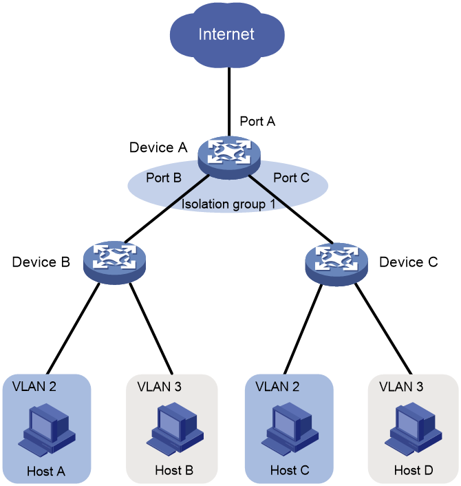

As shown in Figure 1:
·     To isolate Host A from Host C, and Host B from Host D, assign Port B and Port C on Device A to isolation group 1.
·     To enable Layer 2 communication between Host B and Host D, specify VLAN 3 as a community VLAN in isolation group 1. Host B and Host D belong to VLAN 3.
Figure 1 Community VLANs in an isolation group

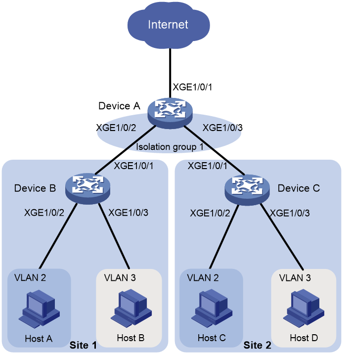

Example: Configuring community VLANs in port isolation
As shown in Figure 3, the company branches Site 1 and Site 2 transfer service traffic in VLAN 2 and VLAN 3.
Configure port isolation and community VLANs on the network to meet the following requirements:
·     All hosts can access the Internet through Device A.
·     Host B and Host D can exchange video conferencing traffic in VLAN 3.
·     Other Layer 2 traffic between Device B and Device C is isolated.
Figure 3 Network diagram
1.     Configure Device A:
# Create VLAN 2 and VLAN 3.
<DeviceA> system-view
[DeviceA] vlan 2 to 3
# Configure Ten-GigabitEthernet 1/0/2 and Ten-GigabitEthernet 1/0/3 as trunk ports, and assign them to VLAN 2 and VLAN 3.
[DeviceA] interface ten-gigabitethernet 1/0/2
[DeviceA-Ten-GigabitEthernet1/0/2] port link-type trunk
[DeviceA-Ten-GigabitEthernet1/0/2] port trunk permit vlan 2 3
[DeviceA-Ten-GigabitEthernet1/0/2] quit
[DeviceA] interface ten-gigabitethernet 1/0/3
[DeviceA-Ten-GigabitEthernet1/0/3] port link-type trunk
[DeviceA-Ten-GigabitEthernet1/0/3] port trunk permit vlan 2 3
[DeviceA-Ten-GigabitEthernet1/0/3] quit
# Create isolation group 1.
[DeviceA] port-isolate group 1
[DeviceA-port-isolate-group1] quit
# Assign Ten-GigabitEthernet 1/0/2 and Ten-GigabitEthernet 1/0/3 to isolation group 1.
[DeviceA-Ten-GigabitEthernet1/0/2] port-isolate enable group 1
[DeviceA-Ten-GigabitEthernet1/0/3] port-isolate enable group 1
# Configure VLAN 3 as a community VLAN in isolation group 1.
[DeviceA-port-isolate-group1] community-vlan vlan 3
2.     Configure Device B:
# Create VLAN 2 and assign Ten-GigabitEthernet 1/0/2 to it.
<DeviceB> system-view
[DeviceB] vlan 2
[DeviceB-vlan2] port ten-gigabitethernet 1/0/2
[DeviceB-vlan2] quit
# Create VLAN 3 and assign Ten-GigabitEthernet 1/0/3 to it.
[DeviceB] vlan 3
[DeviceB-vlan3] port ten-gigabitethernet 1/0/3
[DeviceB-vlan3] quit
# Configure Ten-GigabitEthernet 1/0/1 as a trunk port, and assign it to VLAN 2 and VLAN 3.
[DeviceB] interface ten-gigabitethernet 1/0/1
[DeviceB-Ten-GigabitEthernet1/0/1] port link-type trunk
[DeviceB-Ten-GigabitEthernet1/0/1] port trunk permit vlan 2 3
3.     Configure Device C in the same way Device B is configured.
# Display information about isolation group 1 on device A.
[DeviceA] display port-isolate group 1
 Port-isolate group information:
 Group ID: 1
 Group members:
   Ten-GigabitEthernet1/0/2     Ten-GigabitEthernet1/0/3
 Community VLAN ID: 3
The output shows that:
·     Ten-GigabitEthernet 1/0/2 and Ten-GigabitEthernet 1/0/3 are assigned to isolation group 1.
·     VLAN 3 is configured as a community VLAN in the isolation group.
