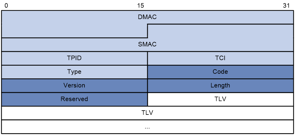

The device detects loops by sending detection frames and then checking whether these frames return to any interface on the device. If they do, the device considers that the interface is on a looped link.
Loop detection usually works within a VLAN. If a detection frame is returned with a different VLAN tag than it was sent out with, an inter-VLAN loop has occurred. To remove the loop, examine the QinQ or VLAN mapping configuration for incorrect settings. For more information about QinQ and VLAN mapping, see "Configuring QinQ" and "Configuring VLAN mapping."
Figure 1 Ethernet frame header for loop detection
The Ethernet frame header of a loop detection packet contains the following fields:
·     DMACDestination MAC address of the frame, which is the multicast MAC address 010f-e200-0007. When a loop detection-enabled device receives a frame with this destination MAC address, it performs the following operations:
¡     Sends the frame to the CPU.
¡     Floods the frame in the VLAN from which the frame was originally received.
·     SMACSource MAC address of the frame, which is the bridge MAC address of the sending device.
·     TPIDType of the VLAN tag, with the value of 0x8100.
·     TCIInformation of the VLAN tag, including the priority and VLAN ID.
·     TypeProtocol type, with the value of 0x8918.
Figure 2 Inner frame header for loop detection
The inner frame header of a loop detection packet contains the following fields:
·     CodeProtocol sub-type, which is 0x0001, indicating the loop detection protocol.
·     VersionProtocol version, which is always 0x0000.
·     LengthLength of the frame. The value includes the inner header, but excludes the Ethernet header.
·     ReservedThis field is reserved.

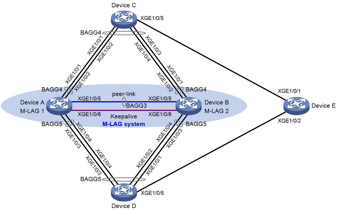

Example: Configuring loop detection on an M-LAG system
As shown in Figure 4, configure loop detection on the M-LAG system formed by Device A and Device B to meet the following requirements:
·     Generates a log as a notification.
·     Automatically shuts down the interface on which a loop is detected.
Figure 4 Network diagram

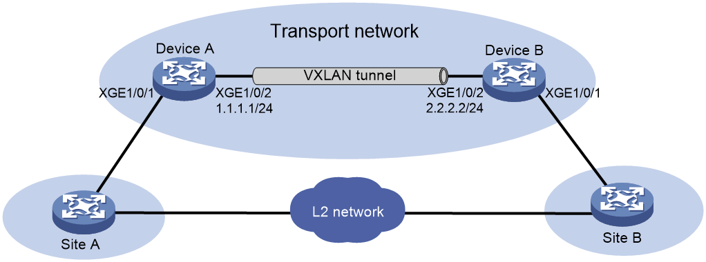

Configuring loop detection in a VXLAN network
About loop detection in a VXLAN network
Loop detection periodically checks for Layer 2 loops in a VXLAN network. The mechanism immediately generates a log when a loop occurs so that you are promptly notified to adjust network connections and configurations. You can configure loop detection to block a looped attachment circuit (AC). Logs are maintained in the information center. For more information, see Network Management and Monitoring Configuration Guide.

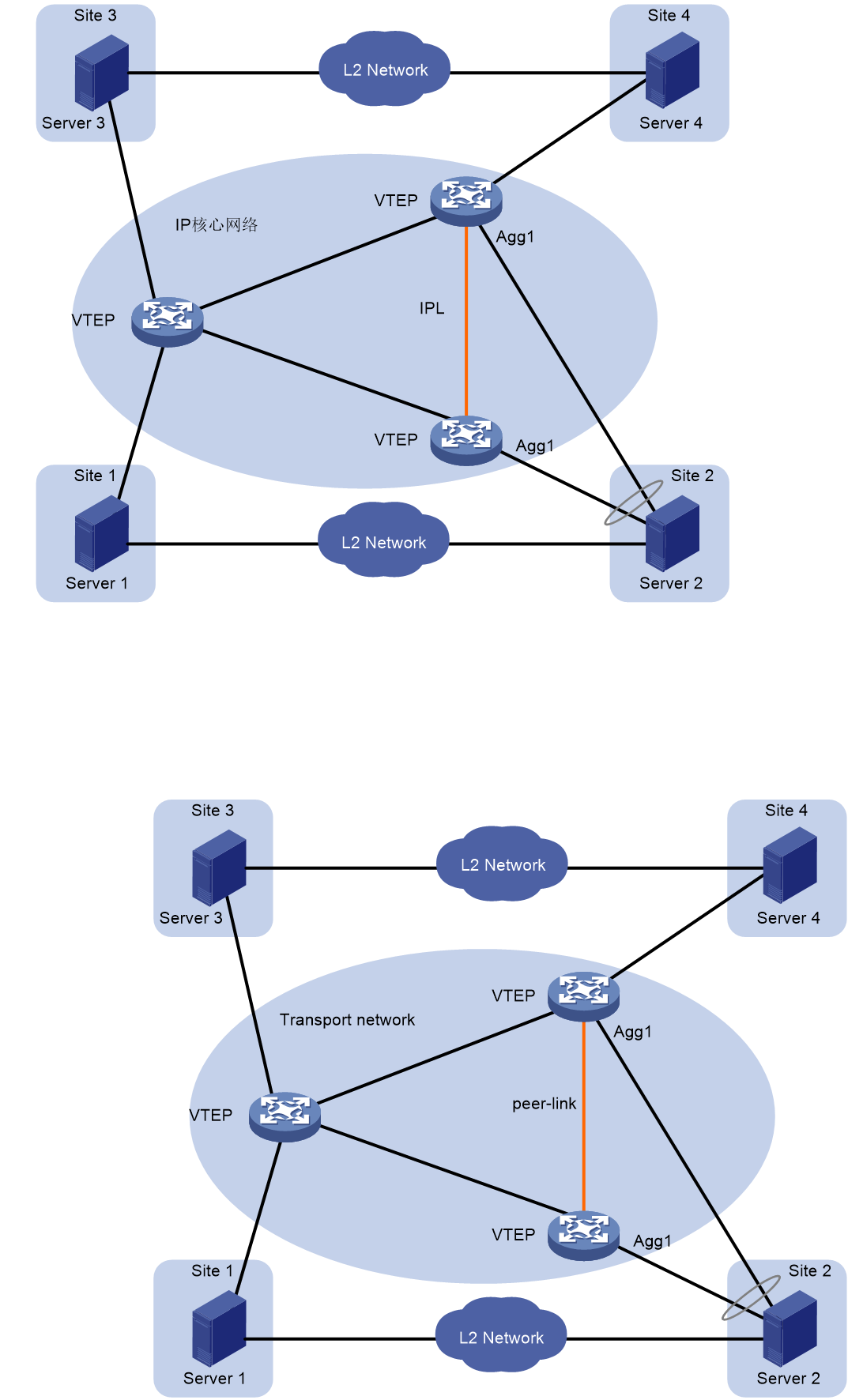

Application scenario
As shown in Figure 5, two VTEPs provide data transmission services for site 1 and site 2. Because the sites also have Layer 2 connectivity, broadcast storms can spread across the sites.
To remove loops from the VXLAN network, configure loop detection on the VTEPs. When a VTEP detects a loop on an AC, it blocks the AC to remove the loop.
Figure 5 Loop detection in a VXLAN network
Loop detection frame format
As shown in Figure 6, a loop detection frame contains the Ethernet header, loop detection header, and loop detection TLVs.
Figure 6 Loop detection frame format
The Ethernet frame header of a loop detection frame contains the following fields:
·     DMAC—Destination MAC address of the frame, which is the multicast MAC address 010f-e200-0007. When a loop detection-enabled device receives a frame with this destination MAC address, it performs the following operations:
¡     Floods the frame in the VLAN from which the frame was received.
·     SMAC—Source MAC address of the frame, which is the bridge MAC address of the sending device.
·     TPID—Type of the VLAN tag, with the default value of 0x8100.
·     TCI—Tag control information, including the priority and VLAN ID.
·     Type—Protocol type, with the value of 0x8918.
The loop detection header of a loop detection frame contains the following fields:
·     Code—Protocol sub-type, which is 0x0001, indicating the loop detection type.
·     Version—Protocol version, which is reserved. This field is fixed at 0x0000.
·     Length—Length of the frame. The value includes the loop detection header, but excludes the Ethernet header.
·     Reserved—This field is reserved.
Payload of a loop detection frame is encapsulated as TLV triplets.
Table 2 TLVs supported by loop detection

Loop detection in a VXLAN network with M-LAG configured
In a VXLAN network, M-LAG can virtualize two VTEPs into an M-LAG system that connects to the remote aggregation system through a multichassis aggregate link. To the remote aggregation system, the M-LAG system is one device. This prevents single points of failure from interrupting traffic forwarding and ensures high availability of the VXLAN network. For more information about M-LAG, see "Configuring M-LAG."
Figure 7 Network diagram
As shown in Figure 7, if an endpoint is dualhomed to the M-LAG system, you must enable loop detection on both VTEPs in the M-LAG system. Loop detection works as follows on the VTEPs:
1.     The VTEPs send loop detection frames out of the ACs configured on the M-LAG interfaces facing the endpoint. The loop detection frames contain the same source MAC address, VLAN tag, loop detection interval, and loop detection priority. The source MAC address is the M-LAG system MAC address.
2.     When receiving loop detection frames on a local M-LAG interface, a VTEP sends the loop detection frames to the peer VTEP over the peer link. This synchronization mechanism ensures that a VTEP can receive loop detection frames in case of link or interface failure.
3.     If a VTEP receives a self-sent loop detection frame from an AC, the VTEP compares the loop detection priority of the AC with that in the frame and acts as follows:
¡     If the loop detection priority in the frame is higher, the VTEP performs the loop protection action on all ACs configured for the M-LAG group that accommodates the looped M-LAG interface.
¡     If the loop detection priority of the AC is higher, the system only records the loop information.
If an endpoint is singlehomed to one VTEP in the M-LAG system, enable loop detection only on that VTEP. Loop detection works as follows on the VTEP:
1.     The VTEP sends loop detection frames out of the ACs configured on the M-LAG interface facing the endpoint. The source MAC address is the M-LAG system MAC address.
2.     If the VTEP receives a self-sent loop detection frame from an AC, the VTEP compares the loop detection priority of the AC with that in the frame and acts as follows:
¡     If the loop detection priority in the frame is higher, the VTEP performs the loop protection action on the looped AC.

Example: Configuring local site loop detection
As shown in Figure 8, Device A and Device B provide user traffic transmission service for site 1 and site 2, and the sites have Layer 2 connectivity in VLAN 10. Configure loop detection on Device A and Device B so that they can block ACs if loops exist.
Figure 8 Network diagram
Configure a routing protocol in the VXLAN for the VTEPs to reach one another.
1.     Configure Device A:
# Create VXLAN 1 and assign it a VXLAN tunnel. Map VSI vsi 1 to VXLAN 1.
<DeviceA> system-view
[DeviceA] l2vpn enable
[DeviceA] interface tunnel 0 mode vxlan
[DeviceA-Tunnel0] source 1.1.1.1
[DeviceA-Tunnel0] destination 2.2.2.2
[DeviceA-Tunnel0] quit
[DeviceA] vsi 1
[DeviceA-vsi-1] vxlan 1
[DeviceA-vsi-1-vxlan-1] tunnel 0
[DeviceA-vsi-1-vxlan-1] quit
# Disable spanning tree globally.
[DeviceA] undo stp global enable
# Configure an AC and map it to VSI vsi 1.
[DeviceA] interface ten-gigabitethernet 1/0/1
[DeviceA-Ten-GigabitEthernet1/0/1] service-instance 1
[DeviceA-Ten-GigabitEthernet1/0/1-srv1] encapsulation s-vid 10
[DeviceA-Ten-GigabitEthernet1/0/1-srv1] xconnect vsi 1
[DeviceA-Ten-GigabitEthernet1/0/1-srv1] quit
# Enable loop detection on VSI vsi 1.
[DeviceA] vsi 1
[DeviceA-vsi-1] loopback-detection enable
# Set the loop protection action to block on VSI vsi 1.
[DeviceA-vsi-1] loopback-detection action block
# Set the loop detection interval to 35 seconds on VSI vsi 1.
[DeviceA-vsi-1] loopback-detection interval-time 35
# Set the loop detection priority to 1 on VSI vsi 1.
[DeviceA-vsi-1] loopback-detection priority 1
2.     Configure Device B:
<DeviceB> system-view
[DeviceB] l2vpn enable
[DeviceB] interface Tunnel 0 mode vxlan
[DeviceB-Tunnel0] source 2.2.2.2
[DeviceB-Tunnel0] destination 1.1.1.1
[DeviceB-Tunnel0] quit
[DeviceB] vsi 1
[DeviceB-vsi-1] vxlan 1
[DeviceB-vsi-1-vxlan-1] tunnel 0
[DeviceB-vsi-1-vxlan-1] quit
[DeviceB] undo stp global enable
[DeviceB] interface ten-gigabitethernet 1/0/1
[DeviceB-Ten-GigabitEthernet1/0/1] service-instance 1
[DeviceB-Ten-GigabitEthernet1/0/1-srv1] encapsulation s-vid 10
[DeviceB-Ten-GigabitEthernet1/0/1-srv1] xconnect vsi 1
[DeviceB-Ten-GigabitEthernet1/0/1-srv1] quit
[DeviceB] vsi 1
[DeviceB-vsi-1] loopback-detection enable
[DeviceB-vsi-1] loopback-detection action block
[DeviceB-vsi-1] loopback-detection interval-time 35
# Set the loop detection priority to 6 on VSI vsi 1.
[DeviceB-vsi-1] loopback-detection priority 6
# Verify that Device A has detected a loop.
[DeviceA]
%Mar 25 10:59:59:690 2019 Device A LPDT/4/LPDT_VSI_LOOPED: A loop was detected on VSI 1's Ethernet service instance srv1 on Ten-GigabitEthernet1/0/1.
# Verify that Device A has detected a loop on the AC on Ten-GigabitEthernet 1/0/1 but does not block the AC because it has high priority.
[DeviceA] display loopback-detection
Loop detection is enabled.
Global loop detection interval is 30 second(s).
Loop is detected on following interfaces:
* indicates the loop protection action was not triggered.
# indicates the loop protection action failed.
  Interface                         Action mode     VLANs/VSI
  Ten-GigabitEthernet1/0/1  srv1    Block*          1
# Verify that Device B has blocked the AC on Ten-GigabitEthernet 1/0/1 to remove the loop.
[DeviceB] display loopback-detection
  Ten-GigabitEthernet1/0/1  srv1    Block           1
