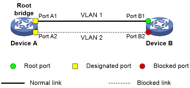

Figure 3 Designated bridges and designated ports

Example of STP calculation
Figure 4 provides an example showing how the STP algorithm works.
Figure 4 The STP algorithm
As shown in Figure 4, the priority values of Device A, Device B, and Device C are 0, 1, and 2, respectively. The path costs of links among the three devices are 5, 10, and 4.
Device state initialization
In Table 3, each configuration BPDU contains the following fields: root bridge ID, root path cost, designated bridge ID, and designated port ID.
Table 3 Initial state of each device
Device
Port name
Configuration BPDU on the port
Device A
Port A1
{0, 0, 0, Port A1}
Port A2
{0, 0, 0, Port A2}
Device B
Port B1
{1, 0, 1, Port B1}
Port B2
{1, 0, 1, Port B2}
Device C
Port C1
{2, 0, 2, Port C1}
Port C2
{2, 0, 2, Port C2}
Configuration BPDUs comparison on each device
In Table 4, each configuration BPDU contains the following fields: root bridge ID, root path cost, designated bridge ID, and designated port ID.
Table 4 Comparison process and result on each device
Device
Comparison process
Configuration BPDU on ports after comparison
Device A
Port A1 performs the following operations:
1.     Receives the configuration BPDU of Port B1 {1, 0, 1, Port B1}.
2.     Determines that its existing configuration BPDU {0, 0, 0, Port A1} is superior to the received configuration BPDU.
3.     Discards the received one.
Port A2 performs the following operations:
1.     Receives the configuration BPDU of Port C1 {2, 0, 2, Port C1}.
2.     Determines that its existing configuration BPDU {0, 0, 0, Port A2} is superior to the received configuration BPDU.
Device A determines that it is both the root bridge and designated bridge in the configuration BPDUs of all its ports. It considers itself as the root bridge. It does not change the configuration BPDU of any port and starts to periodically send configuration BPDUs.
·     Port A1: {0, 0, 0, Port A1}
·     Port A2: {0, 0, 0, Port A2}
Device B
Port B1 performs the following operations:
4.     Receives the configuration BPDU of Port A1 {0, 0, 0, Port A1}.
5.     Determines that the received configuration BPDU is superior to its existing configuration BPDU {1, 0, 1, Port B1}.
6.     Updates its configuration BPDU.
Port B2 performs the following operations:
1.     Receives the configuration BPDU of Port C2 {2, 0, 2, Port C2}.
2.     Determines that its existing configuration BPDU {1, 0, 1, Port B2} is superior to the received configuration BPDU.
3.     Discards the received BPDU.
·     Port B1: {0, 0, 0, Port A1}
·     Port B2: {1, 0, 1, Port B2}
Device B performs the following operations:
1.     Compares the configuration BPDUs of all its ports.
2.     Decides that the configuration BPDU of Port B1 is the optimum.
3.     Selects Port B1 as the root port with the configuration BPDU unchanged.
Based on the configuration BPDU and path cost of the root port, Device B calculates a designated port configuration BPDU for Port B2 {0, 5, 1, Port B2}. Device B compares it with the existing configuration BPDU of Port B2 {1, 0, 1, Port B2}. Device B determines that the calculated one is superior, and determines that Port B2 is the designated port. It replaces the configuration BPDU on Port B2 with the calculated one, and periodically sends the calculated configuration BPDU.
·     Root port (Port B1): {0, 0, 0, Port A1}
·     Designated port (Port B2): {0, 5, 1, Port B2}
Device C
Port C1 performs the following operations:
1.     Receives the configuration BPDU of Port A2 {0, 0, 0, Port A2}.
2.     Determines that the received configuration BPDU is superior to its existing configuration BPDU {2, 0, 2, Port C1}.
3.     Updates its configuration BPDU.
Port C2 performs the following operations:
1.     Receives the original configuration BPDU of Port B2 {1, 0, 1, Port B2}.
2.     Determines that the received configuration BPDU is superior to the existing configuration BPDU {2, 0, 2, Port C2}.
·     Port C1: {0, 0, 0, Port A2}
·     Port C2: {1, 0, 1, Port B2}
Device C performs the following operations:
2.     Decides that the configuration BPDU of Port C1 is the optimum.
3.     Selects Port C1 as the root port with the configuration BPDU unchanged.
Based on the configuration BPDU and path cost of the root port, Device C calculates the configuration BPDU of Port C2 {0, 10, 2, Port C2}. Device C compares it with the existing configuration BPDU of Port C2 {1, 0, 1, Port B2}. Device C determines that the calculated configuration BPDU is superior to the existing one, selects Port C2 as the designated port, and replaces the configuration BPDU of Port C2 with the calculated one.
·     Root port (Port C1): {0, 0, 0, Port A2}
·     Designated port (Port C2): {0, 10, 2, Port C2}
1.     Receives the updated configuration BPDU of Port B2 {0, 5, 1, Port B2}.
2.     Determines that the received configuration BPDU is superior to its existing configuration BPDU {0, 10, 2, Port C2}.
1.     Receives a periodic configuration BPDU {0, 0, 0, Port A2} from Port A2.
2.     Determines that it is the same as the existing configuration BPDU.
·     Port C2: {0, 5, 1, Port B2}
Device C determines that the root path cost of Port C1 is larger than that of Port C2. The root path cost of Port C1 is 10, root path cost of the received configuration BPDU (0) plus path cost of Port C1 (10). The root path cost of Port C2 is 9, root path cost of the received configuration BPDU (5) plus path cost of Port C2 (4). Device C determines that the configuration BPDU of Port C2 is the optimum, and selects Port C2 as the root port with the configuration BPDU unchanged.
Based on the configuration BPDU and path cost of the root port, Device C performs the following operations:
1.     Calculates a designated port configuration BPDU for Port C1 {0, 9, 2, Port C1}.
2.     Compares it with the existing configuration BPDU of Port C1 {0, 0, 0, Port A2}.
3.     Determines that the existing configuration BPDU is superior to the calculated one and blocks Port C1 with the configuration BPDU unchanged.
Port C1 does not forward data until a new event triggers a spanning tree calculation process: for example, the link between Device B and Device C is down.
·     Blocked port (Port C1): {0, 0, 0, Port A2}
·     Root port (Port C2): {0, 5, 1, Port B2}
Final calculated spanning tree
After the comparison processes described in Table 4, a spanning tree with Device A as the root bridge is established, as shown in Figure 5.
Figure 5 The final calculated spanning tree

Port roles
A port can play different roles in different MSTIs. As shown in Figure 11, an MST region contains Device A, Device B, Device C, and Device D. Port A1 and port A2 of Device A connect to the common root bridge. Port B2 and Port B3 of Device B form a loop. Port C3 and Port C4 of Device C connect to other MST regions. Port D3 of Device D directly connects to a host.
Figure 11 Port roles
MSTP calculation involves the following port roles:
·     Root port—Forwards data for a non-root bridge to the root bridge. The root bridge does not have any root port.
·     Designated port—Forwards data to the downstream network segment or device.
·     Alternate port—Acts as the backup port for a root port or master port. When the root port or master port is blocked, the alternate port takes over.
·     Backup port—Acts as the backup port of a designated port. When the designated port is invalid, the backup port becomes the new designated port. A loop occurs when two ports of the same spanning tree device are connected, so the device blocks one of the ports. The blocked port acts as the backup.
·     Edge port—Directly connects to a user host rather than a network device or network segment.
·     Master port—Acts as a port on the shortest path from the local MST region to the common root bridge. The master port is not always located on the regional root. It is a root port on the IST or CIST and still a master port on the other MSTIs.
·     Boundary port—Connects an MST region to another MST region or to an STP/RSTP-running device. In MSTP calculation, a boundary port's role on an MSTI is consistent with its role on the CIST. However, that is not true with master ports. A master port on MSTIs is a root port on the CIST.
Port states
In MSTP, a port can be in one of the following states:
·     Forwarding—The port receives and sends BPDUs, learns MAC addresses, and forwards user traffic.
·     Learning—The port receives and sends BPDUs, learns MAC addresses, but does not forward user traffic. Learning is an intermediate port state.
·     Discarding—The port receives and sends BPDUs, but does not learn MAC addresses or forward user traffic.
When in different MSTIs, a port can be in different states.
A port state is not exclusively associated with a port role. Table 6 lists the port states that each port role supports. (A check mark [√] indicates that the port supports this state, while a dash [—] indicates that the port does not support this state.)
Table 6 Port states that different port roles support

Ignoring the specified VLANs
Traffic of a VLAN on a complex network might be blocked by the spanning tree, as shown in Figure 16.
·     Port A1 on Device A allows the traffic of VLAN 1 to pass through.
·     Port A2 on Device A allows the traffic of VLAN 2 to pass through.
·     Port B1 on Device B allows the traffic of VLAN 1 to pass through.
·     Port B2 on Device B allows the traffic of VLAN 2 to pass through.
·     Device A and Device B run a spanning tree protocol. Device A is the root bridge, and Port A1 and Port A2 are designated ports. On Device B, Port B1 is the root port, and Port B2 is the blocked port. Traffic of VLAN 2 is blocked.
Figure 16 VLAN connectivity blocked by MSTP
Ignoring a VLAN can make ports of the VLAN forward frames correctly rather than comply with the spanning tree calculation result.

Disabling dispute guard
Dispute guard can be triggered by unidirectional link failures. If an upstream port receives inferior BPDUs from a downstream designated port in forwarding or learning state because of a unidirectional link failure, a loop appears. Dispute guard blocks the upstream designated port to prevent the loop.
As shown in Figure 20, in normal conditions, the spanning tree calculation result is as follows:
·     Device A is the root bridge, and Port A1 is a designated port.
·     Port B1 is blocked.
When the link between Port A1 and Port B1 fails in the direction of Port A1 to Port B1 and becomes unidirectional, the following events occur:
1.     Port A1 can only receive BPDUs and cannot send BPDUs to Port B1.
2.     Port B1 does not receive BPDUs from Port A1 for a certain period of time.
3.     Device B determines itself as the root bridge.
4.     Port B1 sends its BPDUs to Port A1.
5.     Port A1 determines the received BPDUs are inferior to its own BPDUs. A dispute is detected.
6.     Dispute guard is triggered and blocks Port A1 to prevent a loop.
Figure 20 Dispute guard triggering scenario (on a designated port)
As shown in Figure 21, in normal conditions, Device A is the root bridge, and Port B1 and Port C1 are root ports. When the links between Device A and Device B become unidirectional (the links fail in the direction of Port A1 to Port B1), the following events occur:
1.     Device B cannot receive BPDUs from Device A.
2.     Device B determines itself as the root bridge.
3.     Port B1 sends BPDUs in which the root bridge is Device B to Port C1.
4.     Port C1 receives BPDUs from two root bridges, Device A and Device B. A dispute is detected.
5.     Dispute guard is triggered and blocks Port C1 to avoid a loop.
Figure 21 Dispute guard triggering scenario (on a root port)
However, dispute guard might disrupt the network connectivity. You can disable dispute guard to avoid connectivity loss in VLAN networks. As shown in Figure 22, the spanning tree feature is disabled on Device B and enabled on Device A and device C. Device B transparently transmits BPDUs.
Device C cannot receive superior BPDUs of VLAN 1 from Device A because Port B1 of Device B is configured to deny packets of VLAN 1. Device C determines itself as the root bridge after a certain period of time. Then, Port C1 sends an inferior BPDU of VLAN 100 to Device A.
When Device A receives the inferior BPDU, dispute guard blocks Port A1, which causes traffic interruption. To ensure service continuity, you can disable dispute guard on Device A to prevent the link from being blocked.
Figure 22 Disabling dispute guard application scenario

Based on the output, you can draw each MSTI mapped to each VLAN, as shown in Figure 24.
Figure 24 MSTIs mapped to different VLANs
