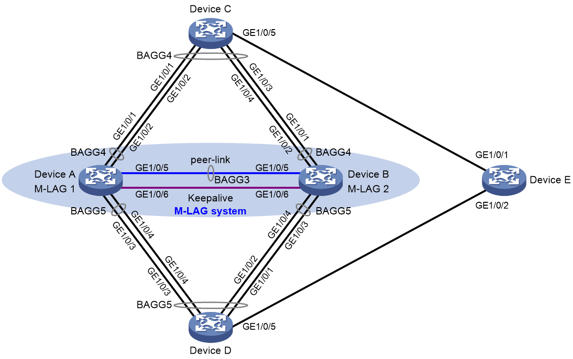

Example: Configuring loop detection on an M-LAG system

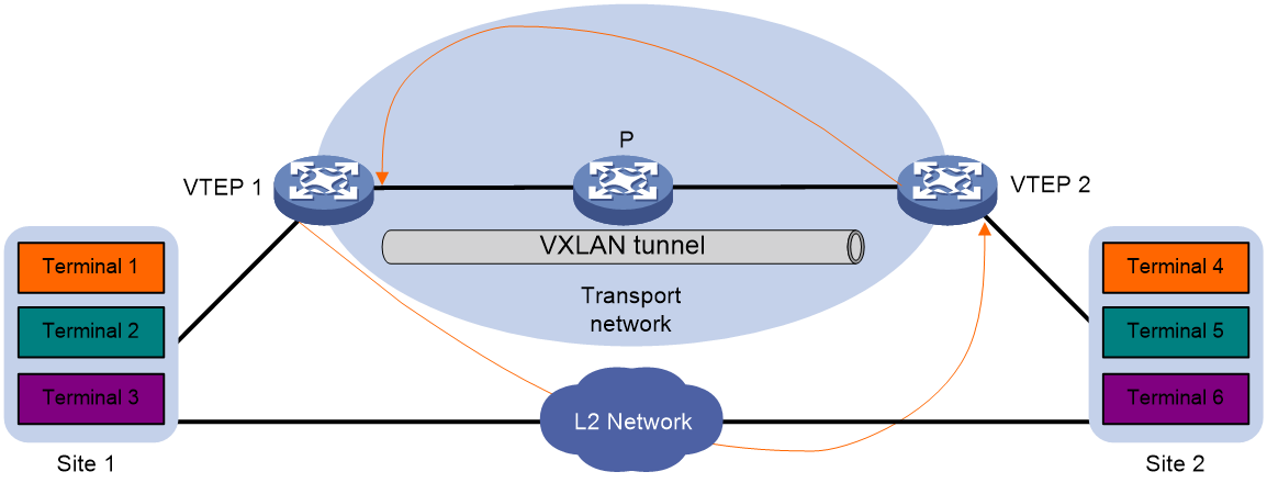

Configuring loop detection in a VXLAN network
About loop detection in a VXLAN network

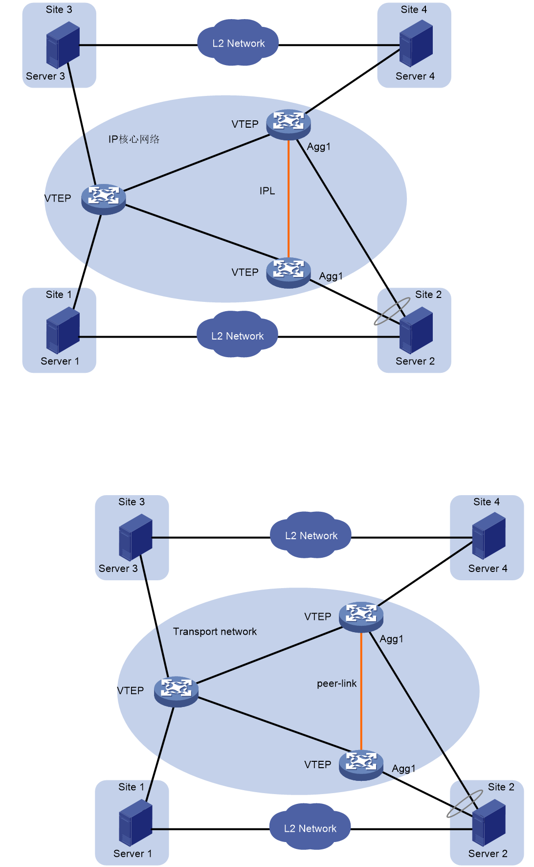

Loop detection in a VXLAN network with M-LAG configured

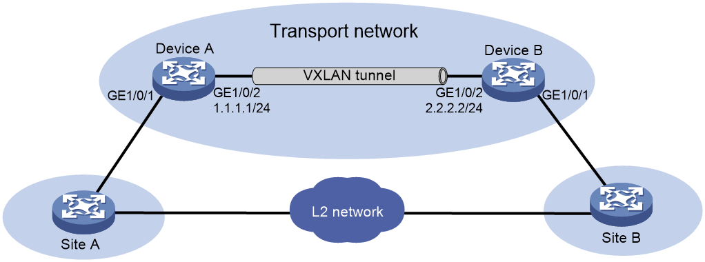

Example: Configuring local site loop detection

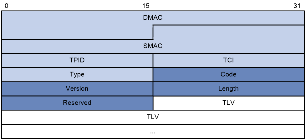

Figure 1 Ethernet frame header for loop detection
The Ethernet frame header of a loop detection packet contains the following fields:
· DMAC—Destination MAC address of the frame, which is the multicast MAC address 010f-e200-0007. When a loop detection-enabled device receives a frame with this destination MAC address, it performs the following operations:
¡ Sends the frame to the CPU.
¡ Floods the frame in the VLAN from which the frame was originally received.
· SMAC—Source MAC address of the frame, which is the bridge MAC address of the sending device.
· TPID—Type of the VLAN tag, with the value of 0x8100.
· TCI—Information of the VLAN tag, including the priority and VLAN ID.
· Type—Protocol type, with the value of 0x8918.
Figure 2 Inner frame header for loop detection
The inner frame header of a loop detection packet contains the following fields:
· Code—Protocol sub-type, which is 0x0001, indicating the loop detection protocol.
· Version—Protocol version, which is always 0x0000.
· Length—Length of the frame. The value includes the inner header, but excludes the Ethernet header.
· Reserved—This field is reserved.
As shown in Figure 5, configure loop detection on the M-LAG system formed by Device A and Device B to meet the following requirements:
· Generates a log as a notification.
· Automatically shuts down the interface on which a loop is detected.
1. Configure Device A:
# Create VLAN 100.
<DeviceA> system-view
[DeviceA] vlan 100
[DeviceA-vlan100] quit
# Configure M-LAG system settings.
[DeviceA] m-lag system-mac 1-1-1
[DeviceA] m-lag system-number 1
[DeviceA] m-lag system-priority 123
# Configure M-LAG keepalive packet parameters.
[DeviceA] m-lag keepalive ip destination 1.1.1.1 source 1.1.1.2
# Set the link mode of GigabitEthernet 1/0/6 to Layer 3, and assign the interface an IP address. The IP address will be used as the source IP address of keepalive packets.
[DeviceA] interface gigabitethernet 1/0/6
[DeviceA-GigabitEthernet1/0/6] port link-mode route
[DeviceA-GigabitEthernet1/0/6] ip address 1.1.1.2 24
[DeviceA-GigabitEthernet1/0/6] quit
# Exclude the interface used for M-LAG keepalive detection (GigabitEthernet 1/0/6) from the shutdown action by M-LAG MAD.
[DeviceA] drni m-lag exclude interface gigabitethernet 1/0/6
# Create Layer 2 dynamic aggregate interface Bridge-Aggregation 3, and specify it as the M-LAG peer-link interface.
[DeviceA] interface bridge-aggregation 3
[DeviceA-Bridge-Aggregation3] link-aggregation mode dynamic
[DeviceA-Bridge-Aggregation3] port m-lag peer-link 1
[DeviceA-Bridge-Aggregation3] quit
# Assign GigabitEthernet 1/0/5 to aggregation group 3.
[DeviceA] interface gigabitethernet 1/0/5
[DeviceA-GigabitEthernet1/0/5] port link-aggregation group 3
[DeviceA-GigabitEthernet1/0/5] quit
# Set the link type of Bridge-Aggregation 3 to trunk, and assign it to VLAN 100.
[DeviceA-Bridge-Aggregation3] port link-type trunk
[DeviceA-Bridge-Aggregation3] port trunk permit vlan 100
# Create Layer 2 dynamic aggregate interface Bridge-Aggregation 4, and assign it to M-LAG group 4.
[DeviceA] interface bridge-aggregation 4
[DeviceA-Bridge-Aggregation4] link-aggregation mode dynamic
[DeviceA-Bridge-Aggregation4] port m-lag group 4
[DeviceA-Bridge-Aggregation4] quit
# Assign GigabitEthernet 1/0/1 and GigabitEthernet 1/0/2 to aggregation group 4.
[DeviceA-GigabitEthernet1/0/1] port link-aggregation group 4
[DeviceA-GigabitEthernet1/0/1] quit
[DeviceA] interface gigabitethernet 1/0/2
[DeviceA-GigabitEthernet1/0/2] port link-aggregation group 4
[DeviceA-GigabitEthernet1/0/2] quit
# Set the link type of Bridge-Aggregation 4 to trunk, and assign it to VLAN 100.
[DeviceA-Bridge-Aggregation4] port link-type trunk
[DeviceA-Bridge-Aggregation4] port trunk permit vlan 100
# Create Layer 2 dynamic aggregate interface Bridge-Aggregation 5, and assign it to M-LAG group 5.
[DeviceA] interface bridge-aggregation 5
[DeviceA-Bridge-Aggregation5] link-aggregation mode dynamic
[DeviceA-Bridge-Aggregation5] port m-lag group 5
[DeviceA-Bridge-Aggregation5] quit
# Assign GigabitEthernet 1/0/3 and GigabitEthernet 1/0/4 to aggregation group 5.
[DeviceA] interface gigabitethernet 1/0/3
[DeviceA-GigabitEthernet1/0/3] port link-aggregation group 5
[DeviceA-GigabitEthernet1/0/3] quit
[DeviceA] interface gigabitethernet 1/0/4
[DeviceA-GigabitEthernet1/0/4] port link-aggregation group 5
[DeviceA-GigabitEthernet1/0/4] quit
# Set the link type of Bridge-Aggregation 5 to trunk, and assign it to VLAN 100.
[DeviceA-Bridge-Aggregation5] port link-type trunk
[DeviceA-Bridge-Aggregation5] port trunk permit vlan 100
# Disable the spanning tree feature.
[DeviceA] undo stp global enable
# Enable loop detection for VLAN 100 globally, set the global loop protection action to shutdown, and set the loop detection interval to 35 seconds.
[DeviceA] loopback-detection global enable vlan 100
[DeviceA] loopback-detection global action shutdown
[DeviceA] loopback-detection interval-time 35
2. Configure Device B in the same way Device A is configured. Set the M-LAG system number to 2, and set the source and destination IP addresses of keepalive packets to 1.1.1.1 and 1.1.1.2, respectively. (Details not shown.)
3. Configure Device C:
<DeviceC> system-view
[DeviceC] undo stp global enable
# Create VLAN 100.
[DeviceC] vlan 100
[DeviceC-vlan100] quit
# Create Layer 2 dynamic aggregate interface Bridge-Aggregation 4.
[DeviceC] interface bridge-aggregation 4
[DeviceC-Bridge-Aggregation4] link-aggregation mode dynamic
[DeviceC-Bridge-Aggregation4] quit
# Assign GigabitEthernet 1/0/1 through GigabitEthernet 1/0/4 to aggregation group 4.
[DeviceC] interface range gigabitethernet 1/0/1 to gigabitethernet 1/0/4
[DeviceC-if-range] port link-aggregation group 4
[DeviceC-if-range] quit
[DeviceC-Bridge-Aggregation4] port link-type trunk
[DeviceC-Bridge-Aggregation4] port trunk permit vlan 100
# Set the link type of GigabitEthernet 1/0/5 to trunk, and assign it to VLAN 100.
[DeviceC] interface gigabitethernet 1/0/5
[DeviceC-GigabitEthernet1/0/5] port link-type trunk
[DeviceC-GigabitEthernet1/0/5] port trunk permit vlan 100
[DeviceC-GigabitEthernet1/0/5] quit
4. Configure Device D:
<DeviceD> system-view
[DeviceD] undo stp global enable
# Create VLAN 100.
[DeviceD] vlan 100
[DeviceD-vlan100] quit
# Create Layer 2 dynamic aggregate interface Bridge-Aggregation 5.
[DeviceD] interface bridge-aggregation 5
[DeviceD-Bridge-Aggregation5] link-aggregation mode dynamic
[DeviceD-Bridge-Aggregation5] quit
# Assign GigabitEthernet 1/0/1 through GigabitEthernet 1/0/4 to aggregation group 5.

# View the system logs on Device A.
[DeviceA]
%Aug 1 03:28:48:110 2019 DeviceA LPDT/4/LPDT_LOOPED: A loop was detected on
Bridge-Aggregation4.
%Aug 1 03:28:48:191 2019 DeviceA LPDT/4/LPDT_VLAN_LOOPED: A loop was detect
ed on Bridge-Aggregation4 in VLAN 100.
%Aug 1 03:28:48:194 2019 DeviceA LPDT/4/LPDT_LOOPED: A loop was detected on
Bridge-Aggregation5.
%Aug 1 03:28:48:288 2019 DeviceA LPDT/4/LPDT_VLAN_LOOPED: A loop was detect
ed on Bridge-Aggregation5 in VLAN 100.
%Aug 1 03:28:48:290 2019 DeviceA LPDT/5/LPDT_VLAN_RECOVERED: A loop was rem
oved on Bridge-Aggregation4 in VLAN 100.
%Aug 1 03:28:48:291 2019 DeviceA LPDT/5/LPDT_RECOVERED: All loops were remo
ved on Bridge-Aggregation4.
%Aug 1 03:28:48:302 2019 DeviceA LPDT/5/LPDT_VLAN_RECOVERED: A loop was rem
oved on Bridge-Aggregation5 in VLAN 100.
%Aug 1 03:28:48:304 2019 DeviceA LPDT/5/LPDT_RECOVERED: All loops were remo
ved on Bridge-Aggregation5.
The output shows the following information:
· Device A detected loops on Bridge-Aggregation 4 and Bridge-Aggregation 5 within a loop detection interval.
· Loops on Bridge-Aggregation 4 and Bridge-Aggregation 5 were removed.
# Use the display loopback-detection command to display the loop detection configuration and status on Device A.
[DeviceA] display loopback-detection
Loop detection is enabled.
Global loop detection interval is 35 second(s).
Loop is detected on following interfaces:
Interface Action mode VLANs/VSI
Bridge-Aggregation4 Shutdown 100
Bridge-Aggregation5 Shutdown 100
The output shows that the device has removed the loops from Bridge-Aggregation 4 and Bridge-Aggregation 5 according to the shutdown action.
# Verify that Bridge-Aggregation 4 has been shut down by loop detection.
[DeviceA] display interface Bridge-Aggregation 4
Bridge-Aggregation4
The interface has assigned a M-LAG group.
Current state: DOWN (Loopback detection down)
# Verify that Bridge-Aggregation 5 has been shut down by loop detection.
[DeviceA] display interface Bridge-Aggregation 5
Bridge-Aggregation5
# Verify that loops have been removed on Device B. (Details not shown.)

Application scenario
As shown in Figure 6, two VTEPs provide data transmission services for site 1 and site 2. Because the sites also have Layer 2 connectivity, broadcast storms can spread across the sites.
To remove loops from the VXLAN network, configure loop detection on the VTEPs. When a VTEP detects a loop on an AC, it blocks the AC to remove the loop.
Figure 6 Loop detection in a VXLAN network
Loop detection frame format
As shown in Figure 7, a loop detection frame contains the Ethernet header, loop detection header, and loop detection TLVs.
Figure 7 Loop detection frame format
The Ethernet frame header of a loop detection frame contains the following fields:
¡ Floods the frame in the VLAN from which the frame was received.
· TPID—Type of the VLAN tag, with the default value of 0x8100.
· TCI—Tag control information, including the priority and VLAN ID.
The loop detection header of a loop detection frame contains the following fields:
· Code—Protocol sub-type, which is 0x0001, indicating the loop detection type.
· Version—Protocol version, which is reserved. This field is fixed at 0x0000.
· Length—Length of the frame. The value includes the loop detection header, but excludes the Ethernet header.
Payload of a loop detection frame is encapsulated as TLV triplets.
In a VXLAN network, M-LAG can virtualize two VTEPs into an M-LAG system that connects to the remote aggregation system through a multichassis aggregate link. To the remote aggregation system, the M-LAG system is one device. This prevents single points of failure from interrupting traffic forwarding and ensures high availability of the VXLAN network. For more information about M-LAG, see "Configuring M-LAG."
As shown in Figure 8, if an endpoint is dualhomed to the M-LAG system, you must enable loop detection on both VTEPs in the M-LAG system. Loop detection works as follows on the VTEPs:
1. The VTEPs send loop detection frames out of the ACs configured on the M-LAG interfaces facing the endpoint. The loop detection frames contain the same source MAC address, VLAN tag, loop detection interval, and loop detection priority. The source MAC address is the M-LAG system MAC address.
2. When receiving loop detection frames on a local M-LAG interface, a VTEP sends the loop detection frames to the peer VTEP over the peer link. This synchronization mechanism ensures that a VTEP can receive loop detection frames in case of link or interface failure.
3. If a VTEP receives a self-sent loop detection frame from an AC, the VTEP compares the loop detection priority of the AC with that in the frame and acts as follows:
¡ If the loop detection priority in the frame is higher, the VTEP performs the loop protection action on all ACs configured for the M-LAG group that accommodates the looped M-LAG interface.
¡ If the loop detection priority of the AC is higher, the system only records the loop information.
If an endpoint is singlehomed to one VTEP in the M-LAG system, enable loop detection only on that VTEP. Loop detection works as follows on the VTEP:
1. The VTEP sends loop detection frames out of the ACs configured on the M-LAG interface facing the endpoint. The source MAC address is the M-LAG system MAC address.
2. If the VTEP receives a self-sent loop detection frame from an AC, the VTEP compares the loop detection priority of the AC with that in the frame and acts as follows:
¡ If the loop detection priority in the frame is higher, the VTEP performs the loop protection action on the looped AC.
As shown in Figure 9, Device A and Device B provide user traffic transmission service for site 1 and site 2, and the sites have Layer 2 connectivity in VLAN 10. Configure loop detection on Device A and Device B so that they can block ACs if loops exist.
Configure a routing protocol in the VXLAN for the VTEPs to reach one another.

# Configure an AC and map it to VSI vsi 1.
[DeviceB-GigabitEthernet1/0/1] service-instance 1
[DeviceB-GigabitEthernet1/0/1-srv1] encapsulation s-vid 10
[DeviceB-GigabitEthernet1/0/1-srv1] xconnect vsi 1
[DeviceB-GigabitEthernet1/0/1-srv1] quit
# Enable loop detection on VSI vsi 1.
[DeviceB] vsi 1
[DeviceB-vsi-1] loopback-detection enable
# Set the loop protection action to block on VSI vsi 1.
[DeviceB-vsi-1] loopback-detection action block
# Set the loop detection interval to 35 seconds on VSI vsi 1.
[DeviceB-vsi-1] loopback-detection interval-time 35
# Set the loop detection priority to 6 on VSI vsi 1.
[DeviceB-vsi-1] loopback-detection priority 6
# Verify that Device A has detected a loop.
[DeviceA]
%Mar 25 10:59:59:690 2019 Device A LPDT/4/LPDT_VSI_LOOPED: A loop was detected on VSI 1's Ethernet service instance srv1 on GigabitEthernet1/0/1.
# Verify that Device A has detected a loop on the AC on GigabitEthernet 1/0/1 but does not block the AC because it has high priority.
Global loop detection interval is 30 second(s).
* indicates the loop protection action was not triggered.
# indicates the loop protection action failed.
GigabitEthernet1/0/1 srv1 Block* 1
# Verify that Device B has blocked the AC on GigabitEthernet 1/0/1 to remove the loop.
[DeviceB] display loopback-detection
GigabitEthernet1/0/1 srv1 Block 1
