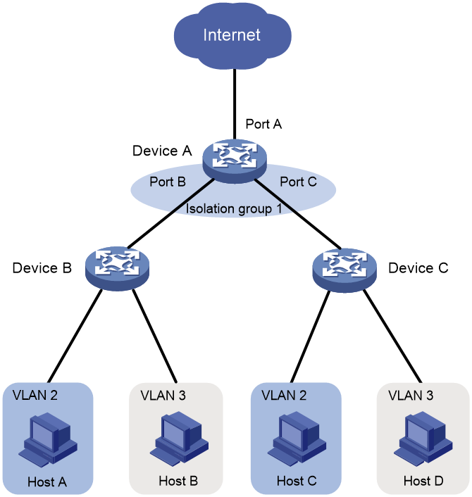

About port isolation
The port isolation feature isolates Layer 2 traffic for data privacy and security without using VLANs.
Ports in an isolation group cannot communicate with each other. However, they can communicate with ports outside the isolation group.
You can configure community VLANs in an isolation group. Ports in an isolation group can communicate with each other if they belong to a community VLAN.
As shown in Figure 1:
· To isolate Host A from Host C, and Host B from Host D, assign Port B and Port C on Device A to isolation group 1.
· To enable Layer 2 communication between Host B and Host D, specify VLAN 3 as a community VLAN in isolation group 1. Host B and Host D belong to VLAN 3.
Figure 1 Community VLANs in an isolation group

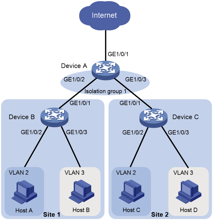

Example: Configuring community VLANs in port isolation
As shown in Figure 3, the company branches Site 1 and Site 2 transfer service traffic in VLAN 2 and VLAN 3.
Configure port isolation and community VLANs on the network to meet the following requirements:
· All hosts can access the Internet through Device A.
· Host B and Host D can exchange video conferencing traffic in VLAN 3.
· Other Layer 2 traffic between Device B and Device C is isolated.
1. Configure Device A:
# Create VLAN 2 and VLAN 3.
<DeviceA> system-view
[DeviceA] vlan 2 to 3
# Configure GigabitEthernet 1/0/2 and GigabitEthernet 1/0/3 as trunk ports, and assign them to VLAN 2 and VLAN 3.
[DeviceA] interface gigabitethernet 1/0/2
[DeviceA-GigabitEthernet1/0/2] port link-type trunk
[DeviceA-GigabitEthernet1/0/2] port trunk permit vlan 2 3
[DeviceA-GigabitEthernet1/0/2] quit
[DeviceA] interface gigabitethernet 1/0/3
[DeviceA-GigabitEthernet1/0/3] port link-type trunk
[DeviceA-GigabitEthernet1/0/3] port trunk permit vlan 2 3
[DeviceA-GigabitEthernet1/0/3] quit
# Create isolation group 1.
[DeviceA] port-isolate group 1
[DeviceA-port-isolate-group1] quit
# Assign GigabitEthernet 1/0/2 and GigabitEthernet 1/0/3 to isolation group 1.
[DeviceA-GigabitEthernet1/0/2] port-isolate enable group 1
[DeviceA-GigabitEthernet1/0/3] port-isolate enable group 1
# Configure VLAN 3 as a community VLAN in isolation group 1.
[DeviceA-port-isolate-group1] community-vlan vlan 3
2. Configure Device B:
# Create VLAN 2 and assign GigabitEthernet 1/0/2 to it.
<DeviceB> system-view
[DeviceB] vlan 2
[DeviceB-vlan2] port gigabitethernet 1/0/2
[DeviceB-vlan2] quit
# Create VLAN 3 and assign GigabitEthernet 1/0/3 to it.
[DeviceB] vlan 3
[DeviceB-vlan3] port gigabitethernet 1/0/3
[DeviceB-vlan3] quit
# Configure GigabitEthernet 1/0/1 as a trunk port, and assign it to VLAN 2 and VLAN 3.
[DeviceB-GigabitEthernet1/0/1] port link-type trunk
[DeviceB-GigabitEthernet1/0/1] port trunk permit vlan 2 3
3. Configure Device C in the same way Device B is configured.
# Display information about isolation group 1 on device A.
[DeviceA] display port-isolate group 1
Port-isolate group information:
Group ID: 1
Group members:
GigabitEthernet1/0/2 GigabitEthernet1/0/3
Community VLAN ID: 3
The output shows that:
· GigabitEthernet 1/0/2 and GigabitEthernet 1/0/3 are assigned to isolation group 1.
· VLAN 3 is configured as a community VLAN in the isolation group.
