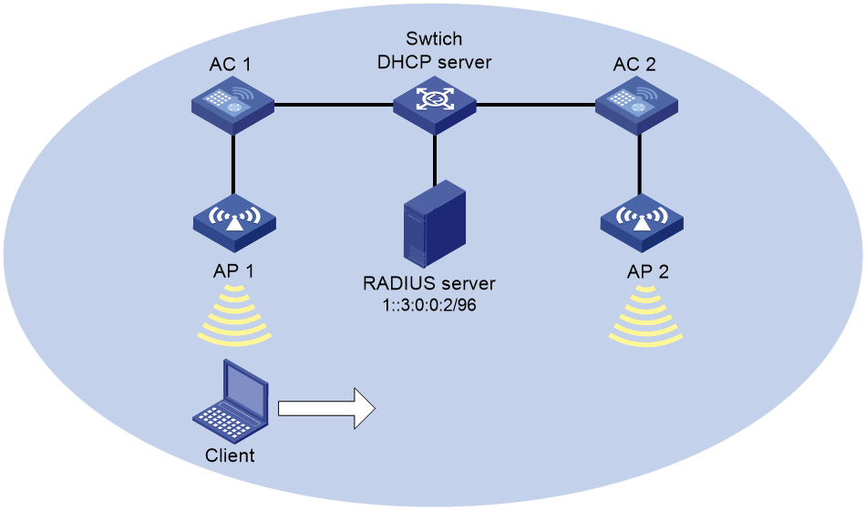

As shown in Figure 1, AP 1 and AP 2 are managed by AC 1 and AC 2, respectively. Clients associated with AC 1 belong to VLAN 200. Clients associated with AC 2 belong to VLAN 400.
Complete the following tasks:
·     Configure all devices to use IPv6 addresses.
·     Configure inter-AC roaming to enable clients to roam between AP 1 and AP 2.
·     Configure VLAN-based user isolation to improve user security and reduce radio resources consumption caused by multicast and broadcast packets.
Figure 1 Network diagram
Table 1 Interface and IPv6 address assignment
Device
Interface
IPv6 address
AC 1
VLAN-interface 100
1::1:0:0:2/96
VLAN-interface 200
1::2:0:0:2/96
AC 2
VLAN-interface 100
1::1:0:0:3/96
VLAN-interface 400
1::4:0:0:2/96
Switch
VLAN-interface 100
1::1:0:0:1/96
VLAN-interface 200
1::2:0:0:1/96
VLAN-interface 300
1::3:0:0:1/96
VLAN-interface 400
1::4:0:0:1/96

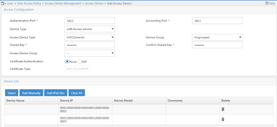

1.     Add the ACs to the IMC Platform as access devices:
a.     Log in to IMC.
b.     Click the User tab.
c.     From the navigation tree, select User Access Policy > Access Device Management > Access Device.
d.     Click Add and perform the following tasks:
-     Enter 12345678 in the Shared Key field.
-     Add IPv6 addresses 1::1:0:0:2 and 1::1:0:0:3 to the Device List.
-     Use the default settings for other parameters.
e.     Click OK.
Figure 2 Adding access devices

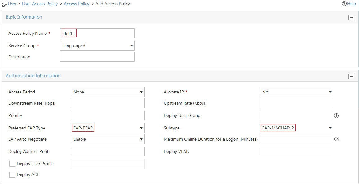

2.     Add an access policy:
a.     From the navigation tree, select User Access Policy > Access Policy.
b.     Click Add to add an access policy that uses the following settings:
-     Access Policy Name—dot1x.
-     Preferred EAP Type—EAP-PEAP.
-     Subtype—EAP-MSCHAPv2. The subtype must match the client authentication method.
Figure 3 Adding an access policy

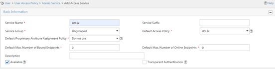

3.     Add an access service:
a.     From the navigation tree, select User Access Policy > Access Service.
b.     Click Add to add an access service that uses the following settings:
-     Service Name—dot1x.
-     Default Access Policy—dot1x.
Figure 4 Adding an access service

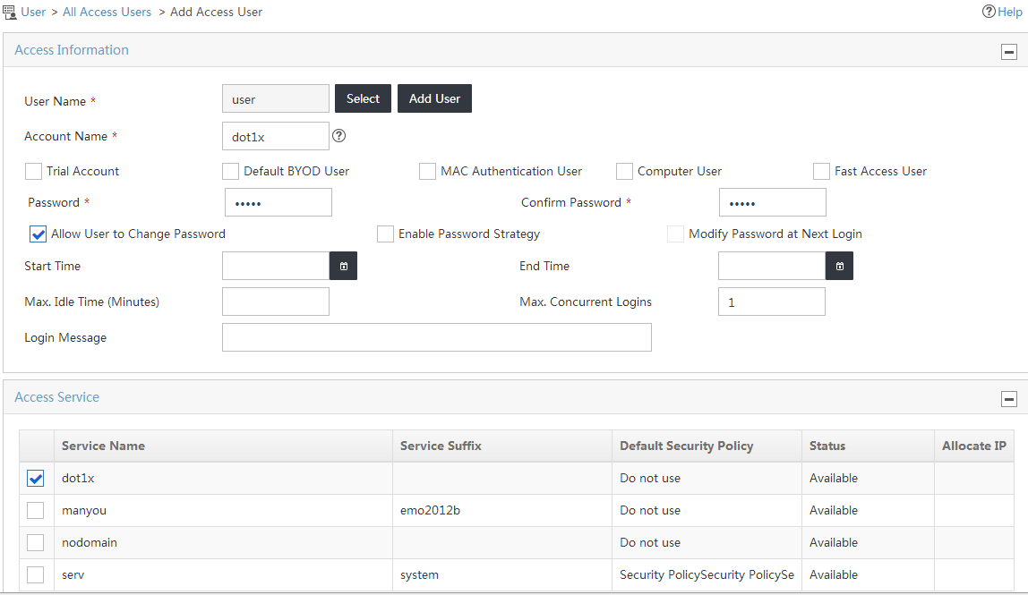

4.     Add an access user:
a.     From the navigation tree, select All Access Users.
b.     Click Add and perform the following tasks:
-     Click Add User to add a user with username user.
-     Set the Account Name to dot1x.
-     Set the Password to dot1x.
-     Select the dot1x service.
Figure 5 Adding an access user
