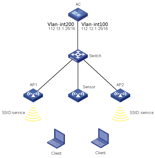

As shown in Figure 1, AP 1 and AP 2 provide wireless services for clients through SSID service.
Enable WLAN probe on the sensor, and configure the sensor to report the received wireless device information to the AC.
Figure 1 Network diagram
