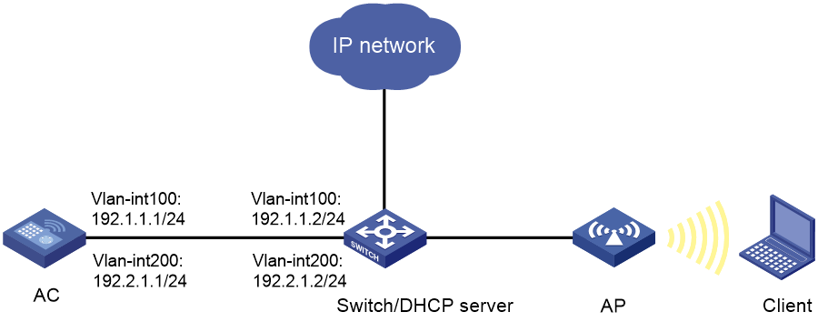

As shown in Figure 1, the switch assigns IP addresses to the AP and the client. The AP and the AC establish a CAPWAP tunnel through VLAN 100, and the client accesses the wireless network through VLAN 200. The working hours of the company are 8:00:00 through 18:00:00 from Monday to Friday.
Configure an application audit and management policy on the AC to meet the following requirements:
·     Permit login from all QQ accounts during working hours.
·     Generate audit logs.
Figure 1 Network diagram
Use the actual serial ID of an AP to uniquely identify that AP.
